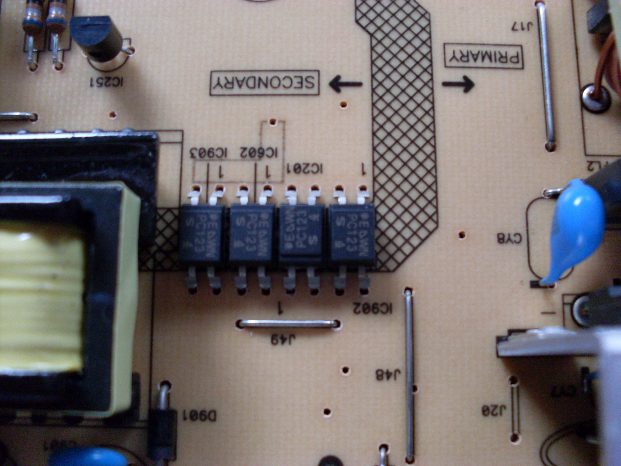

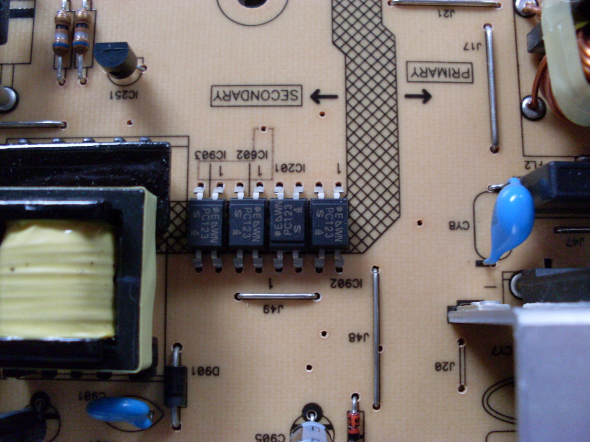

        If you need more pictures, just let me know. Thanks!
          #304
          Re: Sanyo DP42849 - No Power At All
          Pics are good now. Trying to understand circuit. Can you check on continuity or 2000 ohms from NEGATIVE lead of C905 to NEGATIVE of big 450V capacitor?

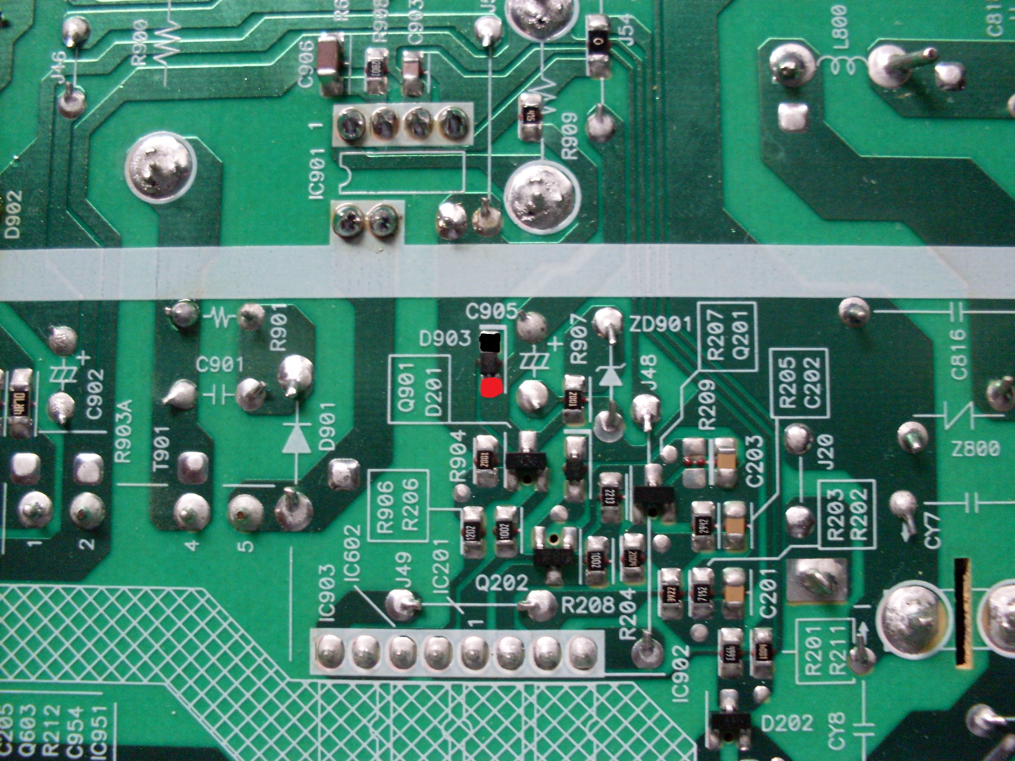

              #306
              OK, so that is grounded.
              Can you see a part # on Q901?
              When you test D903, and got ~600, which side was positive, which side was negative? Can you highlight those?

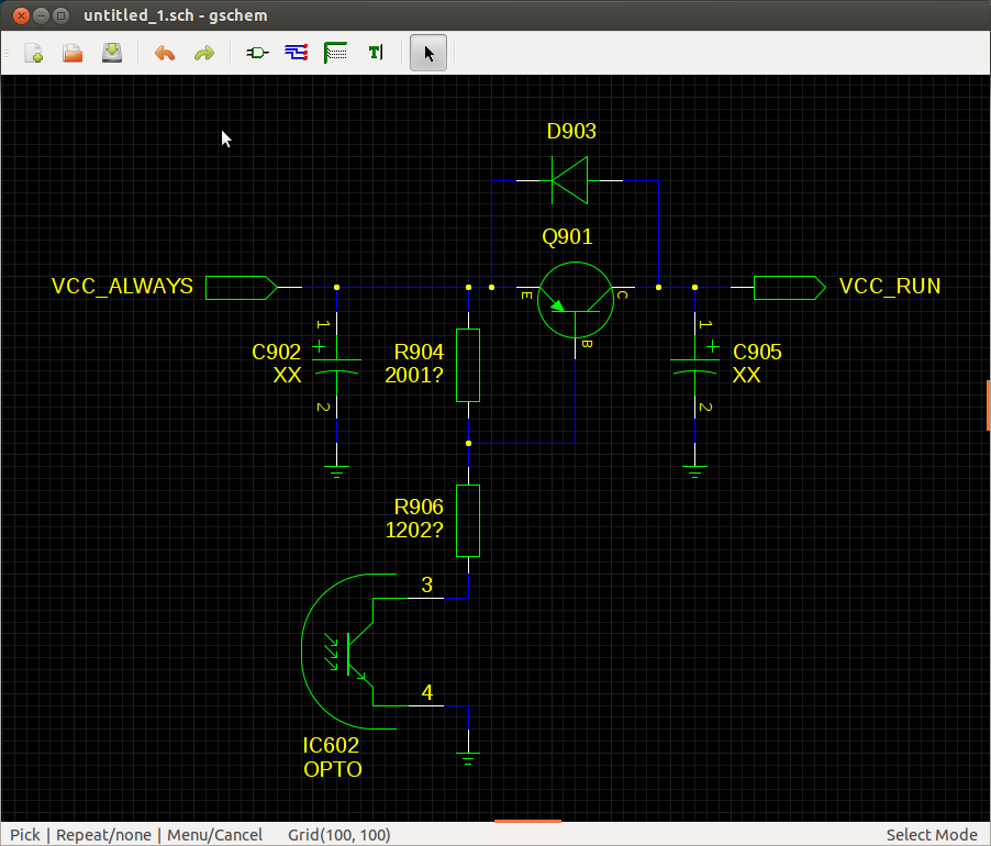

                  The circuit is starting to make some sense... I think Q901 is a PNP transistor.

                    #309
                    I'm amazed that you can make anything out of this.
                    Hopefully I'm looking at the right Q901 - it looks like 2T with a another 2 turned clockwise.
                      #310
                      Think that's a PMBT4403. I'll try to trace the schematic out soon. That transistor might be bad. Looks like this surge/failure did some pretty nasty damage but with very little marks left behind.

                            Traced the circuit.
                              #314
                              Please test voltage across primary side of IC602, in standby and powered on.

                                  #316
                                  Yep - just check the voltage across them.
                                  If the voltage goes from HIGH to LOW (figures will vary) the opto is working and that transistor is not, for some reason; if the voltage does not change, need to look at the opto and/or the circuit controlling it.

                                      #318
                                      DC20V. Orientation unimportant for now

                                          #320
                                          Hmm, what do you measure on the other side of the device? COLD side only?
