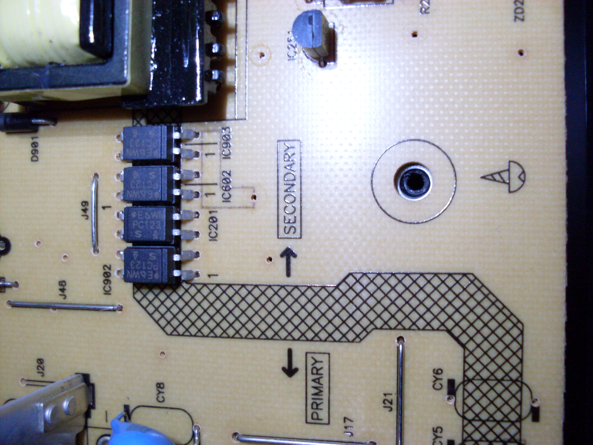

    The results on the IC602, right?
    If you could explain to me in detail how to do the test again, I'll redo it, just in case I did do it incorrectly.
    Thanks!
      Re: Sanyo DP42849 - No Power At All
      You should use diode mode on the secondary/cold side (board unplugged) and see about 1V one way and infinity the other way - though if it is in circuit it might not work.
      You can also check the voltage across each side and be sure that the multimeter probes are touching each pin - verify with continuity check.
        For IC602, the two legs on the secondary side, diode mode:
        "1" one way
        1253 the other.
        IC 902:
        "1"
        1340
        IC 201:
        "1"
        "1"
        IC903:
        "1"
        1196 (but leads are reversed in comparison to the other ICs)

          IC201 does not look right to me. What part # is printed on it?
            I'll get that in a second. I redid the voltage test on all of them as well:
            IC902: 0.87 --> 1.93
            IC201: 0 --> 0
            IC602: 0 --> 0
            IC903: 16.57 --> 19.86
              All 4 ICs have same part number:
                IC201 should test as around 1200~1400 on your meter. So I think it is bad.
                SHARP PC123 optocoupler.

                  Let me test one more time to make sure.
                  So those are the optocouplers? LOL I thought it was that shiny yellow thing above them.
                    Shiny yellow thing is probably a transformer.

                          So IC902 and IC903 are oriented the same way in the board, but I have to reverse the leads when doing diode check on them to get comparable readings. Is that normal?

                              Compared to IC602?
                                You have to remember that electricity follows the path of least resistance. You probably aren't getting a reading through the component but rather, through the rest of the circuit. Sometimes you have to remove the component to test it.

                                  I see what the problem was with IC201's reading. It's the only IC whose orientation is reversed. When I test it on the other side - red lead on pin1 - I get 1367.
                                  IC903, 602, and 902 are all situated in the board the same way - here's how I get my diode readings:
                                  IC903: Black on pin 1 - 1196
                                  IC602: Red on pin 1 - 1253
                                  IC201 (reversed in board): Red on pin 1 on PRIMARY side - 1367
                                  IC902: Red on pin 1 - 1340

                                      So IC201 is good, right?
                                      Why is IC903 different?
                                        I wouldn't know why IC903 is different, that is really odd.
