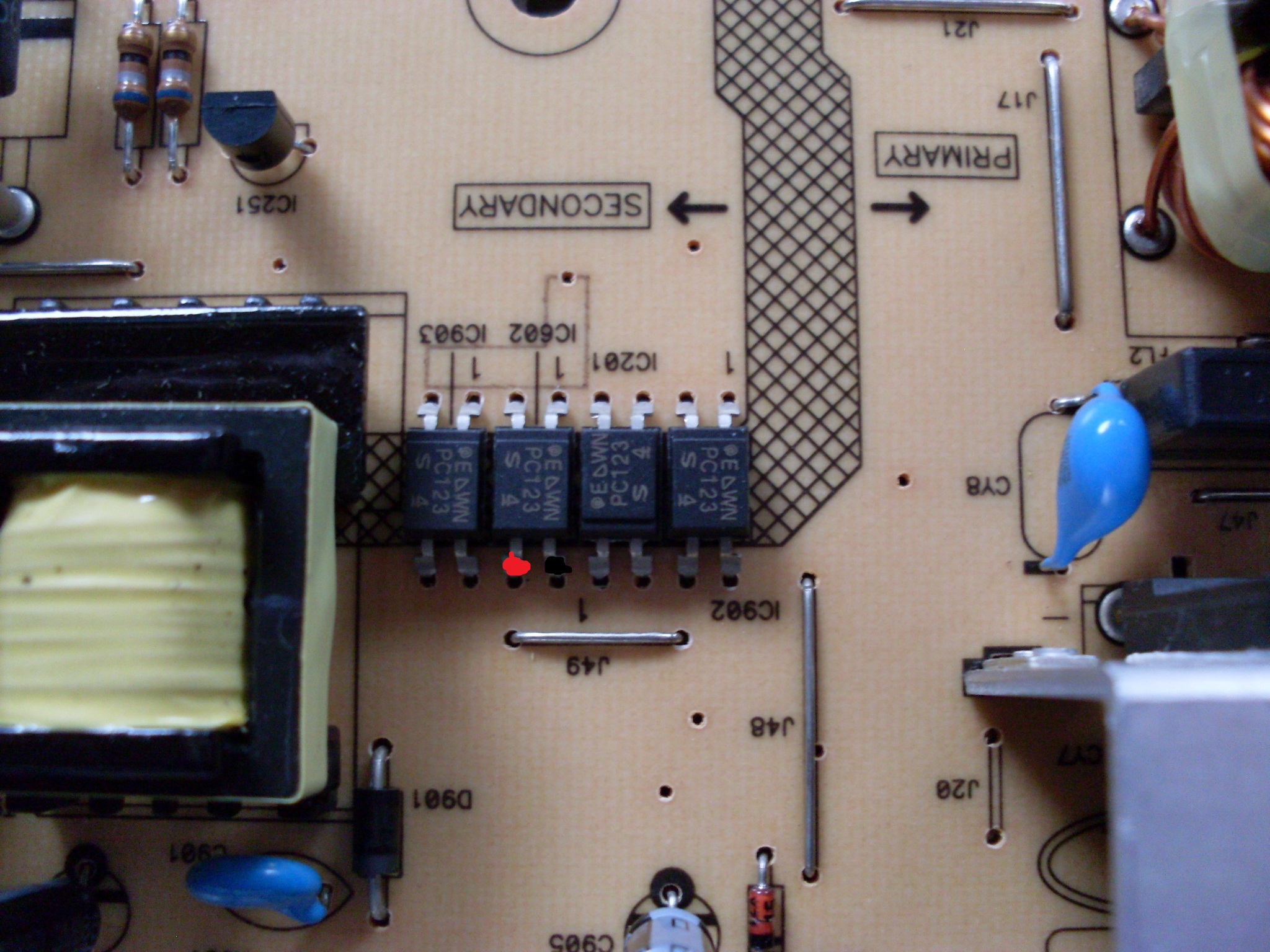

        Maybe I'm doing it wrong. I'm testing the two pins of IC602 that are connected to the primary side of the board with DCV 20.
          Re: Sanyo DP42849 - No Power At All
          That is correct. I have a few tests in mind, for now check what R904,R906 measure on 20kohms scale. (I'm sure you're tired of pulling that board in and out by now, sorry......)

                            I have been thinking about this for the past day or so and can't explain your zero reading on the secondary. Can you show me how you're testing?
                              I plug TV in, put meter on DCV 20, and touch leads as indicated in the picture. Then try it with power pressed.

                                jeesh,forgot all about this thread,this one seems a pain in the arse dosent it?,i think tom is getting there in the right direction,i seem to remember on another set ive worked on with these damned optocouplers had me baffled,pc123's,i managed to test them with 2 analog meters in series to test the transistor side,outputting around 24v on the meter showed up a bad side on the opto,one or 2 of the opto's were for feedback,and was preventing the psu from powering up,but the led side of the opto was working,(reading one way only on diode test)confirmed good,the transistor in the opto cant be tested ,unless you use 2 meters in series,the voltage in a dmm was insufficiant to find a bad transistor in the opto,trying to explain the opto configuration was like this if you imagine the led side of the opto as an arrow they went like this there was 4 of them, ^ ^ and the other 2 were pointing down.V V.
                                might be worth checking them ,they dont have a high failiure rate,but i have come across one or two bad.
                                  just below the link marked j48 in that picture,there is a zener diode,is it me or is there a crack in that zener diode?,it looks to random to be a manufacture mark??

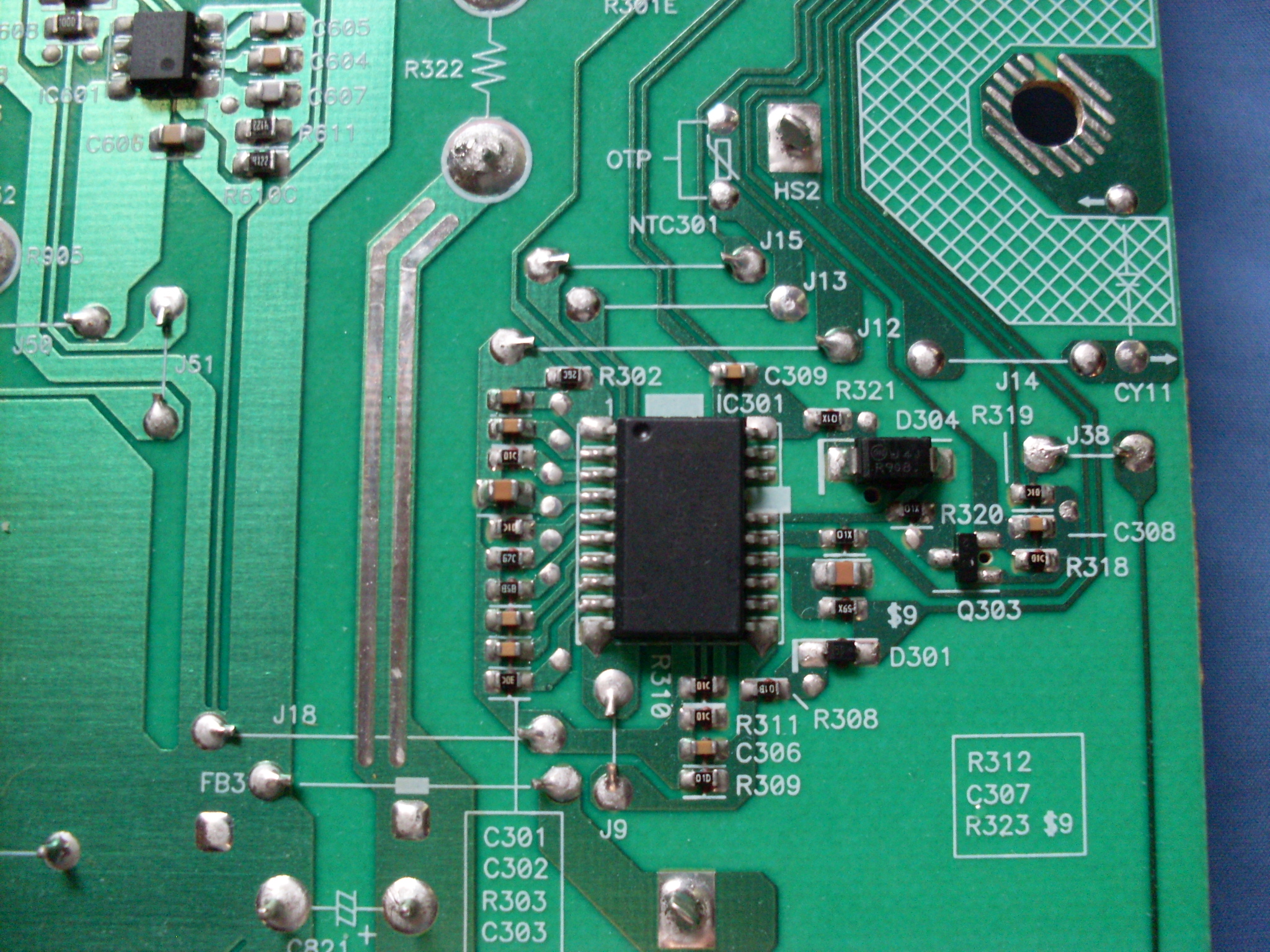

                                    I have the same TV. I spent 3 weeks before I figured out I had a shorted primary on the inverter transformer. I have 3 power supplies and 2 need transformers. I was going to rewrap them but I cracked the ferrites trying to get them apart. I think the second one I could have gotten apart, I put it in the oven for 45 minutes on 350. I should have had something better than needle nose pliers though.
                                    Anyway, I figured out that there is a shutdown circuit. I think its part of IC301. Probably not the case with Nihon's but if the resistances on the big transformer are too low (in my case .3 ohms between pins 1-2, 4-2) it shuts down.
                                      You mean this one (pictured below), multi? I test it with diode mode - got 750 one way and "1" the other.
                                      Here's a picture of IC301, too.

                                        Should I retest IC602?
                                          I wondered what had happened to this thread. My fault entirely for not following up on it. I'm nearly reaching the end of possibilities. I can't explain the results you are getting, unless the optocoupler is bad.
