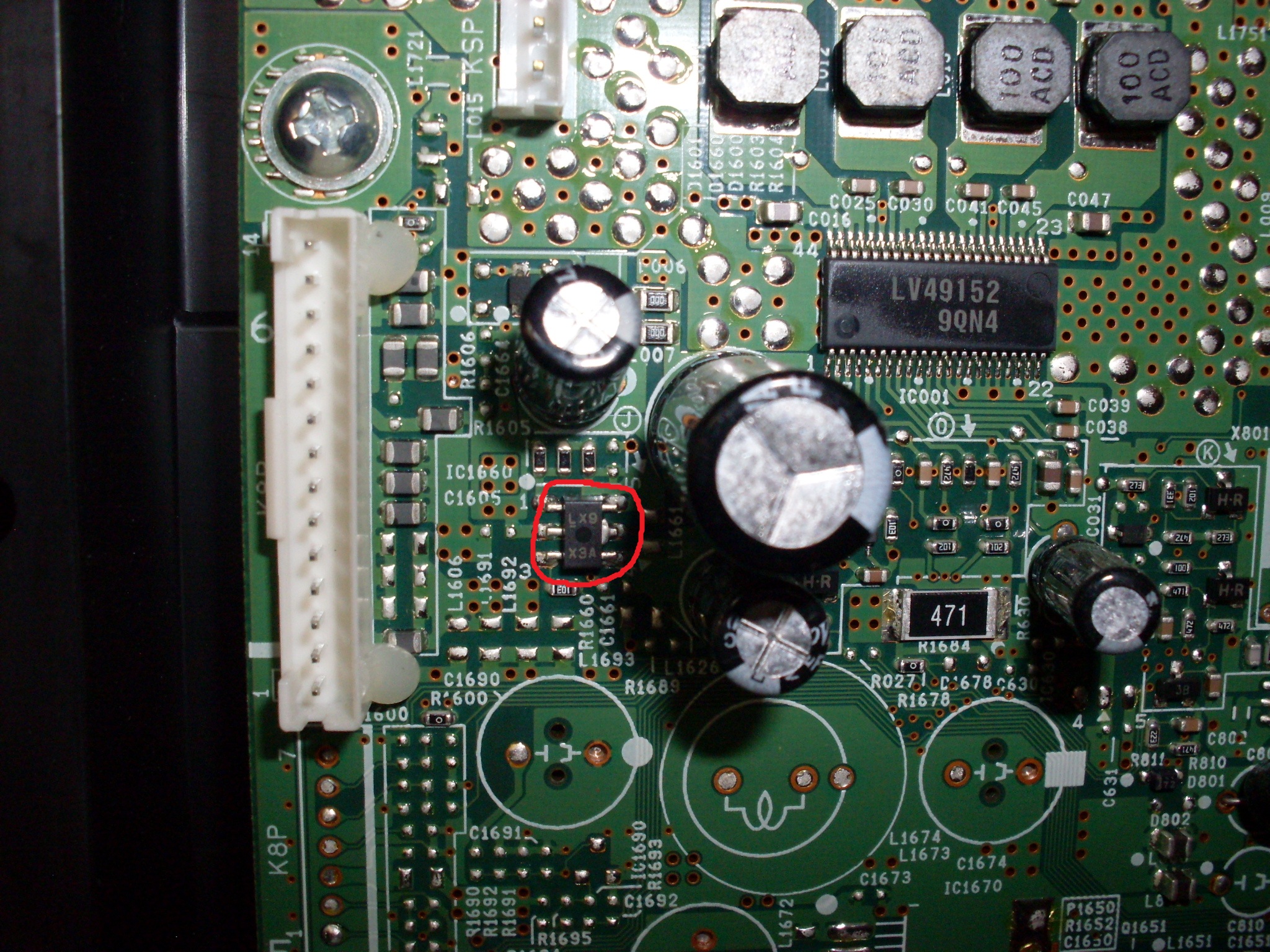

    Re: Sanyo DP42849 - No Power At All
    DCV 20
    IC1660 - Pin 5 = 0.27
    Which pin is pin 1 on 1630 and on Q1651?
      #182
      IC1660 should be primary focus for now.
      Pin 1 of devices should be marked with a "1" or small dot in plastic.

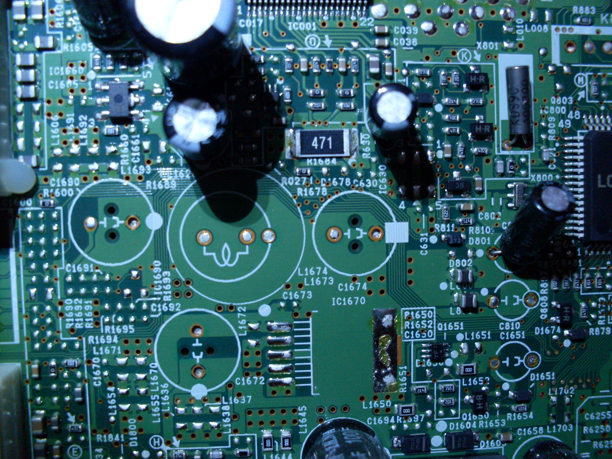

        Here's R1684. Not sure where to put probes.
        I'm not seeing any numbers near the pins, and I can't see any dots in the plastic for 1630 and Q1651.
          IC1660 - Pin 4:
          When I first put probe on it with TV plugged in, I got .09. Touched it for ~80 seconds, and it climbed slowly to .18.
          Touching power button resulted in no change.
          Just to be clear, this is IC1660?

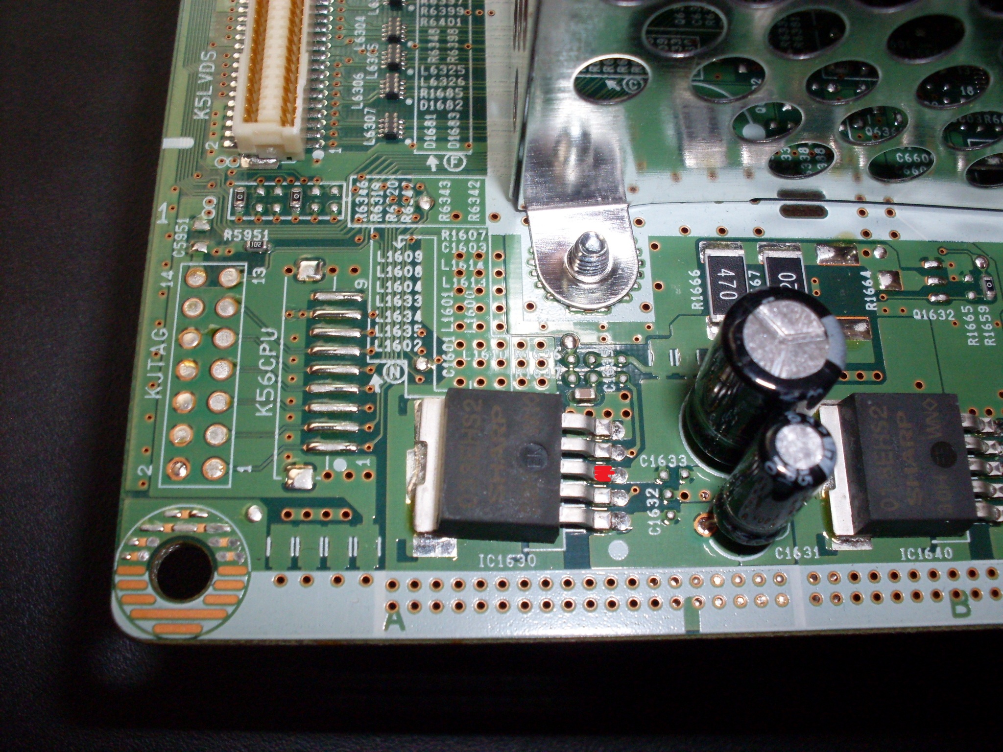

            Probed what I assume is pin 3 on the Sharp IC. Got 0.
