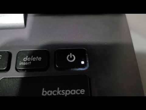

    • Noticed for the first time the power button light was lit, and showing what looked like an error code. I couldn't find any online sources specific to laptops error codes.

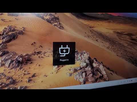

    • Although it was powered up running on USB and with no battery, on screen, the laptop kept switching between Power and Battery icons, as if power was turning off and it tried to switch to battery. Seems to reflect the board power fluctuating in a similar manner.

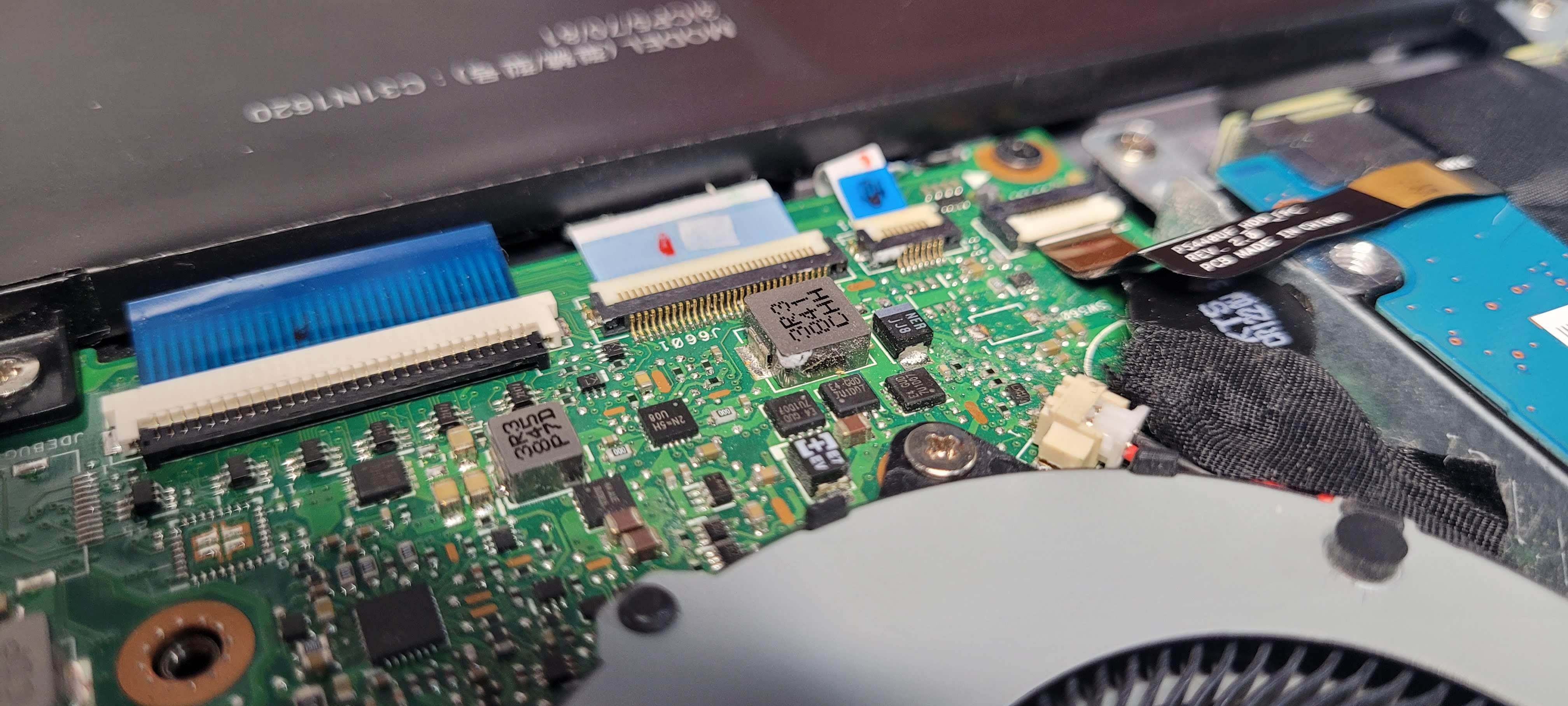

    Edit: Forgot to mention that I found two electromagnetic coils with some kind of seepage. All I can think of is the insulation melted and seeped out? Image attached.

    "Noticed for the first time the power button light was lit, and showing what looked like an error code. I couldn't find any online sources specific to laptops error codes."
    But this is a great sign! Because it shows that the BIOS and the EC-controller is still alive and also the relevant power rails.
    "Seems to reflect the board power fluctuating in a similar manner."
    This can happen if your PD/Charge controller switches forth and back between the two power sources. For example 19 Volt from external power supply and 16 Volt from internal battery.
    Or another reason:This can happen if your external power supply is not able to deliver the requested and necessary current.
    For example, if you need 5 Ampere, but your power supply can deliver 3 Ampere only, then the PD/Charge controller can try to switch to battery.
    It can happen also if your battery can not deliver the requested current. For example if the battery is too old.
    There might be also some kind of dirt or anything else, which confuse some sensitive signals.

      The laptop has not been worked on prior to me, as I am the original owner. It was working fine up until a couple of weeks ago. Not ruling out that a cleaning wouldn't help, but the only suspicious items I've found are two coils which seem to have leaked some white material.
      Hopefully I will be able to get back to the laptop soon, check on any cleaning and continue chasing the suspected short.
