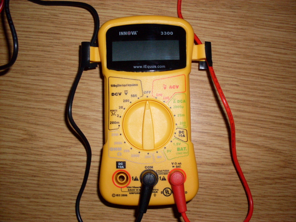

      Got my meter today. Picture attached.

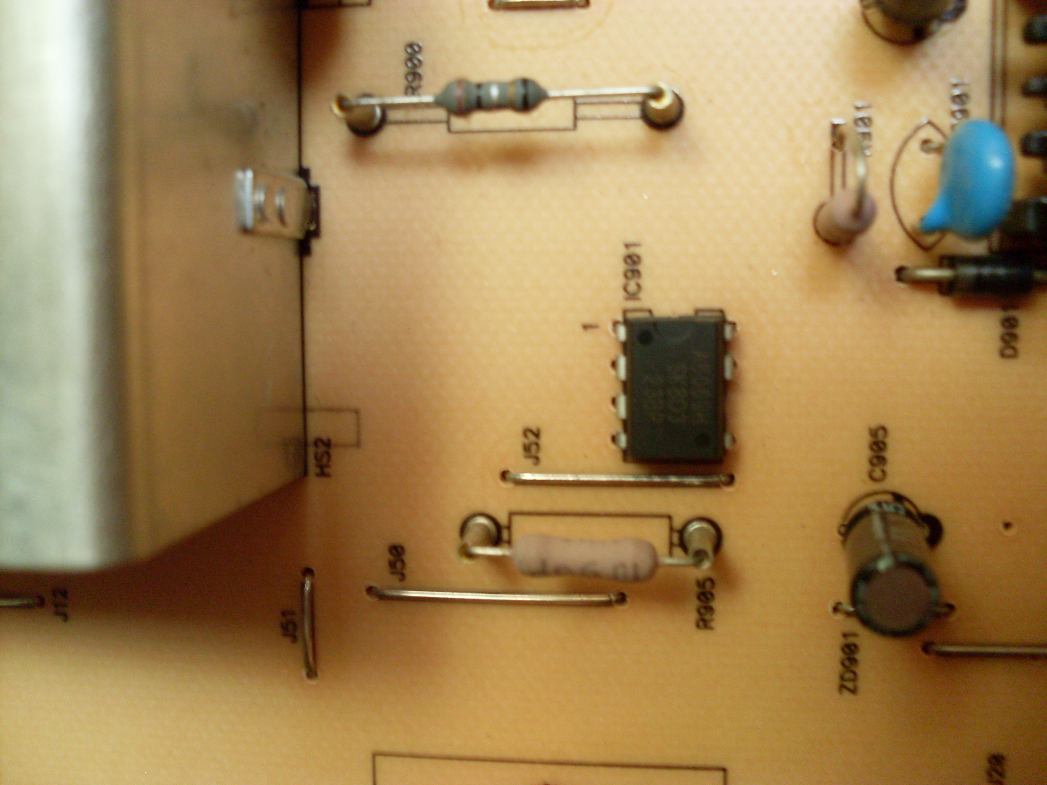

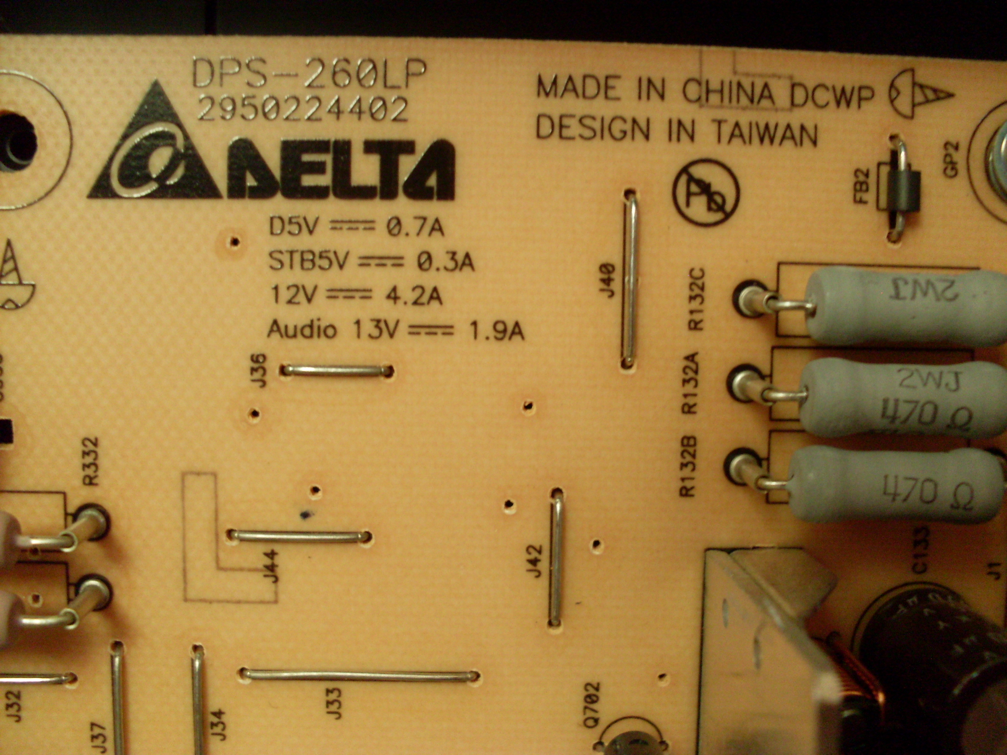

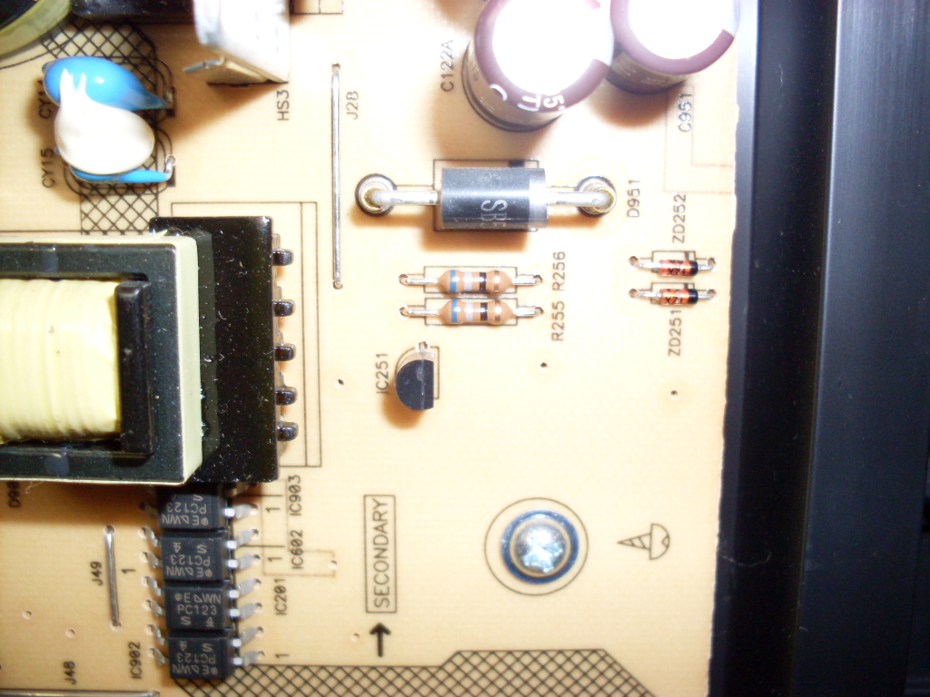

      Also attached are pictures of PS pins, and of IC and diode that have been the culprits in other similar threads about my model.
      D0951 - Tried testing following instructions that came with my DMM. I get 215 one way and "1" the other way.
      IC901 - I don't know how to test this.

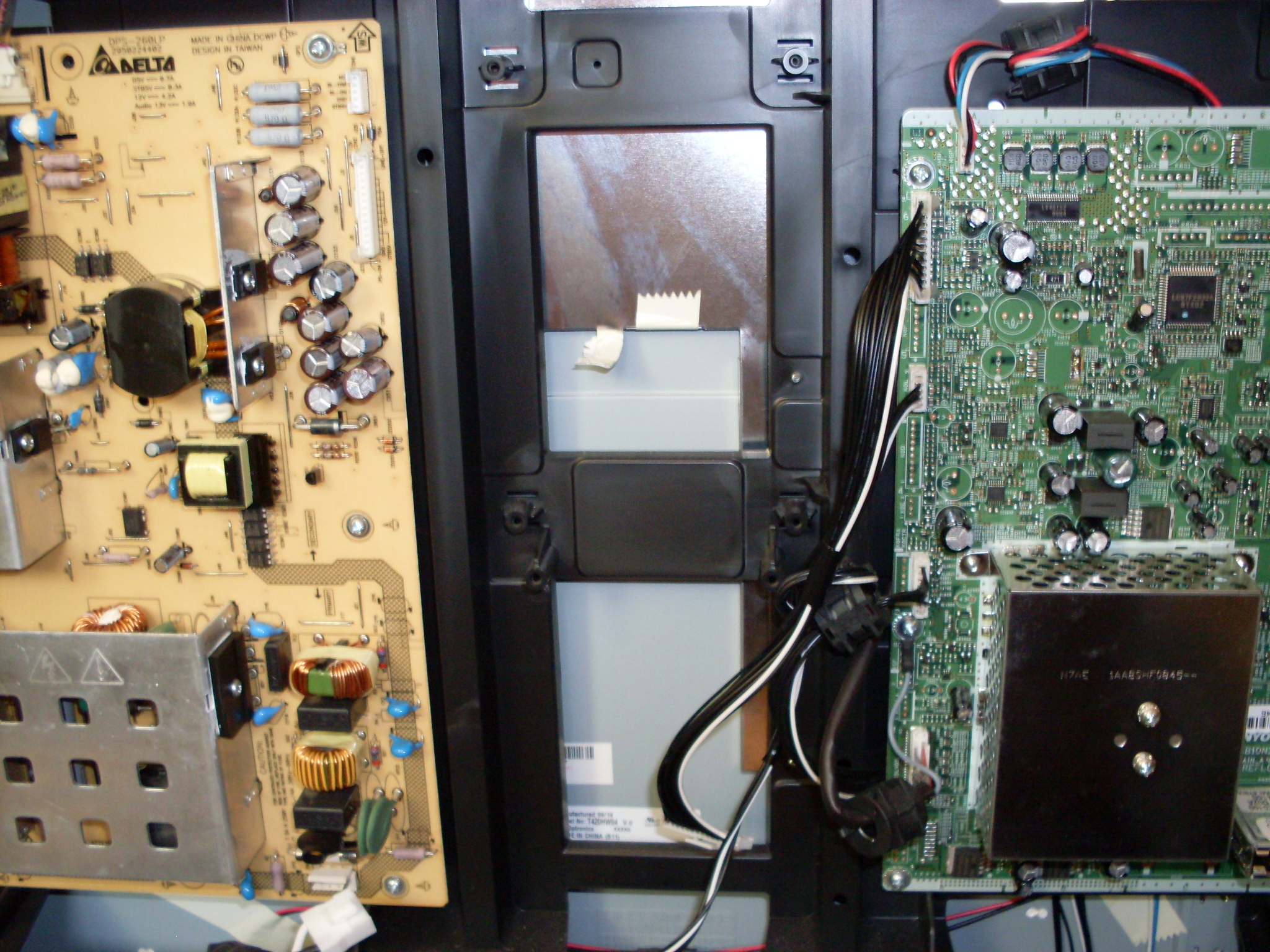

      I now understand that the first step is to test voltage on the pins on the secondary side of the board. Is this something I can do while the television is unplugged? I'm guessing not.
      I've disconnected the power cable to the main board, and another smaller cable that went from power board to main board. Photo attached.
      I've had TV unplugged for a few days. Is there anything I can test while large caps are discharged?
      Should I leave boards in TV or take them out?

        d0951 is fine
        part number of ic901?

          That IC is hard to read. A6069H SK803 23BP.

              Oh yeah - is this my service manual?

                this is your power ic,pin one will have a dot on the surface
                count anti-clockwise,you will have to check pins 3 and 5 ,with your meter on 200 ohm resistance,report the reading back,when you have done the voltage testing
                  looks like it,lets see how testing goes.it could be a mainboard flash problem,eek

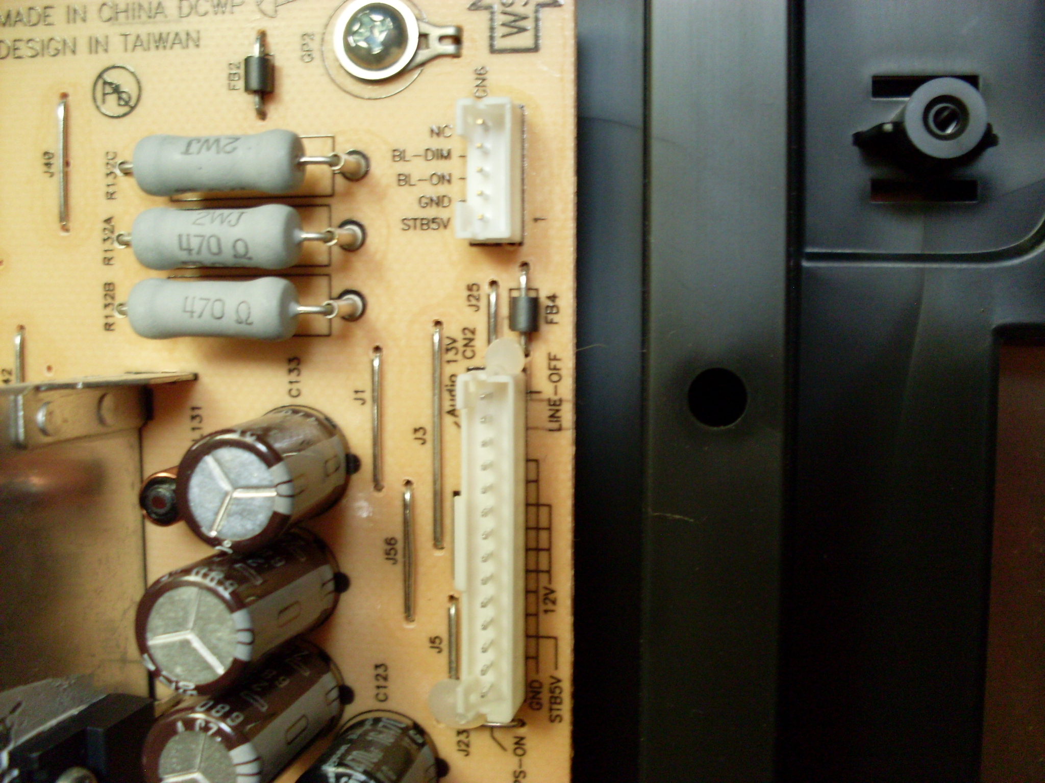

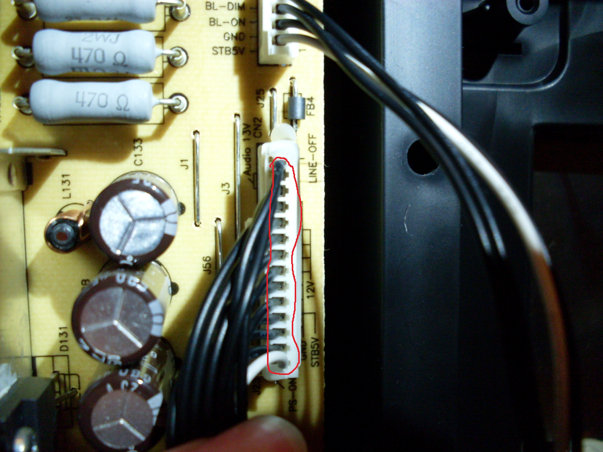

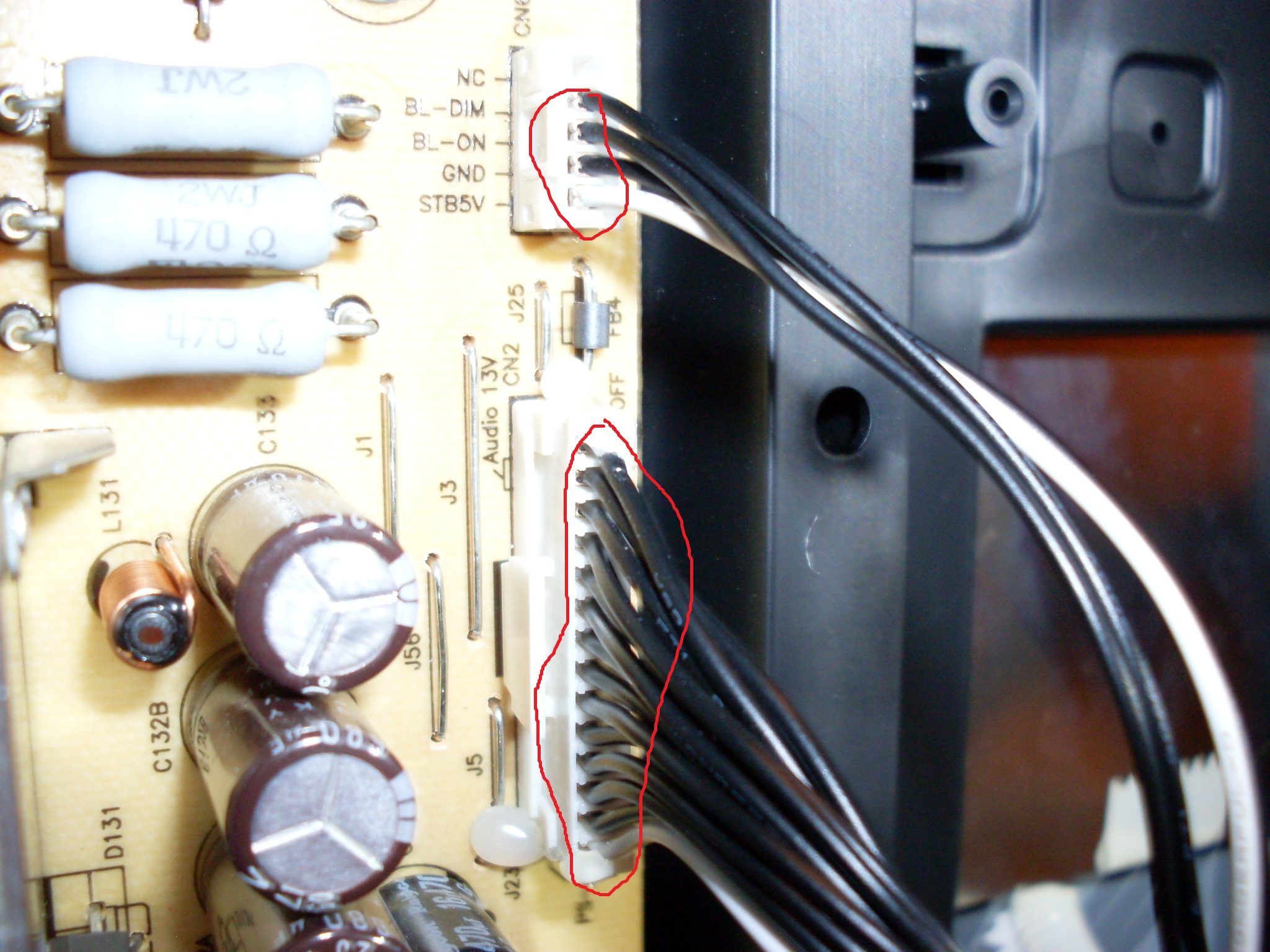

                        Okay, I plugged TV in, poked black lead into mounting screw and red lead into each pin. DMM on DCV 20. Touched all pins in photo.
                        Got 0 on all of them. Paid special attention to STB5V because that's the only one I'm supposed to get a reading on, right? Got nothing.
                        I did remove the cables to make it easier to touch the pins.
                          the 5 v should be there ,those readings are with the tv plugged in ,but not switched on?just double check.
                          then turn the tv on and do the same measurements for voltages
                          on both tests keep the mainboard connected,and just squeeze your probes down the side of the cables

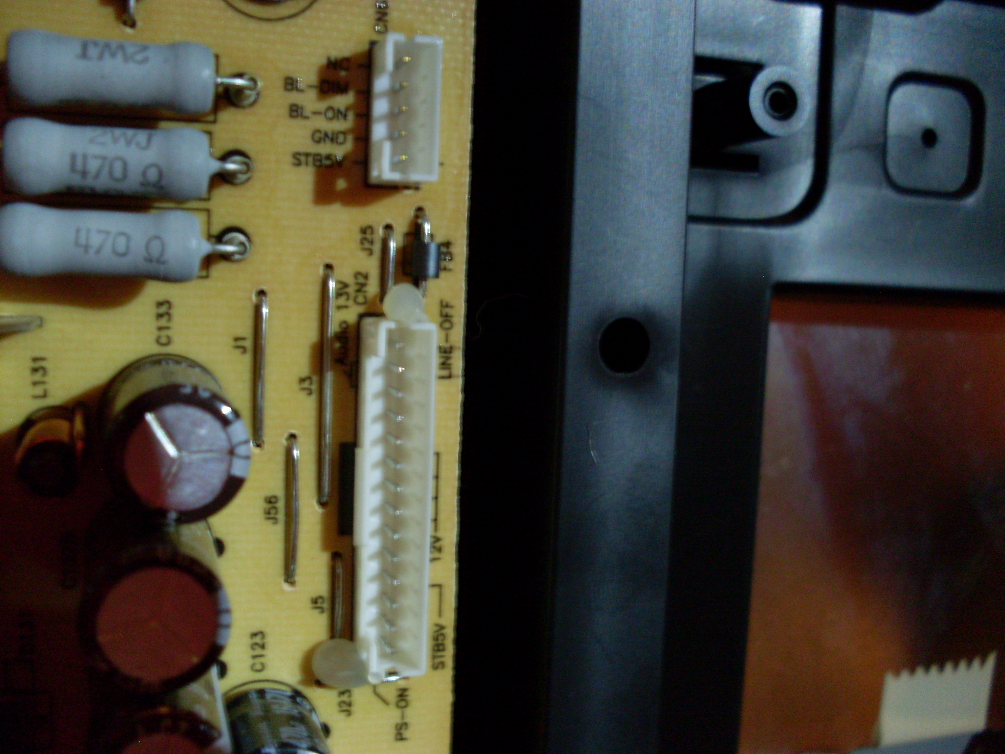

                                  Okay, TV plugged in, didn't press power button.
                                  DMM - DCV 20
                                  Black lead on mounting screw, red lead poked into areas marked in photos. I pushed the lead as far in as it would go. Tried both sides of where wire goes into plastic connector.
                                  Nothing. Paid special attention to STB5V - nothing.
                                    and do the same with power turned on as if you wanted to watch tv,and measure voltage on all pins
                                    there is a fault in the standby circuit it seems.or pfc circuit isnt working.
