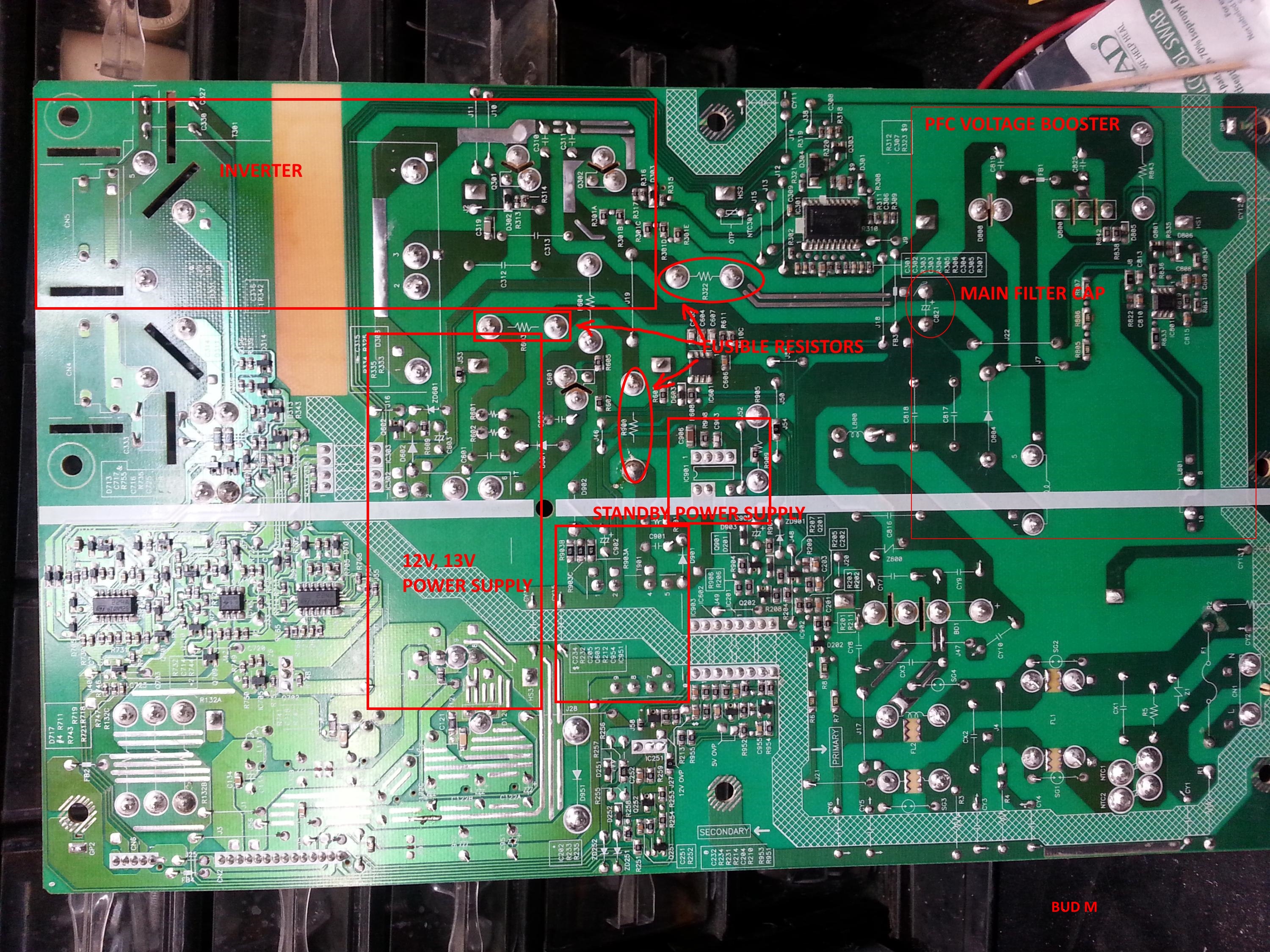

    Are you sure fusible resistor R900 is good.
    You need to check the DCV again this time use the negative leg of the main filter cap C821 for the black probe, the red probe goes to pin 4 of the STBY Transformer T901.
    See picture:
    https://www.badcaps.net/forum/attach...8&d=1450215064

        So you are getting 0V between negative leg of the cap and pin 4 of the transfomer, that means R900 has open circuit. If you check the DCV between the Negative leg of the main filter cap right now you probably will only see 160 VDC on just one of the leg of R900.
        Check the resistance of R322 too.
        BTW, you are measuring the DCV in the HOT DEADLY SIDE of the circuit so you should at least plug the TV into the GFCI outlet and do not touch anything with your hands! You should also read the manual on how to use the meter.

            As you can see, one end of R322 is conected to the + leg of the filter cap C821 and another end is connected to one end of R900,so basically all the legs of the resistors should show 160VDC.
            It seems to me we have measurement errors. At this point I would say R322 is bad due to shorts circuit probably Q301, 302.

                  Well one end of the R322 has 160Vdc feeding it and you have 5vdc on the other end so it means the resistor has 155VDC Voltage across R322, since R322 you indicate 1.3 Ohms, that means you have 155V/1.3 Ohms = 119A of current flowing through that R322 which is impossible!
                  And not only that since R322 leg that shows 5V is feeding R900 but you indicate 10V so that is impossible too, you cannot have 10V when the output of R322 is connected to R900 only has 5V. Think about it and look at the pictures of the bottom side of the board that I have marked for you.
                  You are still not making correct measurement. Look at how R322 connected to R900.
                  I think you should buy a new board at this point.
