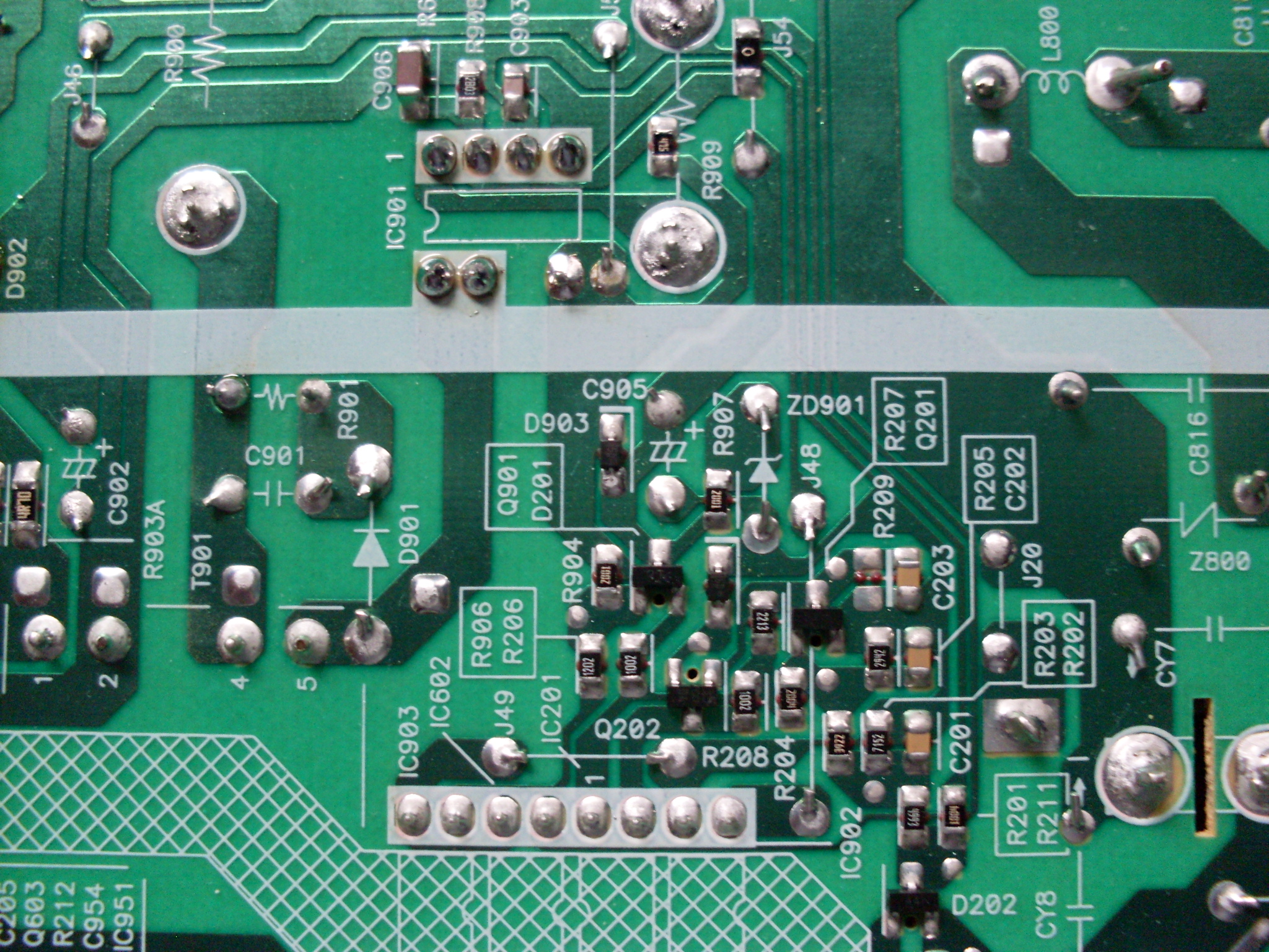

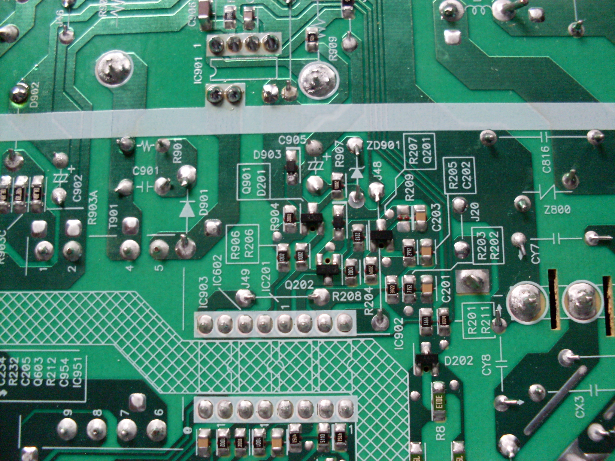

                            So, it looks like D903, a little SMD diode on the bottom of the board, is a potential candidate. It's near C905. This develops the supply voltage for the main switcher IC. It is possibly open circuit, which could be caused by a short, or the initial failure.
                            Can you get a picture of the area around this diode - I need to be able to see where all the traces go into this device.

                                #295
                                Re: Sanyo DP42849 - No Power At All
                                Here you are:
                                  #296
                                  That confirms my hunch; check D903 is not open circuit. Also, check on 2000 ohms across that capacitor C905 right next to it (allow reading to settle for 5 seconds first.)

                                    #297
                                    D903: 626

                                        #299
                                        My fault for not checking. Can you see any part # on D903? Could just be a few letters.

                                          #300
                                          There wasn't much I could do without internet anyway, so I didn't mess with it.
                                          Looks like 5p. Might also be 5D. It really looks like a 'p', tho.
