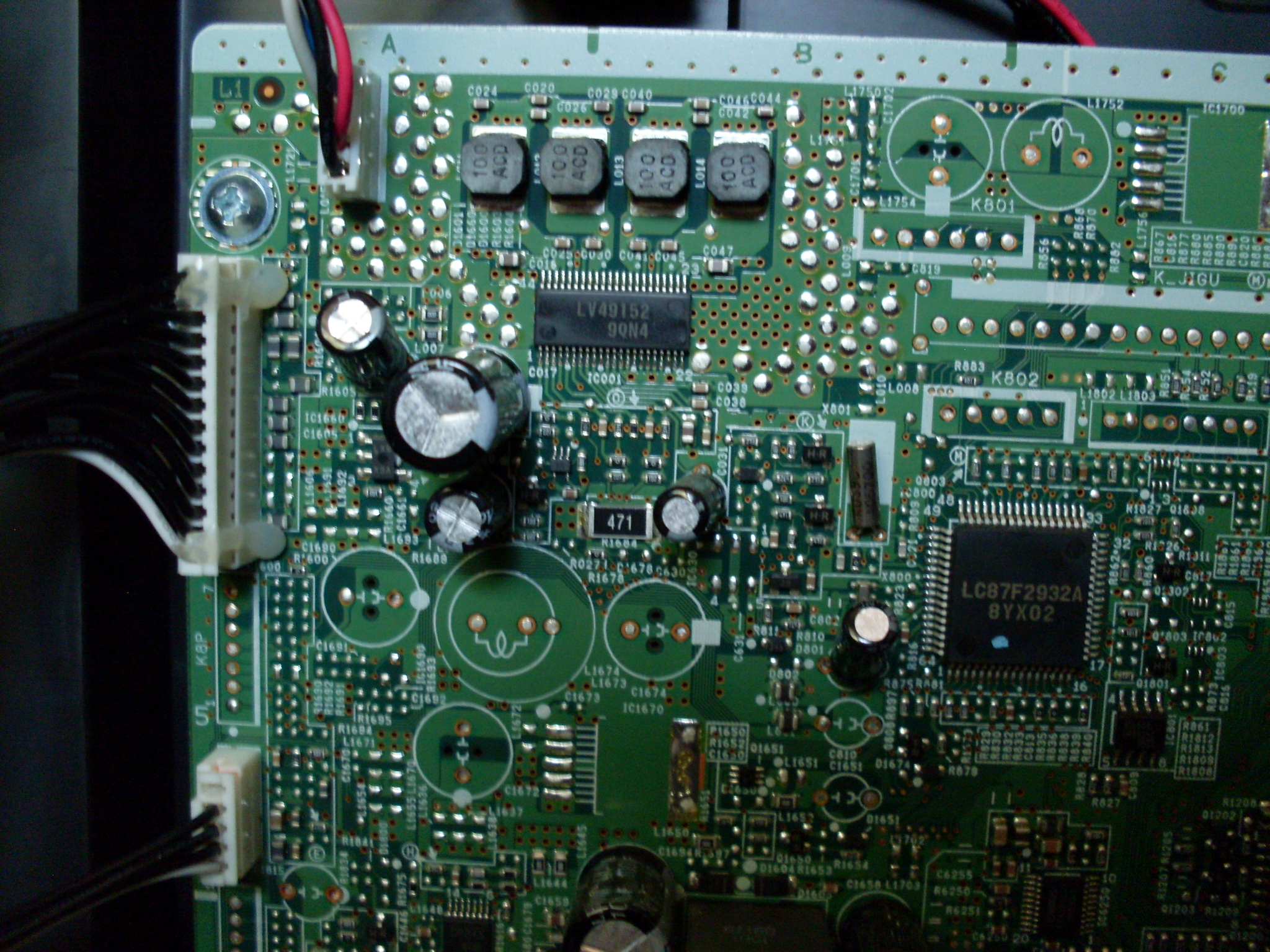

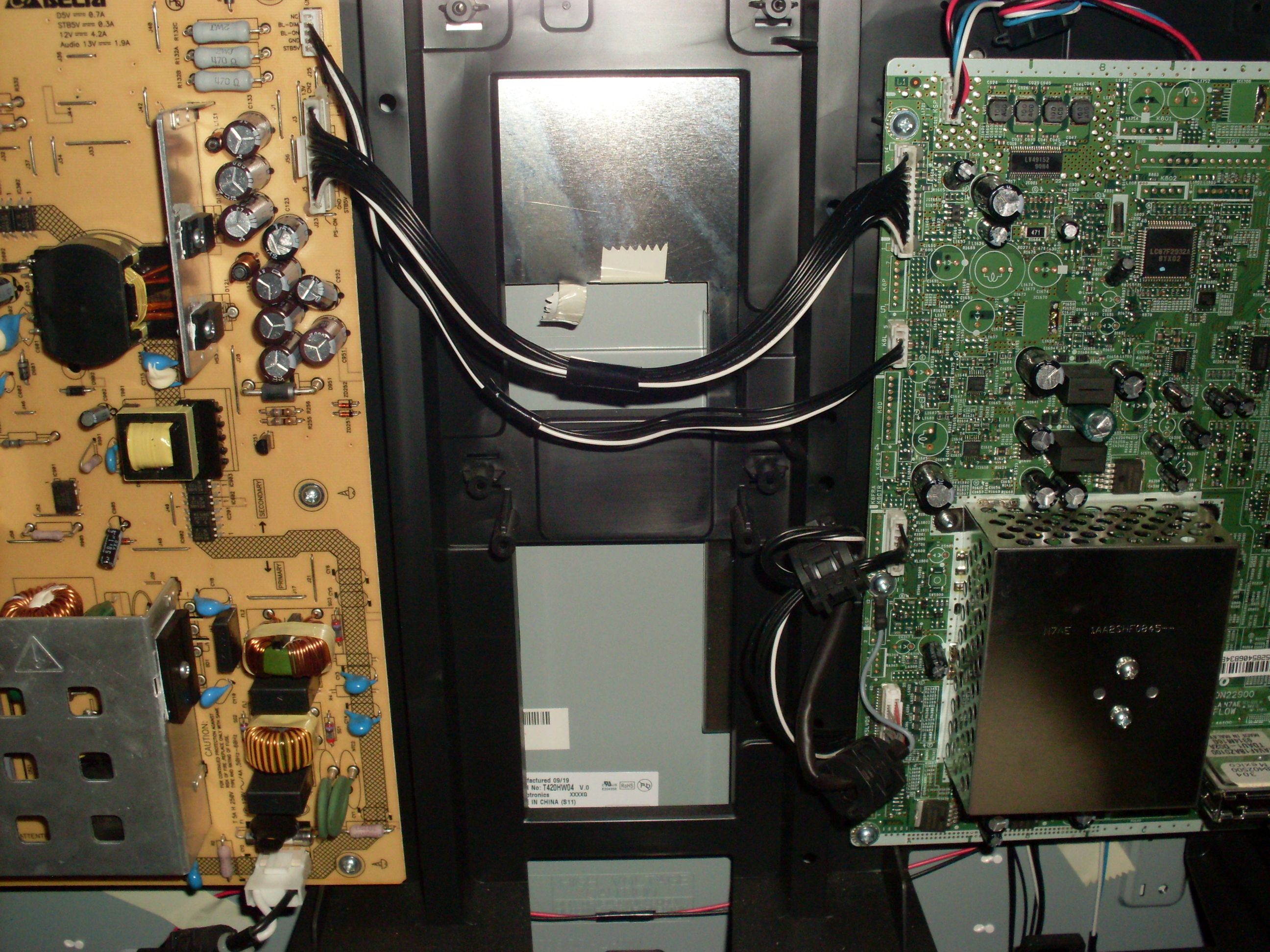

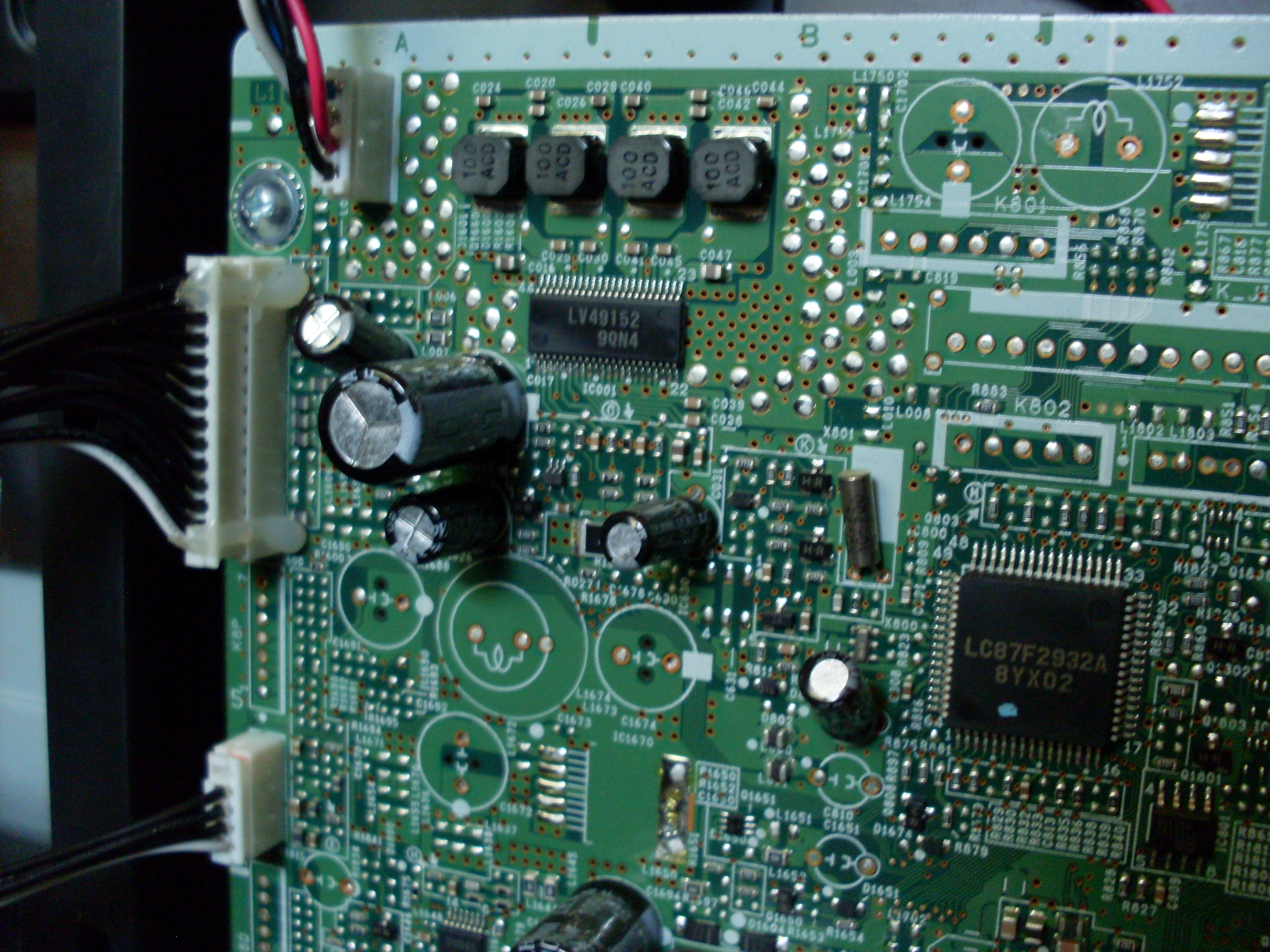

    Picked this Sanyo up today to try and fix for my own personal use, and I think I need a bit of help. I assumed, before actually getting the set, that I would find a situation like this, since it seems to be a common issue, but that doesn't seem to be the case.
    When I hit the power button, I get nothing - no indicator lights, no clicks, no static, no nothing. When removing back panel, I saw that fat cable going from power board to logic board was disconnected - reconnected it, but still nothing. I suspect previous owner messed with it.
    I looked around inside and didn't see any leaky or bulging caps, or any blackened or burnt areas. No funny smells. My best guess, then, would be a blown fuse, but I don't know. Is that glass fuse near where the power cord attaches of any significance? Is there a way to test it?
    Maybe someone with more experience can see something that I wouldn't notice - I'm still learning and this is my first LCD TV.
    I have a MM - currently watching YT videos to learn how to use it.
    Any advice on what to do next/how to troubleshoot would be appreciated - pretty desperate and tired of looking at a little tube TV.

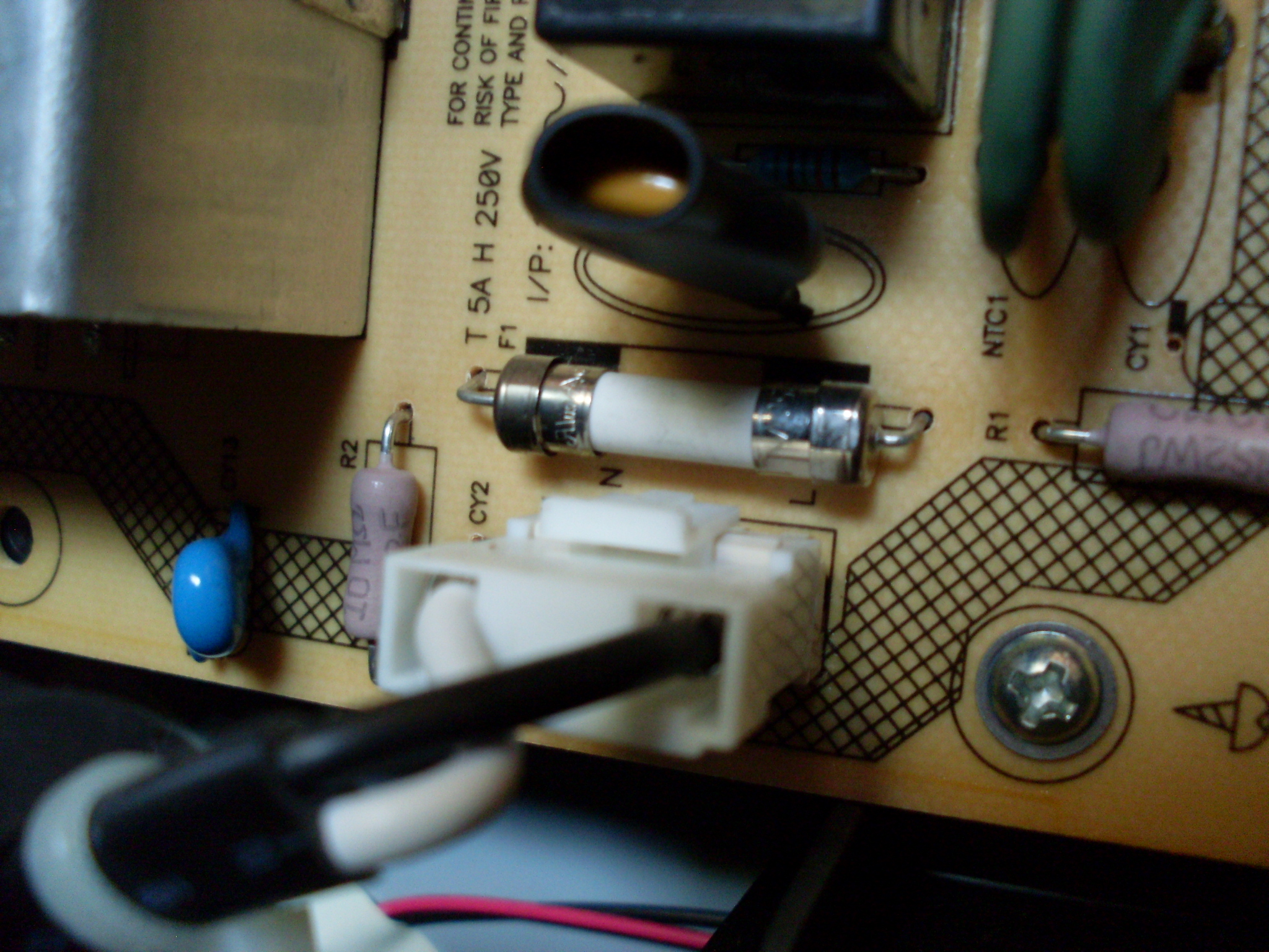

    Edit: After further research, it seems that the fuse near the power cord is the main fuse. It's soldered to the board (figures I'd get one without a fuse-holder) - is there a way to test it without removing it? Thanks.

    You can ohm the fuse with an ohmmeter. A voltmeter on ohm setting. Place probes on each side of the fuse. If good you will get a 0 or a beep. I believe this model is plagued with the inverter issue.

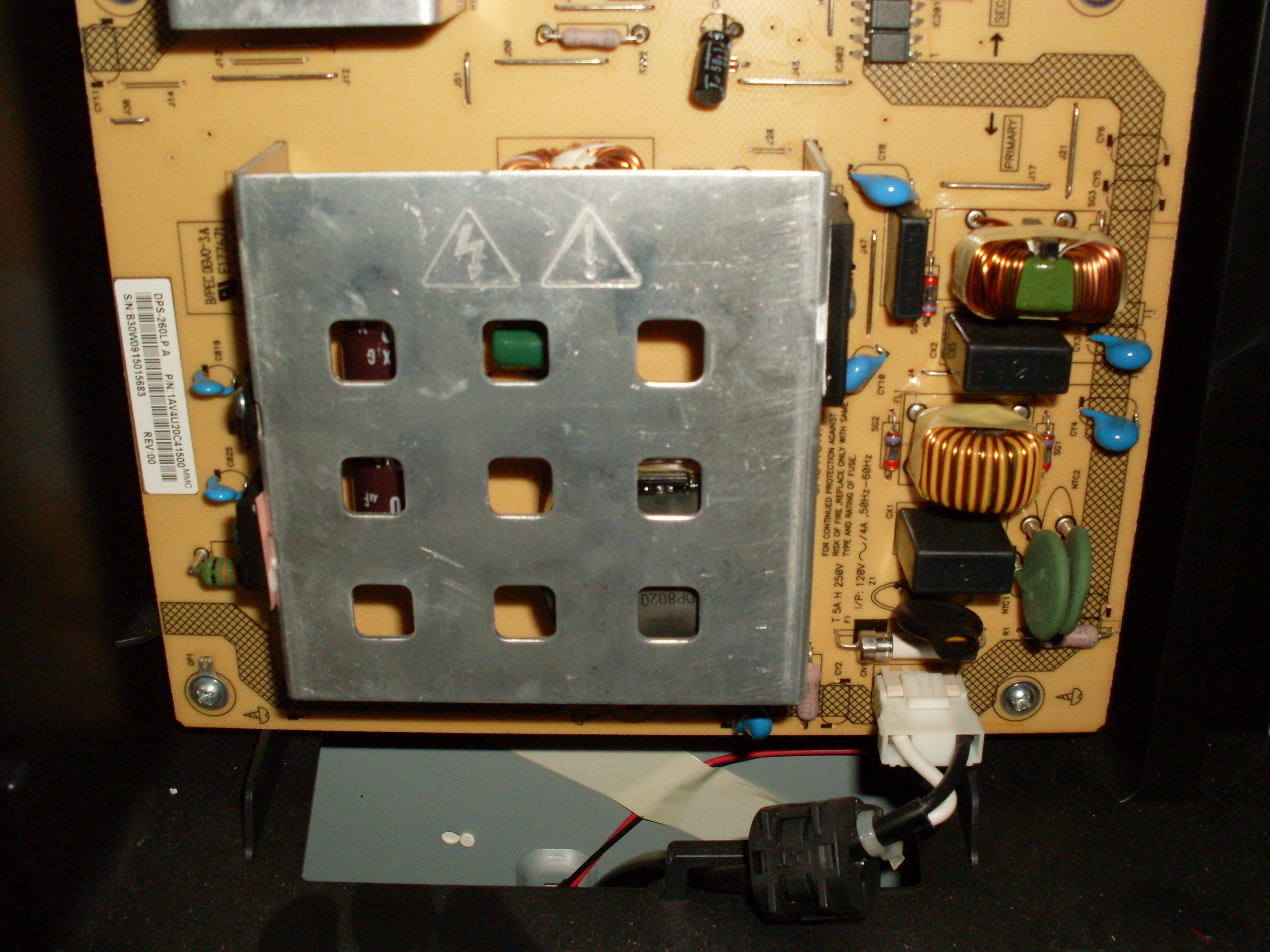

      if you are learning to use a multimeter,can you post up a pic ,so we can tell you what settings to put it on when we do testing?
      is this set completely dead?,nothing at all?,led ,sound,flash of backlights?
      power lead fuse checked?

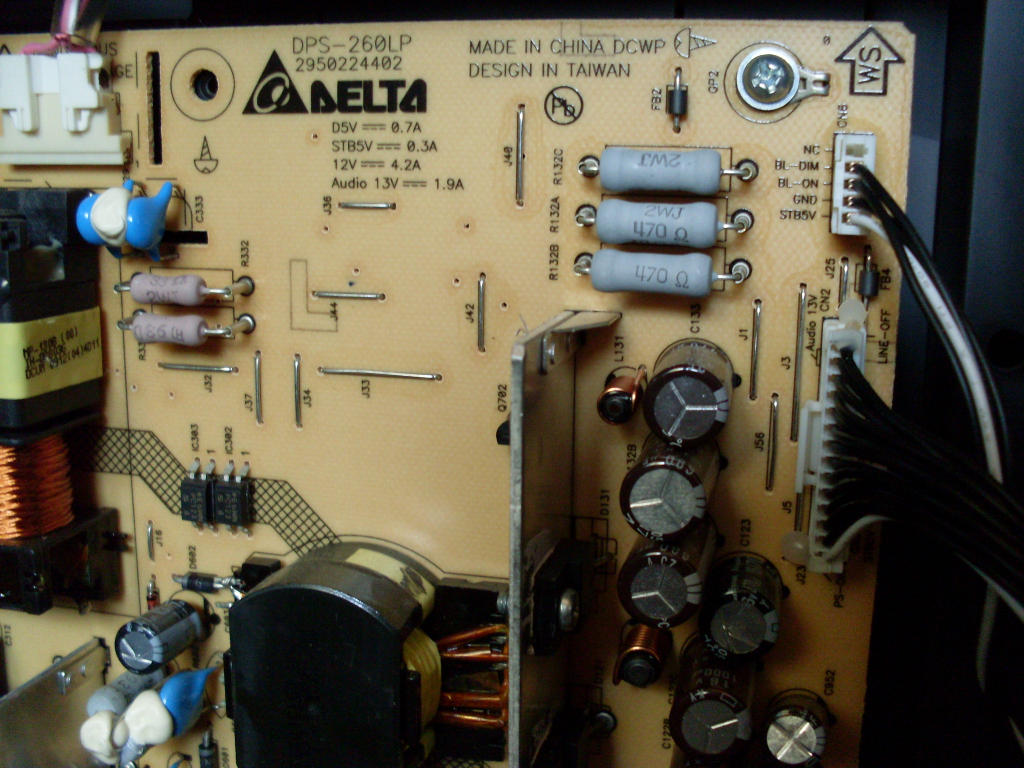

      also want a pic of the connectors going into the power supply,showing there voltage markings

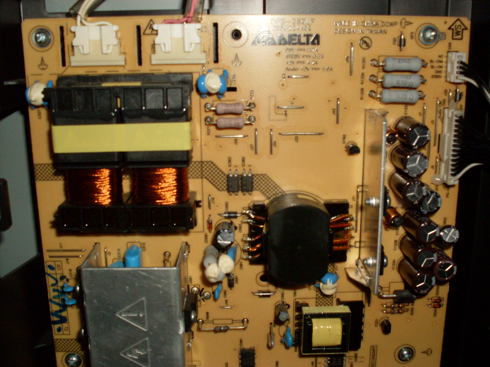

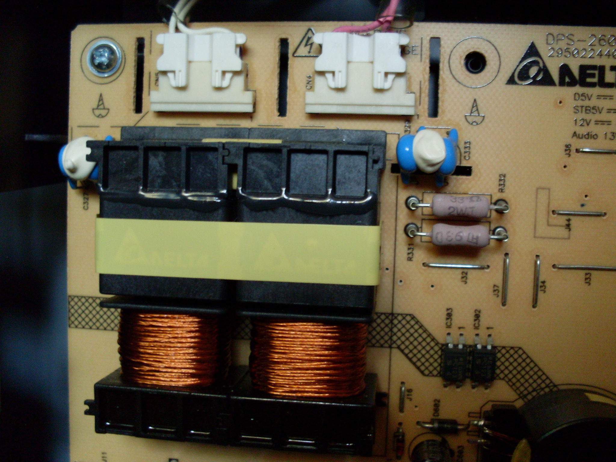

          That big transformer here:
          https://www.badcaps.net/forum/attach...7&d=1389934999
          seems to fail. (Inverter issue.)
          Try checking the power supply pins to see if you have any voltages.
          To check: meter on the 20V range, black probe on chassis, red probe poke into each pin where the wire meets, see if you get anything.

            yes but even if that transformer is damaged which does happen on this particular power supply usually the TV will still attempt to power up with a green light so yes do check fuses on the power supply first make sure that you're getting the proper AC input. Also on dc mode with voltmeter check 5v standby

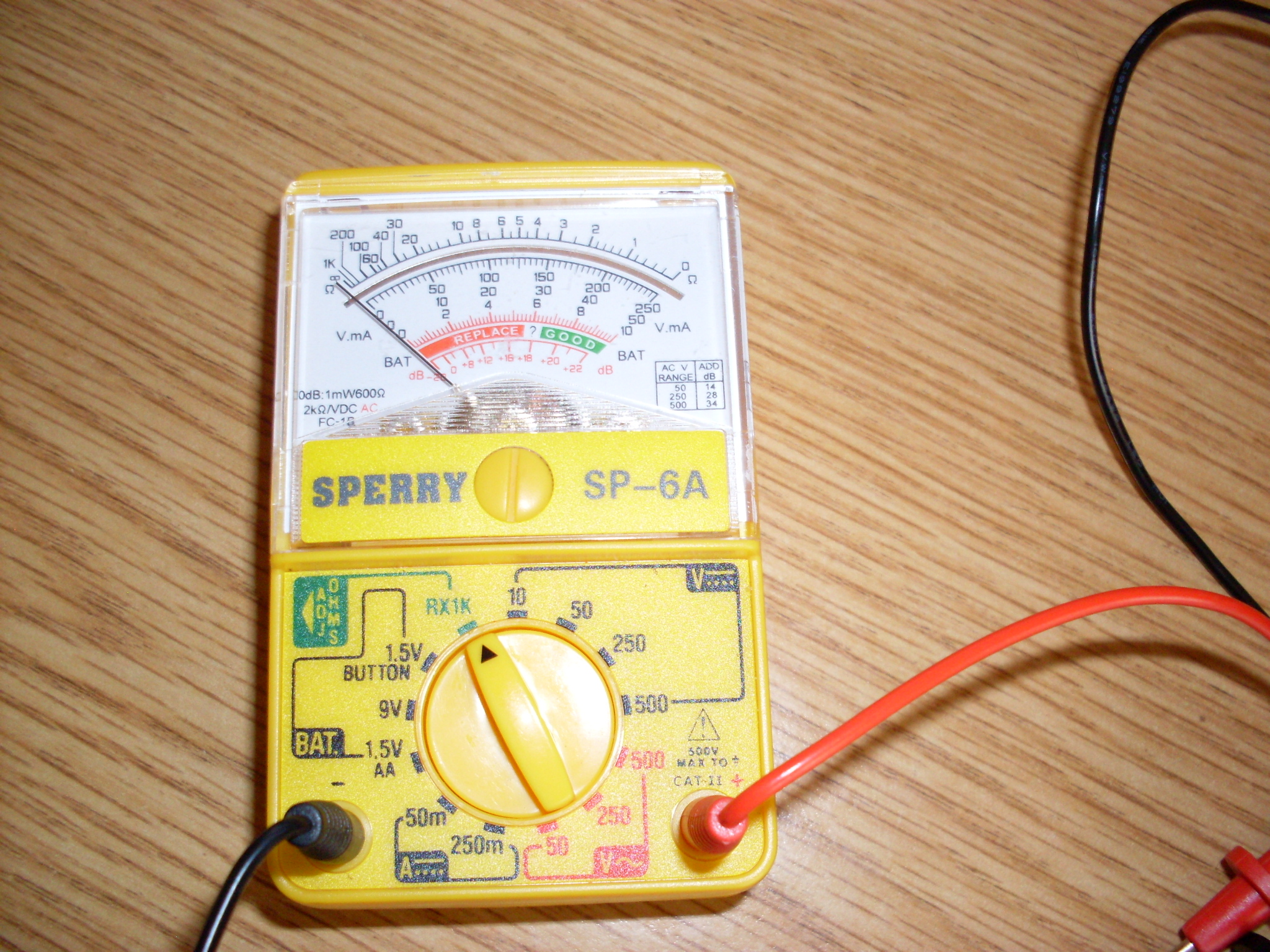

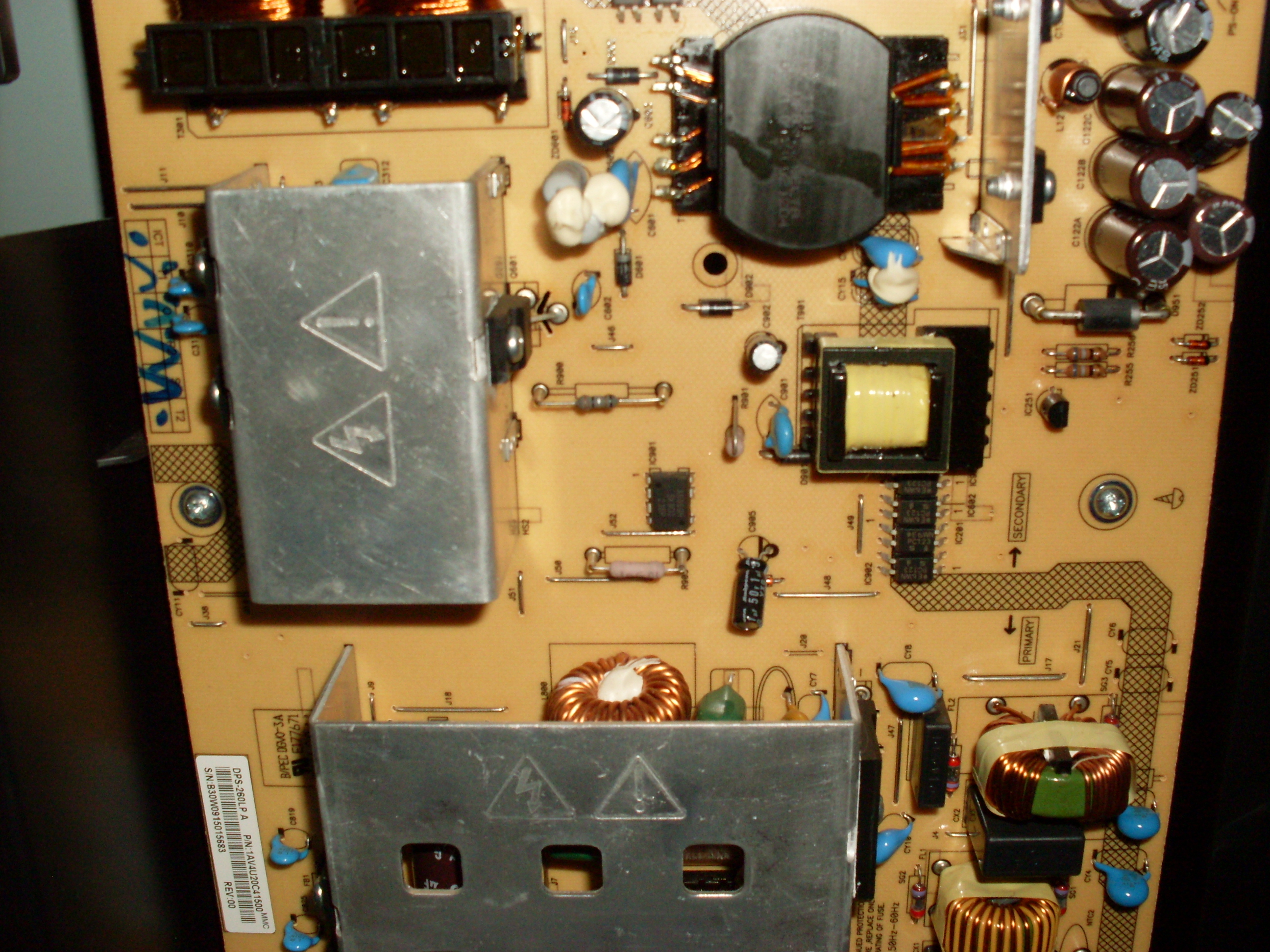

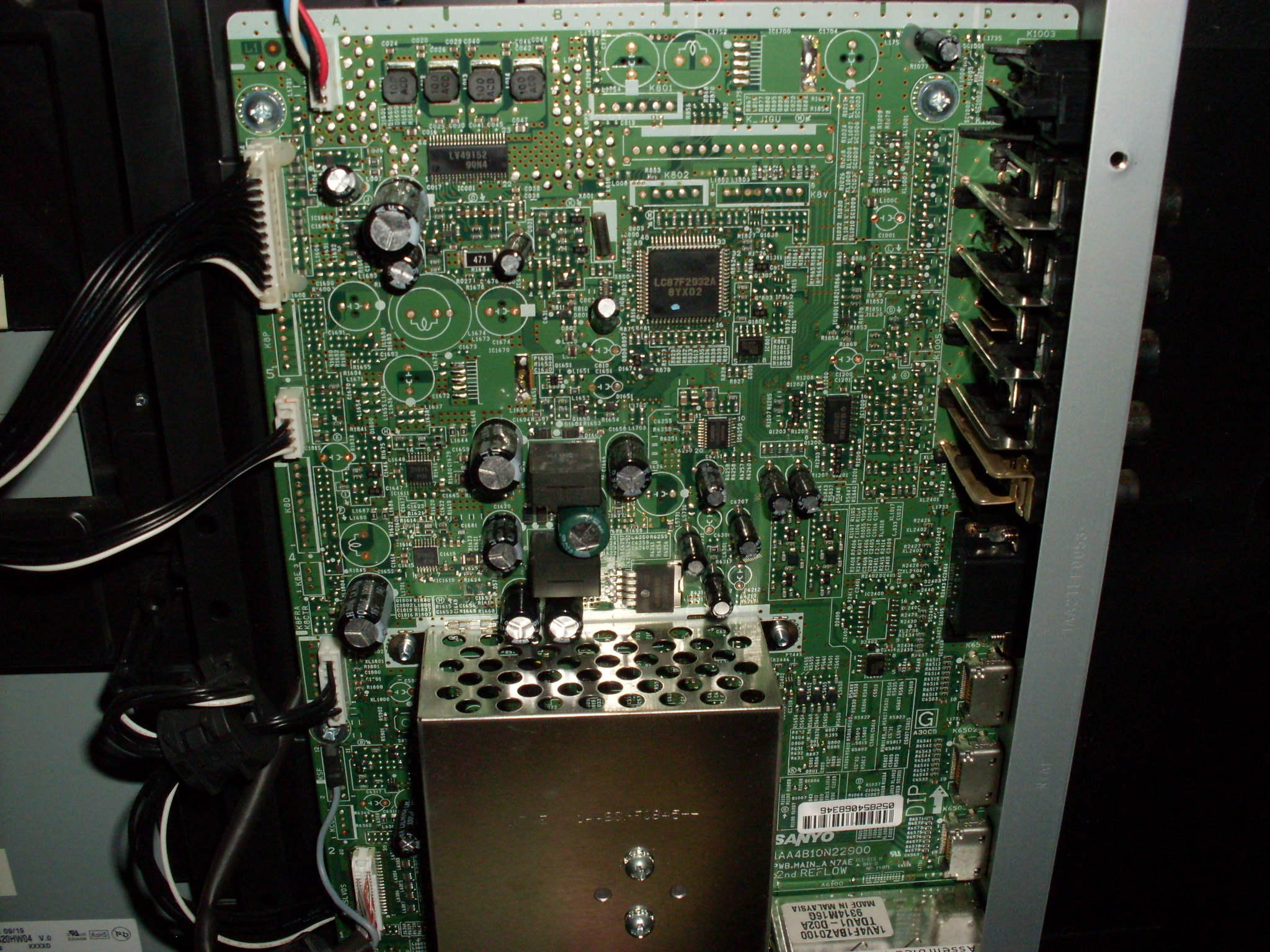

              Okay, so I tested the fuse and I didn't get zero. The needle stayed, if I'm reading this correctly, between 1 and 2 ohms? Or, about 3/4 of the way to the right of the scale.
              Here are more photos. I had natural light this time, so hopefully they came out a little better than with the flash. I can take more if I didn't do these right.

                Top scale used for ohms. Sadly that meter is woefully inadequate for TV repair. Maybe old CRTs it would do. On an LCD, 1 volt can make all the difference. Would highly advise upgrading to a digital multimeter, even a basic model, they start from around $10.

                  Tom, are you referring to that spider looking thing with the orange legs?
                  On my meter I don't have 20, but I have 50 in both alternating current and direct current.
                  Thank you.
                    Re: Sanyo DP42849 - No Power At All
                    Please see my above comment - your meter may not be sufficient to test this PSU.
                    The transformer is the yellow thing with big orange coils.... but that would not cause no standby power.

                        Fuse seems good - a second test would be to set your meter on 400 or 600vAC and carefully put the black probe on the mains negative input pin and probe each end of the fuse with the red probe

                            But yes the fuse seems good

                                Well, Amazon was nice enough to upgrade the shipping on my new DMM (I got this one), so it'll be here Monday. I'll be back.

                                  That's Good. When u get it check back with us. You need to look for 5vstby black probe on ground pin and red lead on 5v standby pin. Meter set on dc.

                                    if your new to this,christ sake be careful,you have combined inverter-psu,
                                    generating around 1200-1500vdc,if you touch the wrong thing ,it will hug you.
                                    can you put a pic of the meter up?so we know what were dealing with
                                    your going to be doing dead testing and live testing
