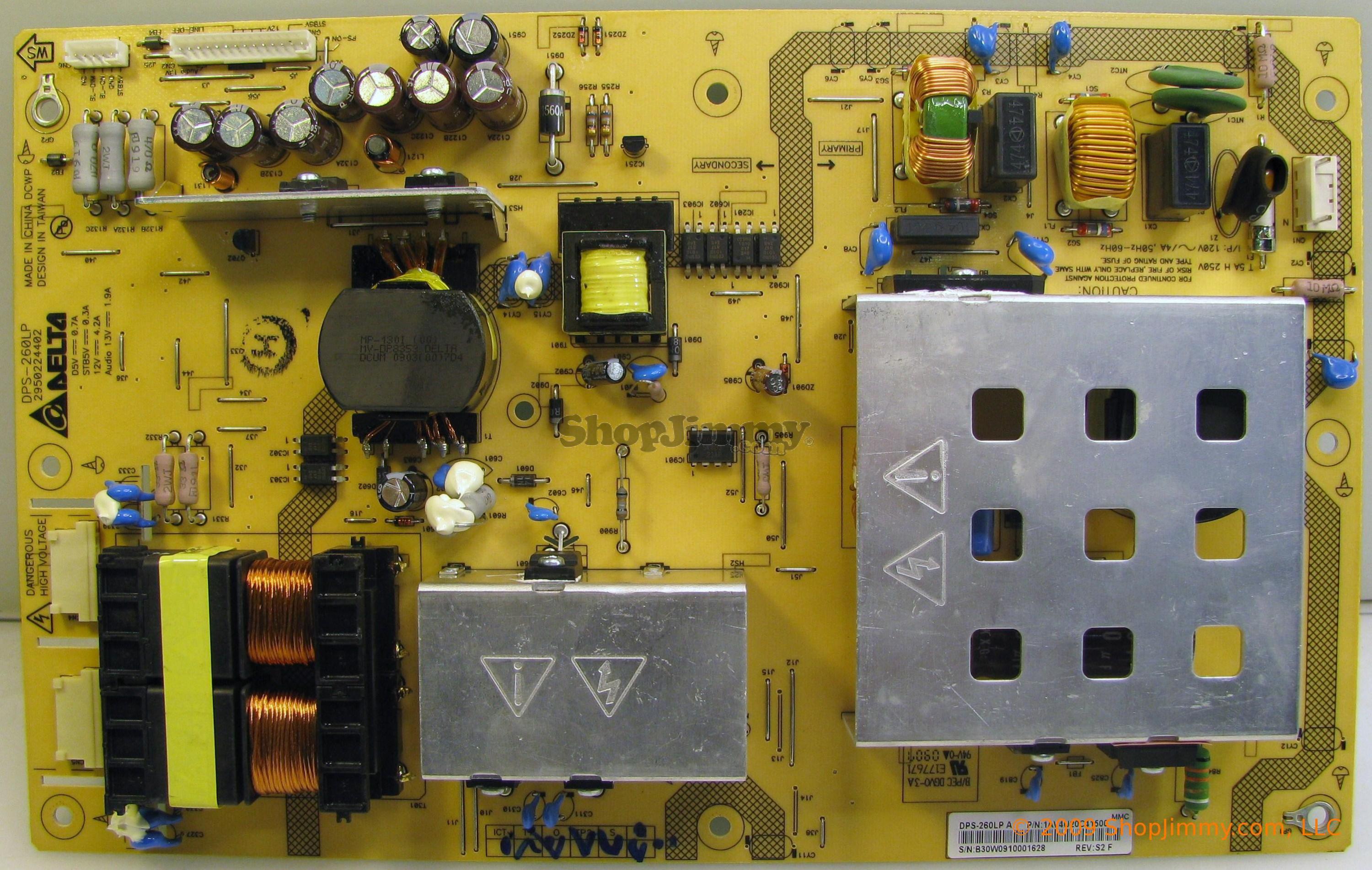

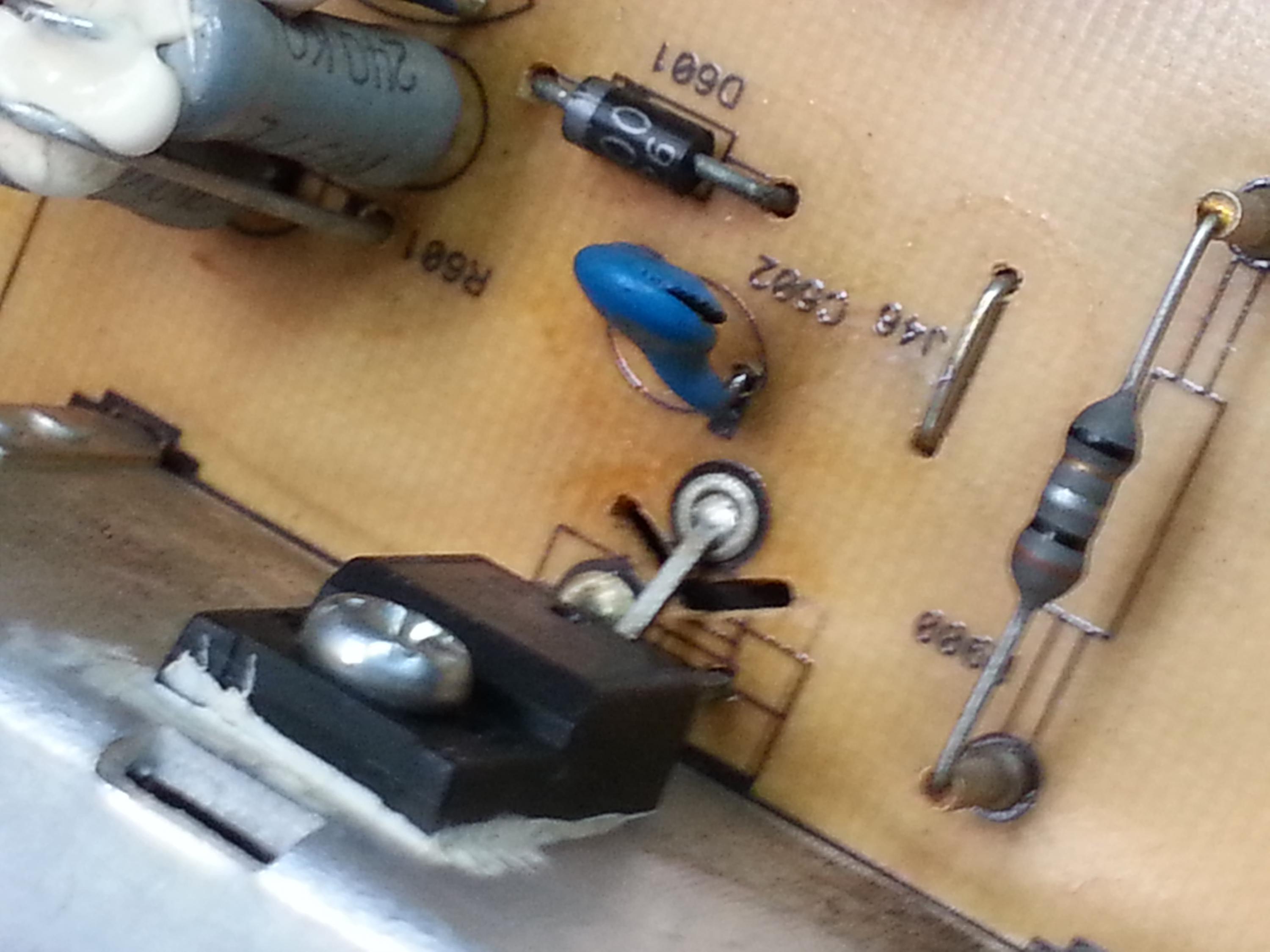

              ok...have a Sanyo Dp42849 with no power at all. no 5 volt standby voltage. found C602 cracked. I am going to order a replacement. Question is do you think this is the reason I have no 5 volts stby?
                #407
                Re: Sanyo DP42849 - No Power At All

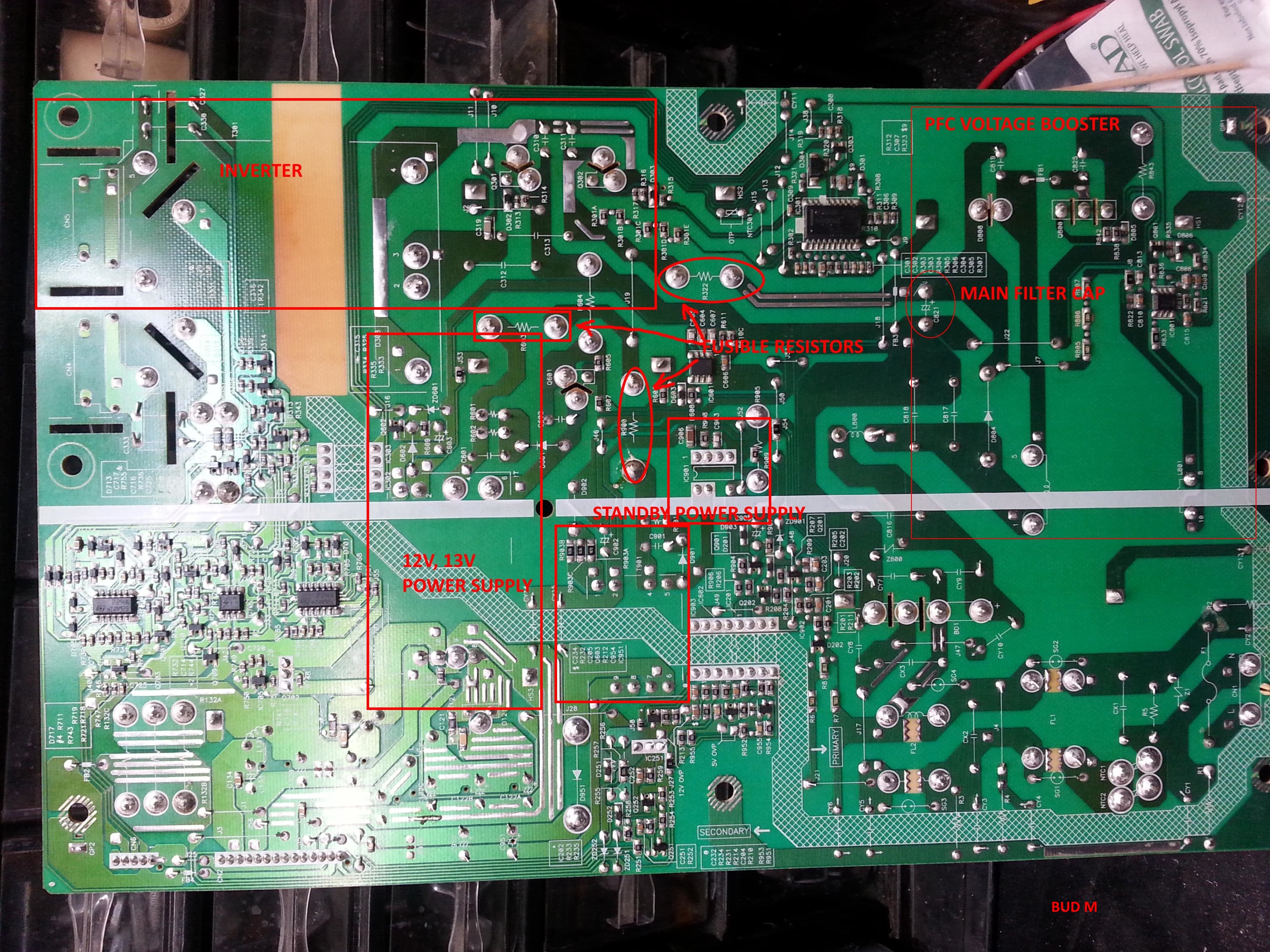

                Standby 5V power supply section is one with 7-pin IC901 and transformer T901, not that section that you show.
                MOSFET Q601, snubber cap C602, and T1 are another power supply for 12V, and 13V.
                DELTA DPS-260LP power supply-inverter board.
                Do you have DCV on the main filter cap? Fusible resistors are OK?
                Picture provided by shopjimmy.
                http://www.shopjimmy.com/power-suppl...yo-dp42849.htm

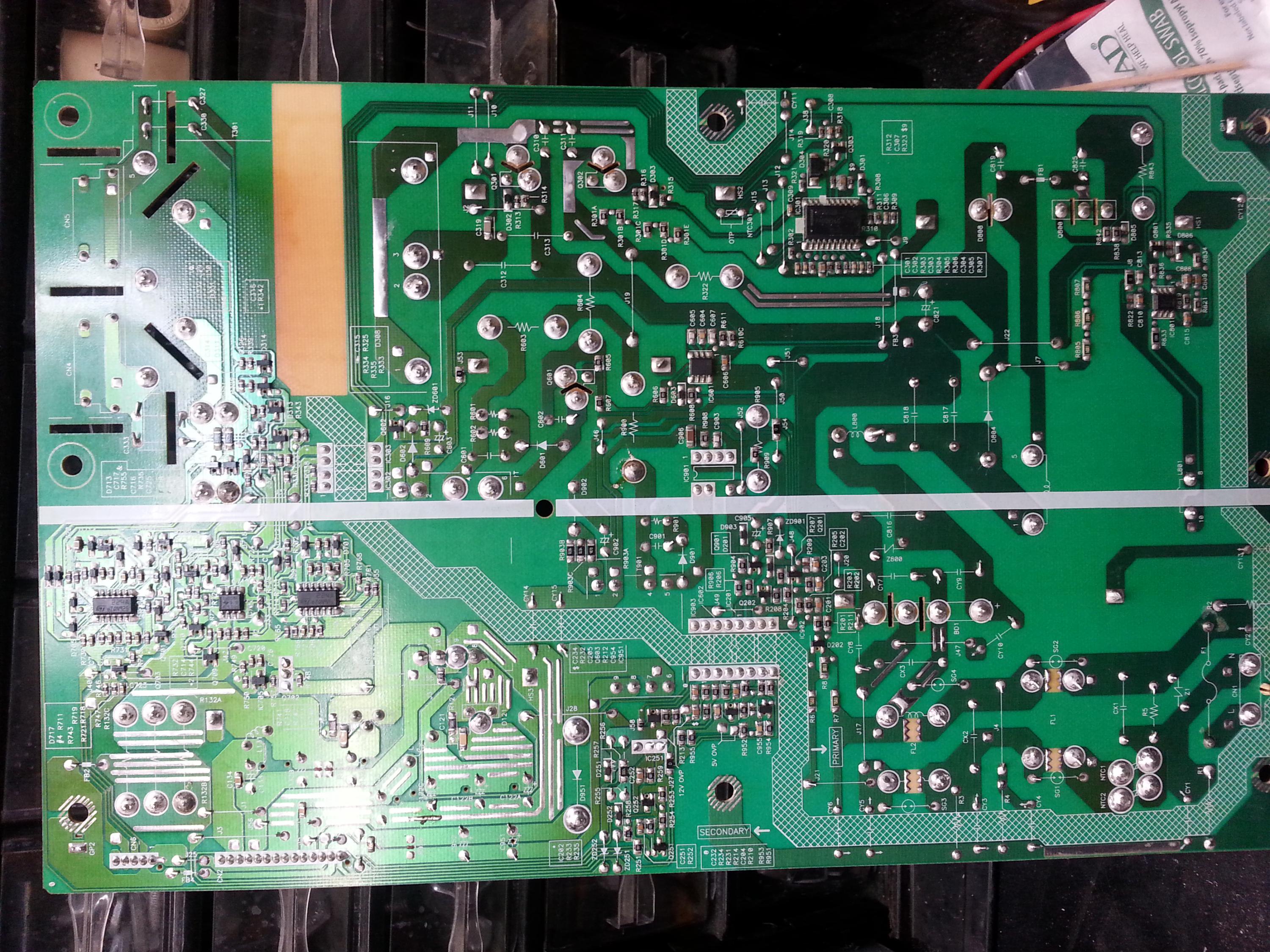

                    #409
                    Originally posted by jomede
                    Main filter cap under the heat sink plate? not sure where you mean.
                    Yes, it is under the big heatsink.
                    Please upload good clear pictures of the whole bottom side of the board, SJ does not have the picture of the bottom side.

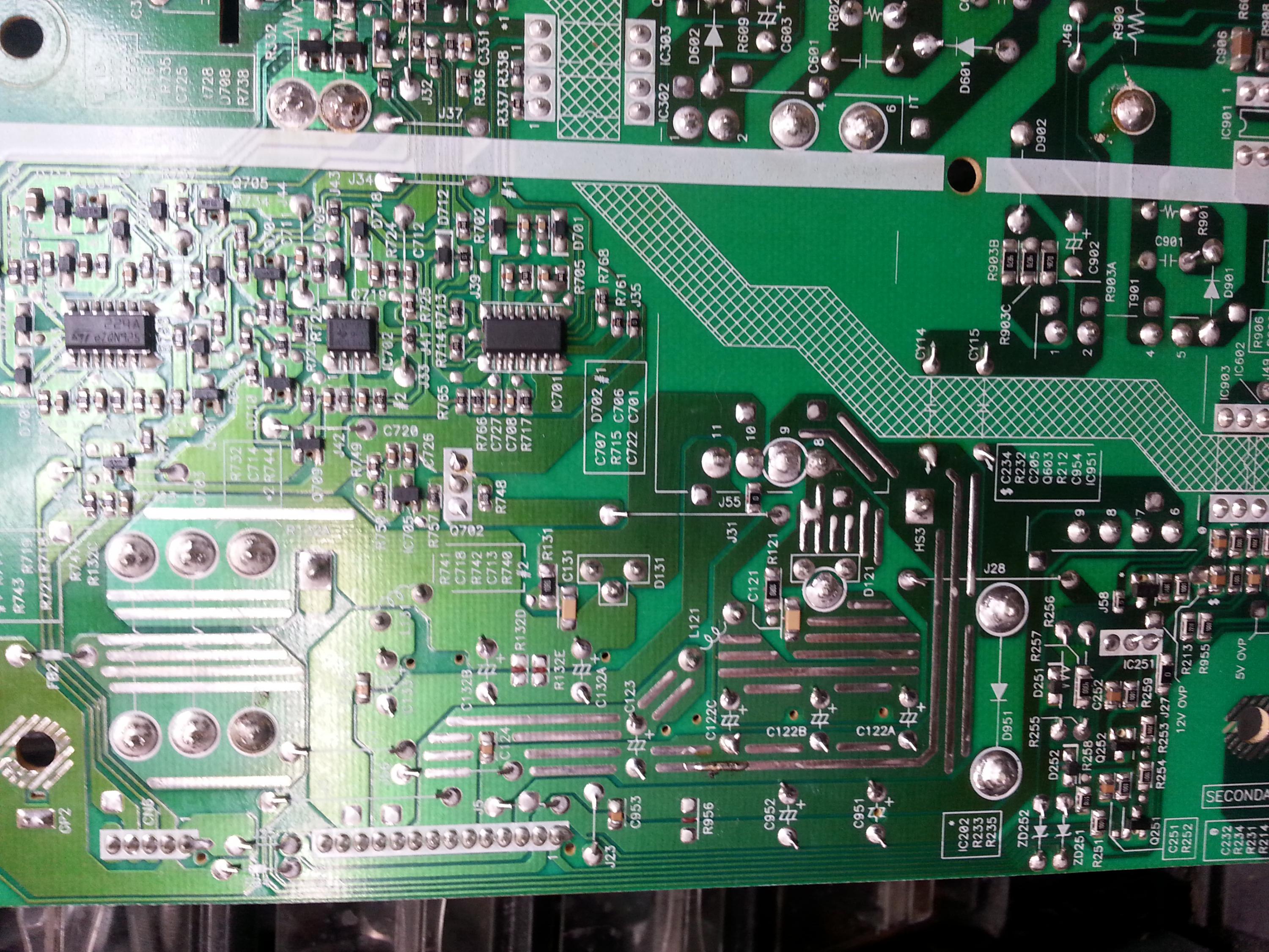

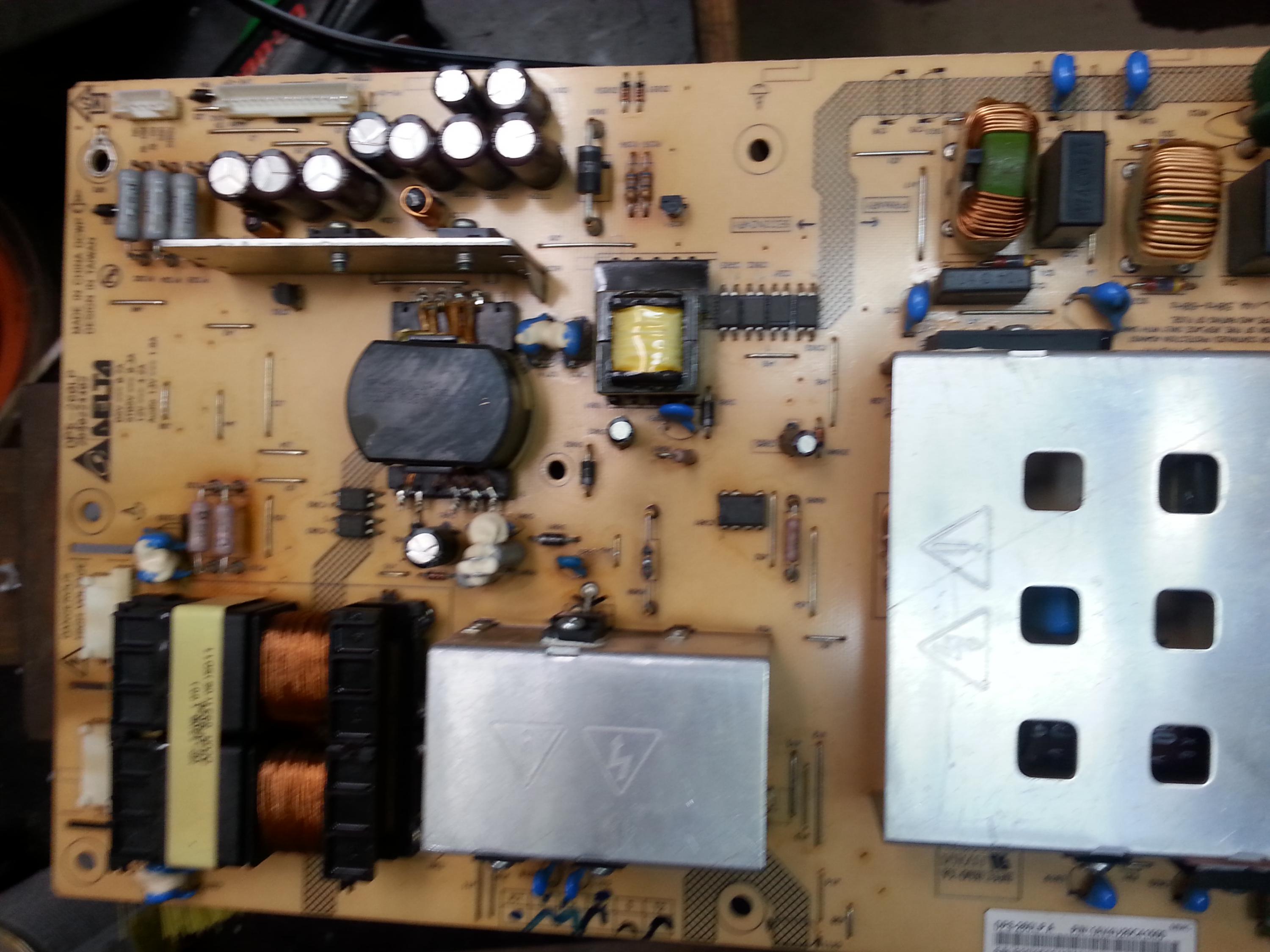

                      #410
                      here are the photos of the back side
                        #411
                        OK, check the resistance of those 3 Fusible resistors first to see if they are OK, they should be <1 Ohms or so. if they are OK, then check the DCV between the two legs of the main filter cap, you MUST be real careful because you are working in the hot side of the circuits, you should at least plug the board into GFCI outlet.
