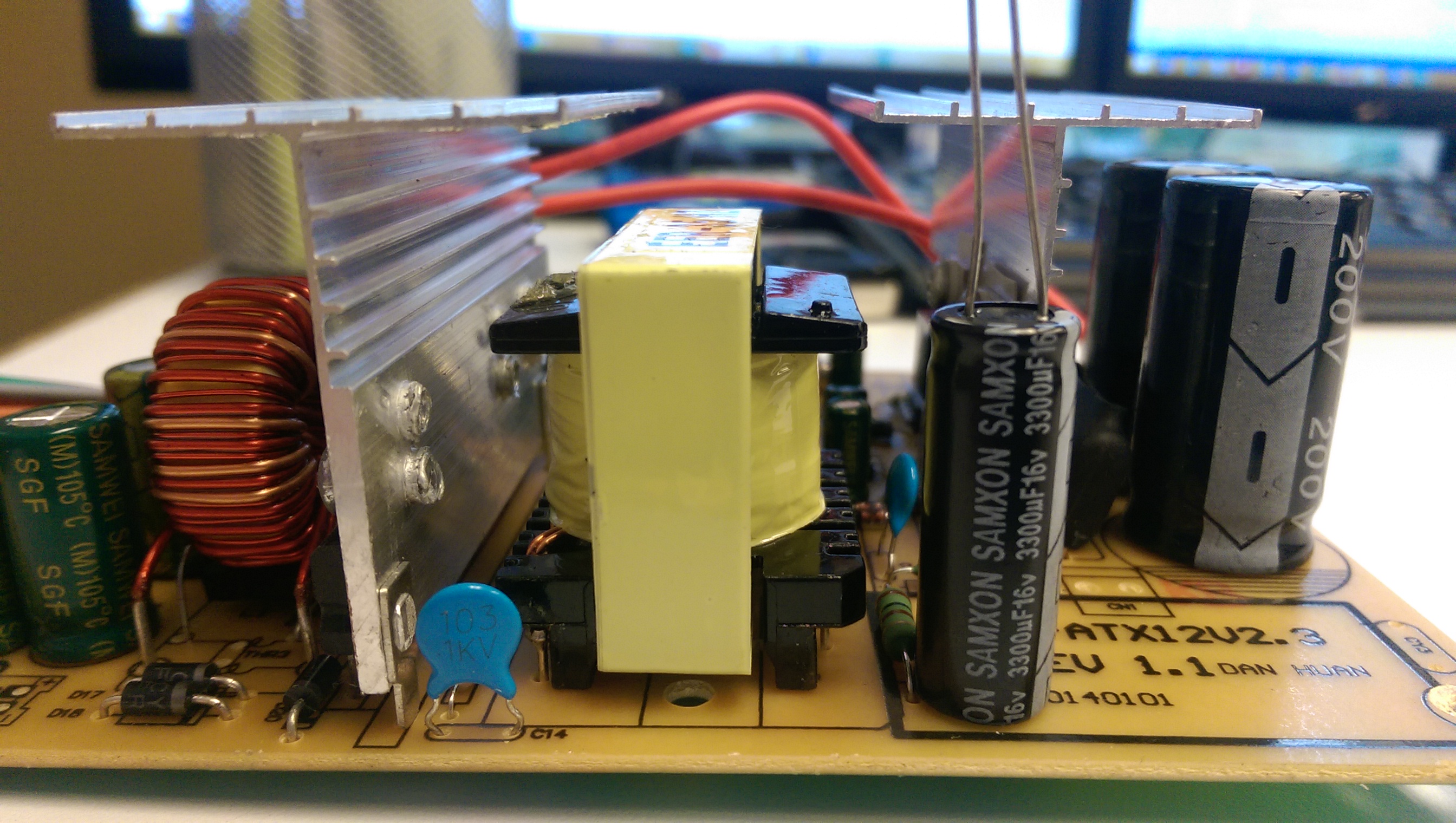

          Originally posted by Pentium4
          Oh boy, what a shame with this one. It had potential! ... but my main gripe is probably easy to guess...the output filtering! Where is it?
          Yes, shame indeed. Those extruded and cut heatsinks are rather good. Probably could do 300W continuous no problem. The rectifiers are good too. Would easily power a modern low or mid-end PCl, because the 12V rail has potential (wait, that's a pun! ).
          That said, you could still easily make it a usable PSU again. Since there is only a single cap for the 12V and 5V rails, looks like you have a lot of space there. Maybe change those caps with 12.5 mm ones? That gives you the option to put a 3300 uF 16V cap on the 12V rail and a 3300 uF or 4700 uF on the 5V rail. The 3.3V, of course, should be more than happy with two 2200 uF caps (and if the PSU won't be powering a power-hungry motherboard, you could probably go as low as two 1500 uF caps).
          As behemoth suggested, though, I too wouldn't recommend you put big filter caps on the 12V rail where the fan connectors are. With the long traces going to those connectors, you may introduce undesirable noise in other nearby traces, and that may or may not cause problem.
          First time I have ever seen a 5VSB filter not have a coil!
          Those coils on the 5VSB probably don't make a overly-huge difference in suppressing output ripple anyways. But I'm sure it helps with the ripple current on the caps, though.
          Looks like you could install one. The jumper in position L4 (or is it J9?... or J10?) right next to the output caps could be replaced with a coil.
          ... or H.Q. (which does not stand for High Quality )
          More likely, it stands for Horrible Quality

            Well, you can put 3300uF 16V caps in D10 there as well, the Samxon RS, soon also NCC KZN…in D12,5 I think you can get as high as 3900 or 4700 uF in 16 V.
              I have Panasonic FR 4700uF 16V D12.5mm but that might be too low for the PSU? ESR for that cap is 0.012Ω
              • Behemot
                • 4845
                • CZ
                • Computers, reading, dancing…
                #1007
                Re: the gutless, bloated, and fried power supply hall of shame
                Just try. As there is no Pi filter, who knows, it can probably handle a lot…
