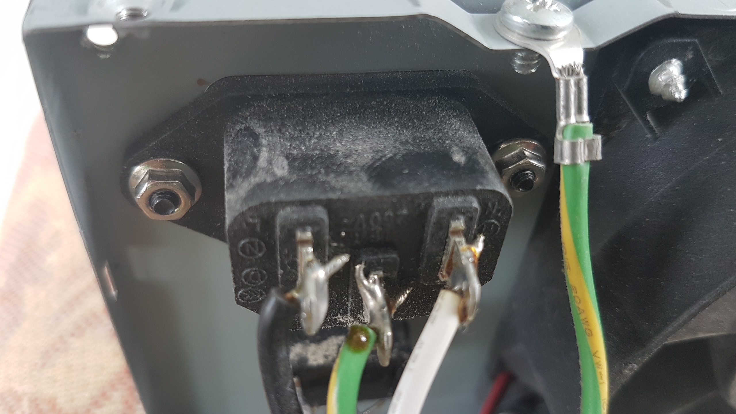

      Check this hot garbage.
      "Torrent Computers" LC-8400BTX, "400W". Erm...for how many picoseconds?
      Then... 2 12v rails? Yeah, right. I'd want to see them on the PCB.
      Cracking it open reveals a sad joke of a PSU. The AC receptacle looks interesting though, in the way it's mounted. Also, the casing is now given a much more updated look from the boring lines present on other Deers! Dunno why they cheaped on two screws, but that's L&C for you.
      Also, fake PI coil spots! The only one that ACTUALLY connects something is for the 12v rail. Guess this would be a worthy opponent for the mighty Google "RAM eater" Chrome?
      I'll probably just save the casing, fan, heatsinks and sillicon, then just junk the rest. Maybe save some of the wiring, since it seems it came with a SATA connector.

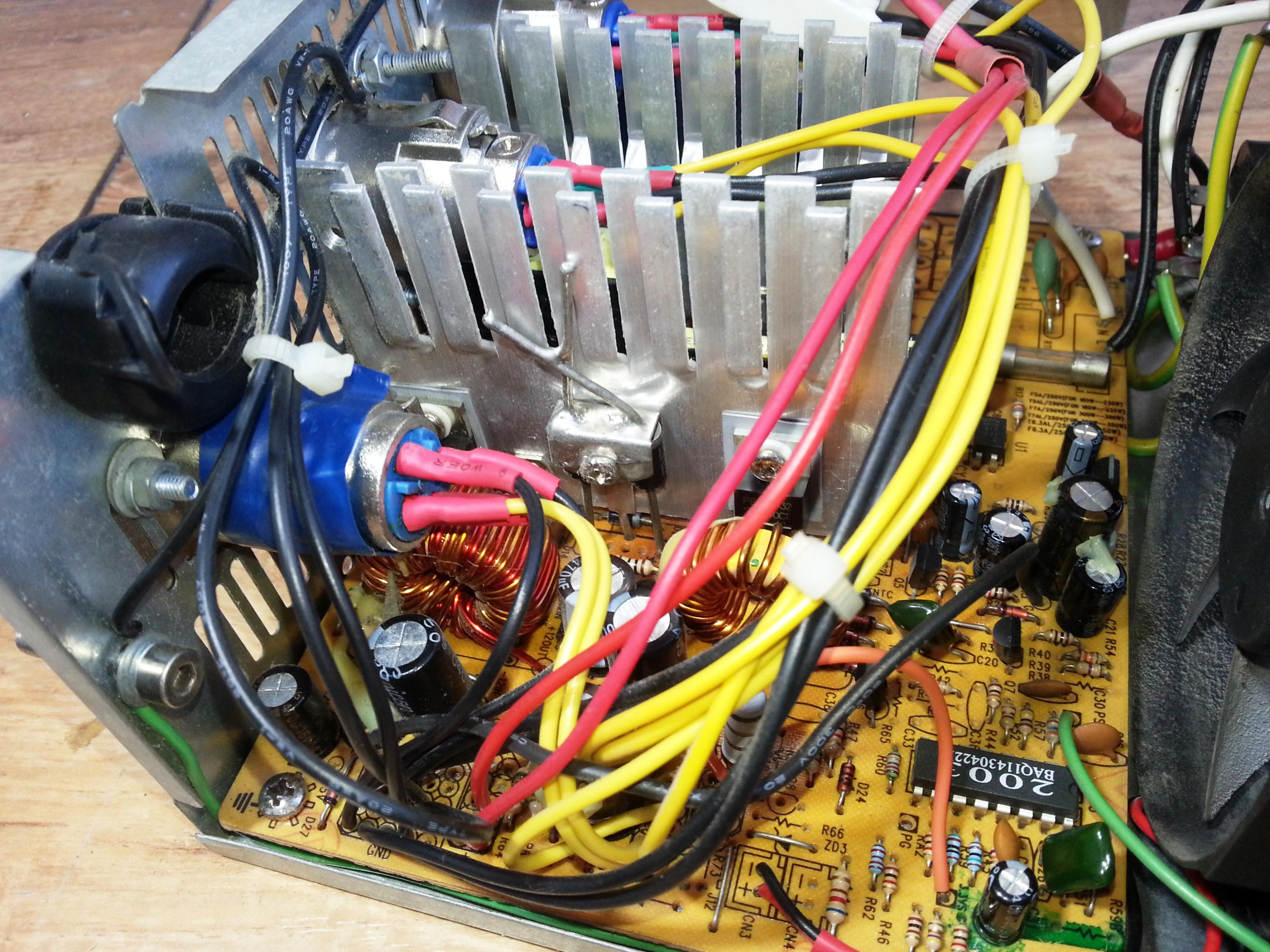

              Re: the gutless, bloated, and fried power supply hall of shame
              Originally posted by Agent24
              WTF? That PSU just doesn't make any sense. Barely one capacitor per rail, and yet they bothered with line filtering? Why?
              Come to think of it, this stupid design was introduced by them as early as 2005. I have 2 more units with the same PCB and same silkscreens.
              And if you haven't noticed, the PI coils for 3.3, GND and 5v are bypassed altogether on the underside Ironically, the only one that actually works as intended is the 12v one.
              Interestingly, the same design was actually fixed in a Allied PSU I have from the same era - same PCB design as above but they finally bothered to fully make the PI coils work, along with adding all caps. (I had to recap it, obviously, because they were your usual Yang Chun crapcaps)

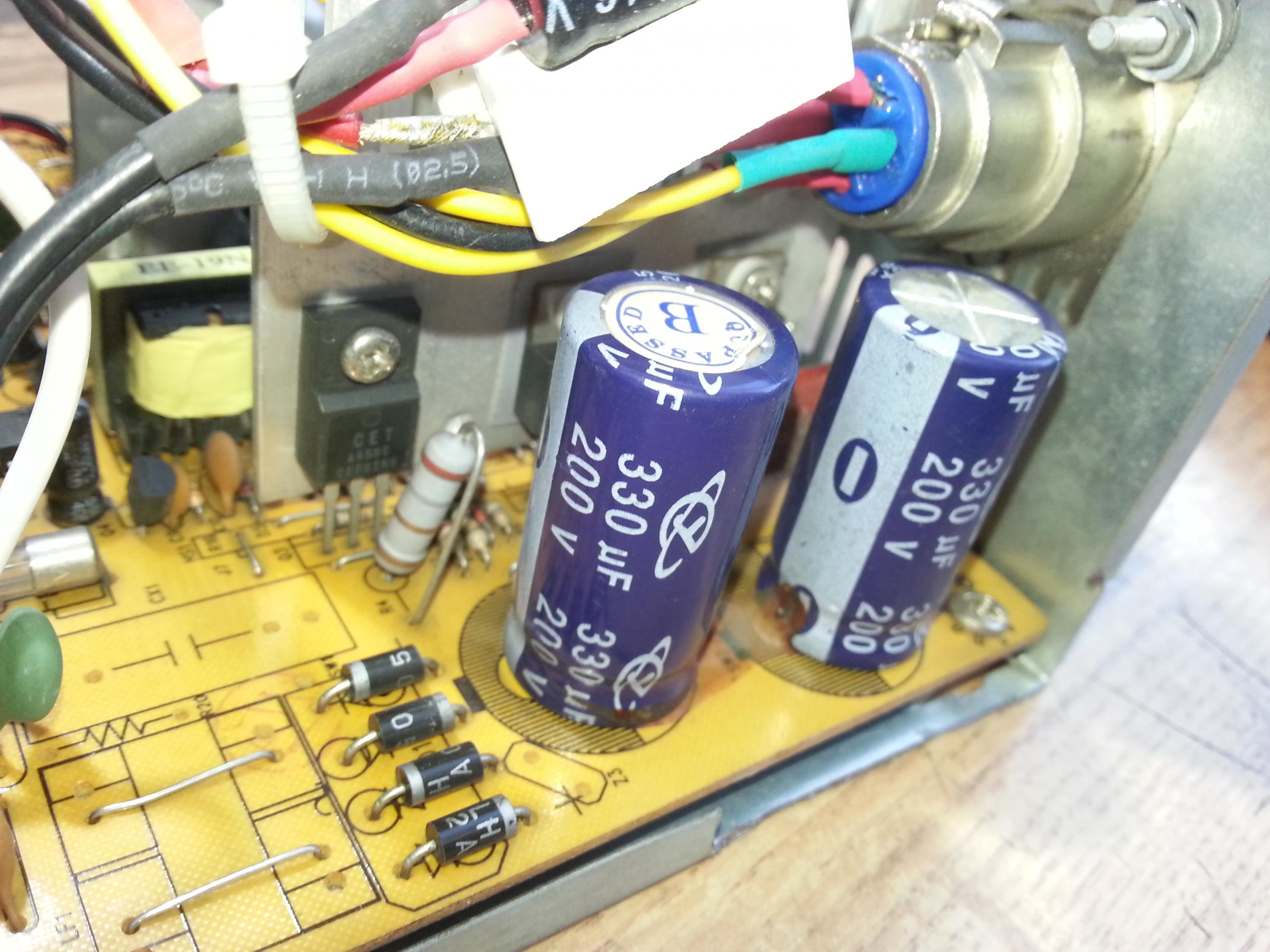

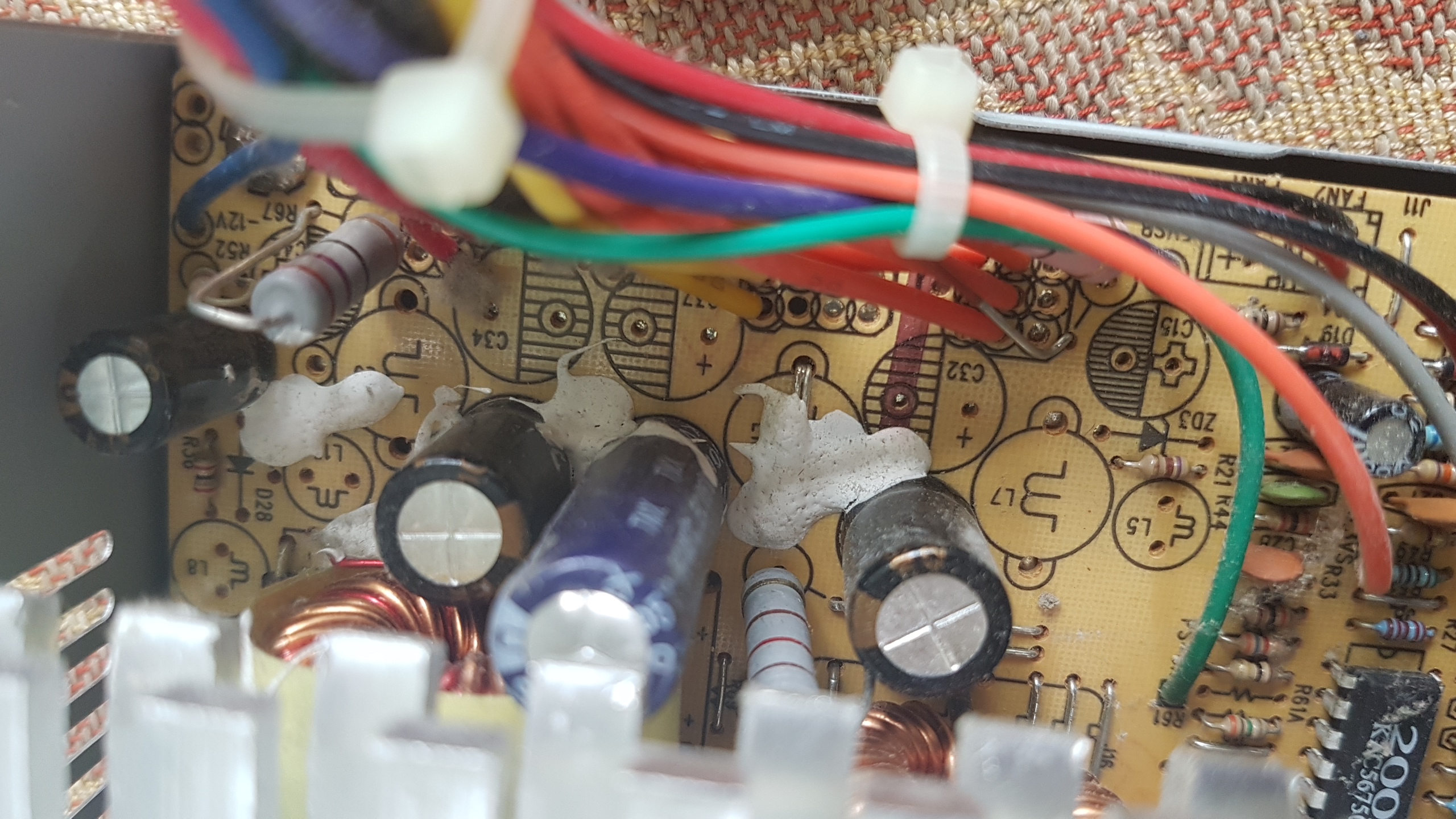

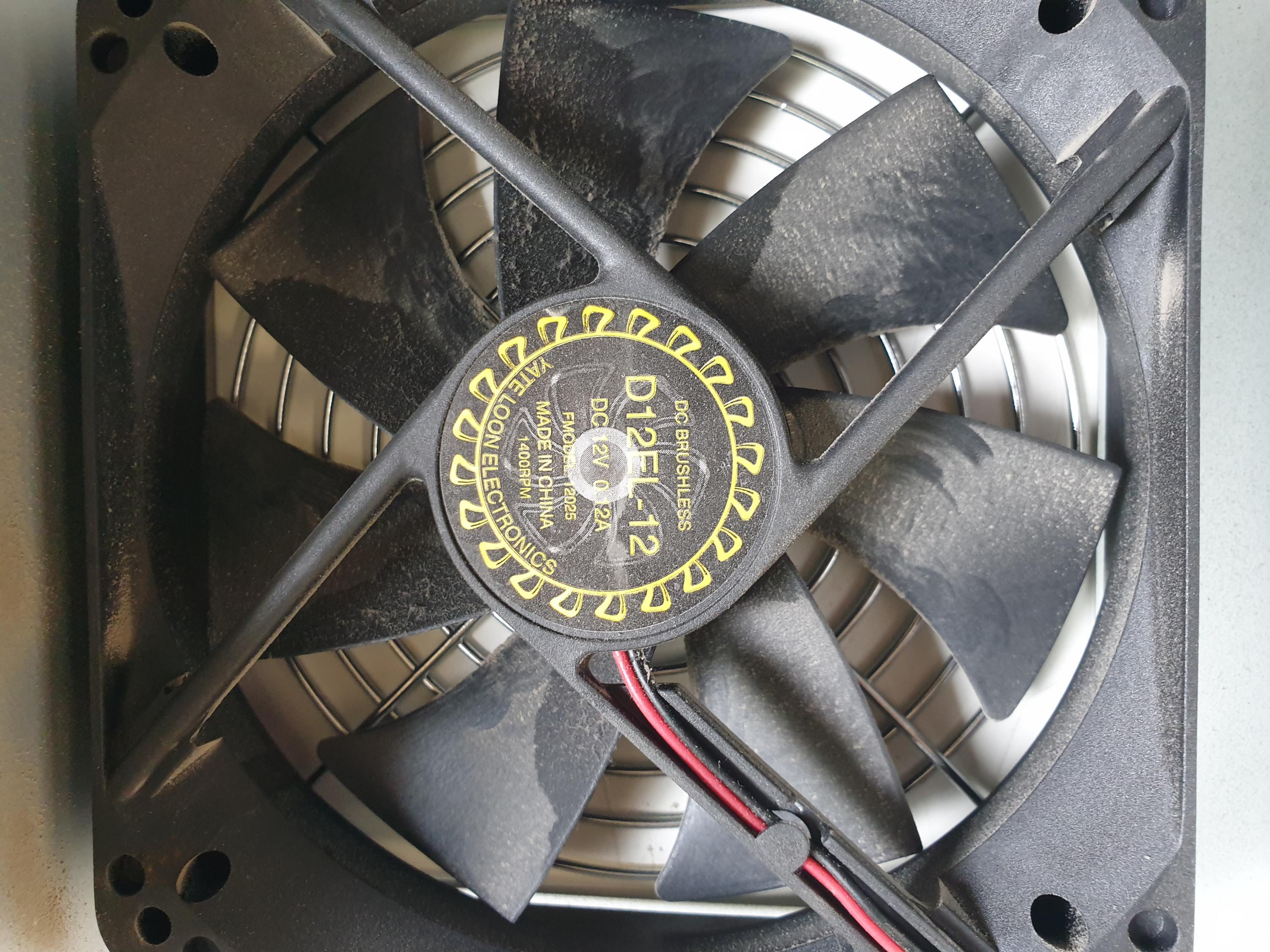

                I bring photos of this terrible PSU "500 watts", and as an extra the fan they tried to fix.
                Although the fault was not caused by bad capacitors, but because the 230v switch was moved to 115v, the last capacitor exploded (the switch bridges the second capacitor in the series).
                The PSU is terrible, thin heatsinks, very small filter winding, small transformer, few capacitors to filter the secondary line, no Y-capacitors, no filters for PFC xDD.
                Most terrible, the wiring voltage switch does not carry any insulating protection, and for more, the cable ends are very close to the psu chassis.
                And the SCHOTTKY diodes are rated 20A according to their datasheet, and there are only 2, so that those 500w are a lie xD.
                What seems curious to me is that these kingcon capacitors on the secondary rail have the same ventilation design as suncon xD.
                When the client brought me the computer to fix it, he told me that the heatsink fan was not working, and when I started to diagnose it, I found the heatsink of the cpu loose, the fan cables cut off, I removed processor from the motherboard to proceed to turn on the computer without burning the CPU, I put the cables in their fan place, plug the fan and it does not turn (what the owner burned when putting the cables wrong) (the computer turned on but did not give video and the dvd reader and the HDD made strange noises) and I also hear sparks inside the PSU due to an electric leak in the exploded capacitor, I change the PSU for a new one, put the CPU in its place, put a new heatsink and it worked again.
                The source was creating a terrible ripple in the electric rails, preventing the computer from turning on, and since the owner of the computer did not know that this was the cause, he tried to take out the cpu, in the process he broke the fan.
                This PSU is the second of my personal list of the most dangerous PSUs that I found (the first is an AT PSU that has huge holes that contact the primary).
                That's why always, you must buy quality PSU and recognized brands.
                        What a gut-free POS! The best thing that could be said for it is that they didn't substitute GP ceramic caps for Y-caps. They didn't install anything for Y-caps. And while the MJE13007 clones and the size of the output transformer preclude drawing 500W from the thing, those 330uF input caps pretty well limit it to somewhere in the 150W-200W range (unless you like lots of 100Hz ripple on the outputs before the PSU launches). And that pathetic POS was made in early 2013! It looks like someone recycled a warehouse-full of dusty 200W PSUs, blew off the dust, and slapped 500W labels on them.
                        Literally, that PSU is a junk xD.
                        You are right, 330 microfarads do not give a stable line to the switch. coincidentally, a few days ago I published some photos of an Emac manufactured by Zippy, it has 2 capacitors of 680 microfarad 200v of the Rubycon brand, and that PSU really delivers 250W, what a difference from a manufacturer who knows how to manufacture PSU, compared to a manufacturer that makes garbage.
                        https://www.badcaps.net/forum/showpo...postcount=3043
                        That source will have come out of some stock stored years ago, as you say. it seems incredible that sources with designs as old as that are sold.
                          470uF would probably be OK for 250W, for ripple and for hold-up time, but better than necessary is a good thing.

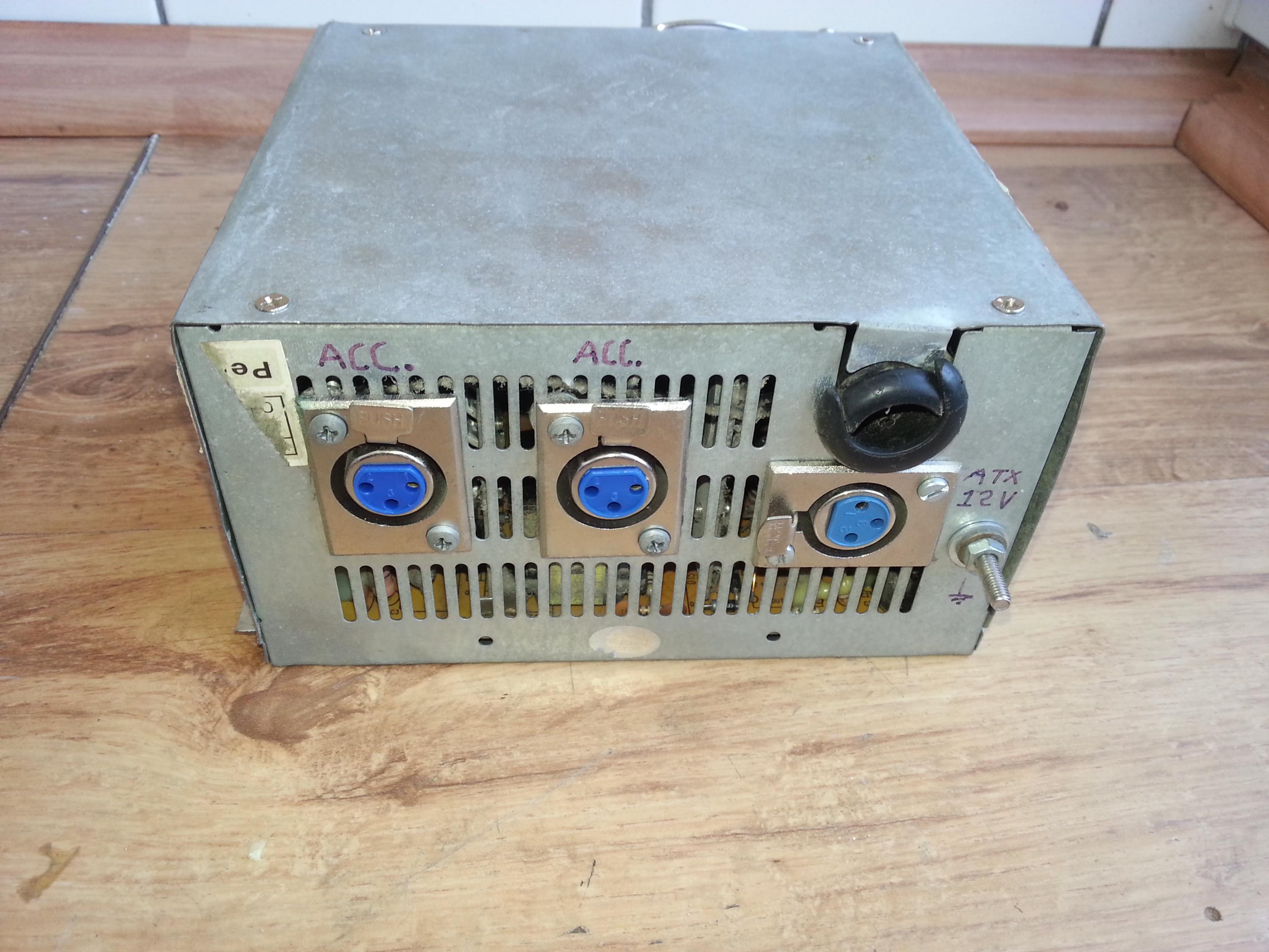

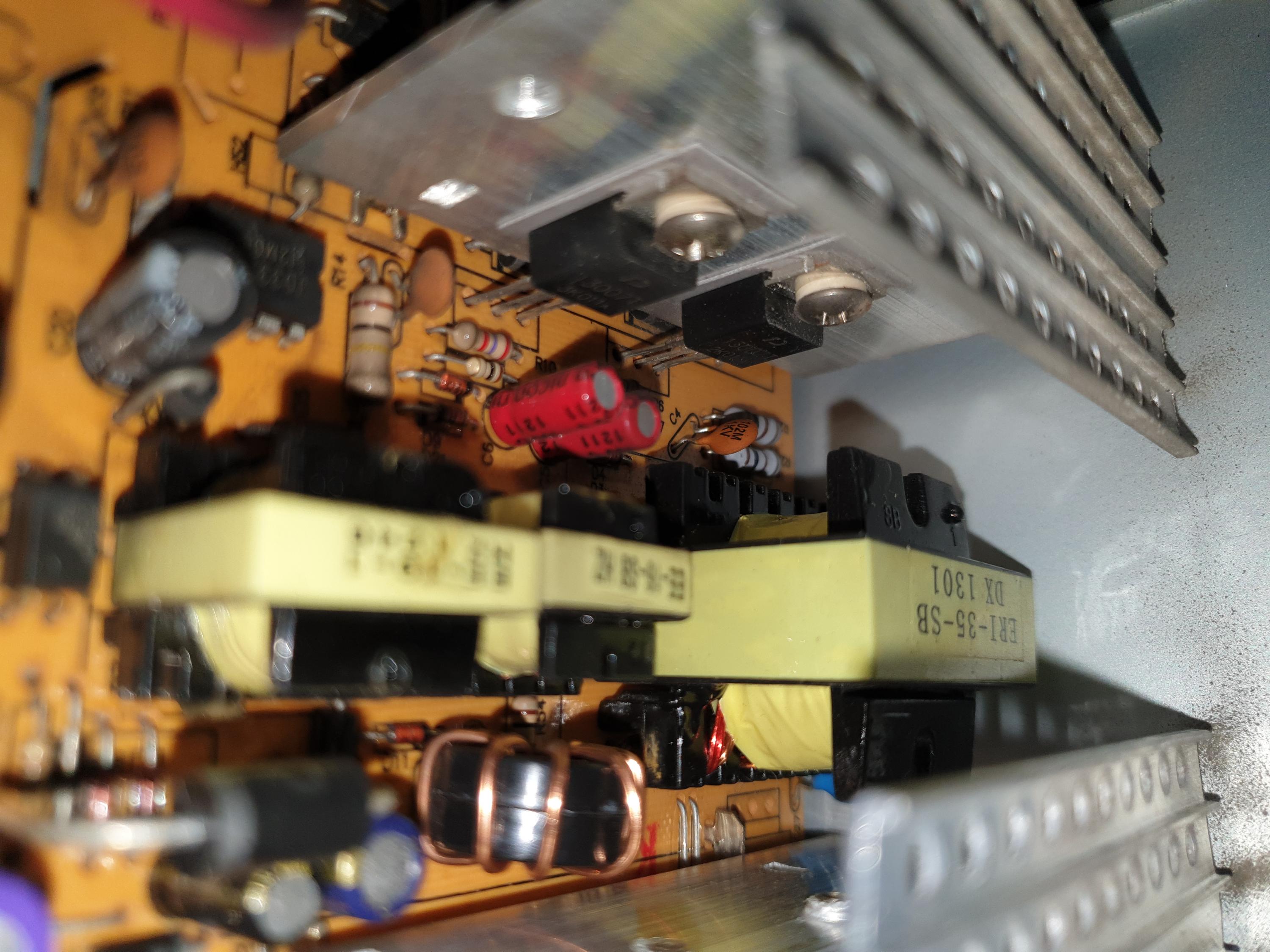

                            Here's one I got I had this 400w "Premier" in my PC when I was just a snot-nosed kid years ago. It came stock with the case of course. When I upgraded, I kept it around to power different stuff. I botched the heck out of it over the years, adding XLR jacks and removing the 20P connector to make it "modular". Look at that "custom" case work - state of the art, isn't it ? (I wrote my full name on the side there for some reason, so I had to censor that out...used to do that a lot when I was a kid - personal possession complex or something...I dunno ) It ended up running a PC in my closet for a while (hence the case mod...can't remember what the F** I did to it), then it died a couple of times, I revived it, botched it some more and ended up powering some RGB LED strips I have in my balconies. That thing went through hell and back and would refuse to die for good. It kept coming back one way or another
                            The eagle-eyed may notice that cap+resistor job sort-of randomly thrown in there - that was a hack of mine to get it to stay on It would no longer stay on by itself (would make a terrible screeching sound and shut off after a few seconds), so after some experimenting on the bench, I convinced it to run with that cap+resistor combo between the 5V rail and GND...I have no idea what the heck happened there - it was years and years ago when I was just getting started with electronics and would do stuff like THAT I think it's losing its regulation and one of the rails is overshooting, so it's tripping the protection. From what I know, in these cheap generic supplies only the 5v rail is actively regulated (only one photocoupler), with the 12v rail relying only on the 5v rail's regulation to stay in check as well and the 3.3v rail being mag-amp generated from the 5v rail.
                            After all these years though, I'm still not certain about one thing: what is the third transformer for ? One is for 5/12v, the other for 5VSB, so what about the third one ? It was only until rather recently that I learned about mag-amps how the 3.3v output is generated, because until now I always thought the 3.3v rail (or one of the other rails) has its own dedicated transformer, which would add up: one for 12/5v, one for 5VSB and the other for 3.3v or whatever...turns out it's not so, so what is it for ? Feedback ?

                              #1574
                              That third one is for driving the BJTs.
                              Also, that might be a candidate for the most funny mod ever. I can't believe someone went to great lengths to make a Deer modular

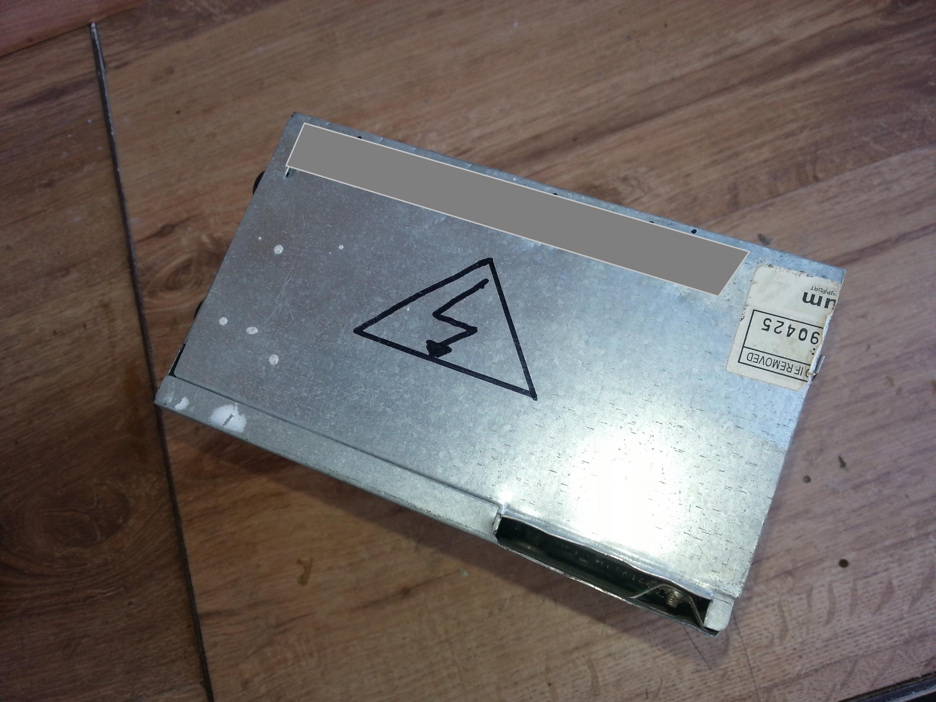

                                Reaction to that 400W Premier:
                                WOW!
                                YES!
                                I used to think I was a good runner-up for King-of-the-ghetto. But after seeing this, I don't think it's even a competition anymore. You sir, shall take that crown.
                                Those XLR jacks are indeed very unique. Never seen a PSU done like that before. Funny thing: just those 3 jacks probably cost 10x more than the PSU itself!
                                Oh, and that hand-drawn "shock hazard" symbol.... it's probably not too far from telling the truth what would happen to you eventually as you keep using this POS PSU.
                                Driving the BJTs, as Dan81 said.
                                If you notice, the PWM IC is on the secondary side. So the only way it can drive the BJTs is through that transformer. Optocouplers won't work, because BJTs are current-driven devices.
                                Some more clever half-bridge designs also used this middle "driver" transformer for over-power protection. Others (very rarely) had a 4th transformer specifically dedicated for that function, and it probably worked a lot better (I have an ePower 350W PSU like that.)
                                  Great ! The more you learn So it's like an isolation transformer so the IC doesn't drive the transistors directly ? Haven't had the patience to look up the datasheet (if any) for that IC to see what it does, but it must be a combined PWM driver-supervisor IC then, since it performs both tasks from the secondary - most SMPSs have the IC on the primary.
                                  Also, what about the STBY output on cheapo's like these? There is an optocoupler there, which I'm assuming is for regulation of the STBY output, but I don't see any driver IC on the primary, so it's like "dumb" regulation. The next step up I've seen from this is a separate PWM IC on the primary for the 5VSB output, though still no IC for the 5/12v output as well - that is still being driven by that third transformer. The next step up from that is of course "full" regulation, or even individual buck converter risers for the 5/3.3v outputs on the secondary, like in my Corsair.
                                    You nailed it! That is actually the -correct- name for it. I just couldn't remember what it was called.
                                        Recently a client brought me a computer that has a corrupted HDD (it had 1000 reallocated sectors in the SMART), and the computer had this 3GO installed. I think the PSU is to blame for the malfunction of the HDD, luckily the client was able to recover all the data from the HDD.
                                        The 5VBS voltage has such a terrible ripple that the multimeter is able to perceive it (the last 2 photos), the 5V line is out of specifications (5.28v) (first photo).
                                        I can't disassemble it because the customer wants to return it to the store where I buy the computer and I can't open it.
                                        Internally it is the same as the L-LINK in this link:
                                        https://www.badcaps.net/forum/showpo...postcount=1477

                                        • PeteS in CA
                                          • Aug 2005
                                          • 3578
                                          • USA, Unsure of Planet
                                          #1580
                                          If that thing is identical to the L-LINK you linked, it's basically a 150W power supply. I doubt the main transformer core is good for 200W, and those input electrolytics might have decent filtering and hold-up for 200W.
