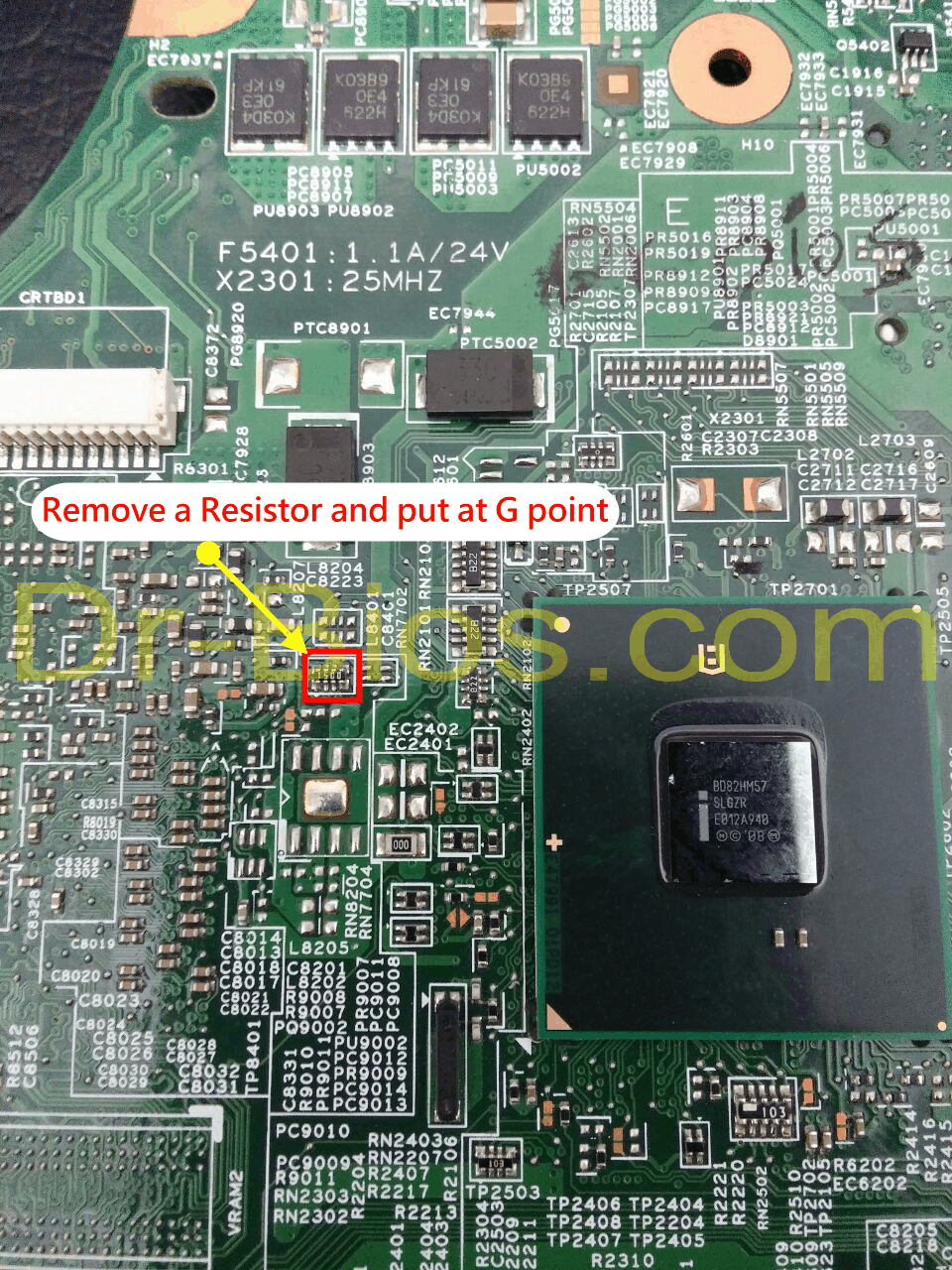

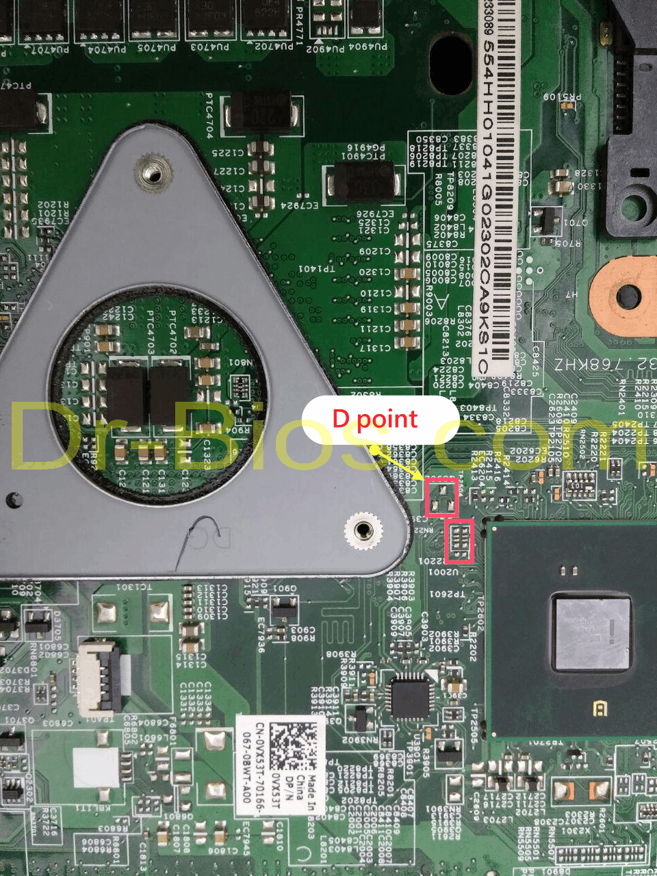

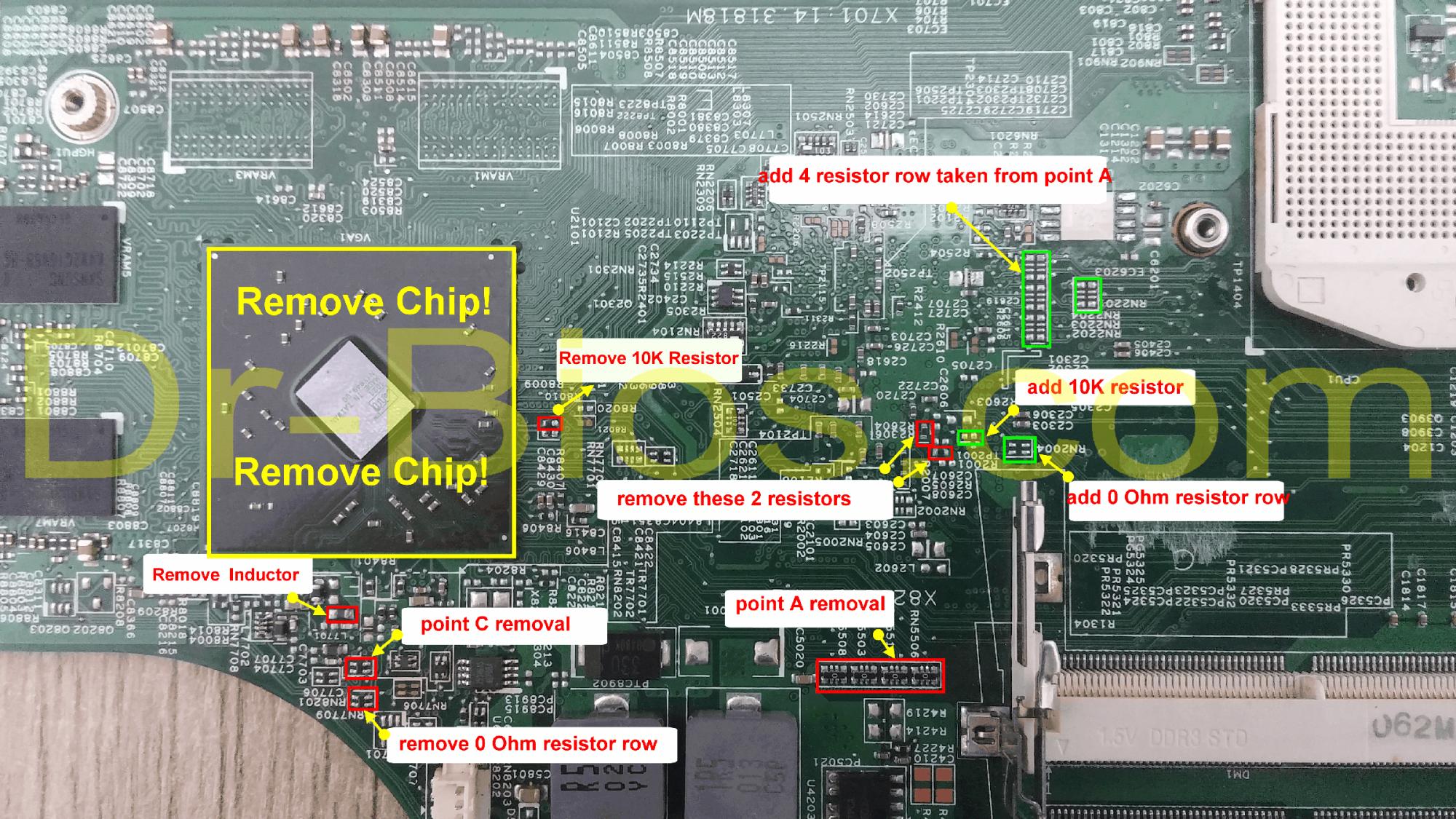

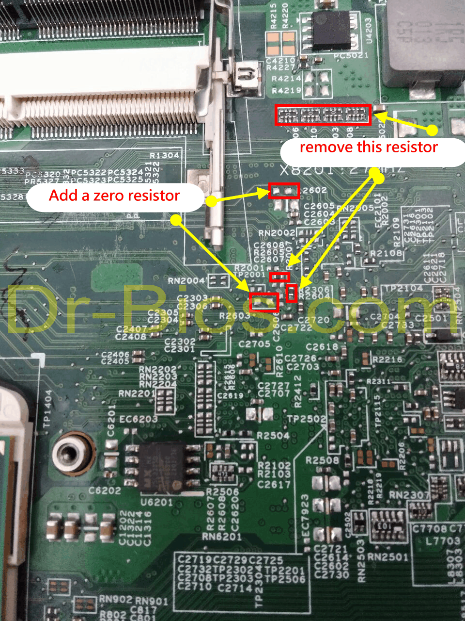

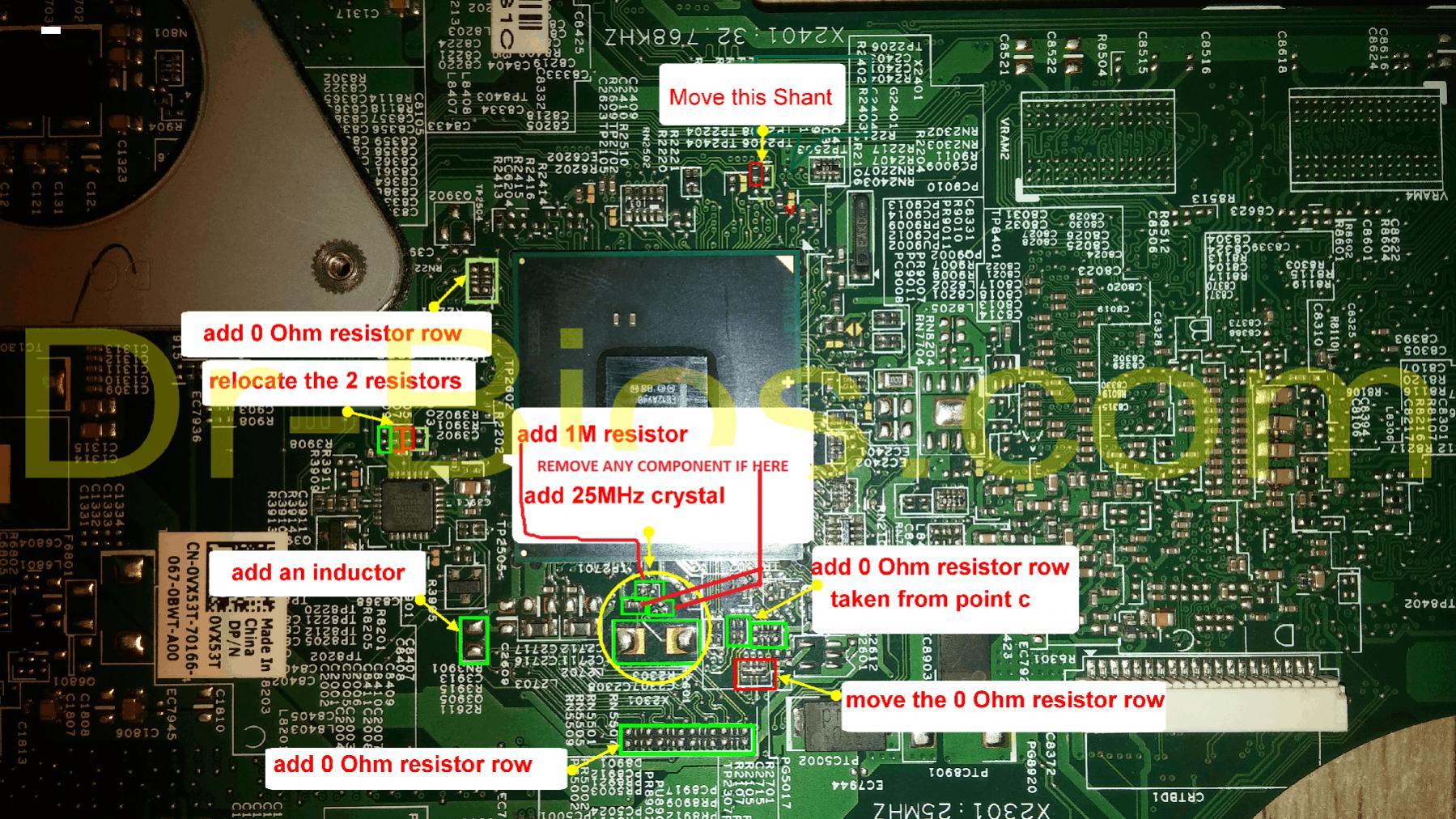

                    Re: Dell n5010 can be converted from graphic version to non graphic

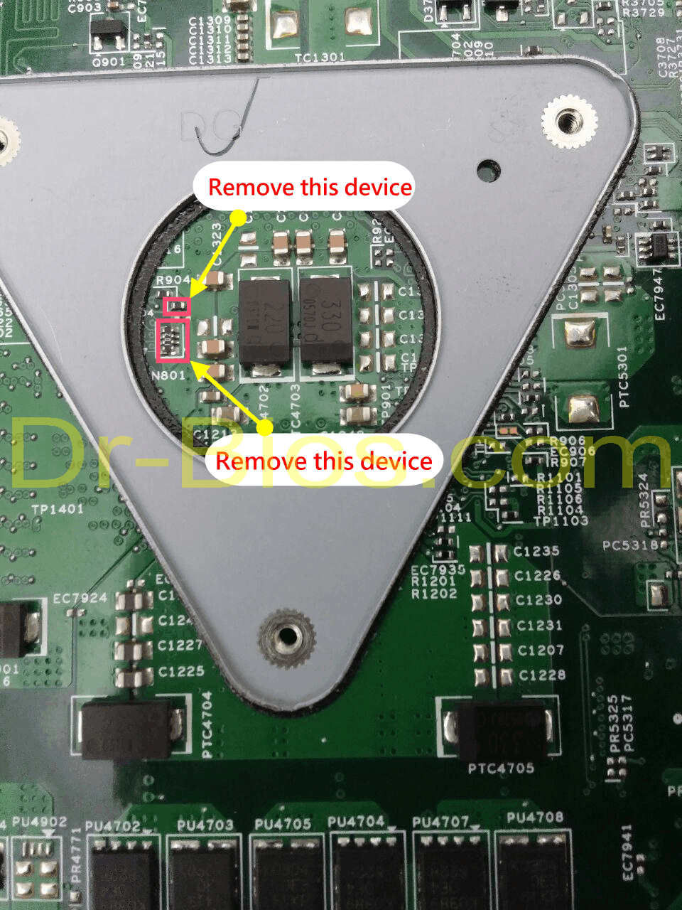

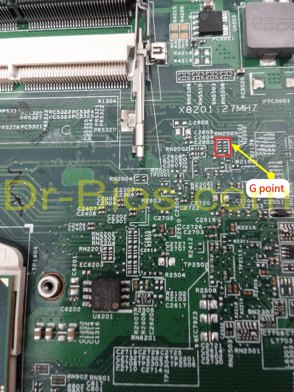

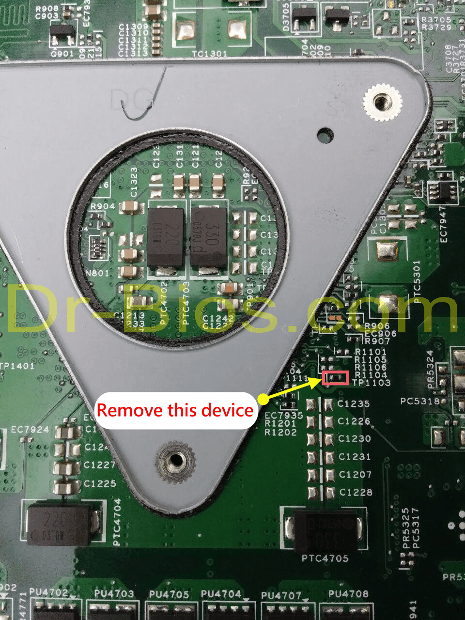

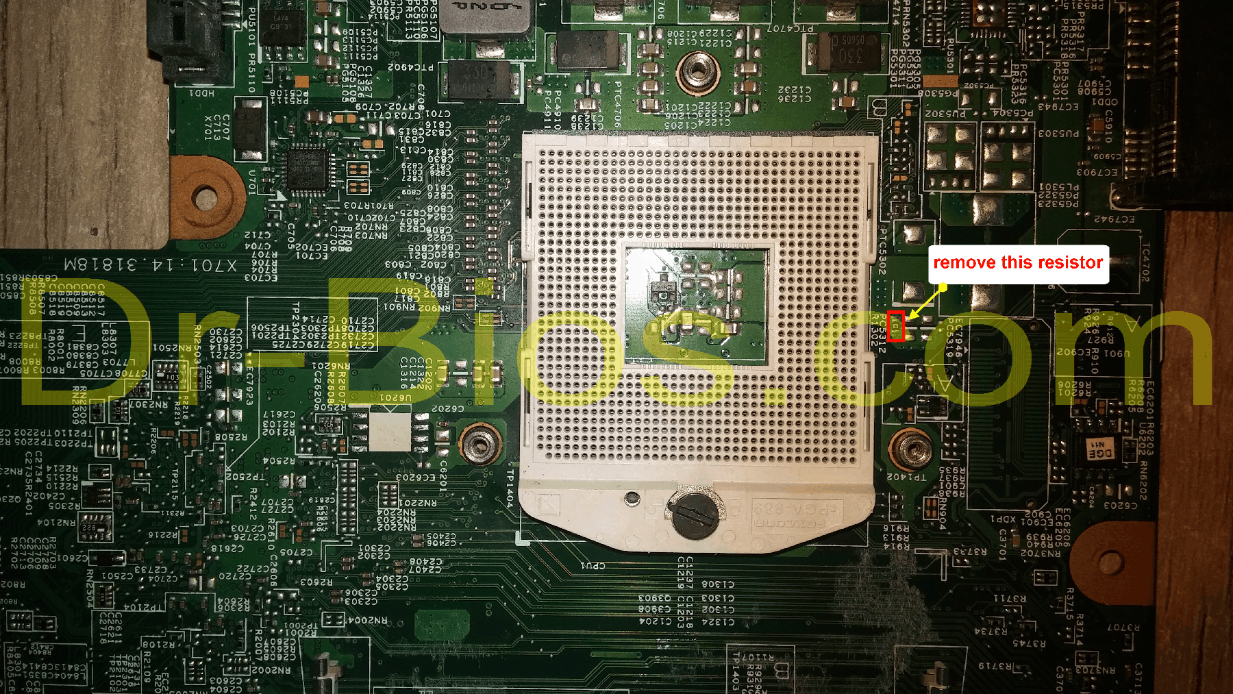

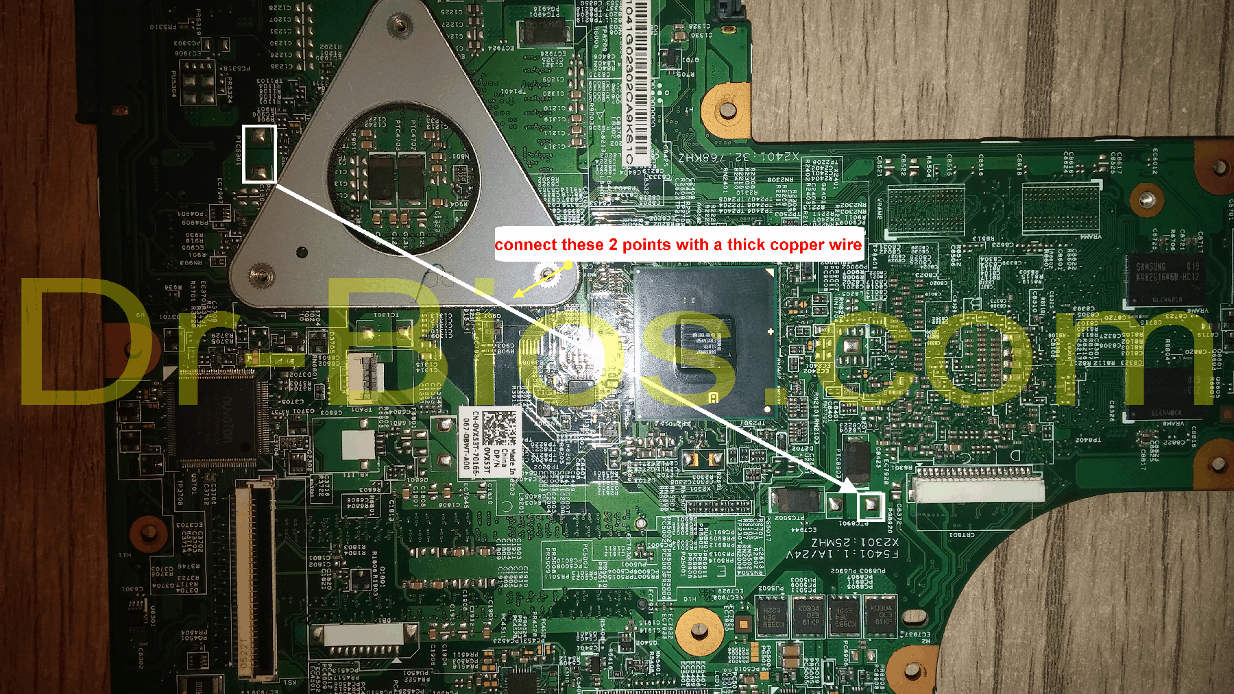

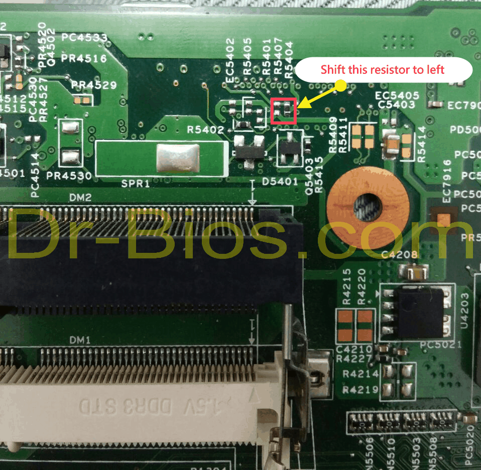

                    I successful do it on my motherboard which part no is following
                    09909-1
                    DG15
                    48.4HH01.011
                    DO THE FOLLOWING CHANGES WHICH I POSTING IN IMAGES
                    FOR THOSE WHO HAVE WHITE DISPLAY FOLLOW INSTRUCTION WHICH SHOWN IN PICTURE
                    if any one have issue msg me

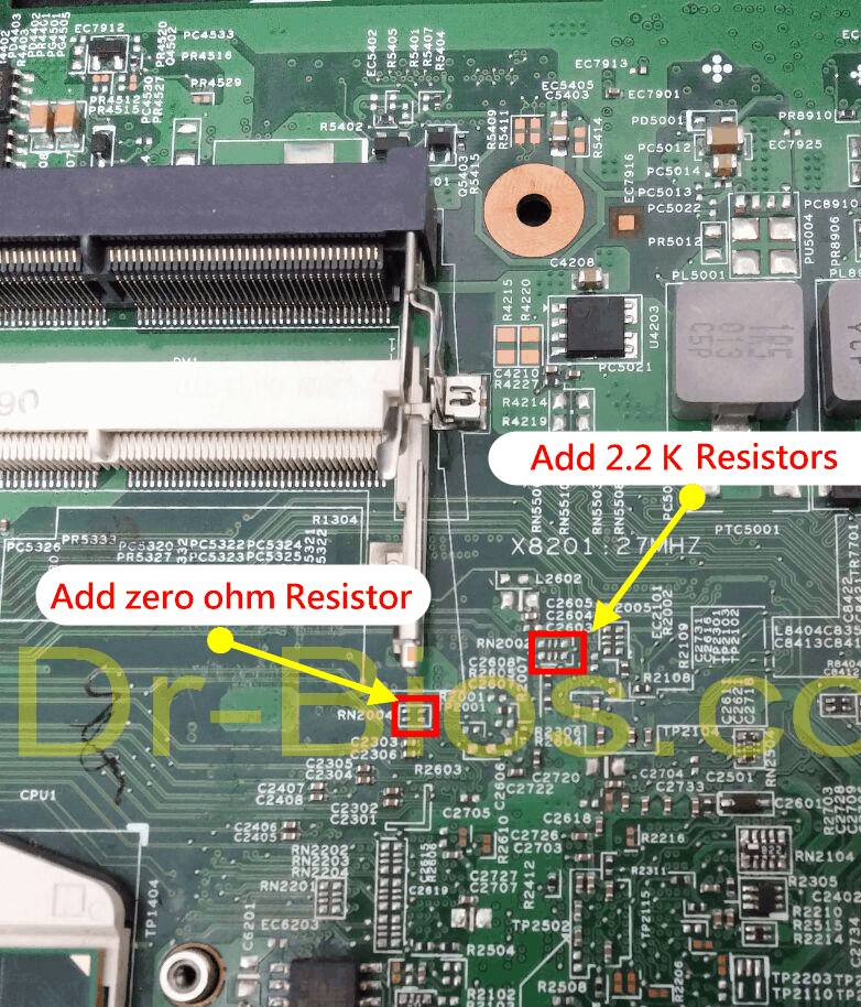

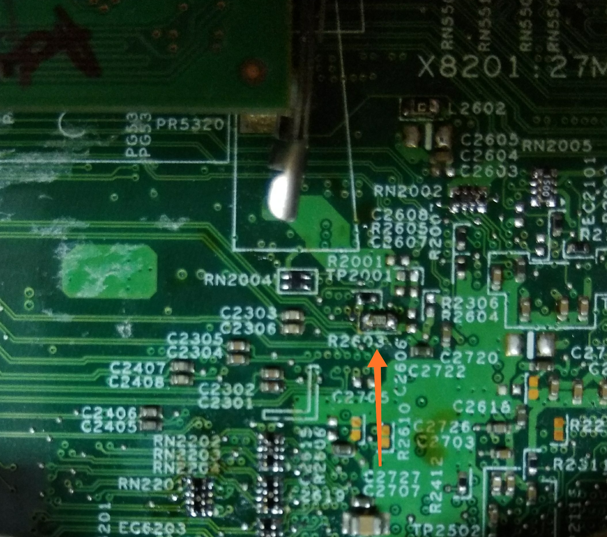

                      #90
                      Hi guys sorry to ask a noob question but looking for the 2.2k resistor in the 4 picture method but don't a[[ear to be able to locate please help!!!!!!1
                      many thanks in advance

                        #91
                        For the guys who couldn't be succesfull of doing this conversion by following the guide, at the 8th pic. of vickey_vip's message, marked with "D point" is the missing element. remove q5702 from its place which is near speaker-mic jacks. Solder it to D point.
                        • oxonater
                          • Oct 2012
                          • 77
                          • uk
                          #92
                          Hi thank you for your reply
                          I have since found this missing part by searching the net for a solution to my problem as there is various different guides.
                          The problem I have at the moment is my N5010 is beeping at me with a blank screen 3 beeps to be precise. I press the power button a few times and a white screen is present then press power button again and it returns to blank. Noticed the power button does not actually turn off when pressed it kind of blinks only way to switch off is remove power supply.
                          The only difference I have done to the previous guide is remove the IC near Northbridge chip (still has a cap were a 0 ohm resistor is on some boards).
                          Also coil and Mosfet and another IC left side of the GPU which is also removed.
                          3 beeps are noted as being related to the following :-
                          ◾chipset Error (North and South bridge error, DMA/IMR/Timer error)
                          ◾Time-Of-Day Clock test failure
                          ◾Gate A20 failure
                          ◾Super I/O chip failure
                          ◾Keyboard controller test failure
                          Thing beeps regardless if it has RAM,CPU, or nothing at all, confused I AM.
                          Any help on this issue would be greatly appreciated many thanks in advance OXY

                            • ktmmotocross
                              Boardkiller
                              • Feb 2014
                              • 3622
                              • slovakia
                              #94
                              i see more boards with bad NB balls than with GPU balls/ATI/. so u must double chceck, what ic have bad connection.
                              more when u have NB and GPU close

                                hi ibrahim there some note
                                1- there are resistor rn2002 2700 ohm code (272) if u didnt find this use 4700 ohm code of it(472)
                                2- use crystal 25x under it 2 capstor under them and betwen them use res 1mega code of it (01c) or(105) or (1004)
                                i do it and work great
                                and follow the chines pdf
                                good luck

                                  still problem are same ,,, white display pls reply
                                  • vickey_vip
                                    • Mar 2016
                                    • 134
                                    • India
                                    #97
                                    Anyone who get white display or Blank screen check below two solution if you get white display only backlight then remove any cap under Intel VGA which is placed under 1 mega ohm resistor and if you get black display with backlight mean no data or character showing on screen then you must check R2603 (0 Ohms resistance) is there you put or not. If you forget to add this reg. Then you not get any data on screen I am attaching picture of that location. Today I successfully convert another motherboard of dell using my previous posting image method
