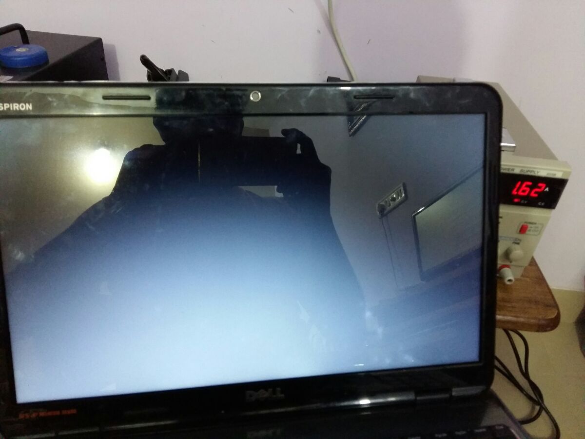

                            I tried this method but getting white screen any solution for it.

                                remove or change the oscillators caps near the crystal, the picture will be ok. you are used a bad caps.

                                  i changed caps as well as i removed caps but display is same.
                                  White Display

                                      can you post a picture off your white picture ?

                                          Re: Dell n5010 can be converted from graphic version to non graphic
                                          Hi please find attached
