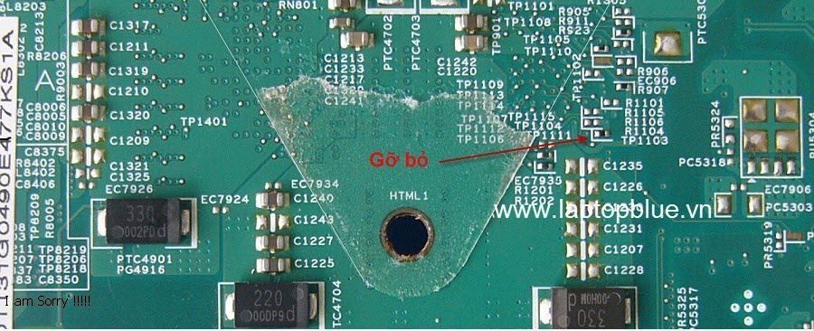

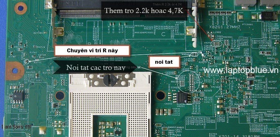

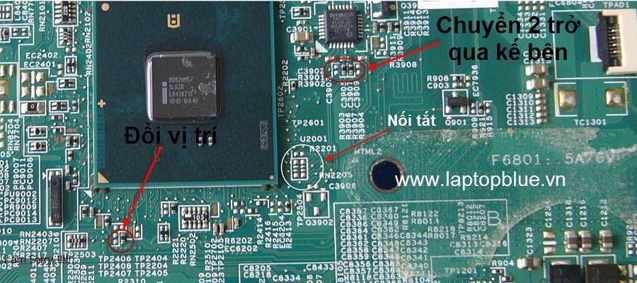

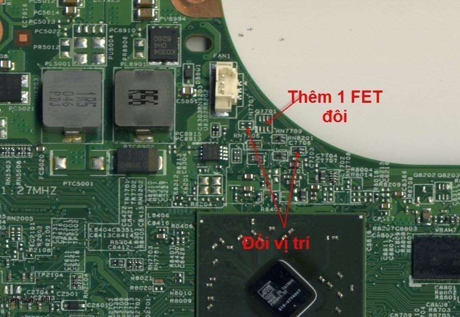

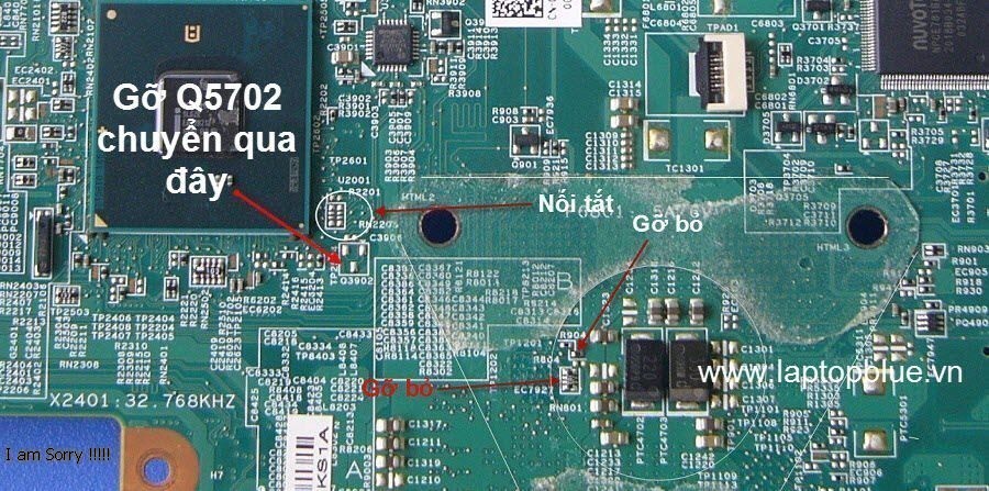

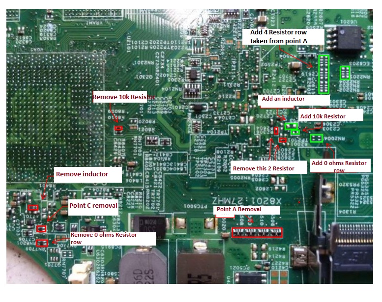

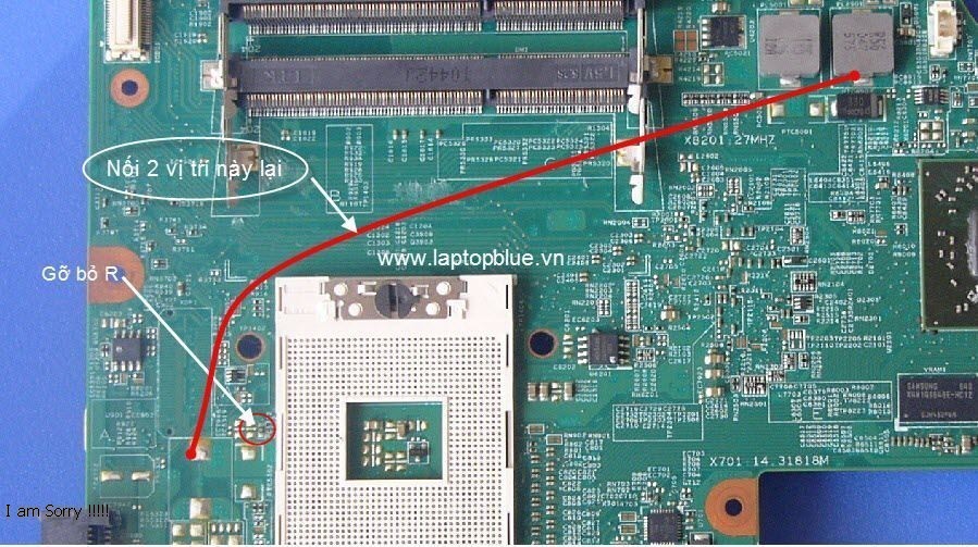

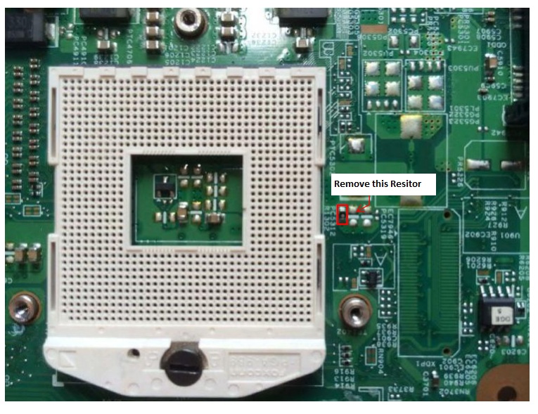

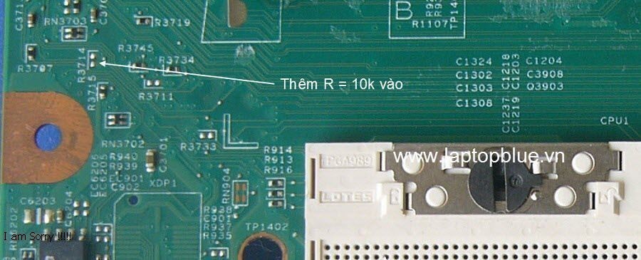

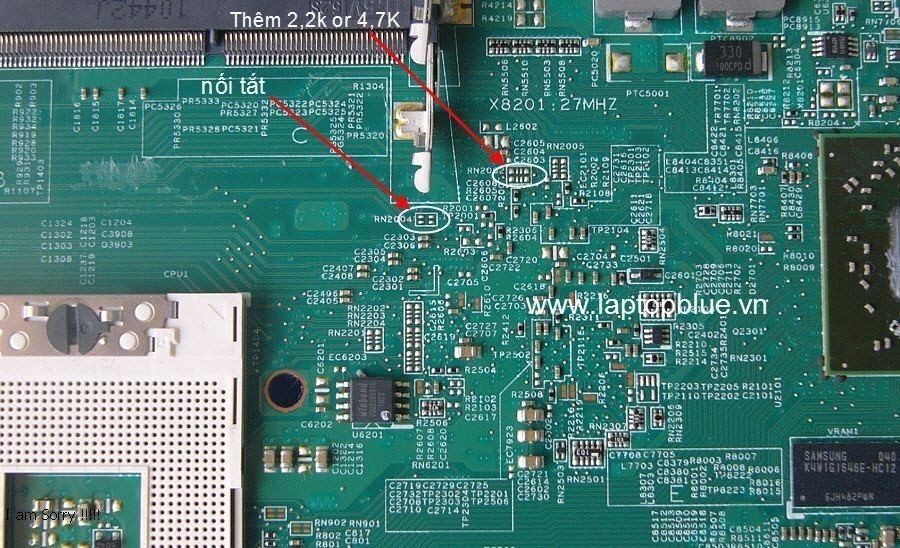

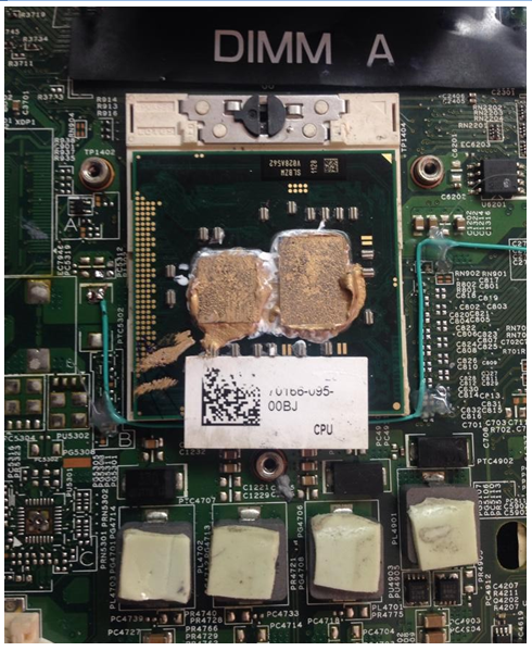

    Originally posted by megaraider
    Because an user requested them to me by pm, samanthban,
    i'm posting the mobo images from n5010milind.pdf
    Thanks my friend

      Re: Dell n5010 can be converted from graphic version to non graphic
      after this, do you see DSC vga in device manager or is it like it does not exist?

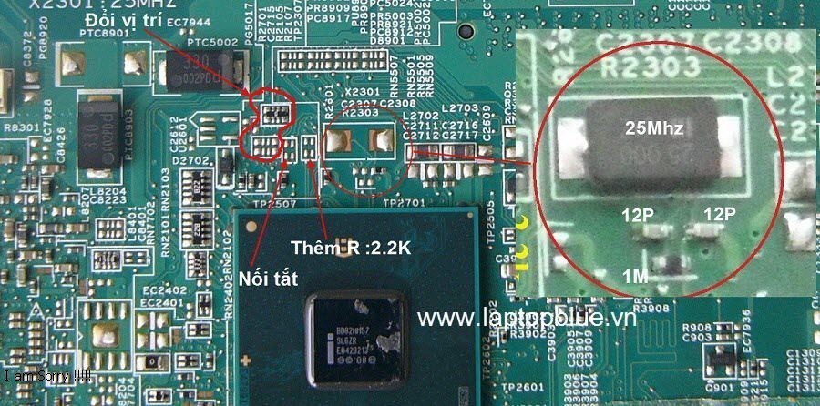

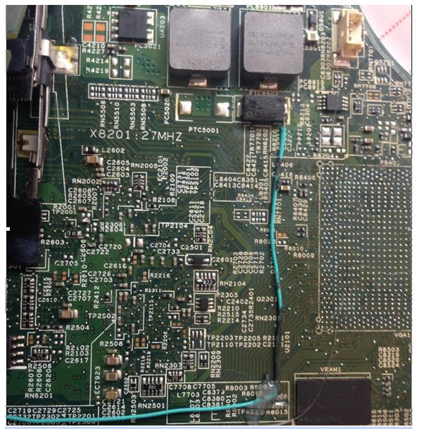

              problem with Dell n5010 converted from graphic version to non graphic
              hi Guys
              i followed all the instructions and did the conversion...
              Display comes fine and i can enter bios and do saves settings and all...
              But ..... the laptop doees not boots up to post screen ......
              neither it is able to boot with USB, CD , HDD or any other media ...
              the display just hangs on a plane white screen after the Dell logo...
              Alt+ CTrl + Del has no action.....
              Even tried to flash the Bios ...with a good one .....but no use .....
              the problem is the same ...
              Thought that might be problem in particular motherboard ... i tried the same on another board
              but ...struck on same page .....
              any ideas guys
              Waiting
              • polytek
                • Dec 2013
                • 496
                • TUNISIA
                try to flash the ec bios U6202 it's near the cpu socket (MX25L2005C)
                          It is never going to work. There are a lot more thinks to do to make it work.

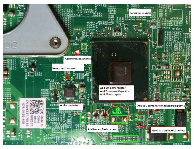

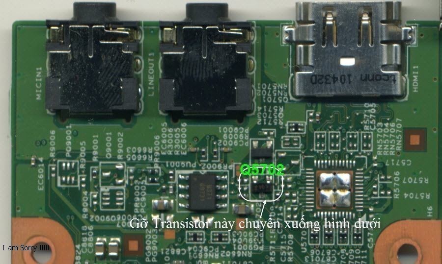

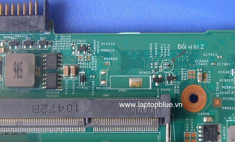

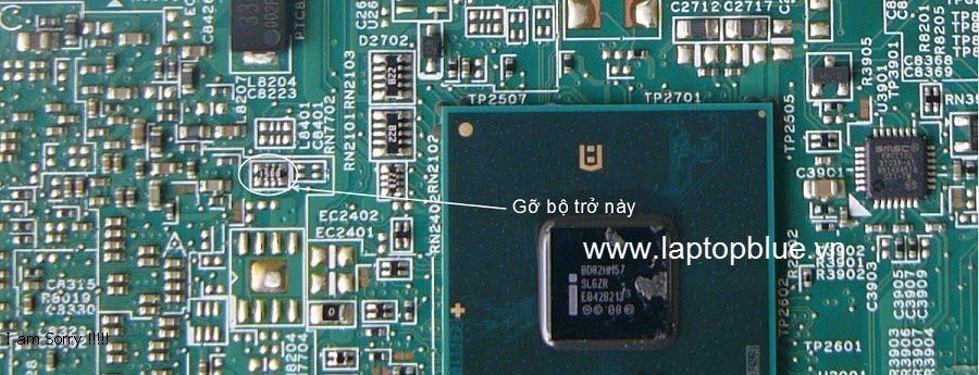

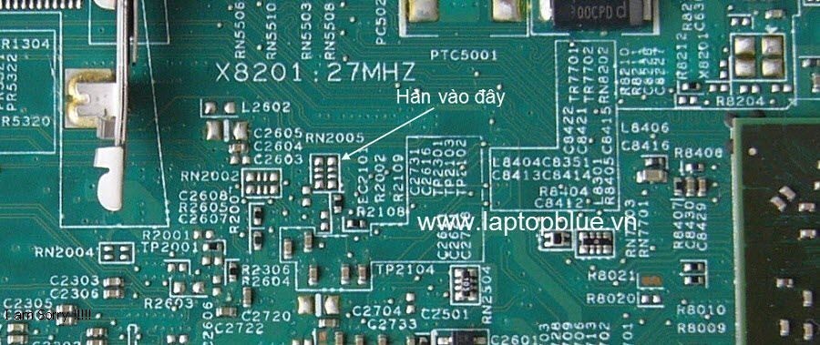

                            This is from another site some one can try and let us know
                             PU5301 > TPS51611
                             PR5311 > 90.9K
                             PC5313 > 2.2U 10V
                             PC5314 > 68P50V
                             PR5312 > 1.69K
                             PC5315 > 22U 10V
                             PR5325 > 18.7K
                             PC5317 > 3300P 50V
                             PR5301 ,PR5302 > 0 OHM
                             PR5327 ,PR5332 > 330 OHMS
                             PC5320 ,PC5322 ,PC5323 ,PC5324 ,PC5325 ,PC5314 > 33P 50V
                             PC5321 > 22U 50V
                             PR5331 > 29.4K
                             PR5330 > 86.6K
                             PR5328 > 24.3K
                             PR5323 > 2.2 OHM
                             PC5301 > 2.2U 10V
                             PC5316 > 22U 16V
                             PU5302 > SI7686DP
                             PU5303 > SIR460DP
                             PC5302 ,PC5303 > 10U 25V
                             PL5301
                             PTC5301 ,PTC5302 >330U 2V
                             PR5313 ,PR5314 ,PR5317 > 0 OHM
                             PR5319 > 1.69K
                             PR5334 ,PR5335 > 100 OHMS
                            And also
                            1. R2001 > 2.37K
                            2. R1305 > 4.37K
                            3. R2603 > 0 OHM
                            4. L2602
                            5. RN2001 > 0 OHM
                            6. RN2004 > 0 OHM
                            7. RN2002 > 2.2K
                            8. RN2005 > 1500 OHMS
                            9. RN2006 >2.2K
                            10. R5407 > 0 OHM
                            11. R2309 > 10K
                            12. RN7702 > 0 OHM
                            13. R2601 > 0 OHM
                            14. RN5501 ,RN5502 , RN5505 , RN5507 , RN5509 > 0OHM
                            15. R2611 > 0 OHM
                            16. R2201 > 0 OHM
                            17. R2205 > 0 OHM
                            18. X2301 > 25 MHZ
                            19. R2303 > 1M
                            20. C2307 ,C2308 > 12P 50V
                            21. R3903 > 0 OHM
                            22. R3904 > 0OHM
                            23. Q3902 > PMBS3904
                            24. RN7704 > 33 OHMS
                            25. R3714 > 10K
                            26. RN7702 > 0OHM
                            27. RN2201 , RN2202 , RN2203 , RN2204 > 0 OHM
                            28. Q7701 > 2N7002EDW
                            29. RN7707 > 2.2K
                            sigpic
                              I finished the job. Unfortunately the laptop is giving white display. I can see that functioning of the laptop is ok.
                              I think i made some mistake. can any body help me.
                                  I did the conversion to 4 motherboards but it gives white display to me, and programmed a working file to the 256 kb bios and 4 mb bios... and i want to say i removed graphics chip same output and after removed graphics chip and vram's all and get same output, why not comes display please help me.
                                        Hello dears,
                                        I tried those steps and its grate work I got display and able to enter bios settings, but Hdd not booting after showing in bios, please give me replay for this problem
