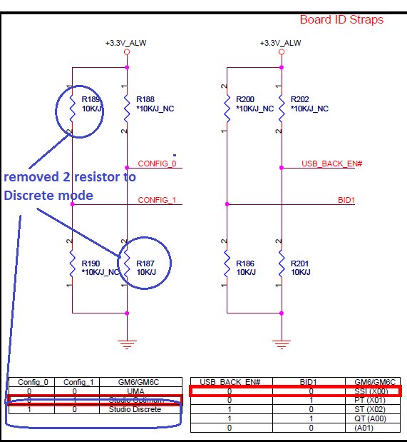

    hello...
    the Dell XPS L502x ( Model P11F ) [ DAGM6CMB8D0 rev.D ..3 of lines output LVDS from PCH has short ohm(0 -70) than LCD displat turn ON but is white !!!
    i decide to change LVDS ports to Lcd from EXT_LCD graphic Studio Discrete to No need it LVDS lines of PCH use...
    according to ُSchematic ,I changed any resistor and... Config_0 and Config_1 EC...but:
    1- EXT_LCD_PWM no voltage to enable pwm
    2-EXT_LVDS_VDDEN no High to Enable LCD_vcc
    and screen is turn off and fan is high Speed!!
    Question:
    I need to Use Discrete graphic nvidia EXT_LCD ports to use LCD and Cut the UMA mode.
    and cut resistors UMA mode (Because some lines is short to 0 ohms -I suppose it was due to the connection of the metal to the outputs).
    any friend Can help me...thanks.
    Also :set D24 and D23 for LCD_Vcc And BL_PWM..
    -move R398 to R394...
    -Remove L43 1.8_run
    -add R455 for dGPU_PWROK
    -remove R672
    -Add R219 and R232
    Please guide me further..
    Click image for larger version  Name:	ddddddddddddddddddd.png Views:	3 Size:	36.8 KB ID:	3233335Click image for larger version  Name:	dddddddddd.png Views:	1 Size:	84.7 KB ID:	3233337
