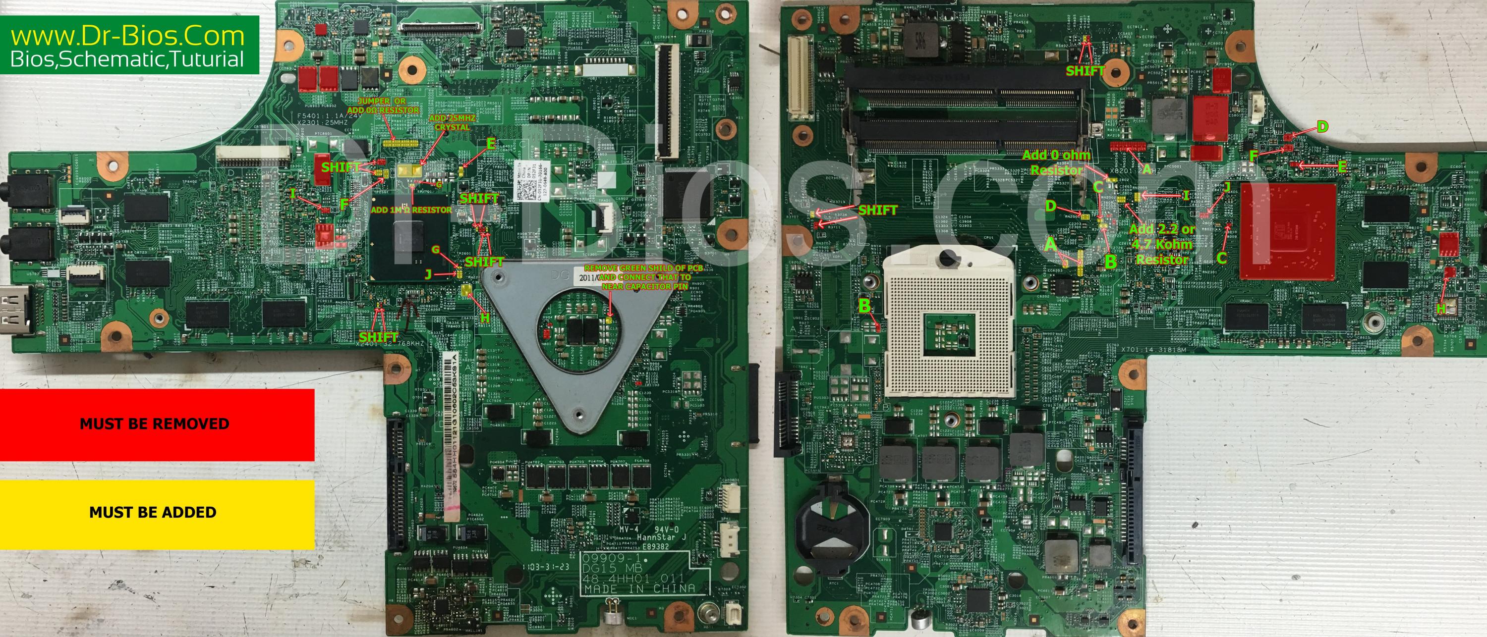

          #144
          Re: Dell n5010 can be converted from graphic version to non graphic
          Hello; i to make conversion with succes; initialy, my laptop it's working properly, but when i load in windows, i get bsod, ati file crash. So, my mainboard was not dead 100%.
          After i make all changes from picture attached, at first power on, i get 5 beeps; after turn off and on again, all is working perfect(keyboard was not connected; i power on laptop with minimum of pieces) .
          Remember to get out battery bios before begin process.
          And, remember after soldering every pieces, to check with magnifier that solder is done properly.
          After reading all 8 pages, to lower some how temperature of chipset, i measure and cut black plastic film underneath keyboard and put a thermal pad with 1mm thickness, to move heat from chipset to keyboard chasis.
          Laptop has i3 first generation, and with 4 gb ram and a 120gb oem ssd, windows 8.1 is flying.
          I attached picture, and a archive with picture unresized.
          Thank you.

                    #149
                    Originally posted by vektro
                    Hello friend,
                    recently i converted an N5010 board using Dr. Bios way.
                    It works only for laptop's display, not HDMI's or VGA's outputs.
                    Now i am trying to resolve this too.
                    Check the attachment.
                    I have Solved VGA Output issue.

                        #151
                        Originally posted by vickey_vip
                        I successful do it on my motherboard which part no is following
                        09909-1
                        DG15
                        48.4HH01.011
                        DO THE FOLLOWING CHANGES WHICH I POSTING IN IMAGES
                        FOR THOSE WHO HAVE WHITE DISPLAY FOLLOW INSTRUCTION WHICH SHOWN IN PICTURE
                        if any one have issue msg me
                        Thanks, it works.
                        I think some heat dissipation method need for the PCH.

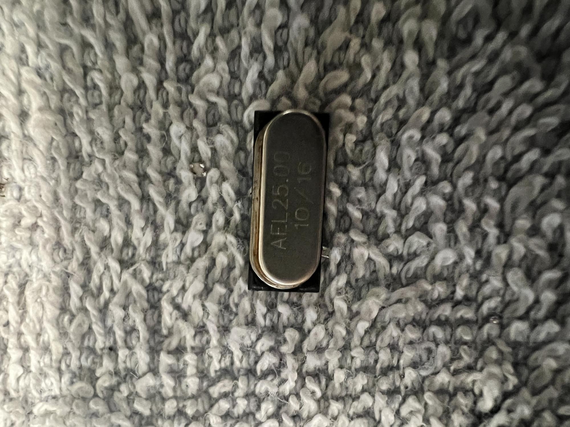

                            #153
                            Hi all can i use this 25mhz crystal?
