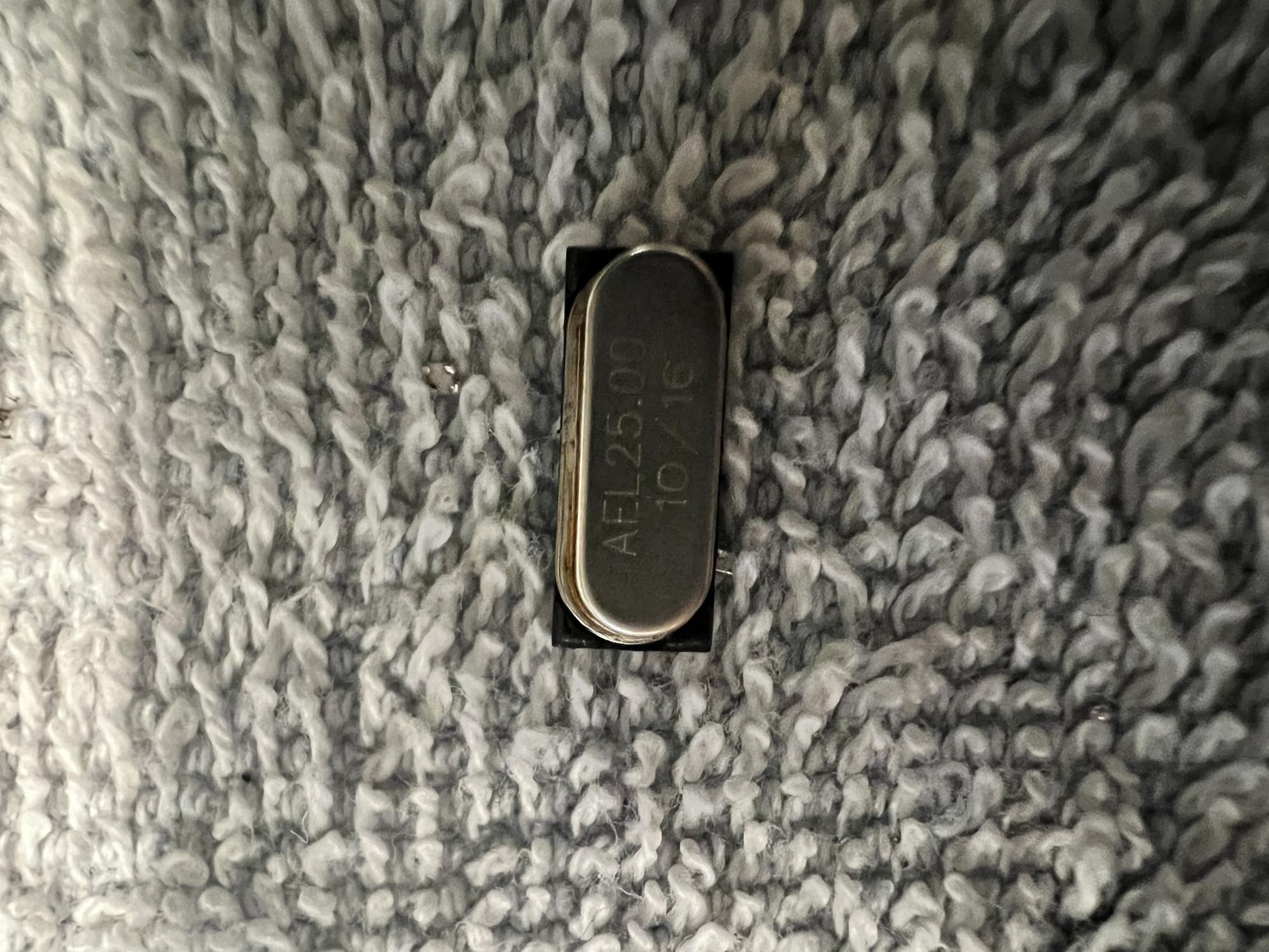

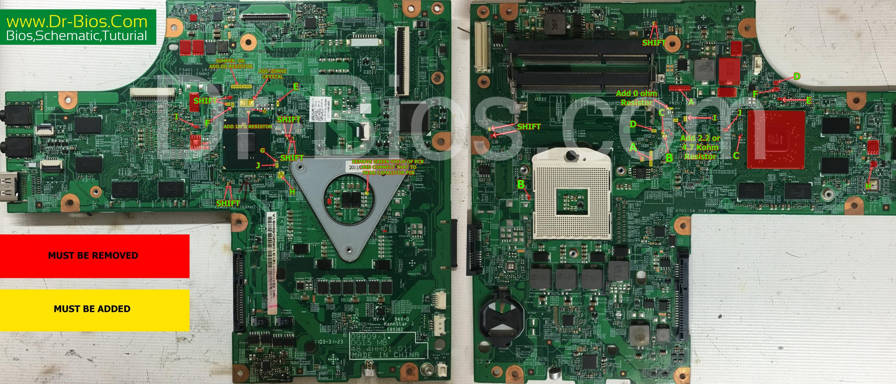

Dell n5010 can be converted from graphic version to non graphic
  • caspian
    replied
    I fixed the problem and now the colors are correct. The problem was bridge between the soldered pins of the resistor arrays.
    Leave a comment:
  • caspian
    replied
    This week, I have received a Dell n5010 and I have converted it into Intel Graphics.
    After conversion, it gives picture , but the colors are different.
    For example, at boot time, the background of the screen should be black and the text should be white, similar to the DOS environment. However, the background is red and the text is white in this laptop.
    The other colors are different in Windows too.
    I have inspected all the soldered pins and the conversion quality seems good.
    the VGA port is not soldered and does not work.
    After conversion, the laptop works fine except for the colors. The Windows loads normally but with different colors.
    what do you think is defective in this laptop?
    CPU? PCH? or my soldering job?
    Leave a comment:
  • robek295
    replied
    Re: Dell n5010 can be converted from graphic version to non graphic
    Hi all can i use this 25mhz crystal?
    Leave a comment:
  • adhiea7x
    replied
    Re: Dell n5010 can be converted from graphic version to non graphic
    Originally posted by teknikbursa
    Thank you very much
    Also on the second page of pdf there is a schema. is it possible to explain?
    thanks
    Leave a comment:
  • niwantha
    replied
    Re: Dell n5010 can be converted from graphic version to non graphic
    Originally posted by vickey_vip
    I successful do it on my motherboard which part no is following
    09909-1
    DG15
    48.4HH01.011
    DO THE FOLLOWING CHANGES WHICH I POSTING IN IMAGES
    FOR THOSE WHO HAVE WHITE DISPLAY FOLLOW INSTRUCTION WHICH SHOWN IN PICTURE
    if any one have issue msg me
    Thanks, it works.
    I think some heat dissipation method need for the PCH.
    Leave a comment:
  • tano2060
    replied
    Re: Dell n5010 can be converted from graphic version to non graphic
    Originally posted by vektro
    Hello friend,
    recently i converted an N5010 board using Dr. Bios way.
    It works only for laptop's display, not HDMI's or VGA's outputs.
    Now i am trying to resolve this too.
    Check the attachment.
    It works nice.
    Leave a comment:
  • vickey_vip
    replied
    Re: Dell n5010 can be converted from graphic version to non graphic
    Originally posted by vektro
    Hello friend,
    recently i converted an N5010 board using Dr. Bios way.
    It works only for laptop's display, not HDMI's or VGA's outputs.
    Now i am trying to resolve this too.
    Check the attachment.
    I have Solved VGA Output issue.
    Leave a comment:
  • caspian
    replied
    Re: Dell n5010 can be converted from graphic version to non graphic
    It is probably possible. but you need to modify the mainboard more. It is not done by anyone yet. So you have to discover it yourself. I think it is not worth it to try, because it is possible to damage the mainboard.
    Leave a comment:
  • lazybigyan
    replied
    Re: Dell n5010 can be converted from graphic version to non graphic
    Is it possible to make display in externa monitor or not?
    Thank you for your response caspian.
    Leave a comment:
  • caspian
    replied
    Re: Dell n5010 can be converted from graphic version to non graphic
    The described conversion method is only for the internal screen. The external displays do not work. and it is normal.
    Leave a comment:
  • lazybigyan
    replied
    Re: Dell n5010 can be converted from graphic version to non graphic
    I convert it discrete to uma but hdmi and vga port unable to work. External display does not detect. Intel graphic display driver is fine. What to do?
    help please
    Thanks in advance.
    Leave a comment:
  • c.daniel
    replied
    Re: Dell n5010 can be converted from graphic version to non graphic
    Hello; i to make conversion with succes; initialy, my laptop it's working properly, but when i load in windows, i get bsod, ati file crash. So, my mainboard was not dead 100%.
    After i make all changes from picture attached, at first power on, i get 5 beeps; after turn off and on again, all is working perfect(keyboard was not connected; i power on laptop with minimum of pieces) .
    Remember to get out battery bios before begin process.
    And, remember after soldering every pieces, to check with magnifier that solder is done properly.
    After reading all 8 pages, to lower some how temperature of chipset, i measure and cut black plastic film underneath keyboard and put a thermal pad with 1mm thickness, to move heat from chipset to keyboard chasis.
    Laptop has i3 first generation, and with 4 gb ram and a 120gb oem ssd, windows 8.1 is flying.
    I attached picture, and a archive with picture unresized.
    Thank you.
    Last edited by c.daniel; 06-23-2021, 12:34 AM.
    Leave a comment:
  • lapfix
    replied
    Re: Dell n5010 can be converted from graphic version to non graphic
    Originally posted by doctormasry
    remove 2 caps up r 1m
    Thank you ..i did this too before as suggested at post n 55..but still the same : only backlight no picture
    Leave a comment:
  • doctormasry
    replied
    Re: Dell n5010 can be converted from graphic version to non graphic
    Originally posted by lapfix
    Back to this thread , after a success conversions i face this one : Only backlight no picture !
    try to resold all the components ans still the same ...any idea please
    remove 2 caps up r 1m
    Leave a comment:
  • lapfix
    replied
    Re: Dell n5010 can be converted from graphic version to non graphic
    Back to this thread , after a success conversions i face this one : Only backlight no picture !
    try to resold all the components ans still the same ...any idea please
    Leave a comment:
  • stingerchamp
    replied
    Re: Dell n5010 can be converted from graphic version to non graphic
    In short
    You have to remove connection from GPU and move it towards PCH
    If hdmi is directly interacted with PCH then no need
    Otherwise change clock signal change display control etc
    Additional you need Uma bios
    Leave a comment:
  • elwess93
    replied
    Re: Dell n5010 can be converted from graphic version to non graphic
    Originally posted by vektro
    Hello friend,
    recently i converted an N5010 board using Dr. Bios way.
    It works only for laptop's display, not HDMI's or VGA's outputs.
    Now i am trying to resolve this too.
    Check the attachment.
    and it says remove green shild of pcb and connect that to near capacitor pin, i didnt understand that too
    thanks
    Leave a comment:
  • elwess93
    replied
    Re: Dell n5010 can be converted from graphic version to non graphic
    Originally posted by vektro
    Hello friend,
    recently i converted an N5010 board using Dr. Bios way.
    It works only for laptop's display, not HDMI's or VGA's outputs.
    Now i am trying to resolve this too.
    Check the attachment.
    hello!
    i'm kinda new to this but i want to try the method you mentioned. can you please help me: there are some letters with yellow square but dont say what must be added. thanks in advance.
    Leave a comment:
  • lapfix
    replied
    Re: Dell n5010 can be converted from graphic version to non graphic
    Originally posted by caspian
    Enabling intel graphics on VGA and HDMI needs an additional number of component soldering/replacement. Considering the facts that the Dell-5010 laptop is old and we cannot spend more time on this laptop, technicians usually refuse to enable intel graphics on VGA and HDMI on Dell 5010.
    Thank you caspian
    Leave a comment:
  • caspian
    replied
    Re: Dell n5010 can be converted from graphic version to non graphic
    Enabling intel graphics on VGA and HDMI needs an additional number of component soldering/replacement. Considering the facts that the Dell-5010 laptop is old and we cannot spend more time on this laptop, technicians usually refuse to enable intel graphics on VGA and HDMI on Dell 5010.
    Leave a comment:
