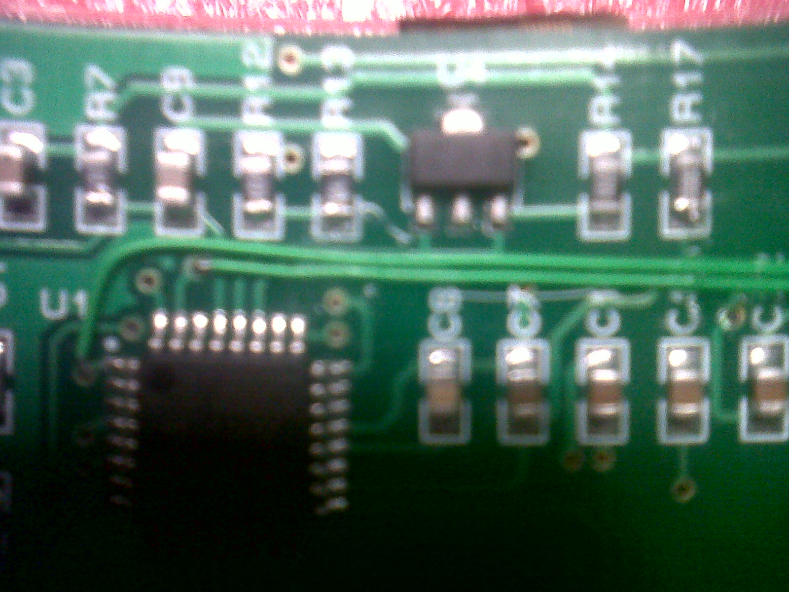

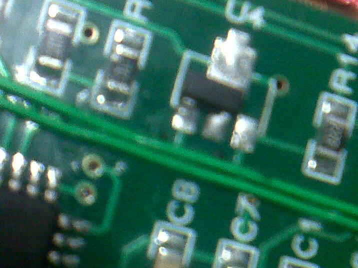

                                        i got my 16MHz xtal fitted - works great.
                                        it even i.d.'d the original crystal i took off as 8000KHz
                                        i also upgraded my voltage reference from a TL431 (1% drift) to an LM4040A (0.1% drift)
                                        **one thing you cant see in the foto - i had to cut the top pin off the LM4040A to isolate it from the board.
