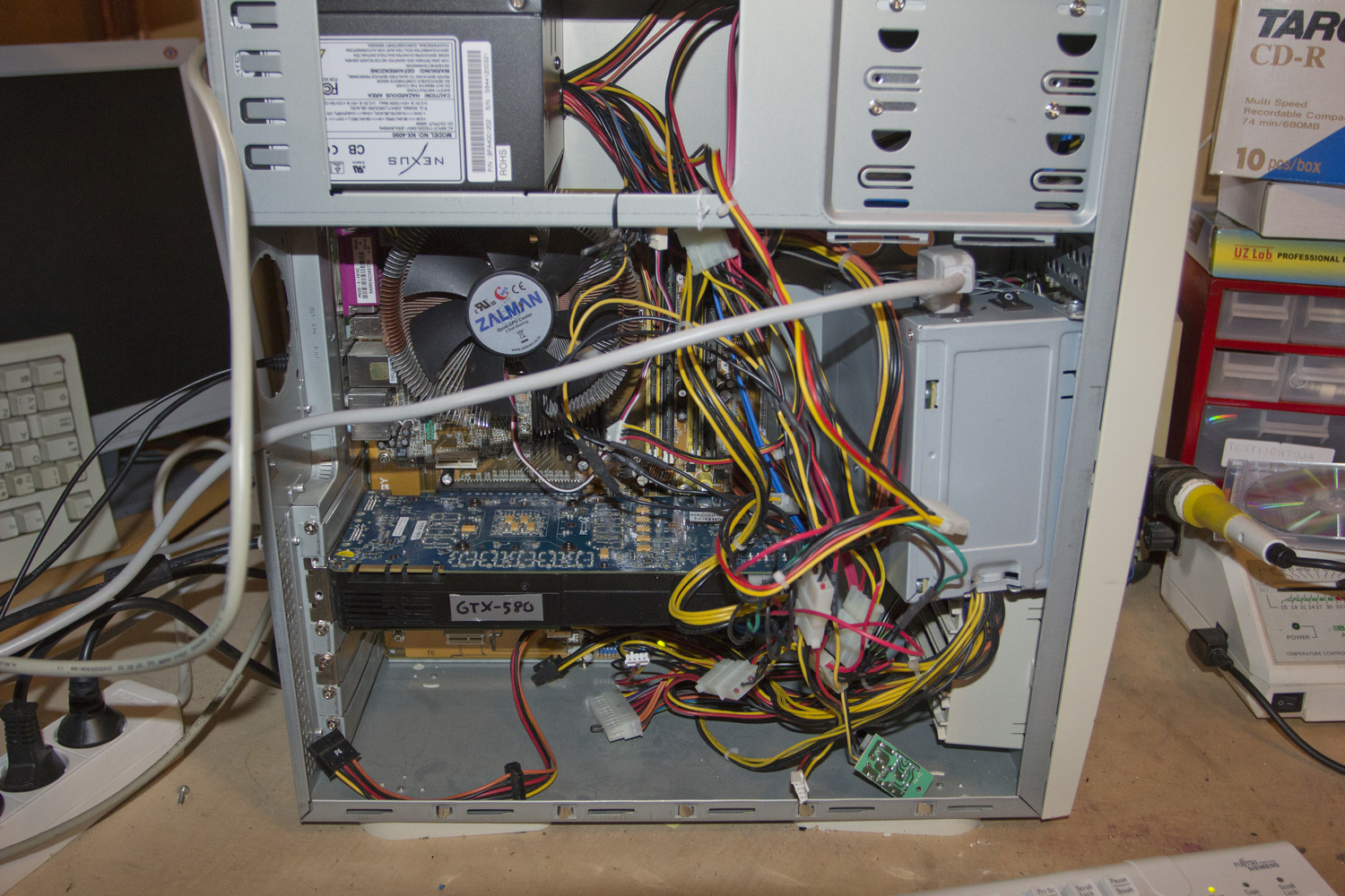

    GPU (from e-waste container) needed a second power supply. Luckily the case was big enough to fit it in...

        Re: The ghetto mod thread
        WOW!
        I mean, the PSU is not even secured in there!!!
        And that small PCB on the bottom just hanging loose ready to short against the case.
        Man, this is actually a work of art!

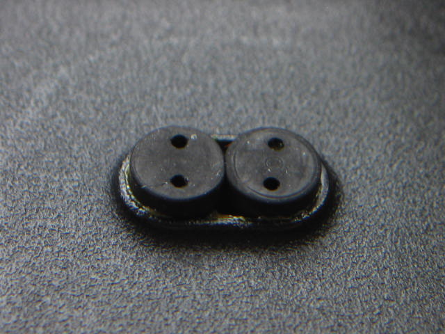

          Re: The ghetto mod thread - laptop rubber feed repair
          Originally posted by momaka
          Since this thread has been awakened, here is something I did recently (actually, yesterday.)
          I've been piecing together / playing around with a few junker laptops this week. One of them was missing a rubber foot on the bottom, which made the laptop very wobbly on a hard, flat surface (and kind of annoying even, when typing on it.)
          So, I had an idea!

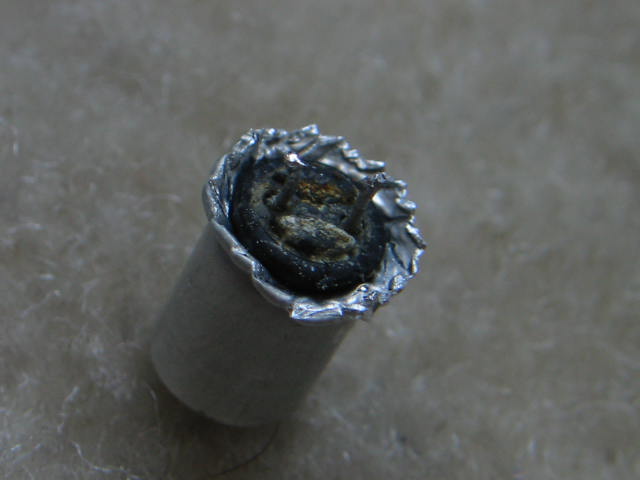

          Let's take a busted Sacon FZ apart:
          Do you see where this is going?
          A few drops of contact cement later, and this was the result:
          ^ Yes, that's the rubber bung from the busted cap. Fortunately for me, that vented Sacon FZ cap was so dry in there, that I didn't really need to clean the rubber bung with anything too harsh or "exotic" (e.g. acetone, toluene, and etc.) Nope, just sanded it down a bit (it was about 0.8-1 mm too wide for the plastic hole on the laptop's body), wiped both surfaces with IPA, put contact cement on both, and glued it all together. Simple as that!
          The best part is, now the laptop doesn't wobble anymore at all. It's like that rubber bung was meant to be there.
          Also, it's a good (re)use for busted/vented caps. I've actually though of using the rubber bungs of capacitors as rubber feet for a long time... but just never found a convenient time to try it. Well, now I have.
          This post changed my life forever.

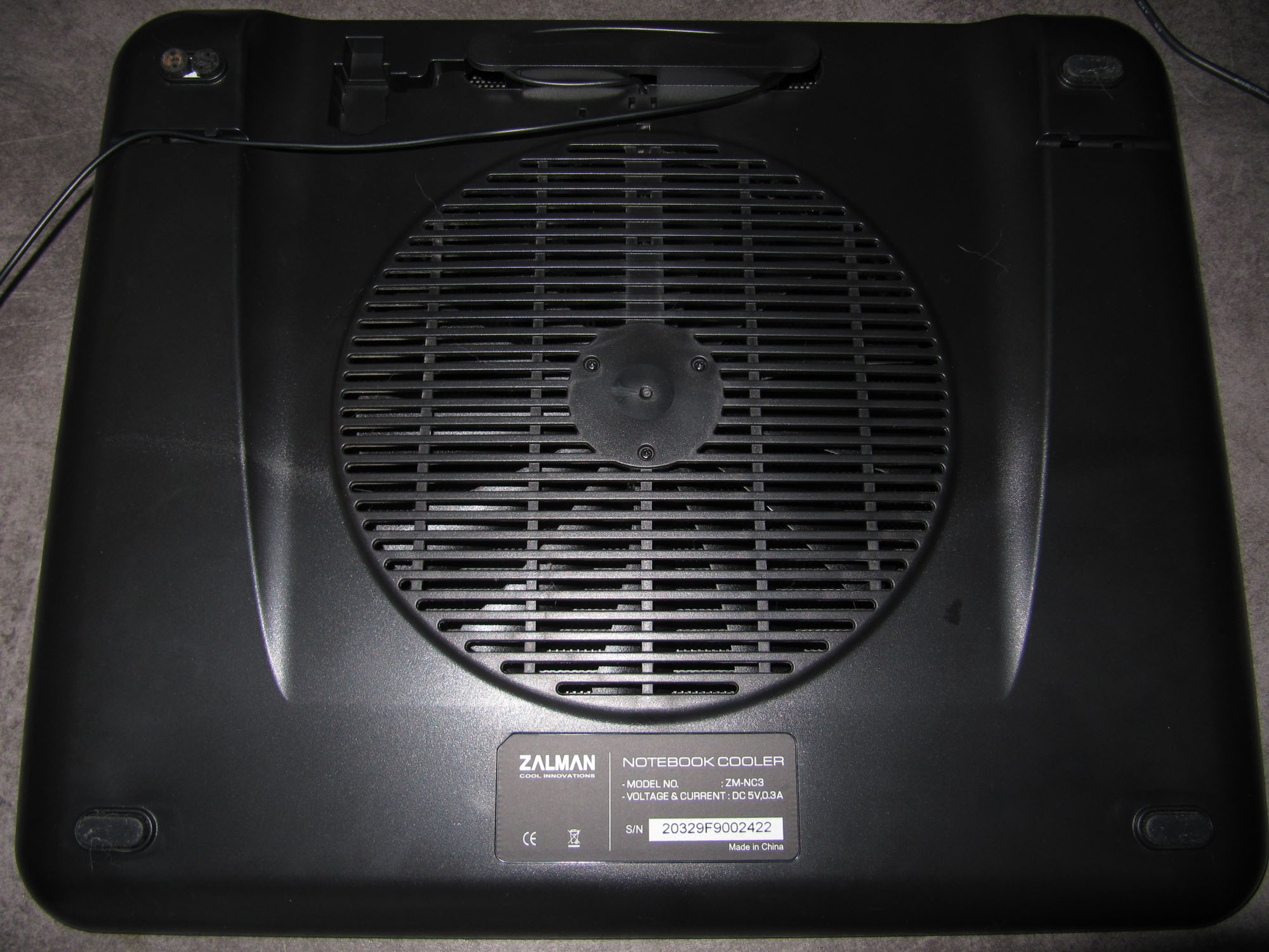

          Check this notebook cooler:
          https://www.badcaps.net/forum/attach...1&d=1642262434
          If you look closer you will find something strange on the upper left rubber foot:
          Yes! I have replaced the original rubber foot of the base with 2 rubber bases of capacitors!
          Does this qualify as ghetto enough?
          I also keep a stock for future use

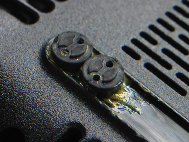

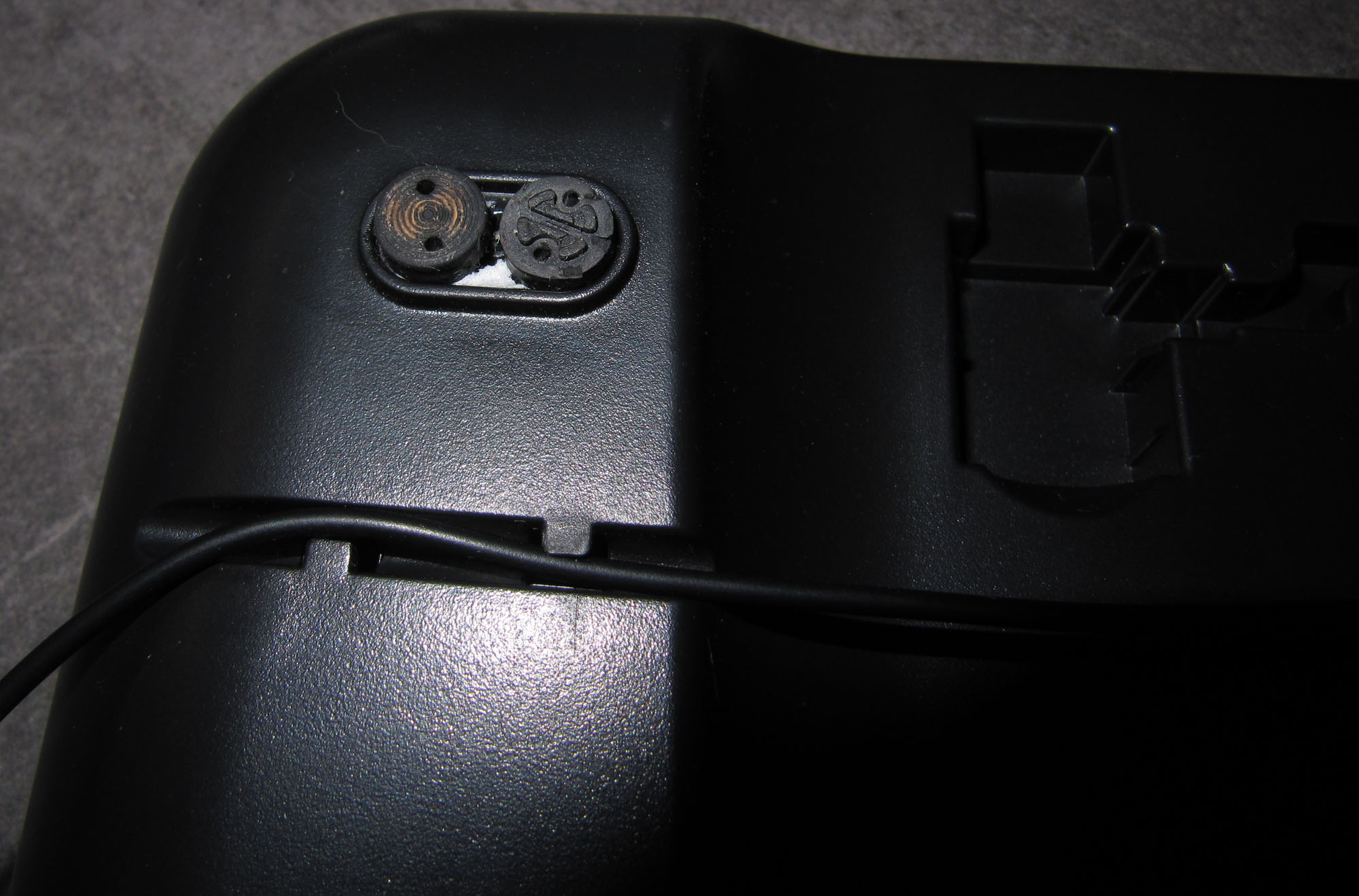

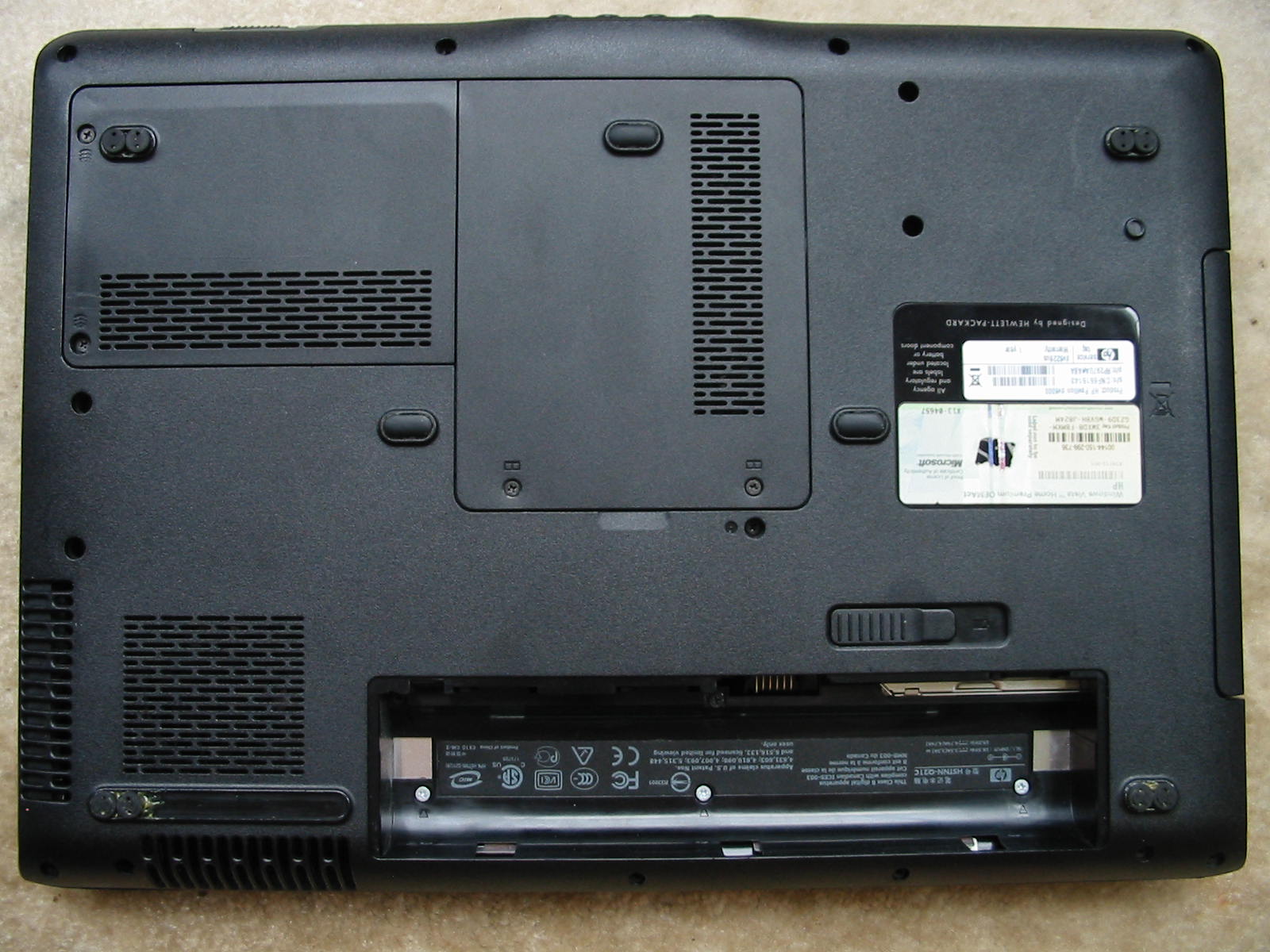

            The ghetto mod thread - laptop rubber feet repair v2.0
            Oh no, I've started a trend.
            Let's see how many laptops will suffer from this ghetto mod now.
            Well, I have another one.
            This time it's an HP Pavilion DV6000 laptop (the reliable non-nVidia model.)
            Actually, I did the rubber foot "repair" on it back in June. I meant to post it here then, but never got to it. On the plus side, this allowed me to evaluate the ruggedness of my handiwork, since I used that DV6000 laptop almost exclusively from about mid June until early September while I was traveling. In that time frame, the laptop was moved around between many locations and slid on various surfaces. None of the glued rubber feet fell off, though. And yes, I said feet, since the laptop was missing ALL 4 feet in the corners! This is how it came out, actually:
            I ended up using 2x "flat" bungs for each foot in the front and 2x "raised" bungs for each foot in the back.
            Actually, you can see that for the last foot (in the rear) above, it was supposed to be a much wider one... but I didn't feel like "wasting" that many bungs there. You can also see what the cured contact cement glue looks like, since I ended up over-applying a bit more on that foot by mistake.
            All in all, though, these feet have not moved even a single bit. I suppose time will tell how much longer they will last... but overall, the idea works pretty well so far (with the appropriate glue, of course.) Another bonus was that the "new feet" were about 1-2 mm higher than the original ones, so that DV6000 was sitting a little higher off the desk surface and getting excellent airflow and cooling.
            Oh, and I did all of the above with only Sacon FZ bungs again.
            Take that, Sacon! Your caps aren't worth a squat. The bungs, on the other hand, are acceptable for these kind of repairs.

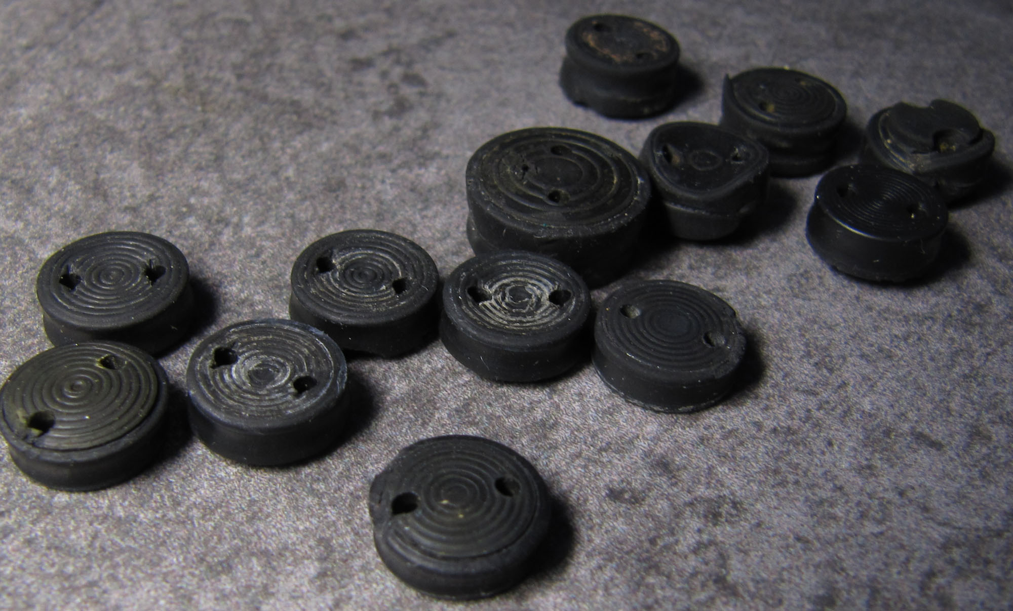

            Also, if anyone is wondering about my method of how I open the caps, here it is:
            Basically, I just take my side cutters and grab the capacitor's can at one corner on the bung side, then twist (out) and repeat until the whole folded edge over the bung is bent out of the way. After this, I use a pin or small metal pick to pry the bung out (should come out pretty easily.) Note that it also helps to straighten the capacitor's leads before trying to pry the bung out to make it come out easier.
            Nice!
            I see you "doubled-up" on the feet too. And it looks like in your case too, the "pad" for the rubber foot was the perfect size for a cap bung (8 mm?) I swear, this is what bad caps were alternatively designed for, lol.

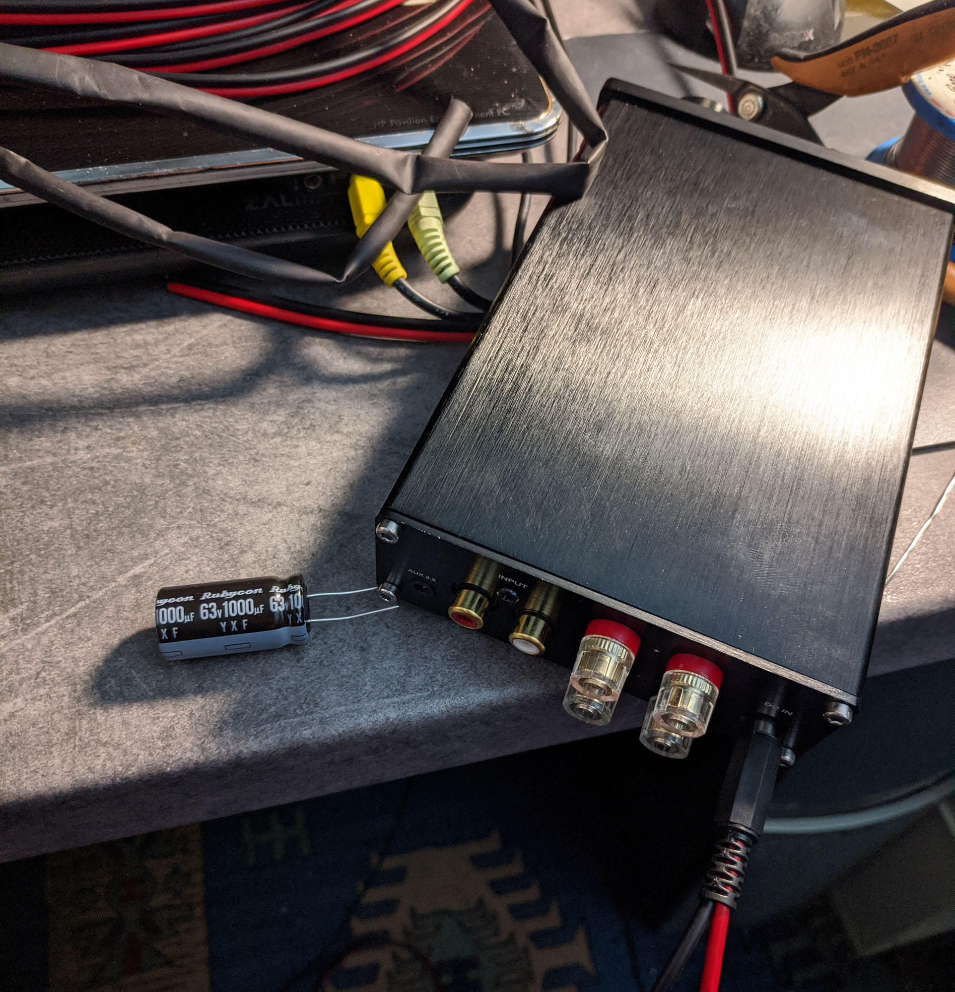

                                I bought this amp at a very good price of 54.35€, including shipping from China and any import fees and VAT all included in price.
                                Then, I had to figure out what power supply to get for it, because the amp doesn't include one, it just has the common input jack of laptops.
                                Amp IC can get up to 53.5V , but the amplifier has input capacitors rated for 50V, so Aiyima specifies a safe limit of 48V max input.
                                https://www.ti.com/product/TPA3255
                                https://www.aiyima.com/products/ampl...el-300wx2-hifi
                                Finally, the amp arrived and by the time it arrived I have already ordered the power supply from here:
                                https://www.banggood.com/RIDEN-RD600...e=CN&ID=520831
                                I got the 48V version for 32,74 € including shipping and fees. According to specs it can do 400W 8.3A.
                                There is also a tear down link of the amp here:
                                https://www.audiosciencereview.com/f...ar-down.19020/
                                Do you think those Nichicon HE caps are genuine? They are rated for 50V 1000uF.
                                Pointing through the ventilation grills with a spotlight I found that the power supply has 4x 63V "Chang" 470uF output capacitors.
                                According to specifications, maximum ripple is 240mV peak to peak.
                                I decided to add a cap in case it helps to lower the ripple and AC mains hum that could pass to the output of the cap (check review).
