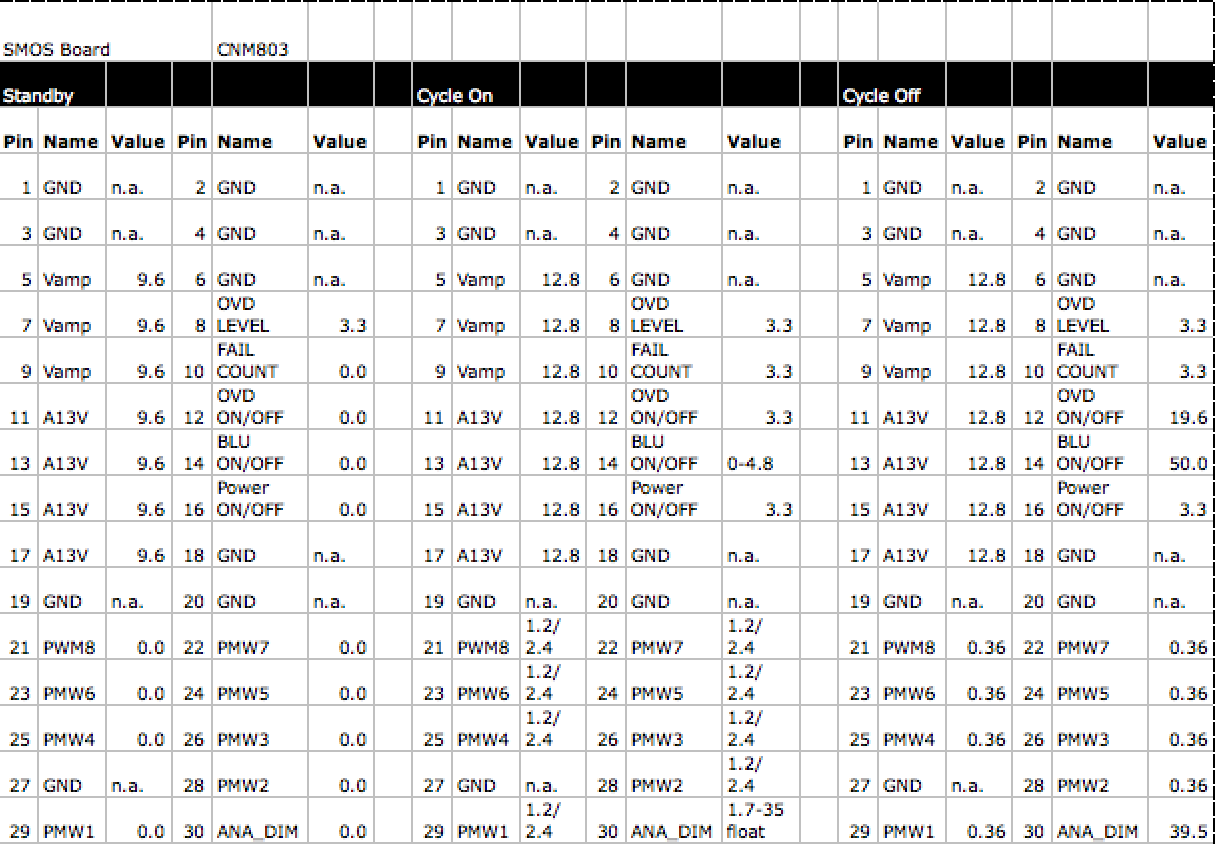

                      • SoftwareHack
                        • Oct 2020
                        • 59
                        #31
                        Re: Samsung UN55KS800DFXZA Ver. AA02 with the seemingly common power cycling problem
                        Here's what I got when checking voltages on the power connector CNM803 on the power board to the main board. The odd thing is that in standby mode, I would get different values for Vamp and A13V when I ran it at different times. It's as if shutting it down by pulling the plug didn't reset it to standby, but it remained constant until I pressed the power button.
                        The 3 main checks were done in Standby (before pressing power button), Cycle On (when backlight flashed on briefly and sound was on for a second), Cycle Off (when backlight went back off and no sound was heard but not quite back in standby mode).
                        I ran the test 4-5 times with the same results except for what was noted above during Standby mode during different tests.
                        All cables connected in this test.
                        Thoughts?

                          #32
                          Are you sure about the last column OVD ON/OFF=19.6 VOLTS and BLU ON/OFF=50 VOLTS? And your getting 4.8 volts at BLU ON/OFF when it's on. I believe your fail count should be 0 if all is well, that looks off too, wonder if that's a backlight SOS? It doesn't seem like it should be tho, because your backlights stayed on with main to powerboard cable unplugged.

                            #33
                            Yes, got the same numbers on at least 2 different runs.
                            When Cycle On BLU ON/OFF floated between 0 and 4.8, never stopping on one value.
                            Also, the PWM numbers 1.2/2.4 means it was 1.2 when backlight flashed on and of 2.4 when sound could be heard briefly and 0.36 when it cycled off (no backlight, no sound, standby light goes on for a few seconds).
                            When in standby mode (before I ever push the power button) I can hear an audible clicking on the main board for 2-3 seconds that cycles periodically but nothing else lights up until I press the power button.
                            • SoftwareHack
                              • Oct 2020
                              • 59
                              #34
                              i ran tests again on OVD On/Off and BLU On/Off and here's the consistent results: (backlight goes on for a second or so, same with the sound)
                              ---------------Standby--Clicking--Backlight On--Sound--Back to Standby
                              OVD On/Off--20.0------floating--3.3-------------0.6-----20.0
                              BLU On/Off---50.0------floating--0.0-4.8--------4.2-----50.0
                                #35
                                Are you sure the 20 and the 50 readings are not in mV?
                                They cannot be 20V or 50V since the logic circuit does not run on that high of the Voltage.
                                • SoftwareHack
                                  • Oct 2020
                                  • 59
                                  #36
                                  You are correct. My meter is not illuminated and I did not see it switch to mV on the fly, so those are mV numbers.
