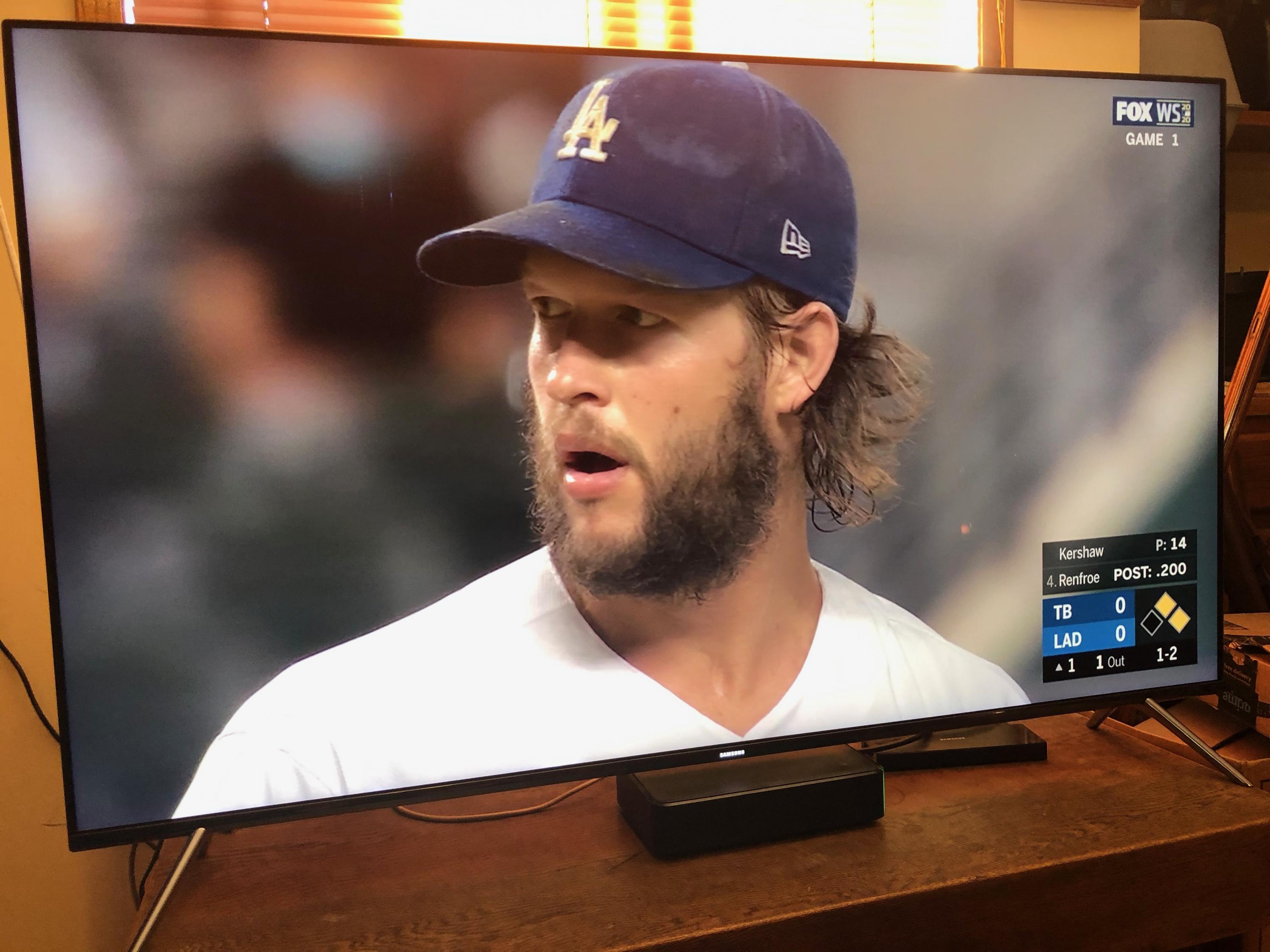

                Re: Samsung UN55KS800DFXZA Ver. AA02 with the seemingly common power cycling problem
                I found my cheap soldering iron that I bought when I couldn't find my soldering equipment. It had a set of tips, one of which was a angled flat tip. I was able to heat up the chip enough to melt the existing solder and remove the diode array. Then cleaned it up with a wick and alcohol swab. I now have it plugged into a surge protector. This is the result! As an SF Giants fan, never been so happy to see Clayton Kershaw on the mound.
                Thanks to everyone who helped me through each step, and getting me past my presumption that all power cycling issues were the same when I thought that I had isolated the issue to the mainboard.
                My next project is an old Dell Latitude laptop with a dead screen...

                  #128
                  Yep Kilroy nailed it, another fine save, nice job and good teamwork.
                          Glad you have it sorted now. I posted the datasheet of the diode array so you could replace it if you want.
                          Little tip on these sets, turn the back light down about 15-20%,reduce the brightness and contrast down a few percent. Those 2 resistors that showed the pulsing will thank you.
