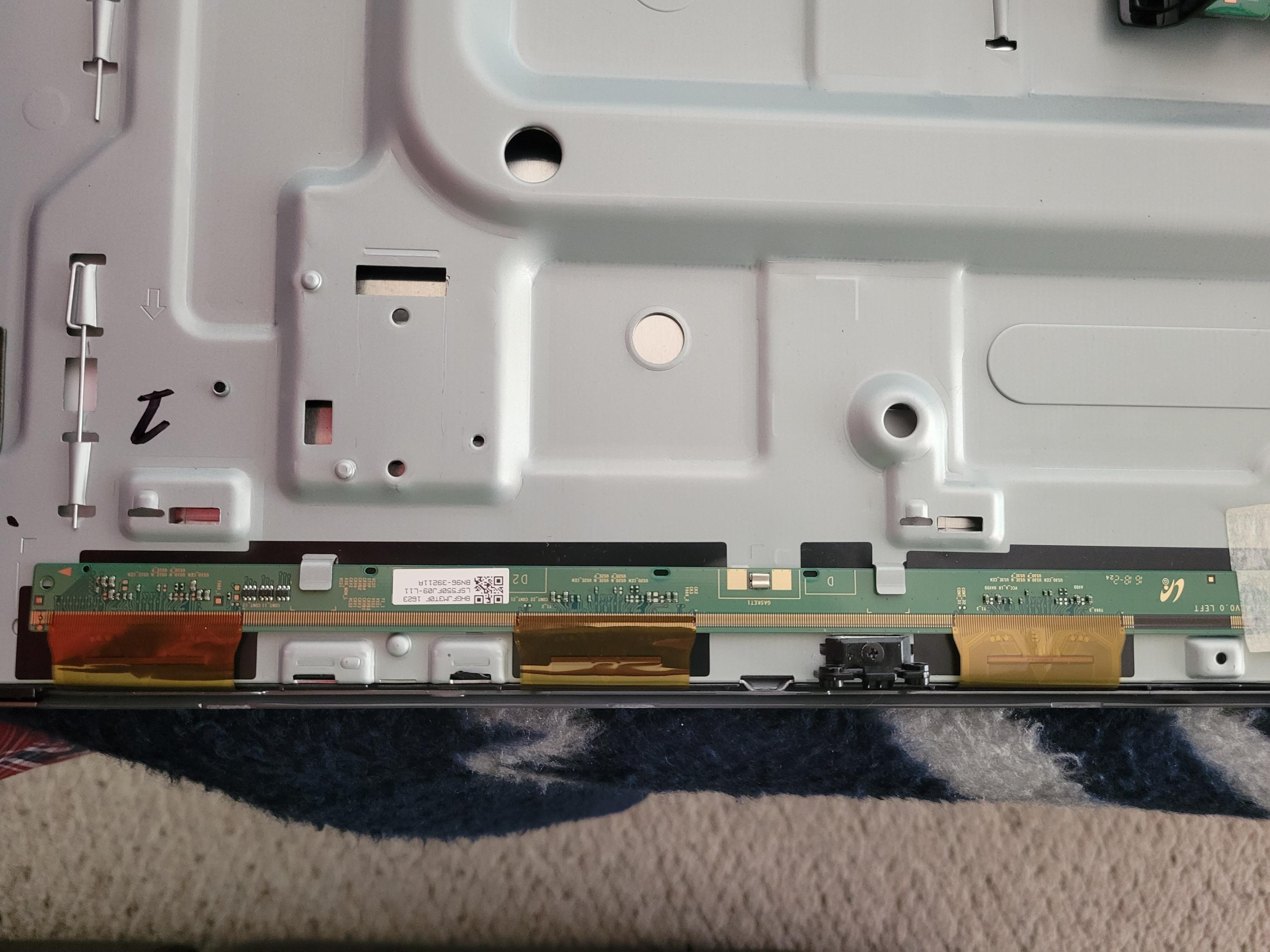

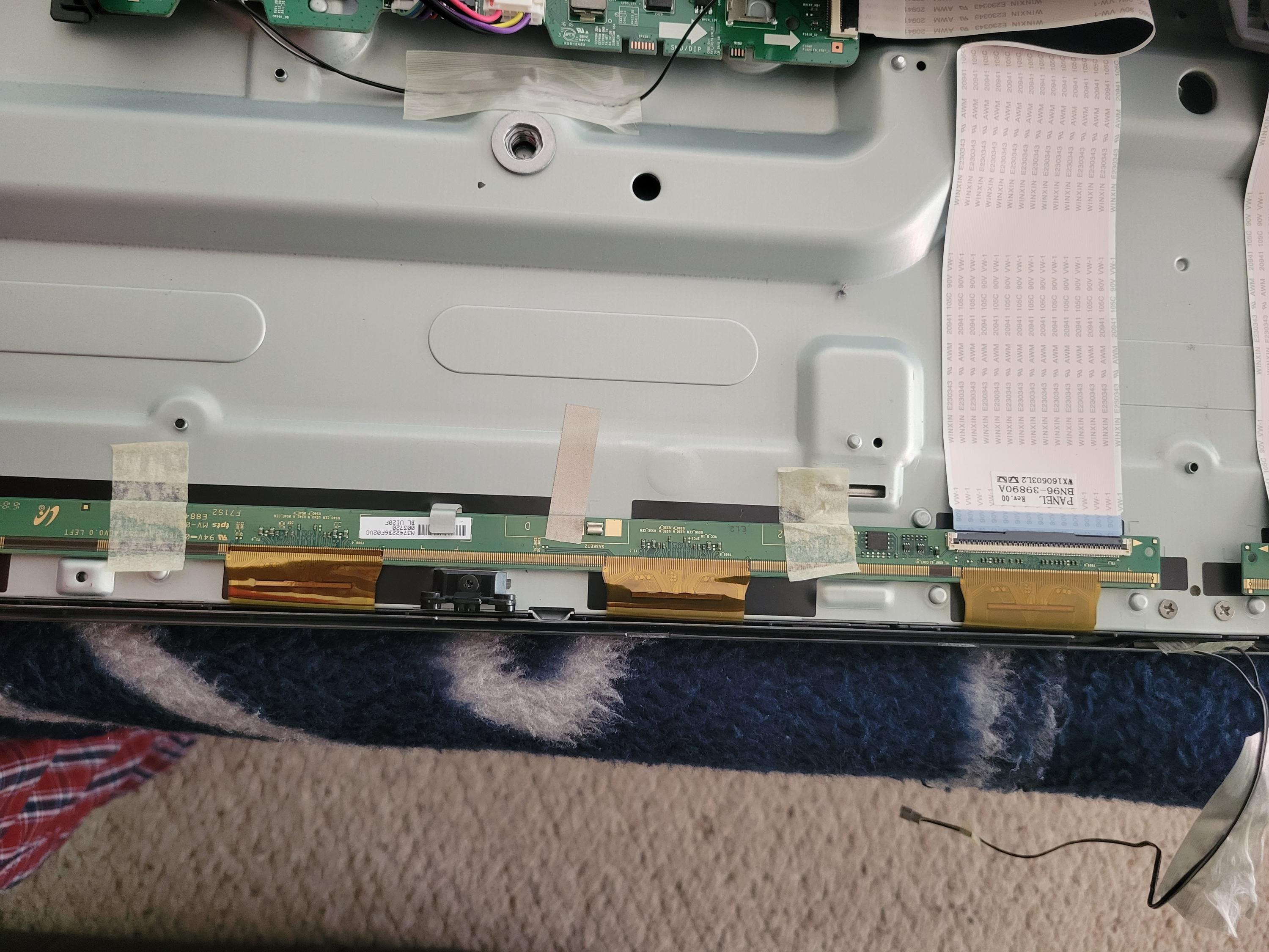

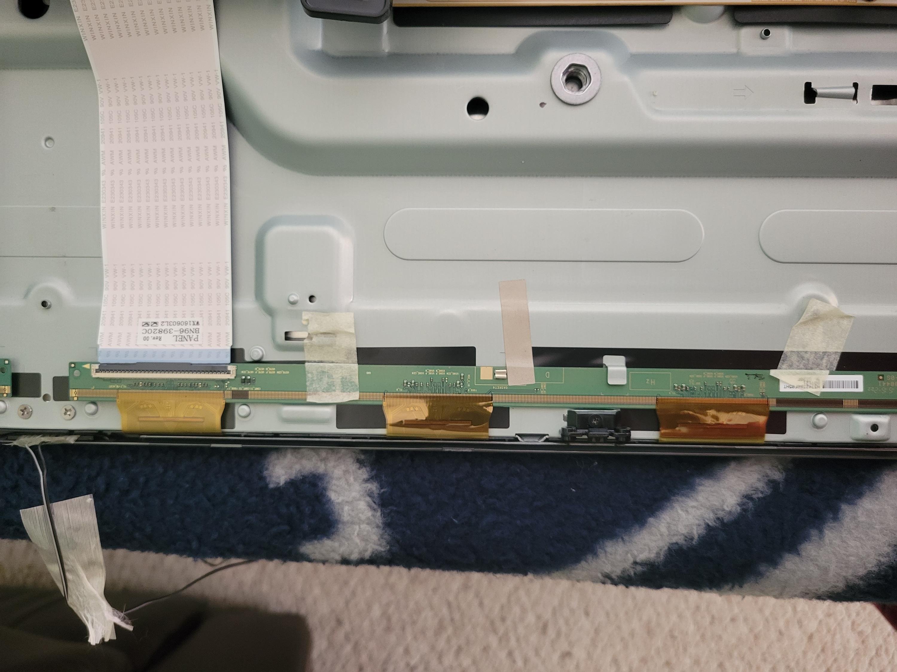

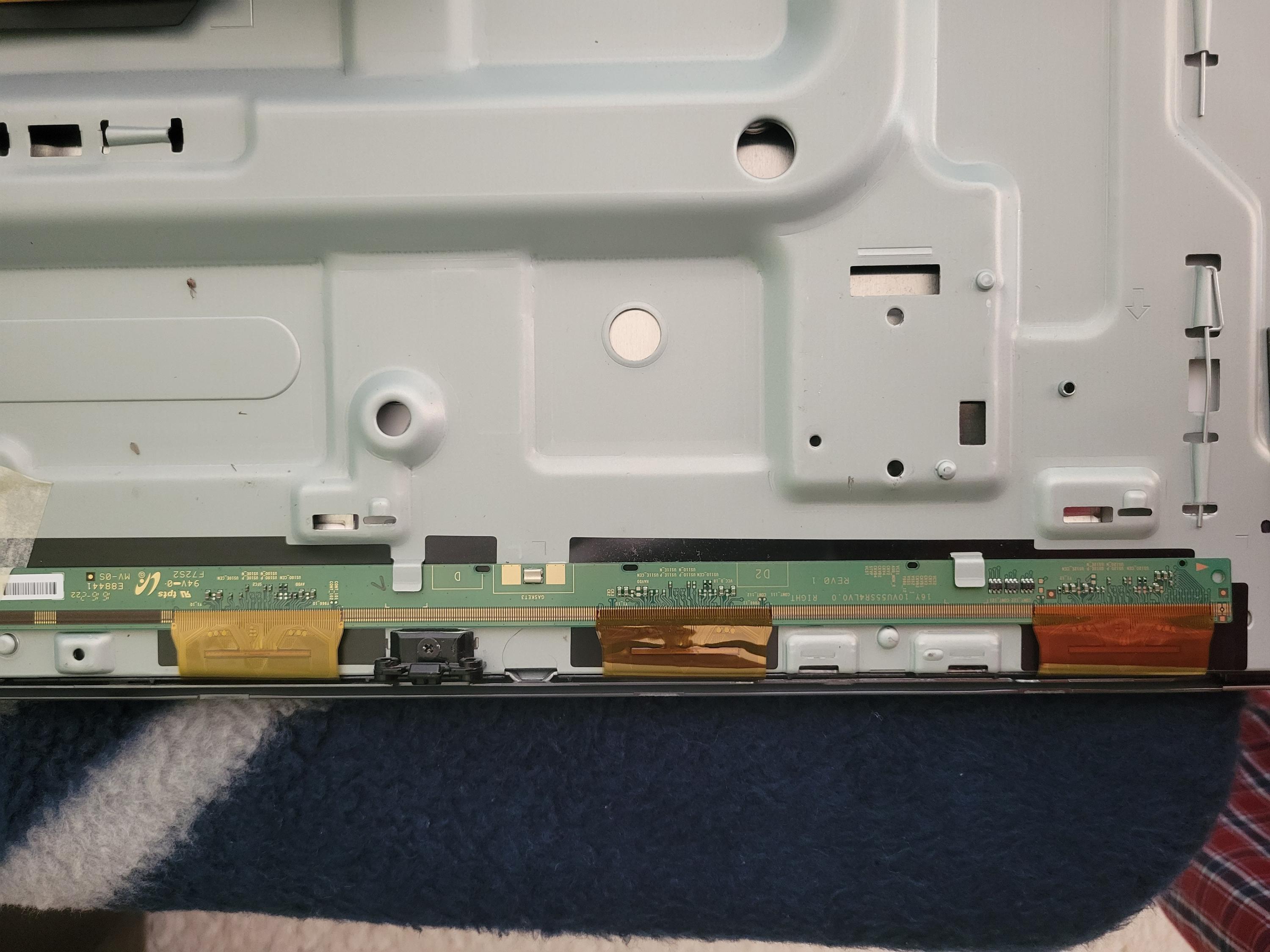

                          Hi folks,
                          I seem to be having the same issue, and was hoping to use the fix here. I even bought the replacement resistors and diodes. But I should have opened the TV first. Turns out my drive boards look nothing like those pictured here (see attached images). Is the advice is this thread applicable to this version of the Samsung UN55KS800D? If so, can someone provide some guidance - e.g. which of these tiny things is the equivalent of the infamous D005 diode? Apologies if I'm omitting important info, I'm a software guy (like OP) but with even less hardware know-how.
                          Thanks, hoping to not toss an until-now-great TV into the scrap heap...
