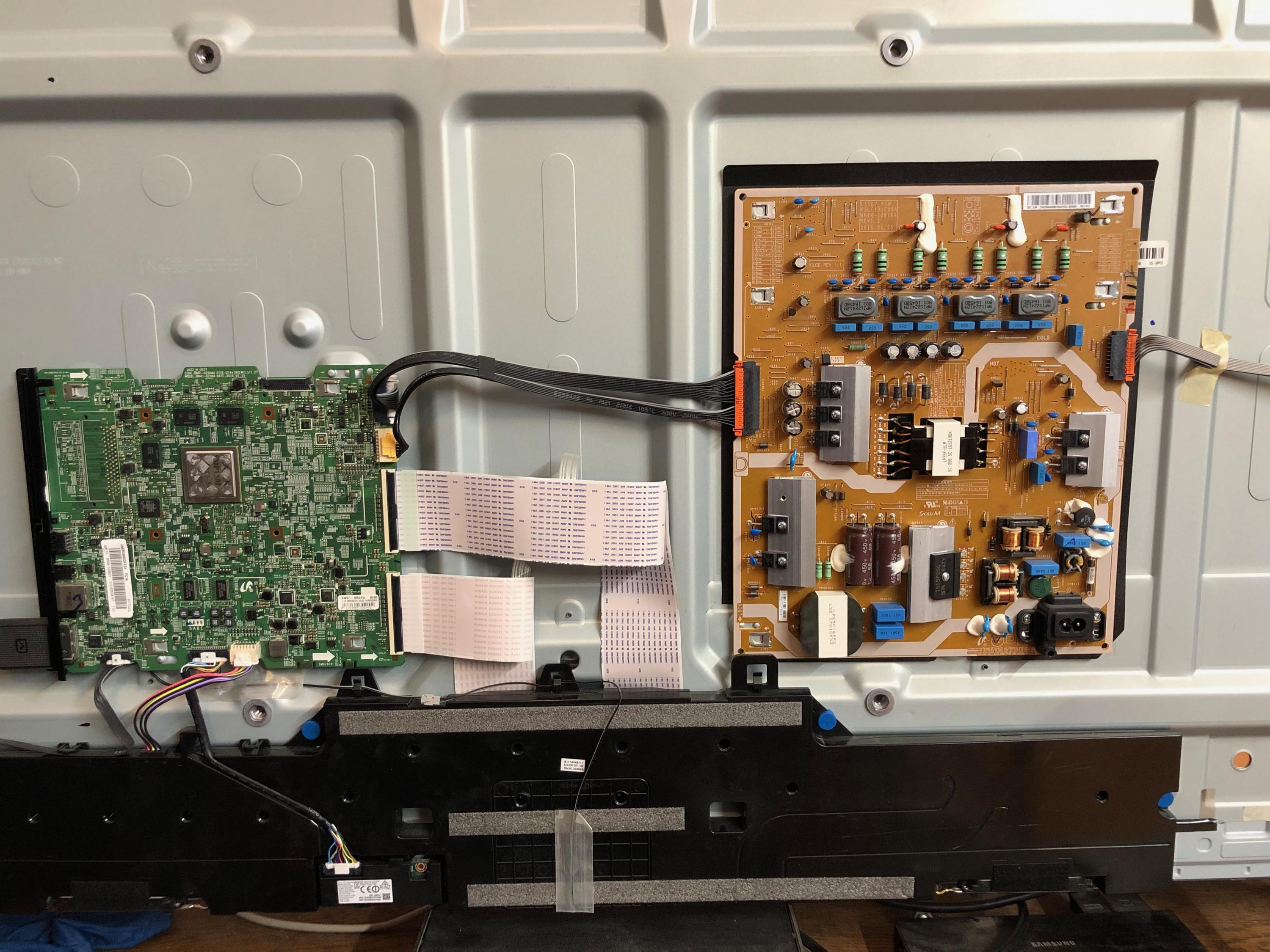

                      Re: Samsung UN55KS800DFXZA Ver. AA02 with the seemingly common power cycling problem
                      Here's a picture of the backside of the TV. T-CON built into the main board. Tested with panel (and wifi, sound) disconnected at the mainboard with the same power cycling pattern. Also, power board tested with only the backlight (no mainboard) with the backlight staying on. Based on these two results, I limited my focus on the main board. Did I make an incorrect assumption?
                      (heat sink temporarily removed for checking for hot spots).

                        #71
                        I have to agree here, I have done two of these in the past couple of months. One was the diode and the second one was the resistors ( just repaired it this morning).
                        I was fairly certain the unit rebooted with the LVDS cables disconnected but I am not 100% sure it was the case so I didnt push the issue.
                        The second one I worked on only had vertical banding which was the result of failed resistors.
                        Personally I think it fails because in both cases the tvs were set to Backlights 100%, Brightness 100% and contrast 100%.

                          #72
                          Just for giggles and squirts, lay it down and pop the speaker off, pop the legs and brackets off then remove the metal strip along the bottom that covers the driver boards and take and post a high res pic of both outboard driver boards please.
                          And while your there try Nicks suggestion to remove the left and right flex cables.

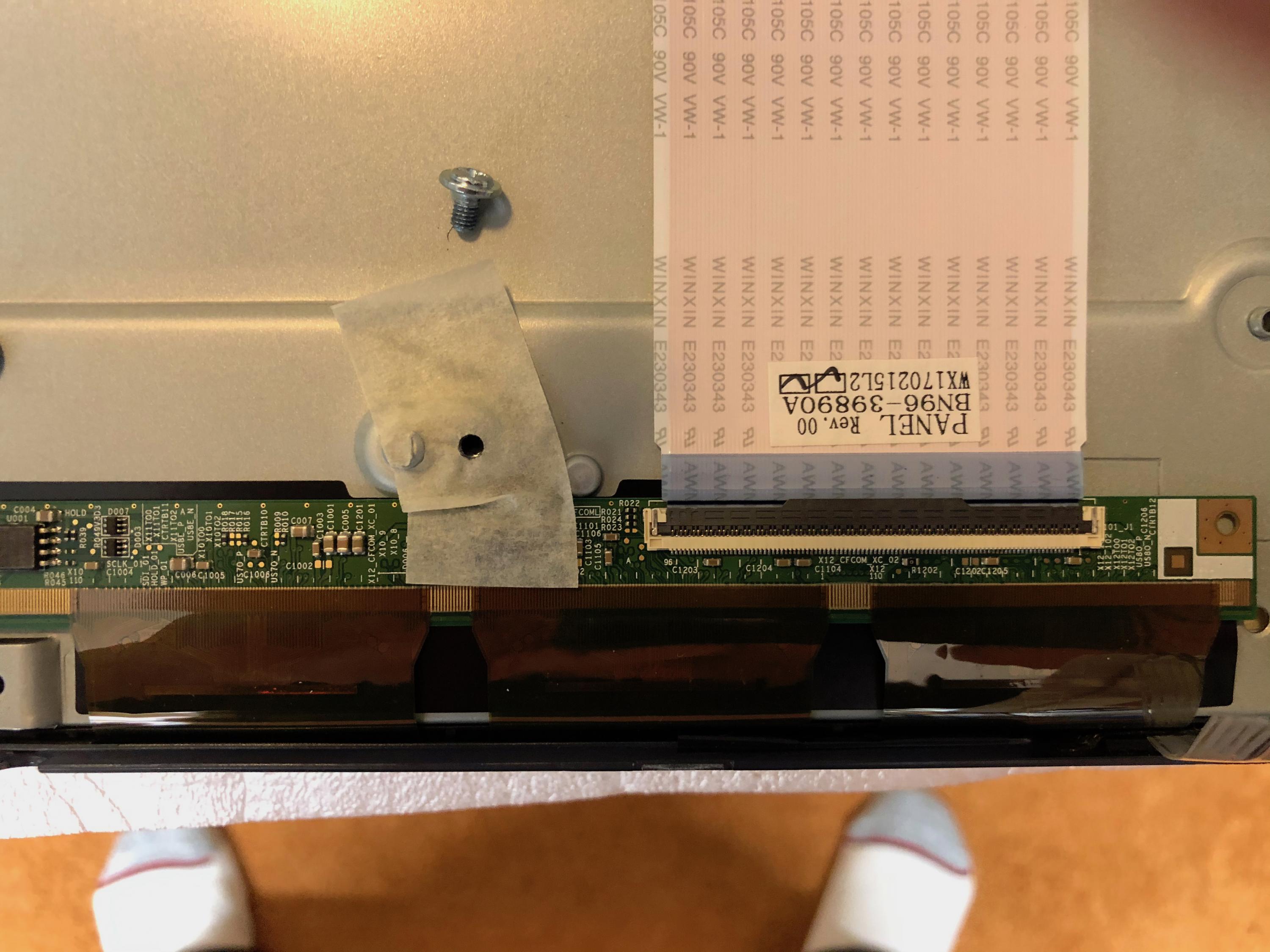

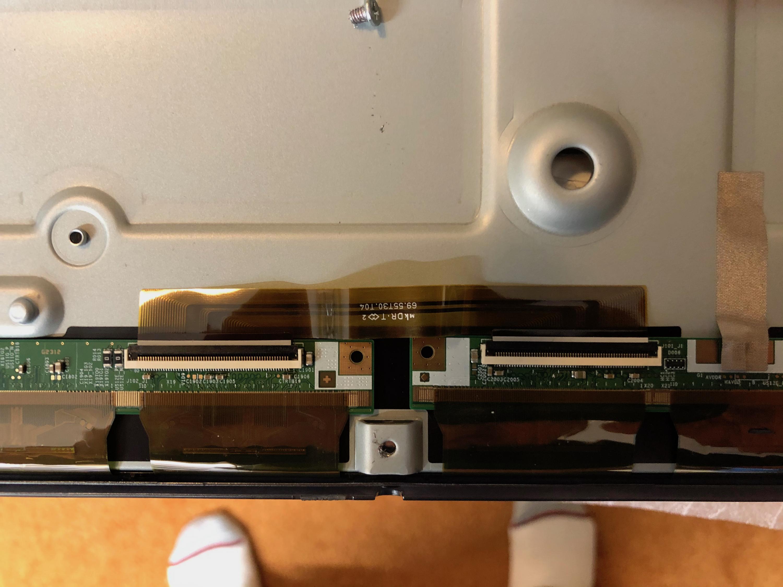

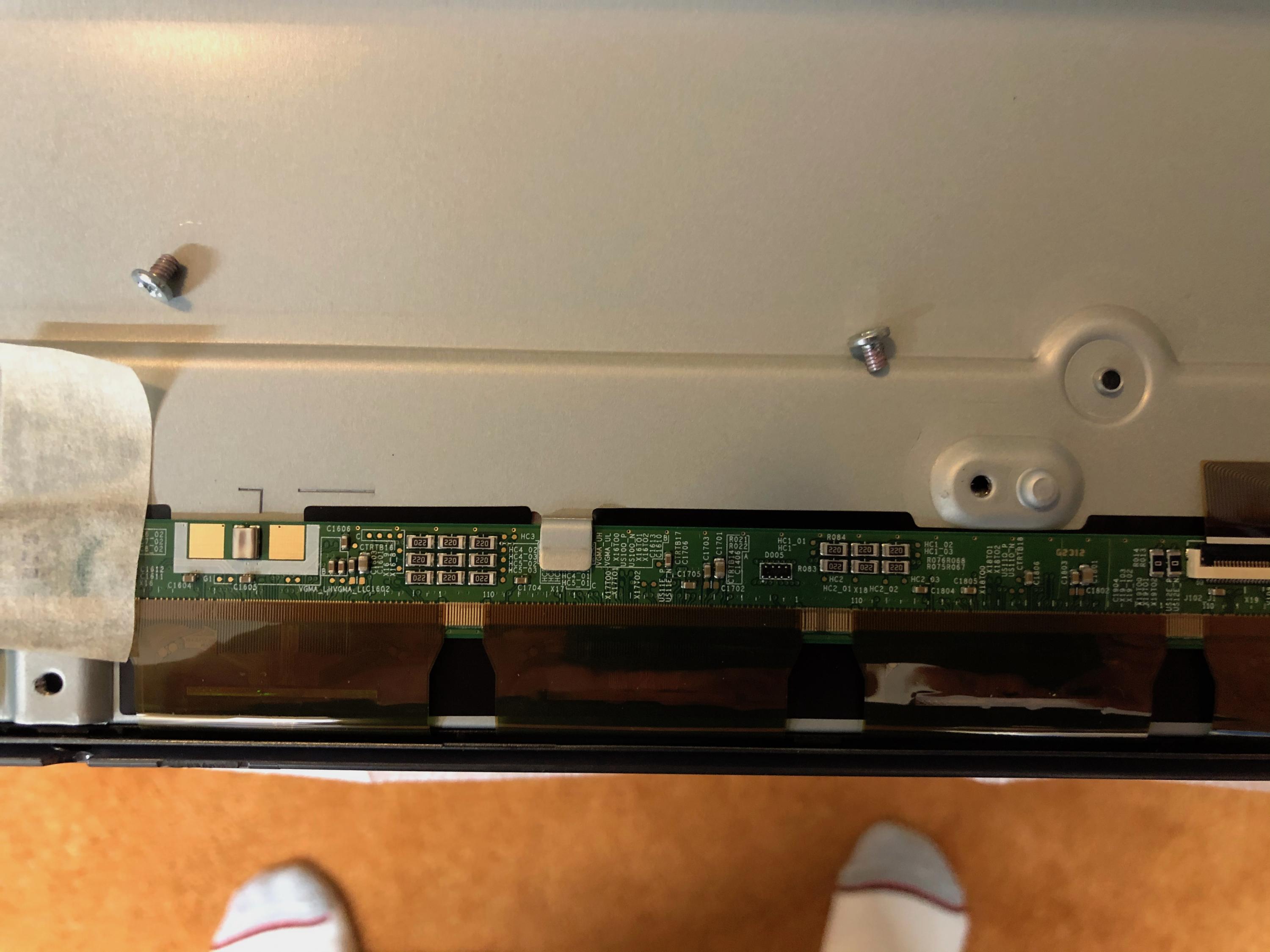

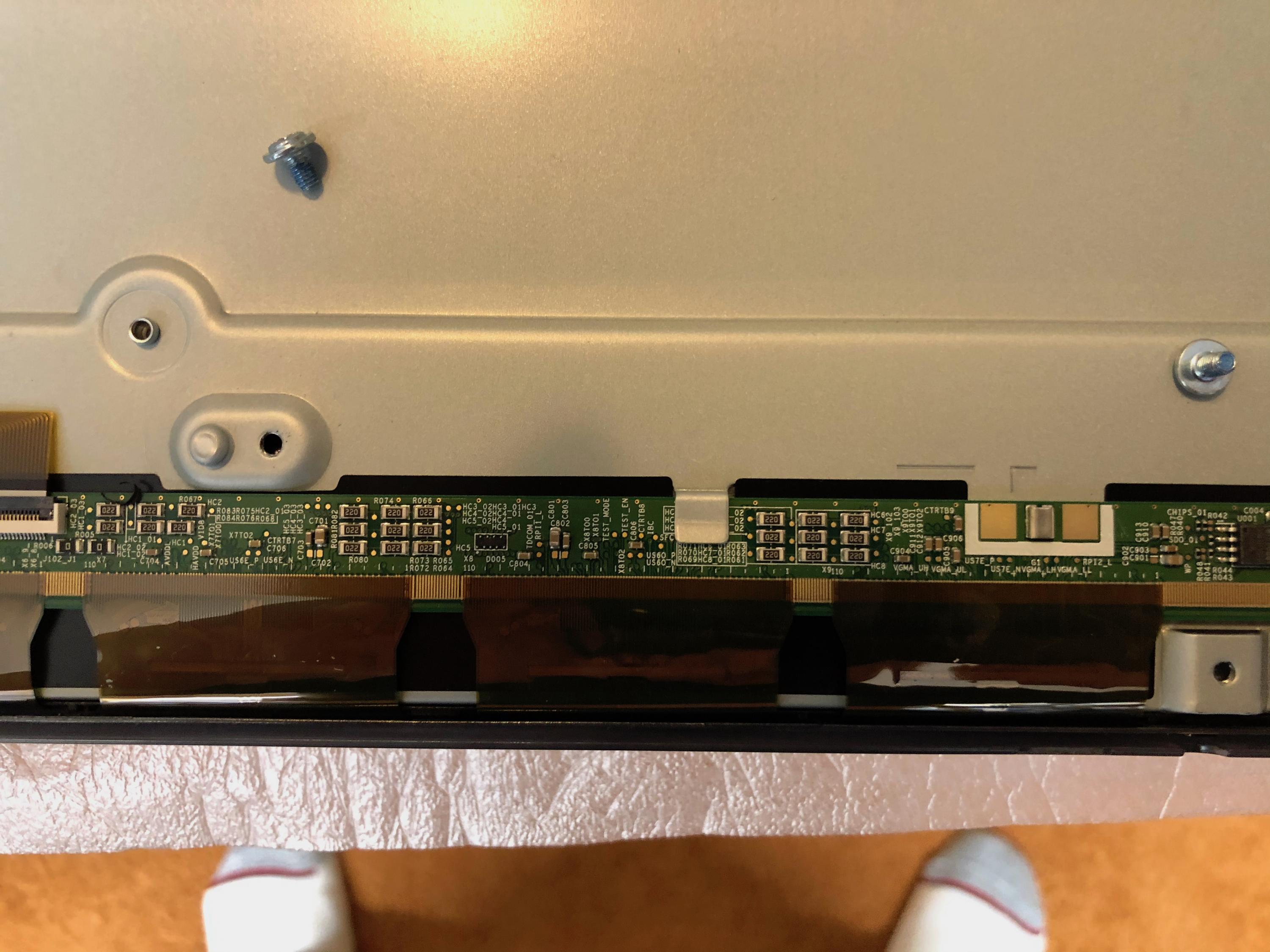

                            Here are a couple of pictures of the ends of the panel when I had the metal shield off the other day for a quick visual inspection.
                              Resistors look ok,
                              On the very outer ends of the boards you see those little black bits that look like 10 pin devices.
                              Those are Diode array devices. the center pad on both sides is your common, i think cathode (someone please correct me if i am wrong)
                              Test with a meter set to continuity between the center pad and the other 4 pads. If any show continuity then you have your problem device.

                                #75

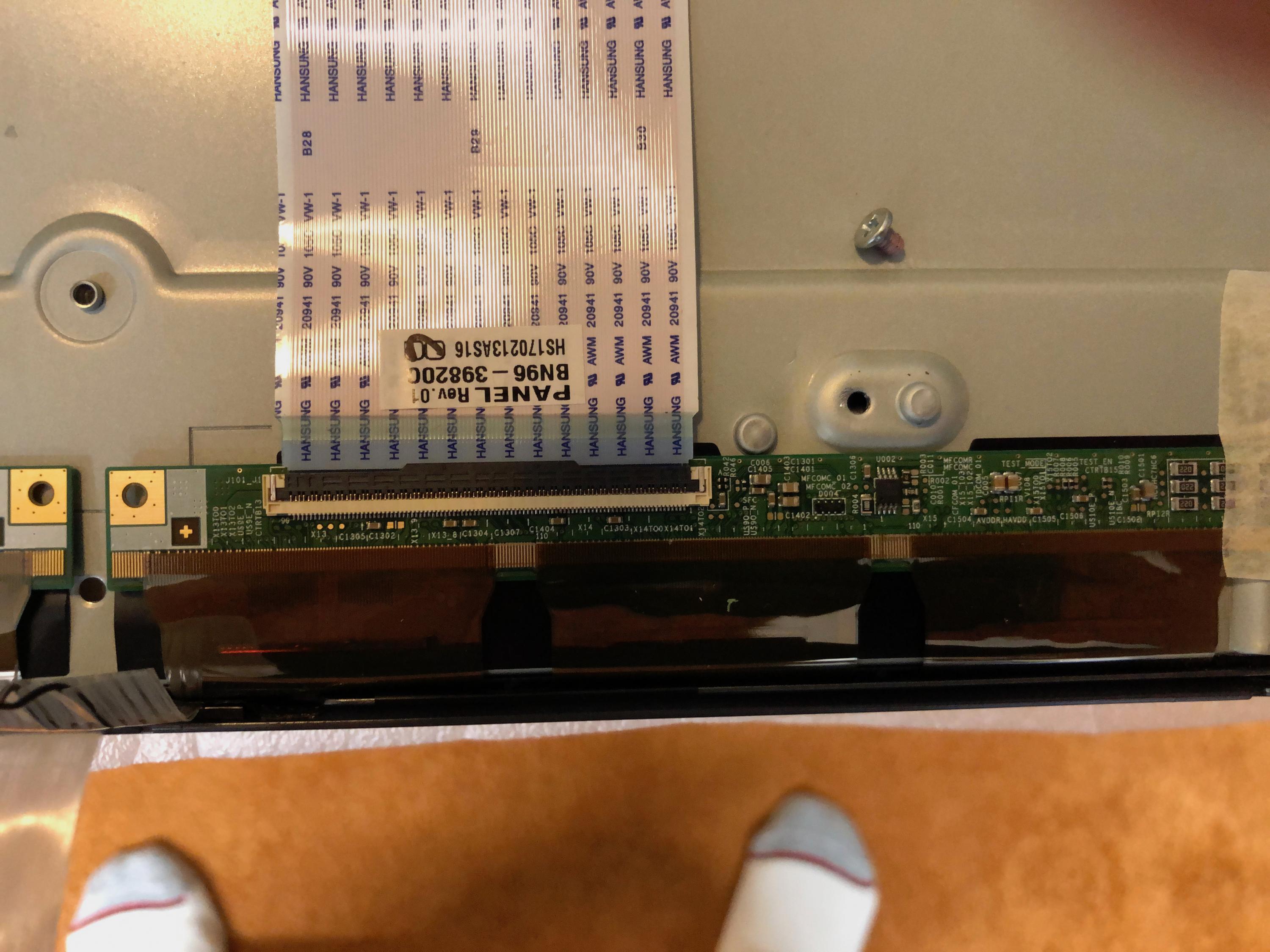

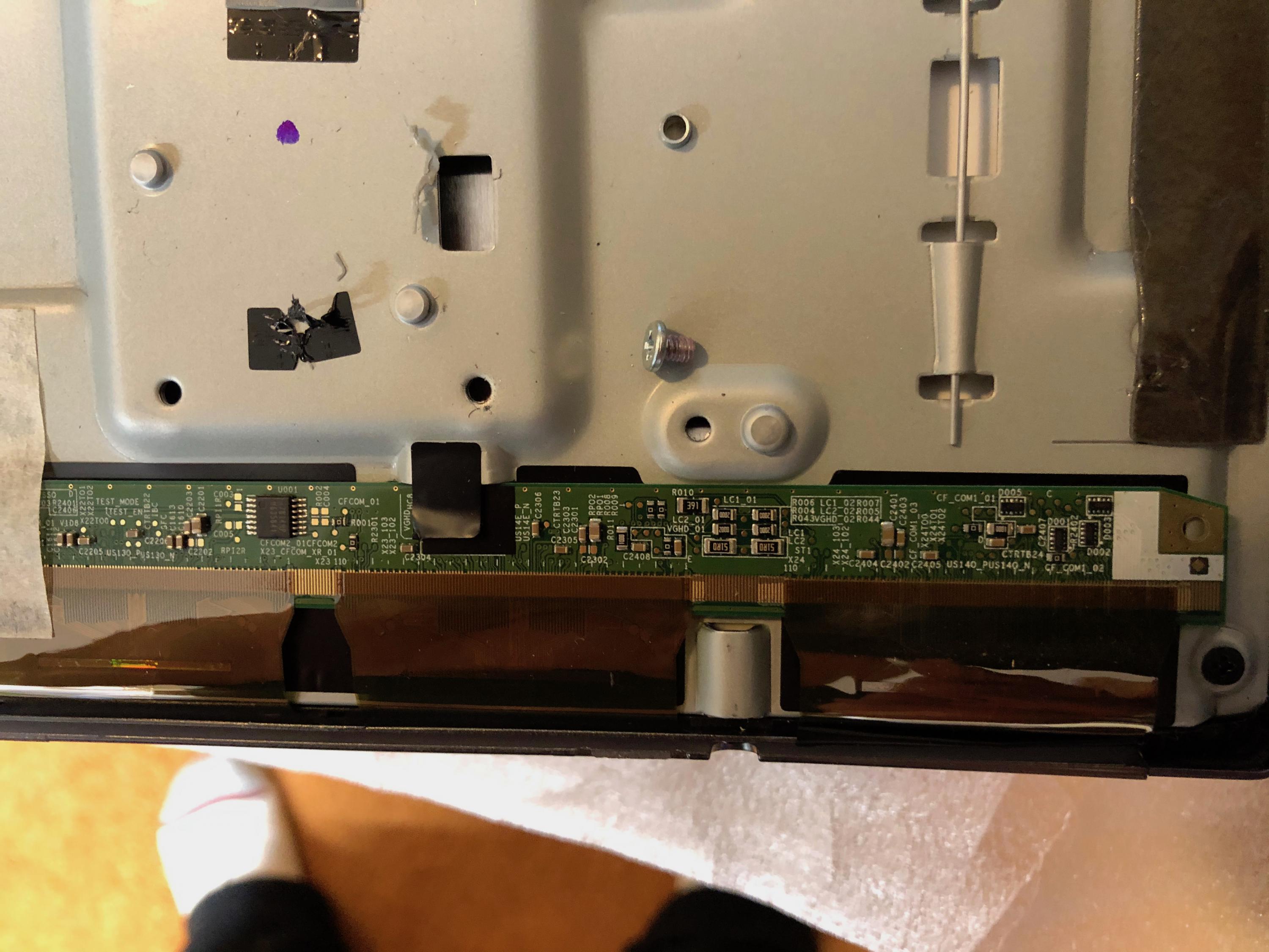

                                Here's the rest of the driver boards.

                                      #78
                                      https://www.badcaps.net/forum/attach...4&d=1602625575
                                      https://www.badcaps.net/forum/attach...9&d=1602625575
                                      You have two linker cables that you can try disconnecting per Nick's TV.

                                          #80
                                          Well sheeeeet...With the linker cables disconnected to the outer boards the power cycling stopped! I didn't have any source connected so I didn't have any picture, but the fact that the backlight and standby LED stopped cycling on and off, I'm sure the problem is on the panel. Oddly, when I unplug the ribbon cables from the main board, the cycling starts again. I suppose the firmware detects this as a panel fault and starts the reboot cycle?
                                          Now to isolate the particular issue. However, I have a new problem. I forgot that the picture is zoomed 20x or so and my multi-meter probes are too big to check individual pins on the diode array IC. I had ordered some previously, but they won't arrive for a few more days. Visually, I see nothing wrong. I'll post my results when I have more info.
                                          What would be the possible harm in removing one of the diodes without replacing it? I don't have the tools the install (much less remove) surface mount IC's.
                                          Thanks to all for the help in getting me this far. I was convinced that it was the main board...
