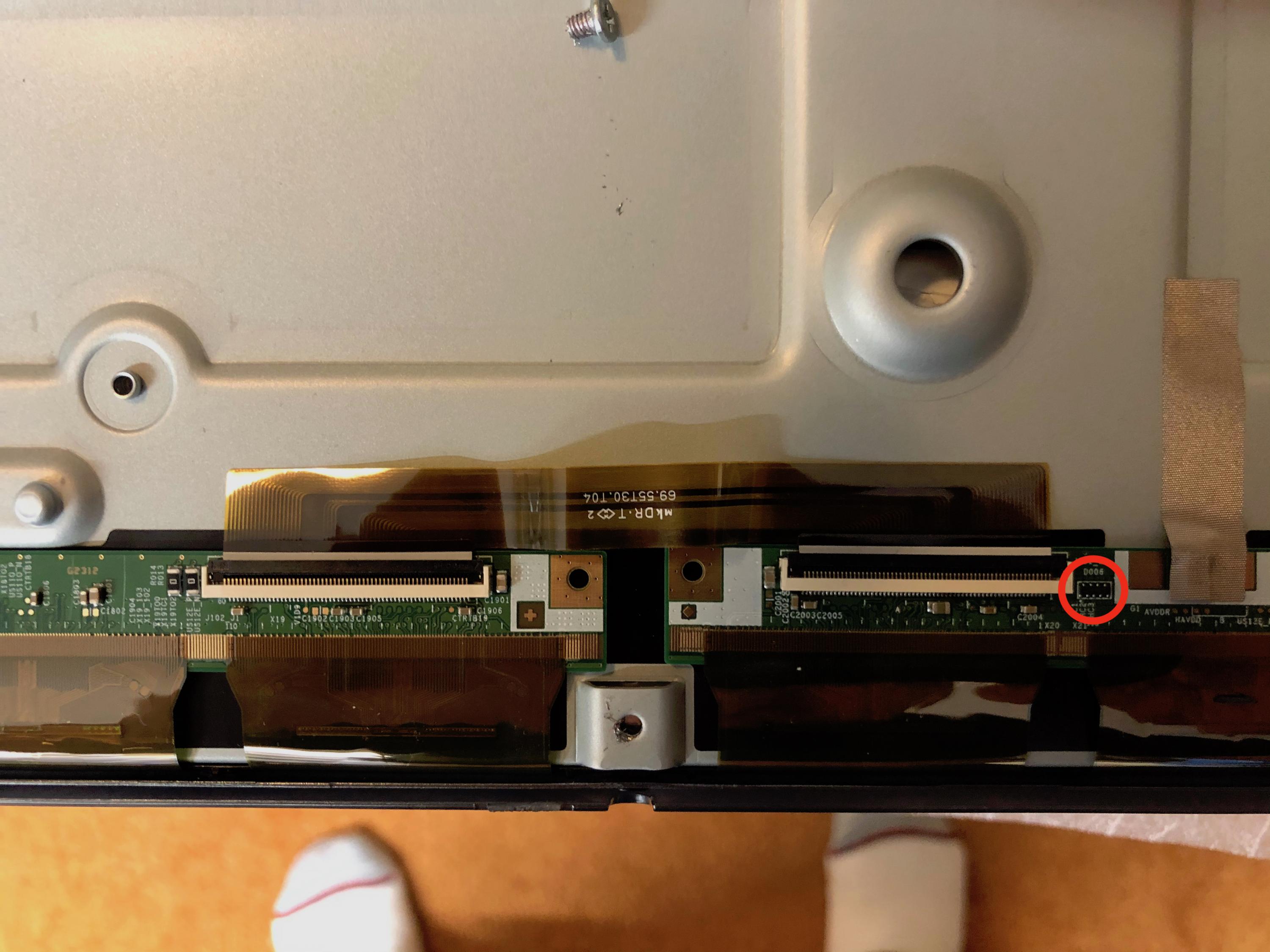

    I pointed to the diodes as a potential point of fault, I do not recommend just removing them willy nilly without finding the 1 thats faulty.
    You can narrow down what side the fault is on by reattaching the flex one side at a time.
    Once thats sorted, you can try the lighter fluid method or sharpen your probes and test them, If they test ok then it could be a capacitor. test for a shorted cap as well.
    I wish i would have taken video of the one I located the faulty diode on, it was like watching a liquid heartbeat.

        So, the power cycling happens only with one of the sides is connected so I'll start looking there.

          If your resistors are good then find the shorted bank of diodes on the ends of the outter boards.
          They will be shorted. PS they are all in parallel I believe. I don't have the TV anymore so I can't double check but all will appear shorted I think even though not all are bad.

              Maybe also test those little ceramic capacitors. You can test them for shorts or low ohms, multimeter set to 200 ohms test probe on each side of cap, see if any read short or read very low ohms, I would be suspicious of any testing lower than about 100 ohms, most will probably read higher, often only one is bad but it will make several read bad, one technique is to remove one bad one at a time and check it again off the board and recheck any on the board that were reading bad, when you get the bad one off the others will read ok, if that is the problem.

                  Okay...armed with only a multimeter mind you, I checked resistance of all of the resistors and they all match the value printed on top. One 100 ohm resistor read 62 ohms, but I checked it against the identical one on the board on the other and and got the same result. I'm assuming it has something to do with what they're connected to? I then checked continuity on each capacitor and found that only one side of each connected to ground. I assume this means no shorts. I also tested each for resistance, they all zero'd then started going up continuously. As I understand it, this is what is supposed to happen when good. Now I have to test the diode arrays. I tested them for shorts a couple of times with sewing needles in alligator clips at the end of my probes leads as my pin probes are way too large. I could get continuity between the grounds on each side of the chip so the setup was working. I didn't find any shorts this way. I have some needle point probe leads coming and I'll retest when I get them. Is there a chance that it's the LED's themselves that are bad and causing this problem? I can't see how to disassemble the panel to get at them just yet.

                                          So I tested it 3 times with the lighter fluid. I used a q-tip to spread it on a small section at a time, enough to surround each component as well as leave a "bubble" on top of them and let it cycle a few times. I did small section at a time so I wouldn't miss anything. I did not see any movement other than when it started to evaporate evenly across the test area. This confirms what I saw with the infrared thermometer, just a slow heating up of the board pretty evenly across all components, no hot spots.
                                          BTW - D0006 also didn't show any movement.
                                          Is there another level deeper to check? What is between the buffer boards and the LCD, if anything?
