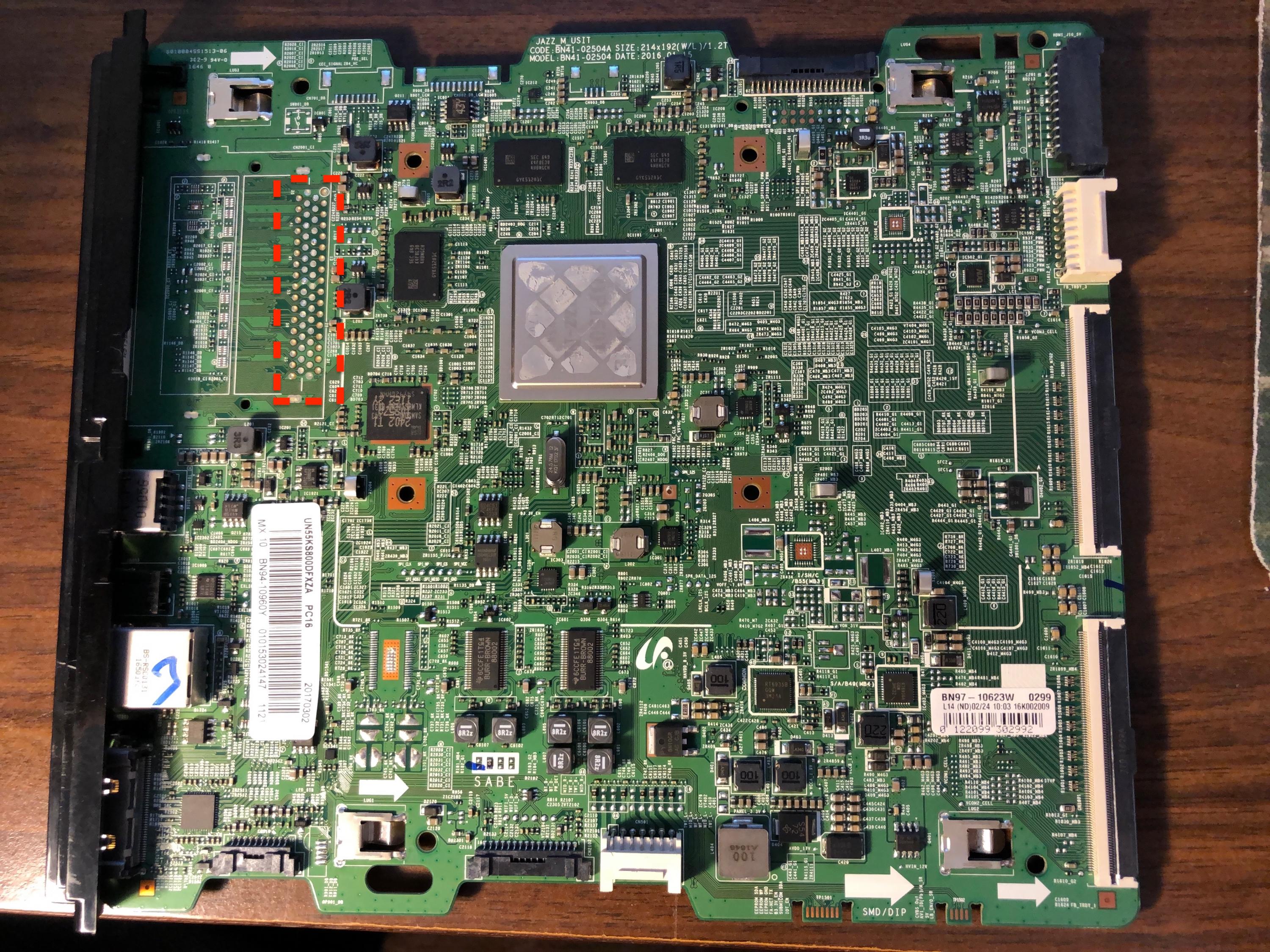

          Looks like you have the same dilema that I do, would have to remove the bga heatsink to replace the nand.
          • SoftwareHack
            • Oct 2020
            • 59
            #45
            Re: Samsung UN55KS800DFXZA Ver. AA02 with the seemingly common power cycling problem
            My heat sink is held on by push pins and the thermal conductor is non-adhesive so mine is easy to remove. The flash chip is also exposed with a cutout in the heat sink so I can freeze it w/o removing the heat sink.
            If you thermal conductor is an adhesive, you might be able to remove it by using a hair dryer to soften it up first.

                            • SoftwareHack
                              • Oct 2020
                              • 59
                              #54
                              I took apart the bottom of the panel to expose the drivers and didn't see any burnt spots or any chaffed or crimped cables. Everything tells me that it's on the main board, however, freezing the NAND did nothing. It's possible that I didn't keep it cold long enough so I'll retry it at some point.

                                Had mainboard in the freezer for effin 19 hours, hooked it up tried to get to service menu, tried to update thru usb, damn thing would not come on or light up, then after 20 minutes it went right back to 12 on 2 off routine.
                                • Davi.p
                                  Hobbist Tech
                                  • Sep 2009
                                  • 4537
                                  • Italy - Milan
                                  #56
                                  This freezing is a waste of time, the symptom tells about a short circuit not a software problem. If you wanna to follow funny stories of wine drinkers...
                                  The sh.cir. can be on the panel or tcon, it's hard to see, in general if it is on the panel the adapters on tcon part stops working and TV boots up normally and you can hear a tv channel if programmed..

                                    #57
                                    Mine won't boot up even when the main board is powered up with nothing else connected to it accept the power button. Backlight is also disconnected.
                                      I'm inclined to agree with Davi.p that it is likely a short somewhere on the main board.
                                      Plug everything back in how it should be then let it cycle a few times then feel around the main board for warm areas.
                                      Only feel around the Main Board, Not the power supply board.
                                          Nothing unusually warm. Only real warm spots are around the CPU, including the DRAM chips. The highlighted area was a bit warmer than other areas the same distance from the CPU. I used an infra-red thermometer rather than my hand for better accuracy...
                                          https://www.badcaps.net/forum/attach...1&d=1602459643
