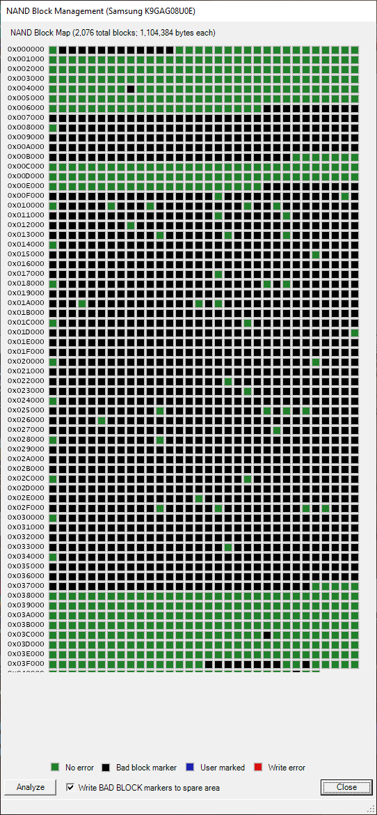

      Erased 3 times in a row. This is my full log what FlashCat software produces:
      Welcome to the FlashcatUSB interfacing software, build: 645
      Copyright 2023 - Embedded Computers LLC
      Running on: Windows (64 bit)
      FlashcatUSB Script Engine build: 312
      Serial NOR memory database loaded: 502 devices supported
      Serial NAND database loaded: 67 devices supported
      Parallel NOR memory database loaded: 405 devices supported
      Parallel NAND memory database loaded: 273 devices supported
      Connected to FlashcatUSB Mach?, firmware version: 2.29
      OTP/UV EPROM memory database loaded: 46 devices supported
      Voltage set to: 3.3V
      Detecting connected Flash device...
      Initializing Parallel NAND device mode
      I/O mode successfully initialized
      Attempting to automatically detect Flash device
      NAND clock speed set to: 20MHz
      Mode NAND X8 ASYNC returned ident code: 0xECD5847250
      Successfully detected device in NAND mode
      Connected to Flash (CHIP ID: 0xECD5847250)
      NAND device failed to load ONFI table
      Flash detected: Samsung K9GAG08U0E (2,176,843,776 bytes)
      Programming mode: Parallel I/O
      Page Information: 128 total pages; 8,192 bytes per page; 436 bytes extended size
      Block Information: 2,076 total blocks; 1,104,384 bytes per block
      Device interface: NAND (X8 3.3V)
      Loading NAND memory map for valid memory
      Total bad blocks: 1455
      NAND memory map complete: 79,488 pages available for access
      Flash device successfully detected and ready for operation
      About the full chip erase it doesn't provide detailed information, only 2 lines:
      Sent memory erase command to device: Samsung K9GAG08U0E
      Successfully erased NAND Flash device
      I'll try to find where it logs the BBs list. Or is it not worth that because is it a highly damaged NAND beyond 'point of no return' ?
        No official BB list produced, so I managed to wrote down the BBs from the programs graphical interface. It is not less than 1455 (picture):
        2-13, 137, 215-377, 471-497, 499-510, 512, 514-518, 520-522, 524-532, 534-535, 537-561, 563-568, 570-584, 586-619, 621-626, 628-632,
        634-640, 642-699, 701-753, 755-768, 770-790, 792, 794-835, 837-847, 849, 851-896, 898-916, 918-959, 961-1024, 1026-1051, 1053-1106,
        1108-1140, 1142-1152, 1154-1195, 1197-1206, 1208, 1210, 1212-1221, 1223-1271, 1273-1280, 1282-1291, 1293-1408, 1410-1428,
        1430-1487, 1489-1515, 1517-1521, 1523-1530, 1532, 1534-1536, 1538-1650, 1652-1664, 1666-1787, 1943, 2033-2040, 2043, 2074.

          But there cannot be so many physical Bad Blocks, it can be the remains of a dump and in it these BBs or the programmer considers them as ECC.
          Try to thoroughly clean all the legs of the Nand Flash from flux, rinse it in isopropyl alcohol and acetone, here you need good contact between the legs and the adapter itself.

            I did it initially before I did anything (fiber glass pen + isopropyl alcohol), but I'll give it a second chance. Now I did it again.
            Something I don't understand: when the software recognising the NAND the message is "loading NAND memory map for valid memory, total bad blocks: 1455". And when I fiddled with the "Analyze" button in the "NAND memory map" menu, a window popped up with "Warning, this operation will erase and overwrite all blocks, continue?". Yes, of course and the process finished less than a second and then the displayed green-black blocks changed to yellow with a question mark in them, and the title says "NAND blocks analyzed (0 bad blocks found). But if I redetect (reinitialize) the NAND, the number of the BBs remains 1455.

              Yes, it’s strange here either the nand flash is completely dead (try to find exactly the same used or new one) or the programmer does not understand the algorithm of this nand, I have never had more than 10 physical BBs in this NAND.

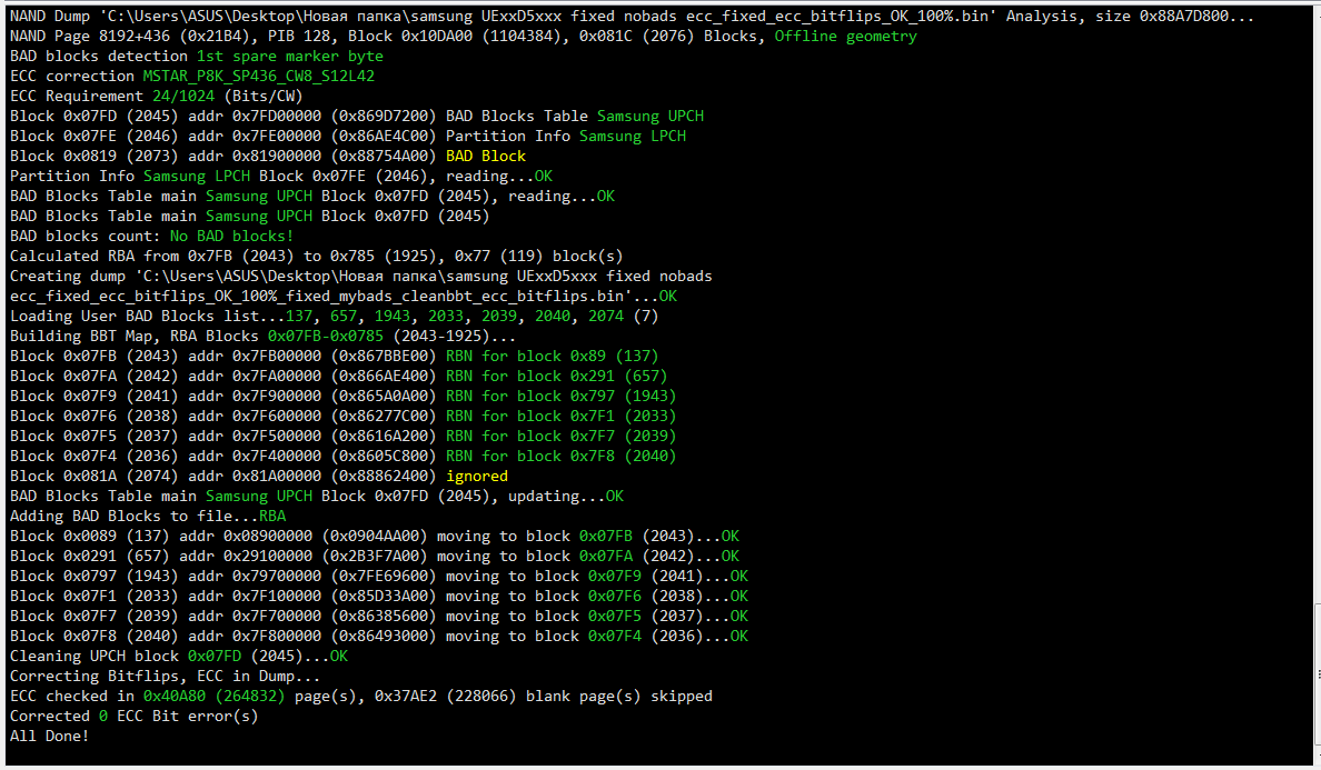

                I think the software is buggy. After I turned off the bad block management and erased the NAND and activated back the BB management, the number of the bad blocks decreased to 7. I really hope this is their valid number.
                137, 657, 1943, 2033, 2039, 2040, 2074.

                  Yes, now it looks more like the truth, but for some reason the BB at address 2073 is not shown, it is present on everyone, even in these new nands.

                    Interesting. What if we take it as bad, that won't be a problem if we don't write on that block, isn't it?
                    Edit: As I found I can manually discard blocks as bad blocks, so I discarded the 2073.
                    Edit 2: It is just temporary so not written onto the BB table. After I redetected the NAND the manually disabled block disappeared. Or maybe I did something wrong.

                      This is what happened under your BB.

                        In private messages there is a link to your dump, write it down as is (without missing BB!).
