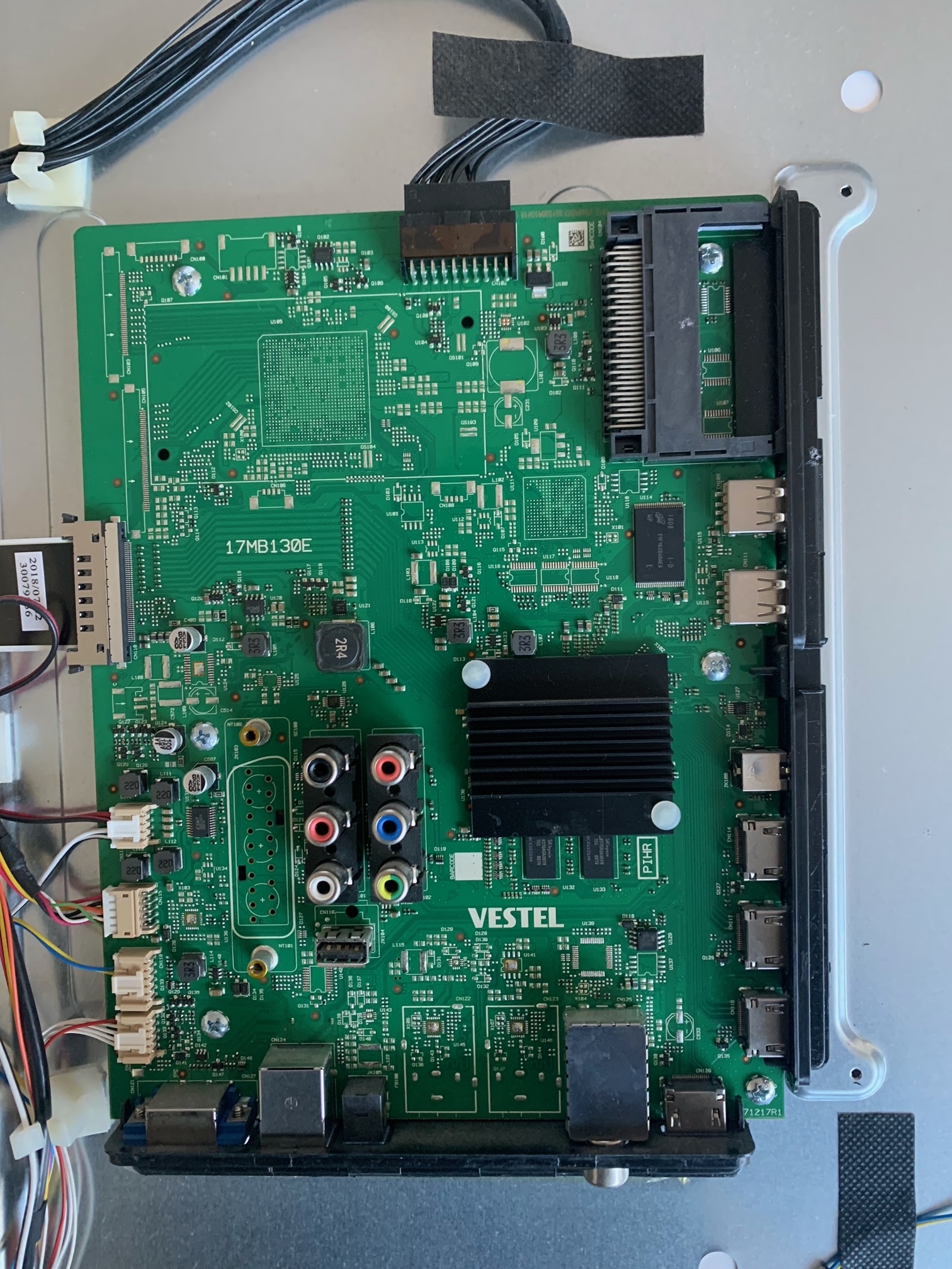

                              #1674
                              JVC LT-43C888 (manufactured by Vestel) - Looking for firmware (V.3.62.35.2) or (V0.51.19.3)
                              Images attached
                              Panel: VES430QNUL-2D-U01
                              Mainboard: 17mb130E
                              thanks
