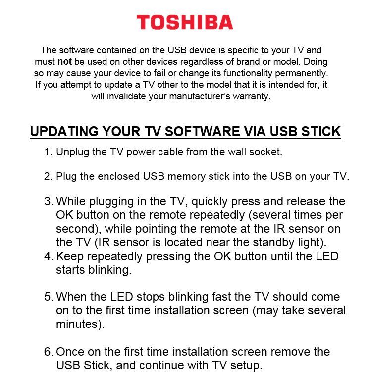

                                        #1659
Name:	Toshiba update via USB.jpg
                                        Tv stuck on Toshiba Splash screen.
                                        Guys here is the Software provided by Toshiba. ## Can someone help as I keep getting - Error: PHP Max Post Size has been exceeded. when trying to upload zip file, thanks ##
                                        Toshiba: 55T6863DB
                                        Mainboard: 17MB130S - 23495635
                                        Panel number: VES550QNYL-2D-N01​
                                          SMDFlea commented
                                          Editing a comment
                                          Splitting the attachment might fix that
                                      • StephenU
                                        • Dec 2013
                                        • 230
                                        • United Kingdom
                                        #1660
                                        ok will try that now, Thanks
