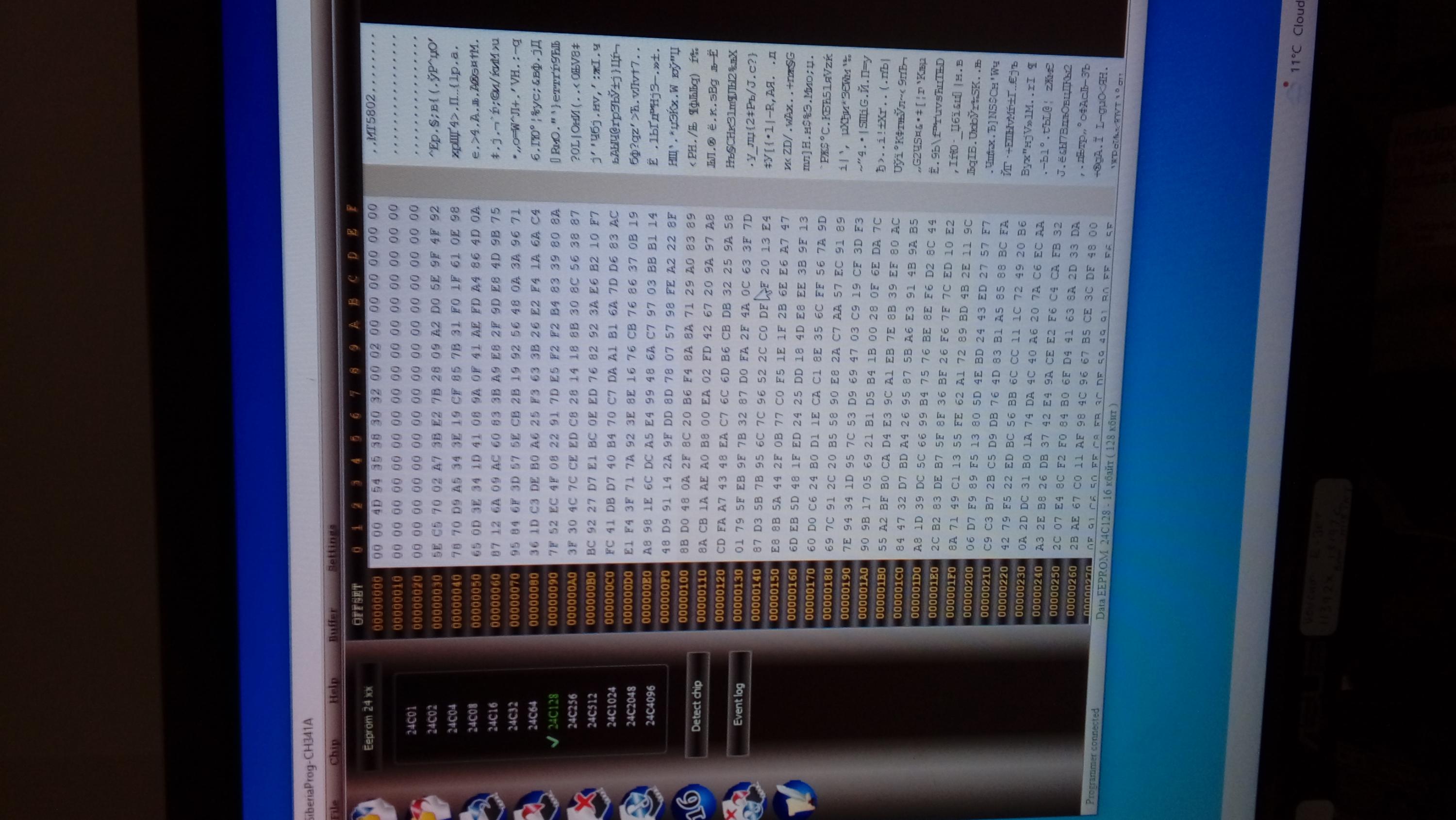

    Re: Eeprom dump thread!
    it seems that if the chip is blank it shows
    recognition error
    i am now able to write to chip
    but it only took a few seconds to write is that normal?
    i expected it to take more time?

          #1484
          heres what has loaded and a pic of how ch341a is configured
          • lotas
            • Jan 2016
            • 4500
            • Russia
            #1485
            Everything seems to be correct, click on the check.
            • jimbofz
              • Apr 2013
              • 537
              • uk
              #1486
              data and buffer the same
              so it looks good ill try it and let you know if it works
              thanks again for all your help

                  #1488
                  Originally posted by lotas
                  Ok!
                  same symptoms
                  well at least i know eeprom is not causing the fault
                  original post phil pus6162/05 dated 6.4.22
                  trying to find replacement mb for this 65inch model
                  is proving to be headache
                  thanks for all your help lotas
