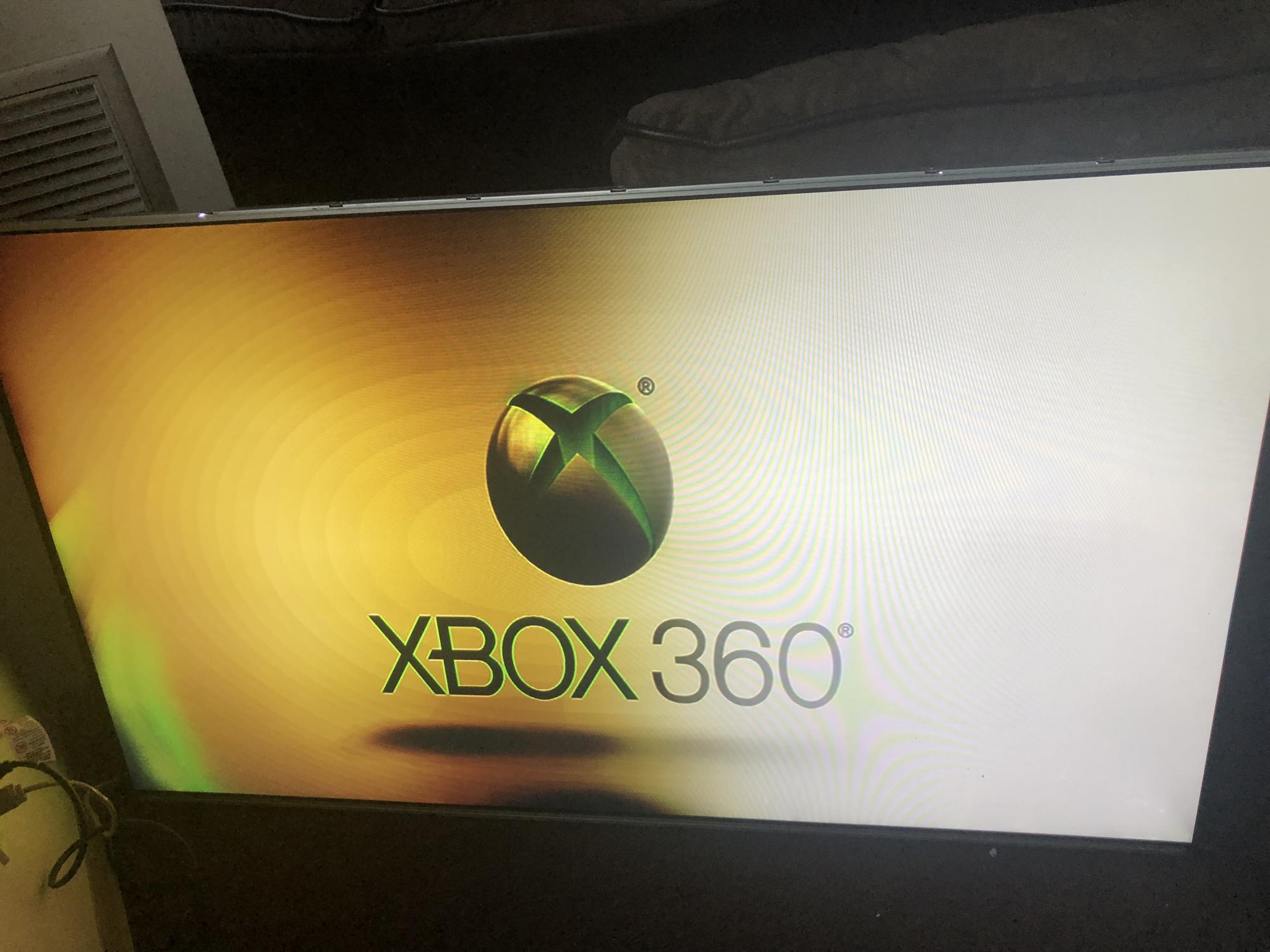

                    I would like to announce that, thanks to this post and its commenters, I have successfully repaired the tv (e701i-a3) as of last night. So thank you all.

                      This thread was a long read, but worth it. I had a Vizio E70-E3 that did have multiple backlight LEDs burnt out and some underrated capacitors. After getting the backlights working, I was sad to see the image was distorted with odd lines. It actually started with both reddish vertical lines and intermittent horizontal white thin and thick lines. Sometimes it would show a whole image and other times it would have a dark blob on the bottom right corner with white lines. I was about to give it up for parts, then came across this thread. This TV is 70 inches, with no driver boards on the side of the panel. As a last ditch effort, I peeled off the tabs along the one bad side of the panel, reseated all other connectors and the picture looks fine. Amazed.

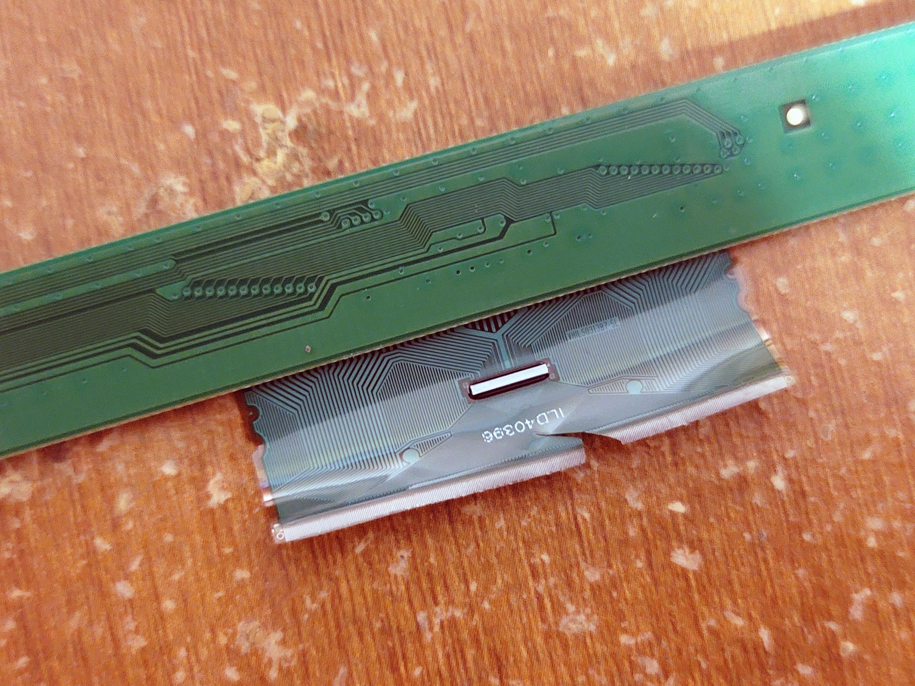

                          I'd like to add some things to this thread if I may. I've probably done at least 20 of these horizontal drive board removals by now and I'm not sure if these things were covered, but just in case:
                          I just did this procedure on a Sharp model LC-70LE757U 70" 3D tv.
                          Symptoms:
                          TV will not turn on
                          "Icon" light (the upside down "V") flashes code 24 and/or 25
                          Diagnostic actions taken:
                          From screen to T-Con board there are 4 flat flex cables on this model. Detach right outboard flat flex cable (when looking at the BACK of the TV) and try to power on TV, TV powers on with darker image along with a horizontal line and bar emanating from the left side of the screen (when looking at the FRONT of the TV) where the #2 COF tab (from the bottom of the screen) is located.
                          The horizontal line and bar emanating from the left side of the screen (when looking at the FRONT of the TV) mostly disappears about 3/4 of the way to the right side of the screen (when looking at the FRONT of the TV)
                          Inspect #2 COF (Chip On Flex) tab from the bottom of the screen. The green tab is discolored to brown in color in the area surrounding the Gate Driver IC. The IC itself does not appear to be discolored.
                          Repair (WORK AROUND) action taken:
                          Remove BOTH left side (when looking at the FRONT of the TV) horizontal drive boards by peeling the attached COF tabs FROM THE SCREEN.
                          CHECK ALL COF TAB ATTACHMENT POINTS AT THE SCREEN to be sure they PEELED OFF CLEANLY since remaining adhesive or traces of the COF tabs can cause problems.
                          Re-attach right outer flat flex cable (when looking at the BACK of the TV) to t-con board and power on TV.
                          Verify there are NO THIN HORIZONTAL LINES emanating from the left side of the screen (when looking at the FRONT of the TV). None present.
                          Test TV for no less than EIGHT HOURS before re-assembly.
                          Top take-aways:
                          1) The horizontal drive boards and any components attached ARE NEVER the source of this problem. It is ALWAYS an overheated/shorted GATE DRIVER IC embedded in the green flex cable that causes this problem.
                          2) BEFORE REMOVING THE HORIZONTAL DRIVER BOARDS it is IMPERATIVE one CHECKS EACH GATE DRIVER IC for discoloration ON THE IC ITSELF and on the FLEX CABLE surrounding the embedded chip. A severely damaged GATE DRIVER IC will often be blue in color and not have a shiny chrome appearance as it should. Extreme overheating of the GDIC will often cause a blue in to white color appearance upon the chip itself. The green flex tab will often have brown discoloration surrounding the GDIC and the flex tab will be distorted (wrinkled) around the IC. The flex tab may have holes in it and the brown discoloration may follow several of the traces leading up to or away from the GDIC. If none of these are found, check the flex tabs/GDICs on the OTHER SIDE OF THE SCREEN before removing the horizontal drive boards.
                          3) Remove the horizontal drive boards WITH THE FLEX CABLES from the screen. NEVER leave the flex cables attached to the screen.
                          4) MAKE SURE THE FLEX TABS PEELED FROM THE SCREEN CLEANLY! AFTER REMOVAL LOOK AT THE CONNECTION POINTS (TRACES) ON THE FLEX CABLES WHERE THEY WERE ATTACHED TO THE SCREEN to ensure ALL OF THE TRACES PEELED AWAY WITH THE FLEX TAB!!!!!!! Furthermore MAKE SURE NONE OF THE BONDING ADHESIVE REMAINS UPON THE SCREEN. I like to heat the bonded connection slightly with a hair dryer to no more than 120 degrees F to help the flex tabs peel away cleanly.
                          5) CAREFULLY INSPECT THE PICTURE on the side the horizontal driver boards were detached from. IF THERE ARE THIN LINES EMANATING FROM THE LEFT SIDE OF THE SCREEN this means the flex tabs DID NOT PEEL AWAY CLEANLY! This can lead to problems later.
                          6) THIS PROCEDURE IS NOT A REPAIR. IT IS A WORK-AROUND RESCUE PROCEDURE TO ELIMINATE A SCREEN SHORT WITH THE INTENTION OF EXTENDING THE LIFE OF THE TV!!!!!!!
                          7) Severely shorted/overheated GDICs can place stress upon the components of the source driver boards (vertical drive boards), the other horizontal drive board and all of their gate driver ICS. It can take 30 days or more before you know if this procedure rescued the TV.
                          8) if there are ANY PICTURE PROBLEMS after applying the rescue procedure the TV should be considered totaled and it be recycled!
                          9) I have NEVER encountered a right side (when looking at the FRONT of the TV) GDIC failure. It has ALWAYS been the left side (when looking at the FRONT of the TV) that has failed. This isn't to say the right side GDICs never fail, just my experience.
                          After doing several of these procedures this is what works for me.

                              Thanks to this board I sucessfully revived my Vizio E701i-A3E. Same simptoms- backlight with no picture. Ordered a new T-con board from Encompass and removed the side driver ribbons. Found Left side was bad, ripped off the Drivers and reassembled. TV works great, although the early version of smart apps in this TV are laughable now. Got the TV for free, T-con board was my only investment.
                              Thanks freakaftr8!
