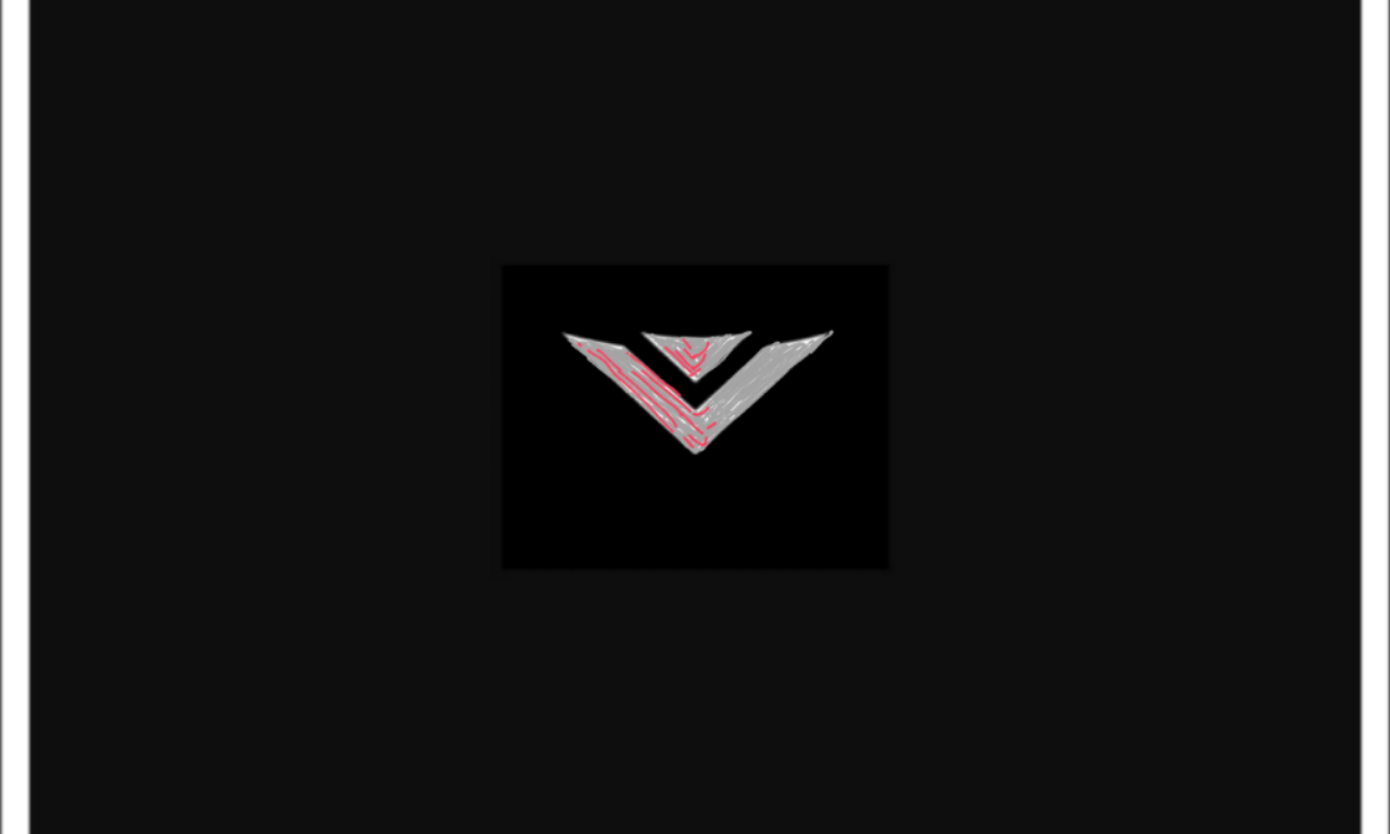

                          I have a question about the red lines you had seen where they spanning vertically or horizontally accross the screen?
                            #33
                            Re: e701i-a3 no picture but backlights
                            Hi no the thin red lines were making up part of the 'V' logo. I'm attatching a picture I edited to describe it. The real image I saw on the screen was much more faint and not as pronounced.
                              #34
                              So when you did the previous test (and in the "recent past"), you no longer see or get any code flashing at any time? Not sure about a Vizio but the corresponding sharp panel displays "SHARP" BUT not all the time. That gets only displayed during some form of "reboot" / "initialization" which isn't necessarily tied to just unplugging / plugging because there is some "retention" power.

                                Ok here is how I found the glitch from the beginning. My TV came in to me with the same typical symptoms. I replaced the tcon board thinking it was an easy fix to find out that the one I got was already failed from eBay so I ordered another one to find out that one was also already failed from eBay. I found out the second one was bad by just connecting the LVDS cable and not connecting the ribbon cables to the panel. I was not able to achieve any voltages from that board studying the board and reading what others have posted about the board I found out that in the component repair kit they offer an EPROM a couple transistors and a four Channel voltage regulator. There were absolutely no problems with any of the components on any of my boards except for the small Coxa transistor shorting. I noticed that the two boards that I received already had a bad Coxa transistor. The way I found that out is using a digital voltmeter in ohms load and probing the black tip to the center pin the red tip to each individual other pin on the other side of that transistor a good transistor should read about 500 ohms between center pin to one of the ending pins. If you're getting near zero on that transistor shorts when there is a panel problem. The reason I found the specs on that transistor by researching it on the internet I came across a suitable replacement that I had mentioned earlier. This replacement I had found was often old tcon board to a Sony. It was the only thing that I had in my stash that was even close to an equivalent transistor and when I replaced that transistor it obviously had a little more meat to it per say it could handle the surge that the panel was giving it for a few more seconds just enough to be able to turn on the TV and see the actual symptom. What I saw was a really messed up right side picture with a lot of lines going through it very dark and flickering like crazy. I instantaneously knew that there was a problem on one of those side tab driver boards on the right side. So to my findings that is when I disconnected the right hand ribbon driver to the right panel driver boards. When I powered it up the next time I no longer had a flickering red right side but a dim and blurry right side which I was pretty sure that that was going to be like that when I powered it up because there's no power going to those tab drivers any longer but also I was presented with some really nice bright horizontal lines in the picture like you saw in my previous post. The next thing I did was remove the metal framing to expose the side tab drivers and when I pushed on the driver in the suspected problem area the lines started disappearing in and getting bigger. That's when I decided that since the screen has two drivers one on each side I had nothing to lose except for to pull those drivers off since they were causing an issue. That's how I got a perfect picture. The dark lines in the Vizio emblem I don't know what to tell you about but you drew those as if they were on the left side of the screen. The only other thing that I could offer as help would be to attempt to either Repair one of your tcon boards because I seriously doubt you want to go buy another one or purchase another one disconnect both side driver cables on each side of the screen and then power it up if you do not blow that t-con board then you know that it obviously is the left side causing the problem not the right. Then I would focus my efforts on those drivers and then reconnect the right side. This is all trial and error and can be a very expensive process. I just took the expense part out of it by finding my own equivalent transistor replacements instead of constantly buying another t-con board to try to find out how to repair the symptoms. If you are in anyway having extra board laying around your house from previous repairs it wouldn't hurt to Google search some of the small transistors on those boards and try to find an equivalent close to the specs that I provided for the transistor if it's somewhere even close you can try soldering one on and giving it a shot.
                                The key to trial and error on this TV is to keep your hand on the power cord if the V emblem doesn't come up with in a few seconds or you see something flickering it doesn't look right immediately unplug it so it doesn't damage the board because if it doesn't look right from the get go then it's not going to be right.
                                This TV uses the Sharp LCD panel. To my knowledge only one other member has been able to successfully repair a sharp model TV the same time I was working on mine.
