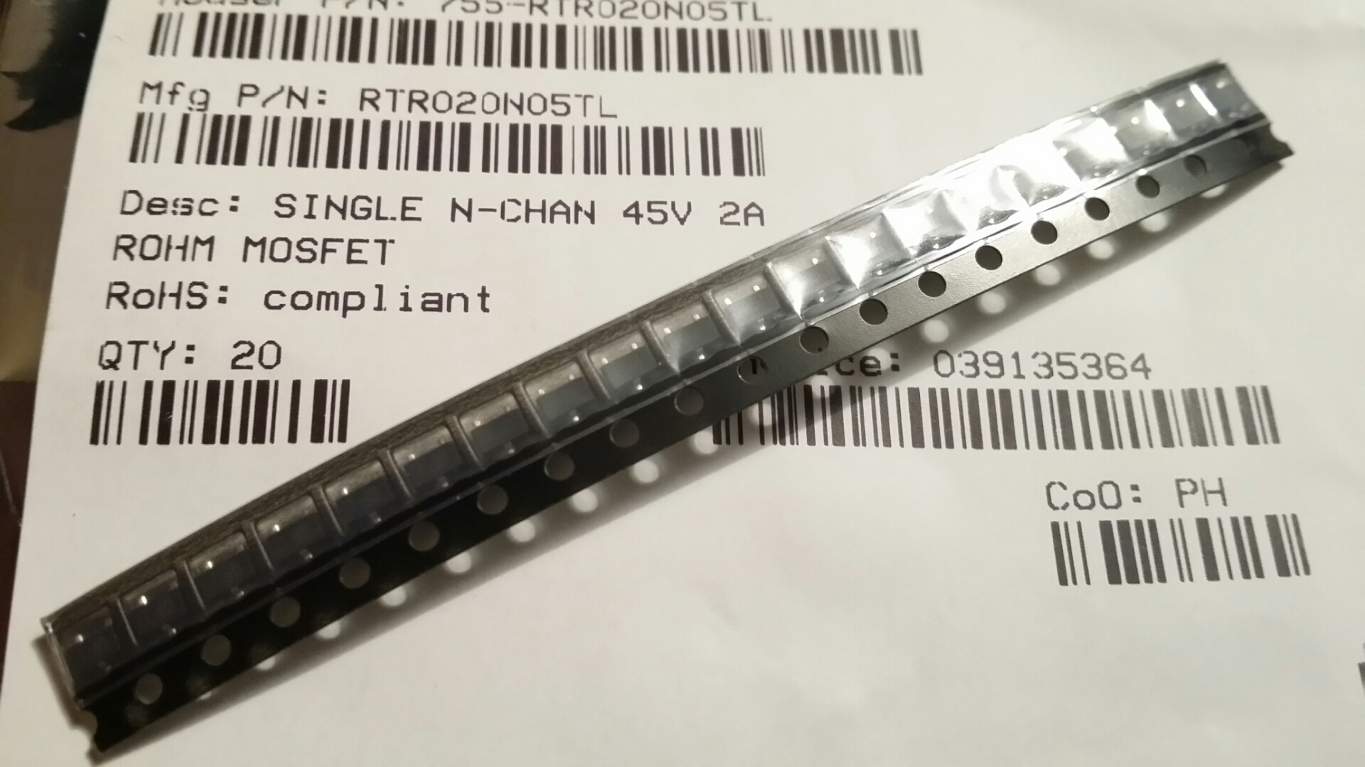

    Hey there freak new new magic transistors are in and I only had time yesterday to replace the one's on the 2 of the 3 t-cons I have the 3rd one is still in the tv. I recall, you had replaced your COXA with one of these from a Sony t-con that you had and the values are higher and they handle more power from your and is what has been working without issue on one of your 70's? I will be doing g so e testing later today- I had a hell of a time resolder the new ones in place. Just positoning was a task and a magnifying glass is a must! I even added a tiny bit of solder but wasn't easy even though I sharpened the tip with a dremel. I'm crossing my fingers

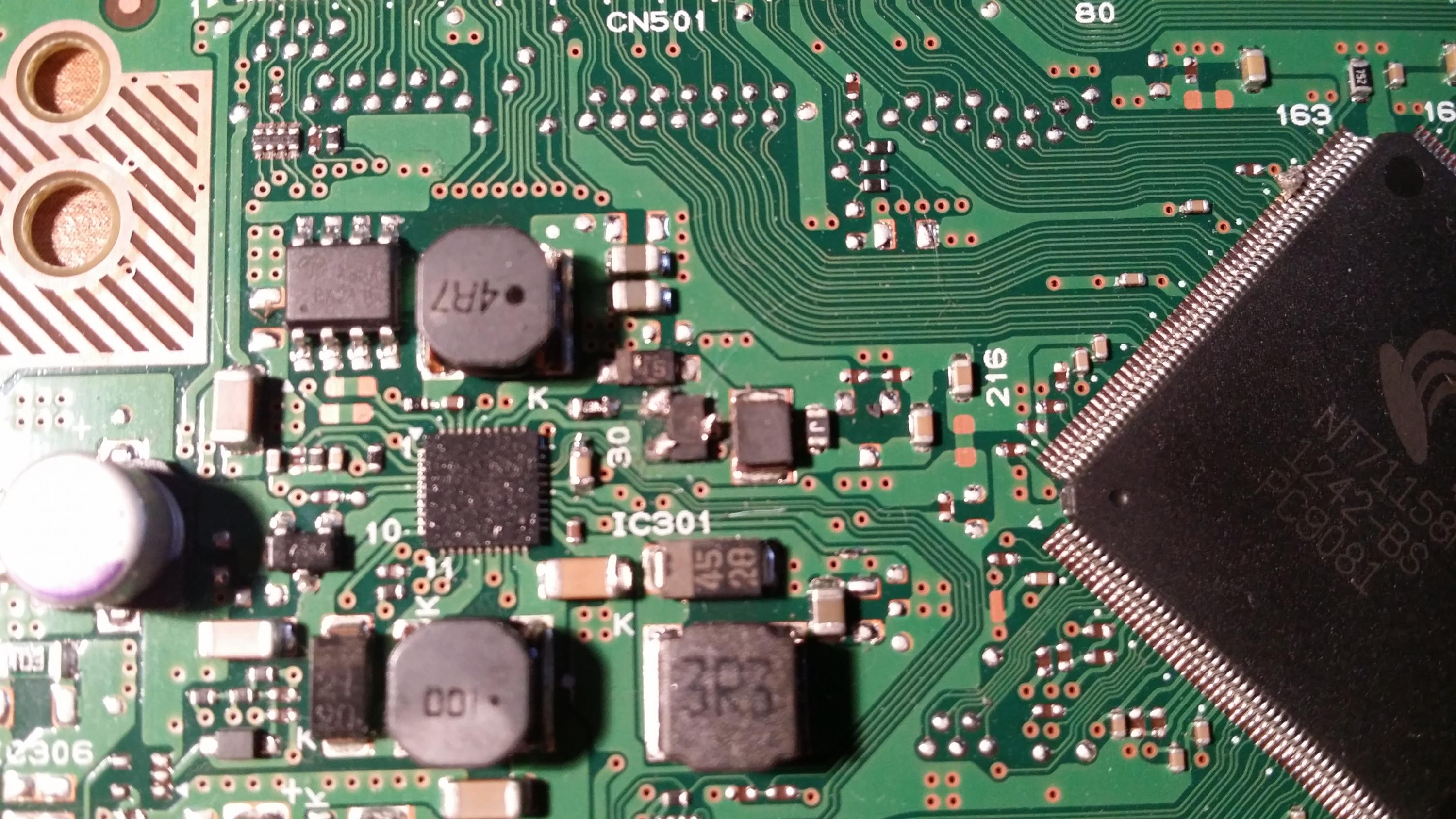

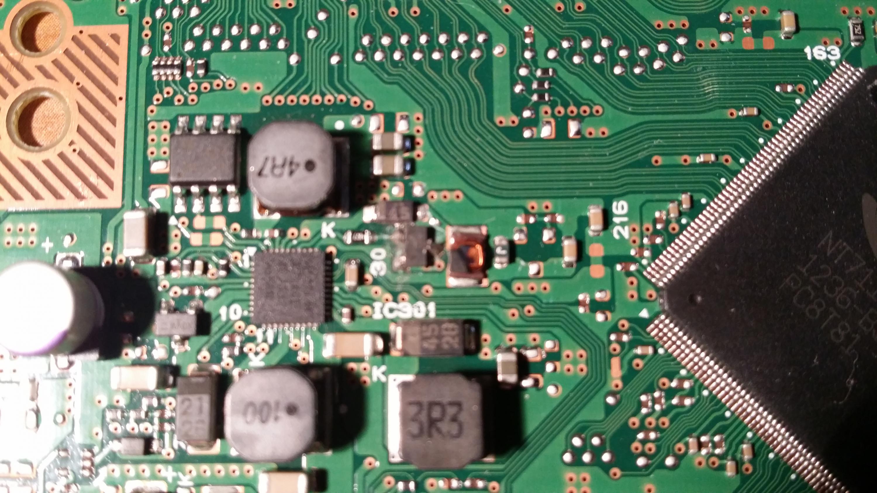

            in the first picture of the tcon under the number 163 by the big chip pins theres a blob of solder that maybe shorting some pins out just make sure you remove it before powering it on.

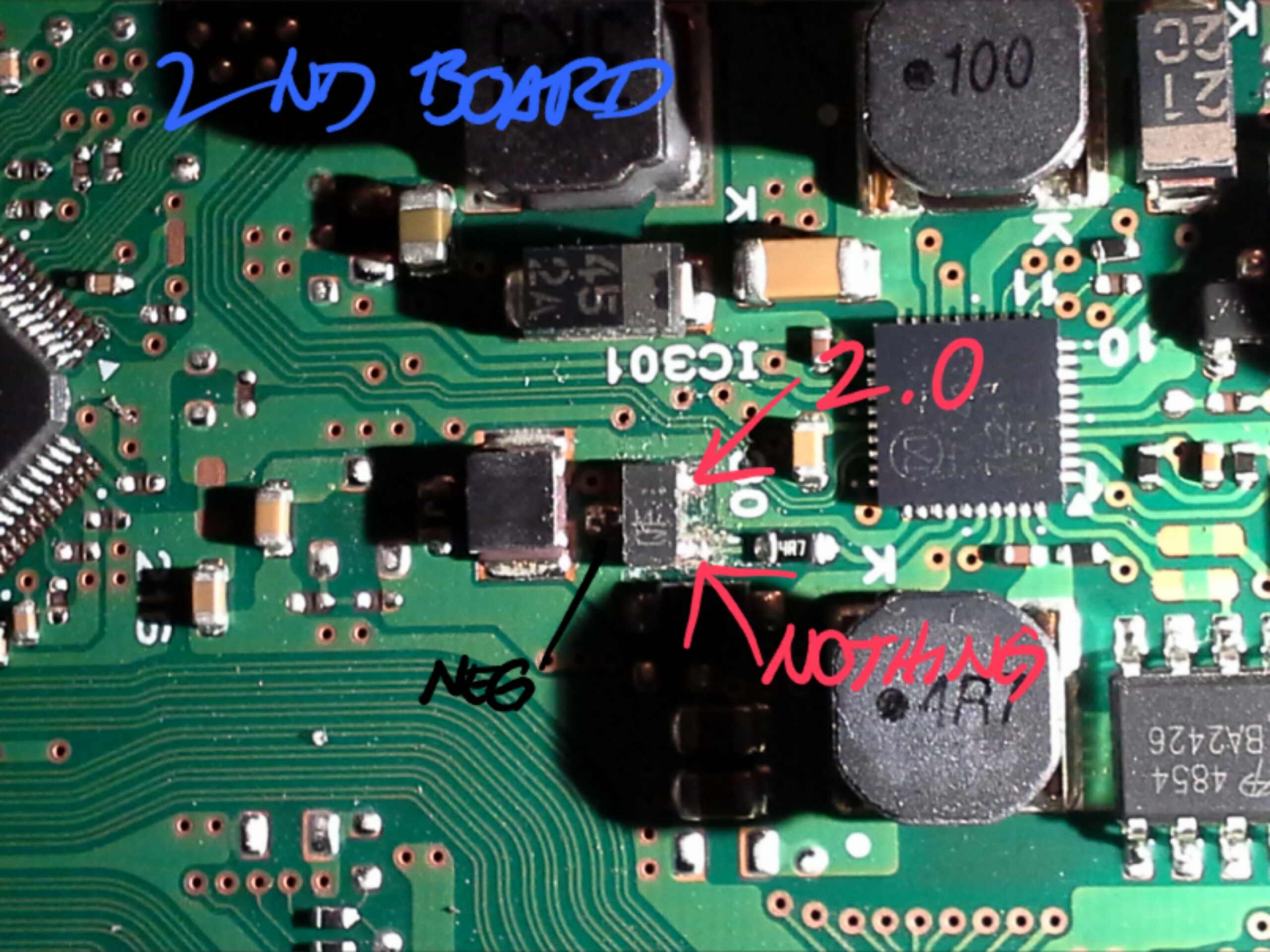

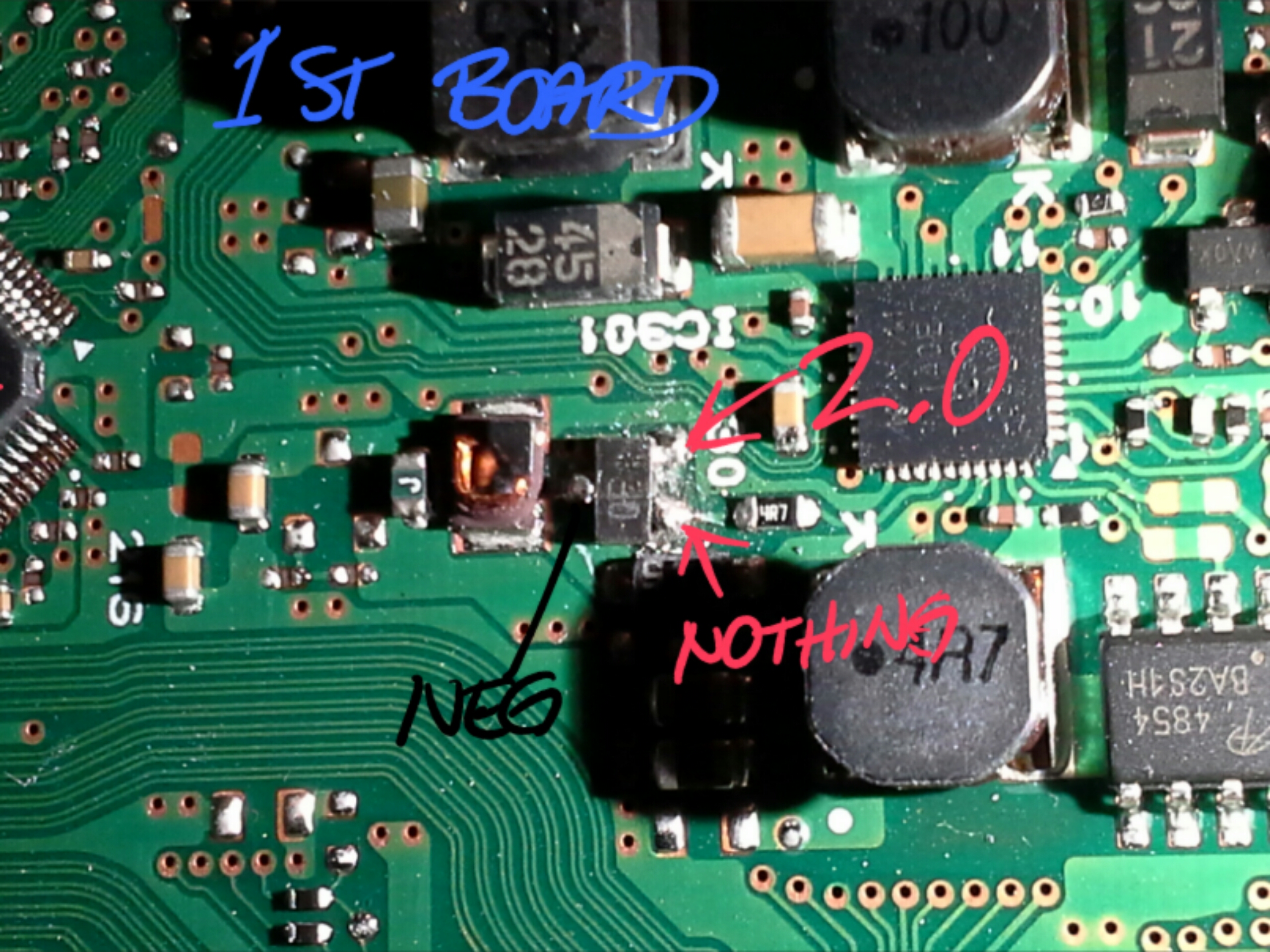

              Well I found the ohm meter that I was using crapped out even thought the battery and fuze were good so I bought a new digitial multi meter. I tested a couple 1.5 AA batteries- one new and one not new but good. The readings were around 1567 on the new one and 1534 on the other. I got all 3 t-cons suited up with the new QF transistors. With each board hooked up, then the LVDS cables hooked up only, then the power cable plugged in and they all read the same. In ohm mode with the dial on 200k with the negative probe on the left middle single leg and the red probe on the top and bottom legs as shown in the pictures, I only got 2.0 on all three boards. I get the same reading with the red probe on the + of the silver capacitor still yet on 200k setting in ohms- on all three boards, but no other setting on the meter brings up a reading. I dont want to hook up the panel ribbons or power it on until I can do some tests that make sense- any idea where I go from here?
                #67
                Re: e701i-a3 no picture but backlights
                No reading with black probe on left middle leg and red probe on right lower leg

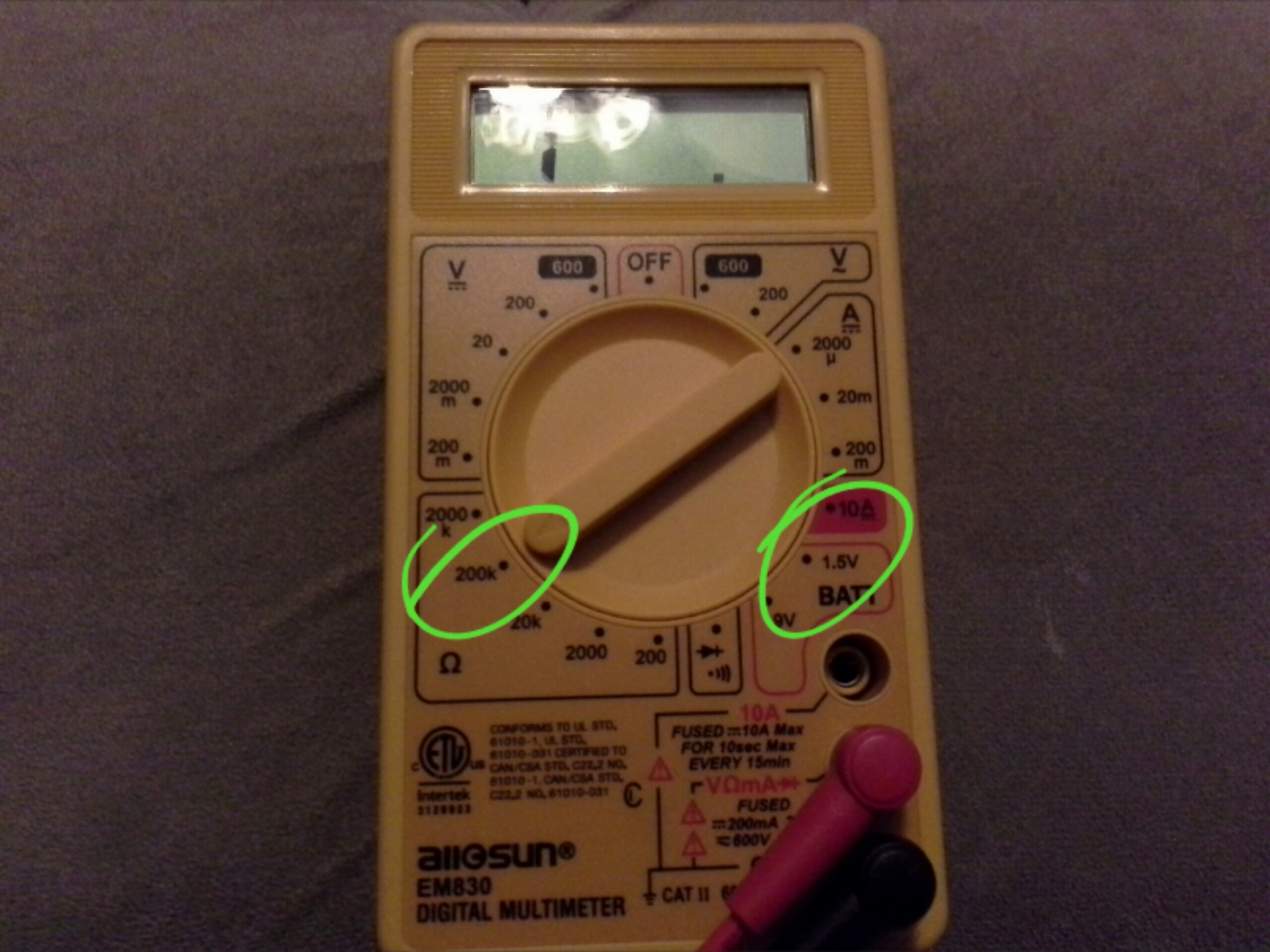

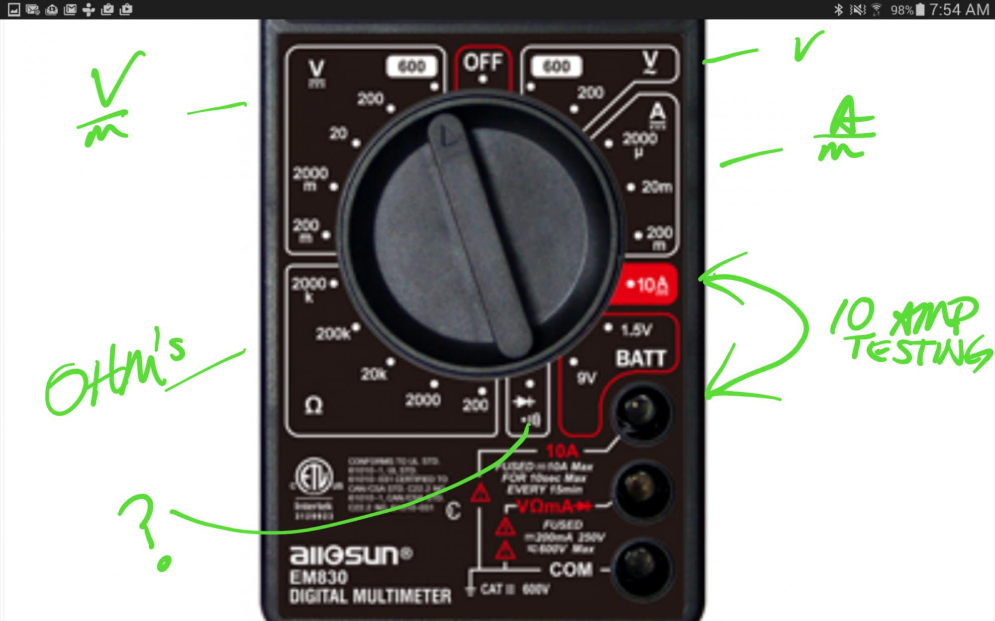

                    Not sure you may not have picked up that I have no experience using a volt meter but it seemed the only setting theat I could get a reading was in ohm's on 200k- heres a picture of the exact same multimeter I bought only in black- what should I set the deal on and should I put the red probe in the 10A slot?- also I did put the black probe on the screw and red on the + side of the red cap and also got a reading of 2.0 in 200k on ohm's- somethings obviously wrong if I'm only getting readings on 200k in ohm's. Where would DC be or does this multimeter not have that? I hate to sound like an dumbo but I just haven't used a volt meter much.

                        Ok. Black probe in COM socket red probe right above it. Not the top socket. That's used for a different application. Have the selector switch set in the top left section in 200 DC mode.
                        Now with tcon connected to the LVDS cable only, run 2 screws into the tv securing the tcon to the tv. Don't worry about the metal cover being there. Now power up tv.
                        Put the black probe into one of the holes that are not occupied by a screw for your ground.
                        Now with the tv powered on, use the red probe and carefully probe those round matte grey canisters on the board. They say 3r3, 100 and 4r4 or something close to that.
                        Are you getting any voltage?

                            So I got my new tcon board in and plugged up the LVDS cables and powered it up without the bottom ribbon cables plugged in. Tested voltage on the three canisters labeled 3r3, 100, and 4r4. Got 3.3, 12.57, and 0. I'm thinking my "new" board may not be as advertised. I also noticed while I was checking the voltage a small puff of smoke came from somewhere on the board. I also did the ohms test on the transistor and got like 2.45 on the top pin and 10.6 on the bottom pin. Bad board?
