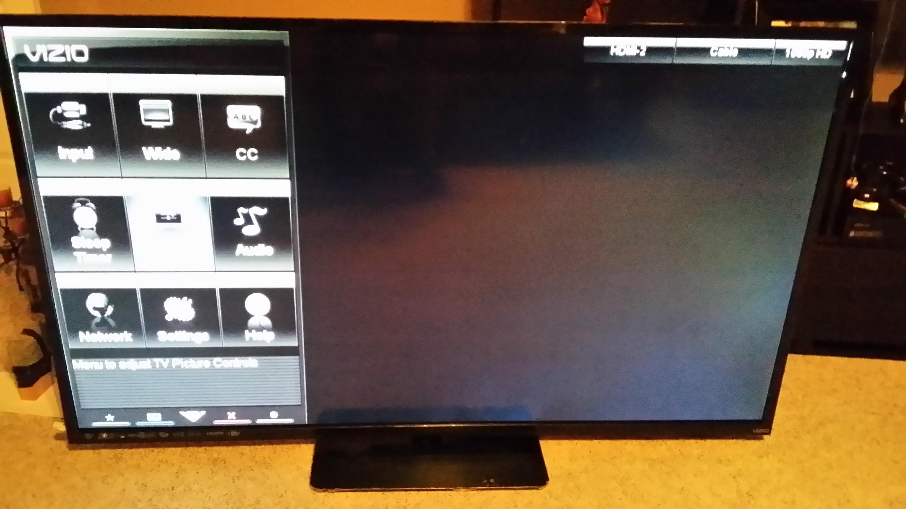

      You also need to double check the cabling leaving the tcon to the panel, especially the one going to the same side as the vertical lines. If the cabling is OK (clean the bare cable "pin" surface with some alcohol), and the vertical lines still remain, try another board. From my experience, when a tcon cable is not connected, and one "brushes" their finger lightly across the corresponding tab cables at the bottom of the screen on that side, you can cause those vertical lines to readily happen. So it more than likely you have some form of "open" connectivity on that side or broken tcon card.
      If fact, if you do the "remove tcon cable" test (one cable connected, other removed) on the other side, the same vertical lines will appear.
        Re: e701i-a3 no picture but backlights
        So bud you mean check the cables going down from the t-con? So disconnect all connections,wipe with alcohol, then reconnect- I assume you mean bottom boards and right side LCD drivers? Then do the t-con test…
          yes those cables especially since you have been taking them on and off alot between swapping cards in and out.
          As for side... from the "V" picture, it is the left side of the screen, looking from the front, then on the back side, the right side cable.
          Further, I would bring up the menu screen to help with looking at something that you would expect to see along with the fact that text stuff is easy to quickly determine whether things are good or bad.
          You can take turns connecting and disconnecting one of the 2 tcon cables (ie. one for each side of the screen) with power off during the disconnect / connecting and look at the screen for changes.
          I suspect that you have a tcon issue currently / still.

            Right. Like we cleared one problem but now we have to look at the next
            Don't touch the right side tab drivers. The more you move them the more chance it have a break in connection. The only thing you need to check is replacing the t-con board to start see if the picture changes. We'll go from there.

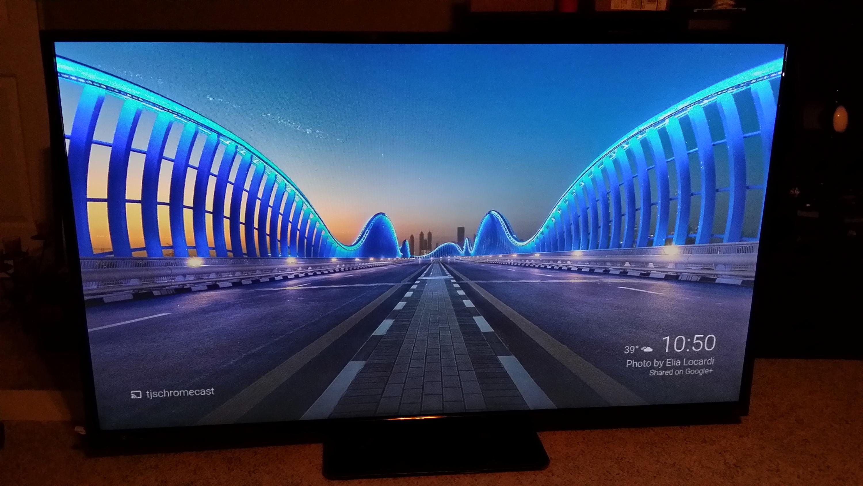

              Well I disconnected the bottom ribbon cables both sides and cleaned them with alcohol and the right side boards patch cable and bottom cable, swapped out another t-con then plugged in and shizammm a picture for the first time but the only thing is the audioa dosent work- only bleeps of audio for a second here and there- I disconnected the speaker cables going into the main board- no change- could this be a t-con thing also? Thanks for all the help!
                I don't think the audio goes near the tcon board. The main board does all the audio processing. What sources are you trying to play? check your audio settings.
                Nice picture.... congrats on that part.
                  Awesome man congrats! Another "operation " completed. 2nd vizio I know of besides mine now.
                  Your audio problem is probably a processor ic problem on the mainboard. Did you have audio before?

                    Ya it looks good… funny thing on the audio- the main board works perfect in the 60- I recently put it (original main board) back in the 70 so I'm perpelxed as to what it could be. I did check the settings- reset audio etc. differeent settings- nothing
