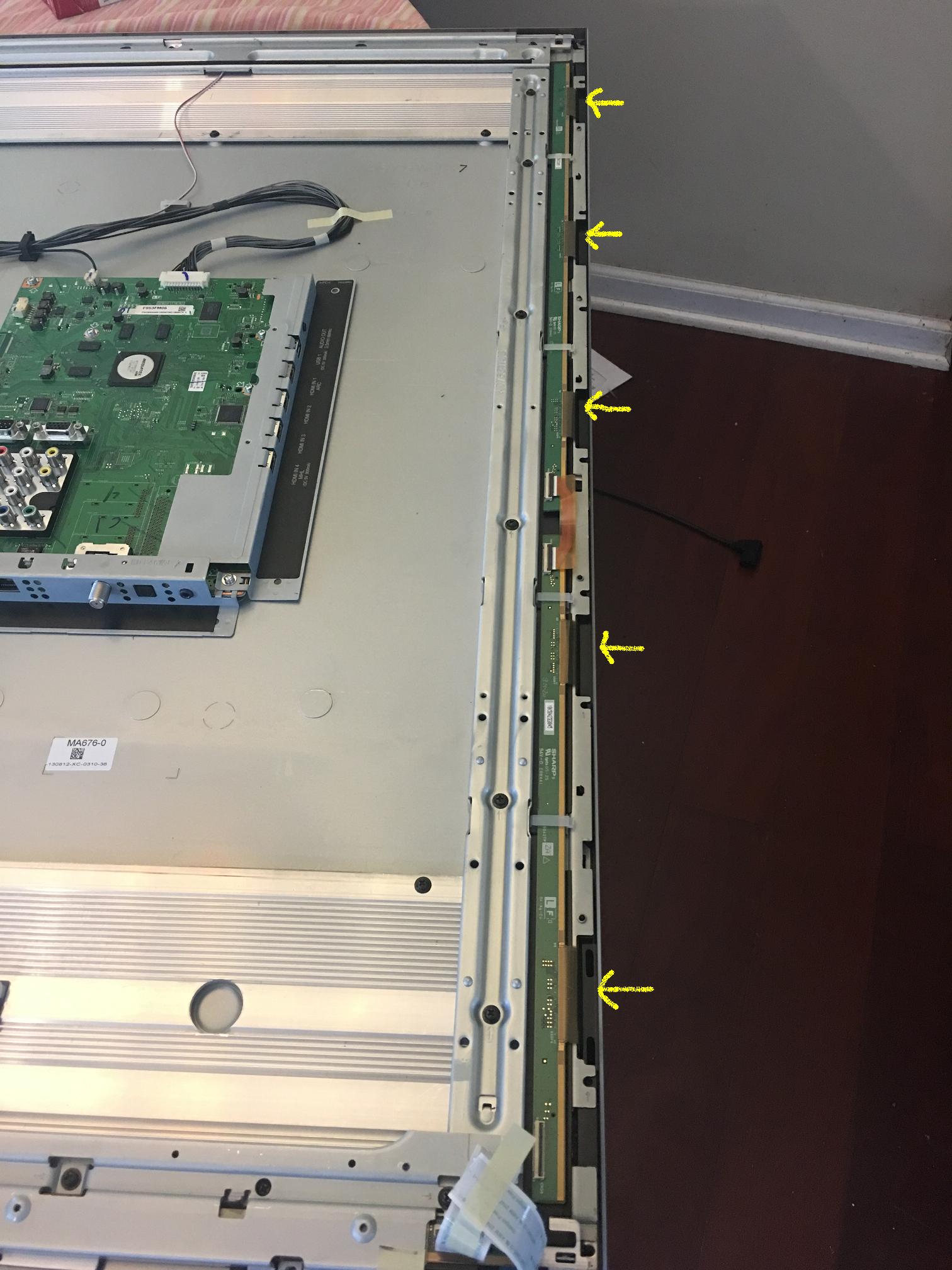

      you need to leave the tcon fully connected. You need to disconnect the small cable in the lower right or left side of the panel. The cables interconnect the side boards on the panel to edge boards on the bottom of the panel. Depending on which corner cable gives you a picture will indicate which side of the panel is in trouble...maybe. Otherwise you need to start troubleshooting a bit deeper looking at the board level (power / tcon / main) at varying voltages.

          Further, "do I peel off all 5 of the ribbon cable's from the boards and the panel"... you only need to remove the tabs from the panel... you will then pull the side boards out from the set as they are no longer of any use.

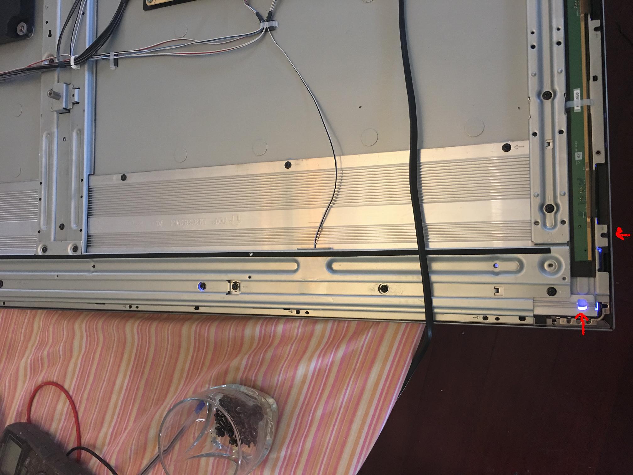

            Ok in the first pic as you can see the ribbon cable to the t con board is unplugged..
            If i leave that ribbon cable unplugged as you can see the led's light up around the edge in the 2nd pic..
            If i plug that ribbon cable back in the tv will flash 2 5 error code.. if i leave that cable plugged in and disconnect the the other ribbon cable on the left hand side of the tv going to the other set of t con boards i still get error code 2 5

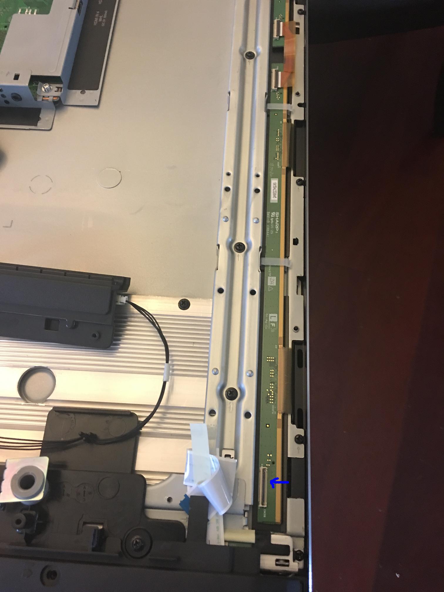

            So my question is do i peel all of these cable's off ( all 5) from the panel as seen in pic 3 and remove the t con boards since they will no longer work

              that certainly helps with clarification.
              so the "detached" ribbon that your are referring to (picture 1) is not going to the tcon board... it is interconnecting, bottom edge boards to side edge boards. For information, the tcon is somewhere in the middle of the back... you should see either 4 or 2 large ribbon cables going to it from the bottom edge boards.
              Anyways, as you have tested, it does appear to be an issue with what you refer to as the "right side". Your picture 3 shows the edge boards going up the side. If you unclamp those boards from the holders, and gently turn them over, you might see the tab driver chips on the 5 cables that you have highlighted. You need to be able to get at where those cables are bonded to the side of the panel. You may not be able to get at the bonding areas without removing / moving the bezel away from the side. You need to get reasonable access to those bonding areas to peel away the tab cables as cleanly as possible. Once they are removed, you can take the side boards (therein) and remove them (along with the flex cable that you had unplugged)... they are of no further use. Hope that helps clarify things.

                Thanks for the info ..
                Did what you said tv is up and running perfectly for an hour now

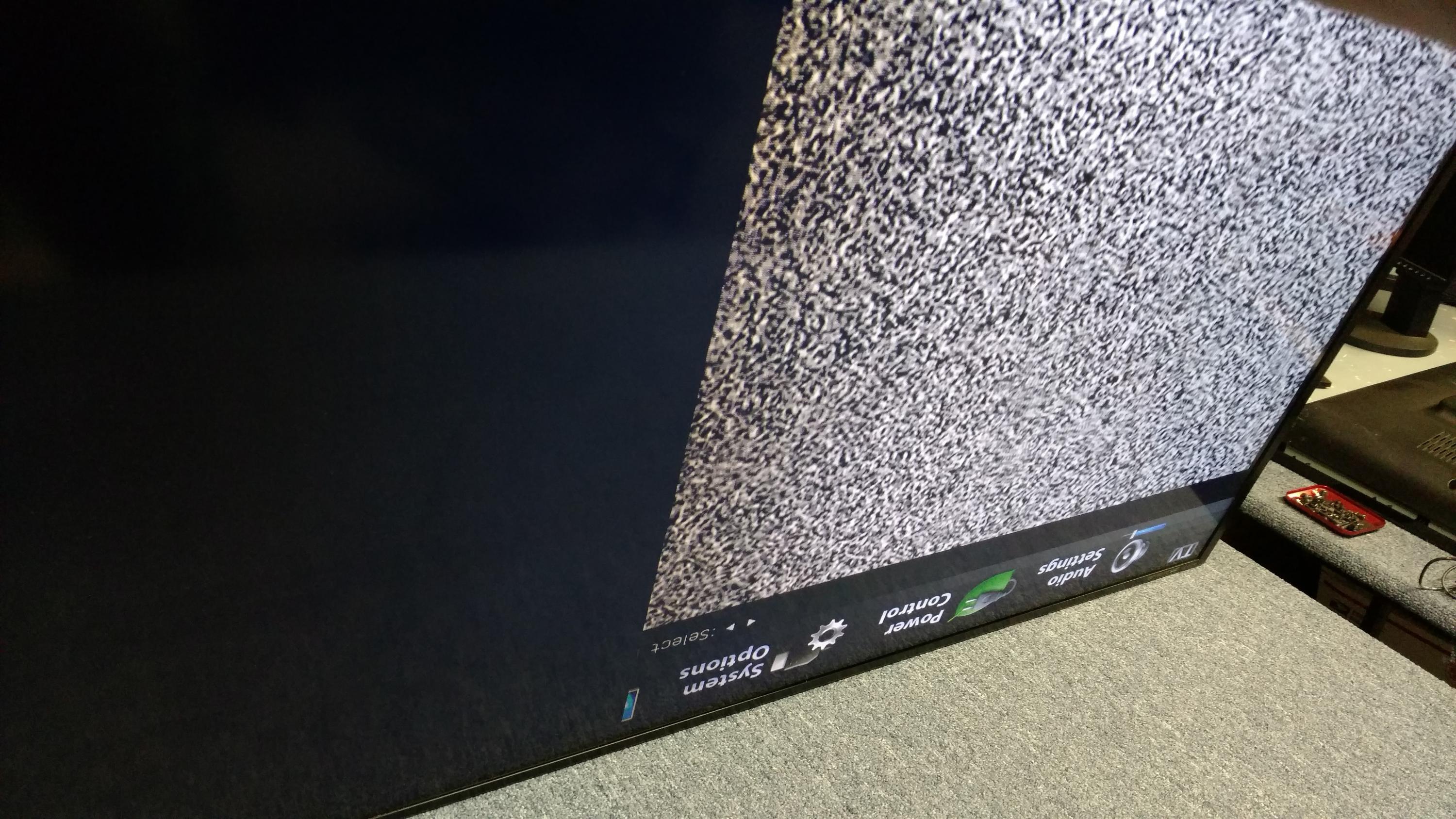

                            Wow! I just stumbled upon this thread following an online search. I read the entire thread and, fumbling along, I have hit what I consider to be 90% paydirt. Here's the story (which sounds a lot like those of other participants to this thread). I have a Sharp Aquos LC-70UQ17U which I picked up yesterday on a lark. The previous owner reported that the thing had gone dead. He had done some Internet sleuthing and had replaced the power supply. Much to his surprise, that did not fix the problem. He was giving it away and I took it home. Quite by accident, when the room was completely dark, I noticed the "2 long, 5 short) blink code. At this point, the backlignt only came on dimly for a few seconds. Anyway, to make a long story short, I followed the threads to the point where it was recommended that the ribbon connectors at the bottom rear of the screen might yield some insights. I disconnected the one on the right hand side (when looking at the back of the television) and plugged the TV in. Right away, the red Sharp logo came on and I figured I was in business. So, right now, the television is running although the same side of the screen (the left side when you are looking at the screen) is quite a bit darker that the other side. Other than that, I get bull menus, etc. If I plug the connector back in, the set is dead again. Same thing if I unplug the other side.
                            So, I am sure that all I need is a little more help (or to be told that that is as good as it's gonna get and that the dark half is just a fact of life. So my two questions are:
                            1- Can I get the "darkside" issue rectified?
                            2- What do I do next.

                              you need to clarify your post a bit.... "... If I plug the connector back in, the set is dead again. Same thing if I unplug the other side...." what does this actually mean... using "same thing" does not specifically say much without a lot "guessing" by those who read it. Please revisit and restate exactly the "test" and the result / observation from each test. Once you do that, then the guessing will be less and odds are good you will be successful. Further post a picture or two of the screen with a known test pattern and that will go a long way in helping with the "observations".
                              IF you get a screen with either corner cable disconnected, then you might have some other issue or this version of the set is designed different so you might have to share pictures of the back to help things along.

                                Well, after much re-reading of this thread and of similar threads on this site, I took the plunge. I left the TV in its upright position on its pedestal base. I removed the 7 or so screws from the side bezel along with the screws along the top bezel. This allowed the top bezel strip to come off which, in turn, freed up the side bezel. At this point, I had to be careful because the outermost layer of the entire screen wanted to flip down. I put one screw back in along the top bezel to keep it from doing that. Then it was just a question of carefully peeling the tabs off of the screen. The bottom one was the most challenging because the side bezel was still attached to the bottom bezel but I still managed. The was a very small amount of the tab left on the third one down but I decided to try it like that and see how it went. To my sheer and utter amazement, the screen image was absolutely perfect. No lines, no blotches, no slow refresh, just perfect! Freakin' WOW! Thanks so much to all of the people who actually know about this stuff for having taken the time to sort this out. Excellent! I was able to watch The Game on my new 70-incher and, to make the day perfect, the Sens beat the Panthers 2-0... The End of a Perfect Day!

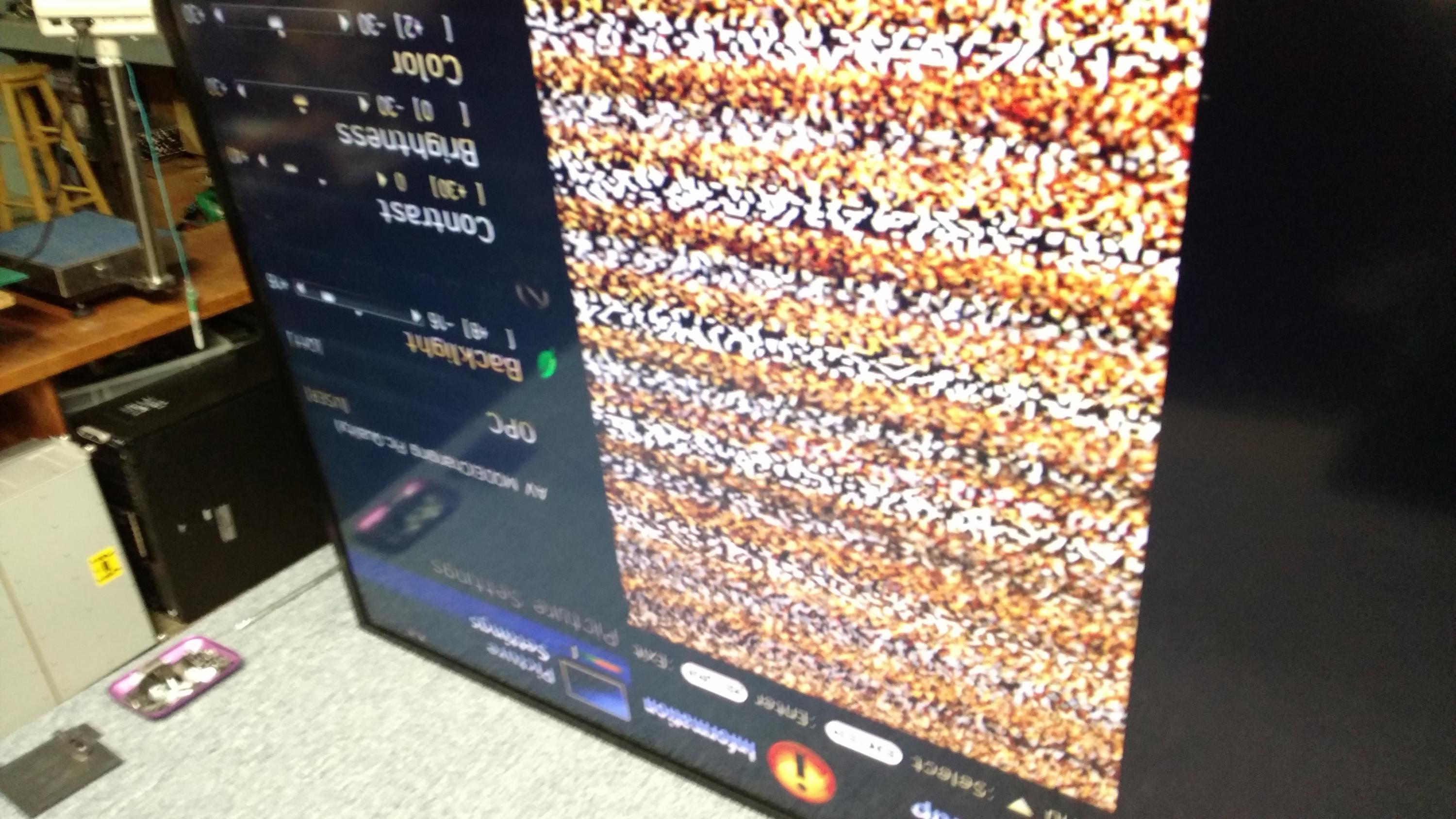

                                          Ok I have a LC-70LE755U doing the "25". Below the first picture is with the left side of the tcon ribbon disconnected which shows a perfect picture and the second picture is with the right side disconnected which shows a distorted picture. I'm still not convinced that my problem is NOT the tcon so I've made an offer on one. But just wanted to get confirmation that pulling off the driver ribbon on the left side may fix this tv. What do you think?
                                          Oh and by left side I mean as you look at the back of the tv. It would be the right side when viewing it correctly from the front.
