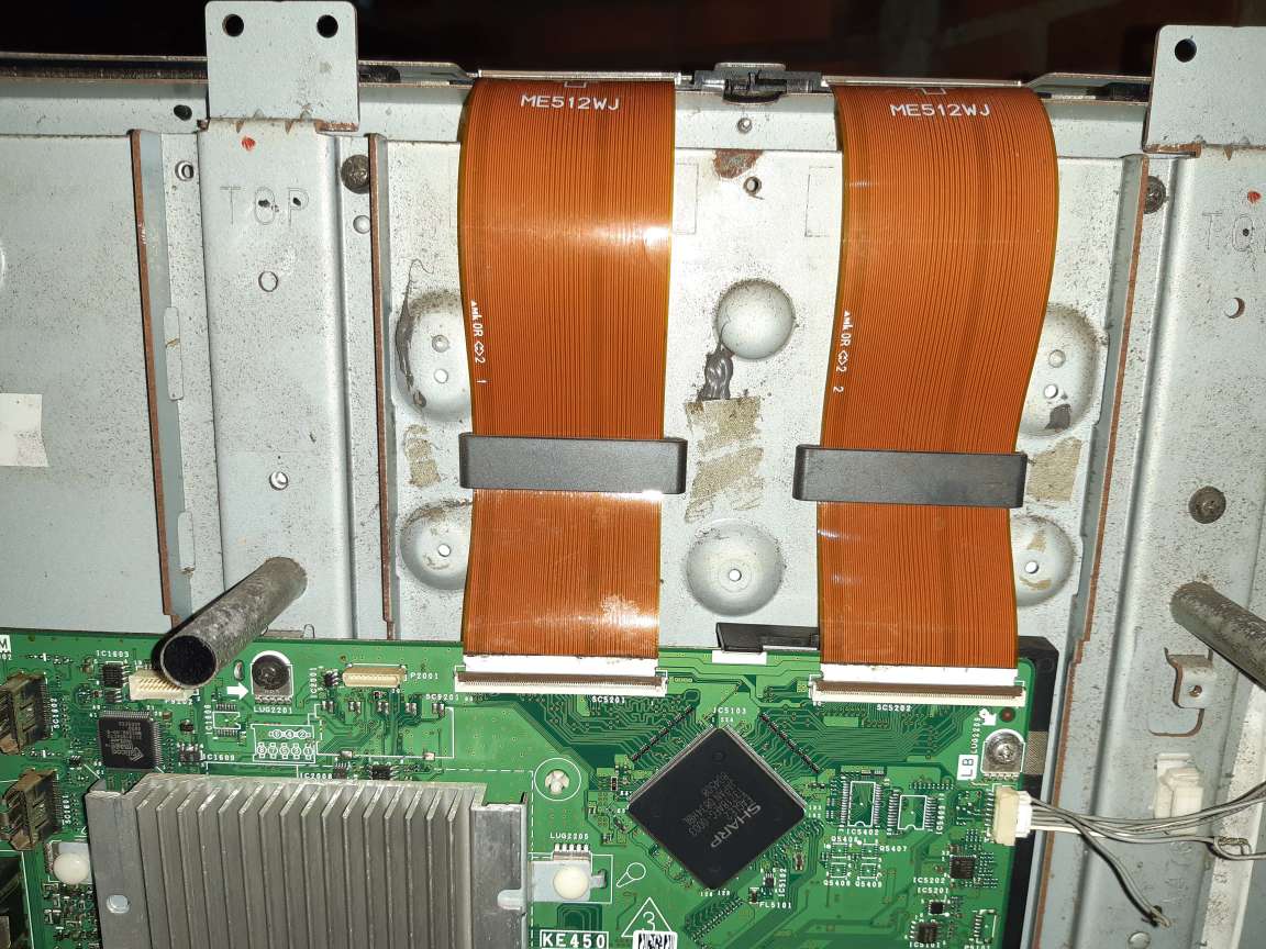

    Thank you very much budwich i wil do that, but after read all post in this thread i realise my problem is the 13.2 volts from the power suplay because if i remove all display (panel) flat cables i get the same error code 2-5 so i realise if i start the set and mesure the output voltage from the PS i should get 13.2 v right and yes i get it but in two 3 secounds they start to fall to 12.8 ~ 12.2 v and finaly when the set turn on the back lights they go to 11.5v and the set goes off all this with the flat cables from the main board disconected and conected are the same readings i change main bord to the old one i have and same results so my conclusion is i have probably some voltage regulator or some output capacitor failing i guess. Before i open a new thread please i like to ear your opinion.
    Thanks very much to all people from this thread.

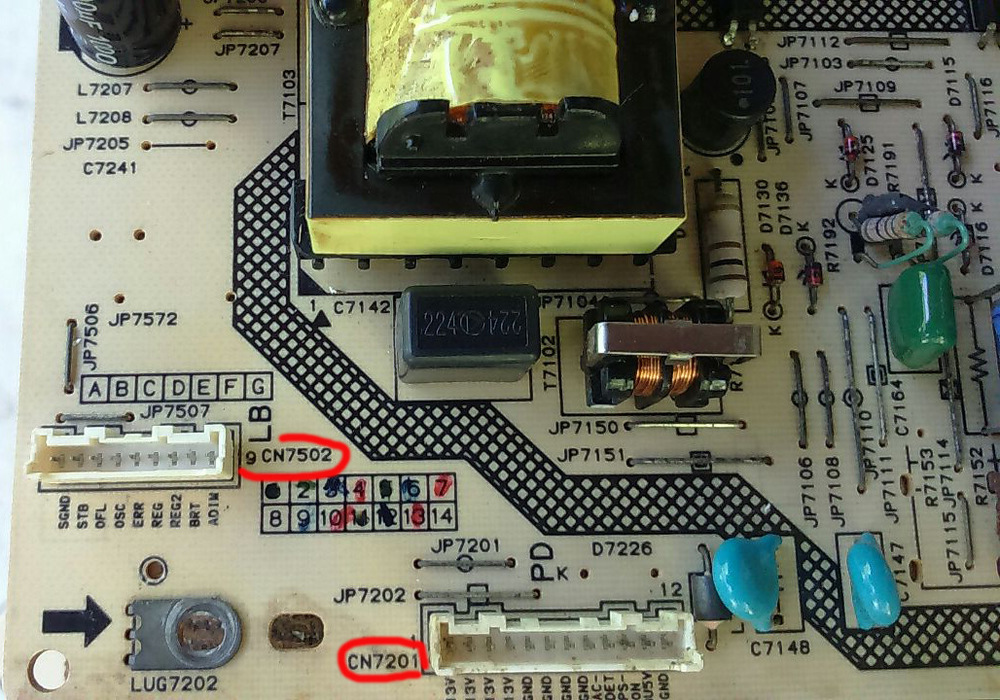

      Re: Sharp LC-70LE757U Flashing 2-5 :-( can it be saved economically?
      try doing the following test.... all cables connected but disconnect just one cable from the tcon to panel. What happens / what is the display looking like? Do the same test again with the opposite cable from the tcon to panel disconnect. What happens this time?
      Sometimes, the 13.2 volts is removed if the set detects an issue with either the panel or backlights. The fact that you see the voltage start to "slide" gives me the impression that there is an issue in the panel.

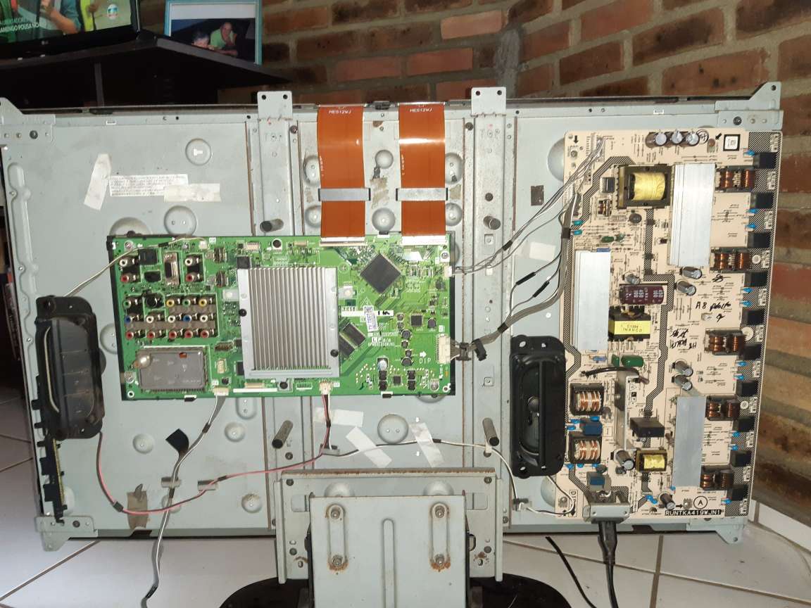

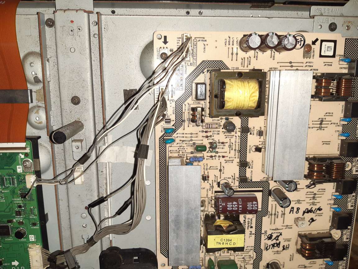

        Hi budwich thanks for your replay...i already measure the 13.2 with the right flat cable (tcom) disconected and the left to and i disconect the two cables also and i get same exact mesures this time when the backlights come and the image from the display (2 secounds) sayng hdmi 4 the fall goes from 11.8v to 10.8 v more than my last attempt with the two flat cables conected the last picture with image off course was with the two flat cables conected. i sent some images for a more clear idea from the set. .....give always when shut down 2-5 code.
        Again Thanks for your kindness and patience....

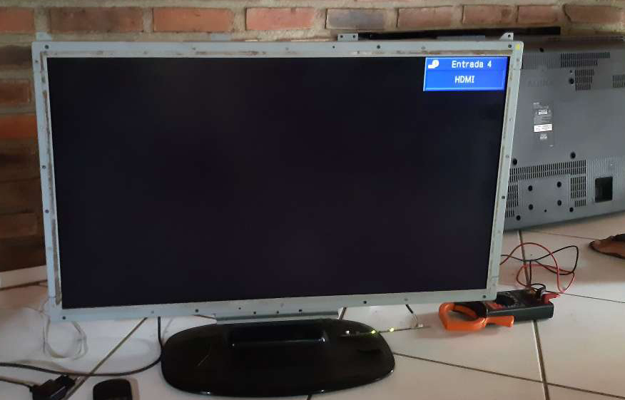

          Please show the display when one cable on tcon to panel is disconnected. Also input a signal into the tv. With one cable disconnected, the disconnected side should be white.
          Further, the last picture shows a display... there is an image. not sure why you say there is "image off"... what does this mean... no input sent???? can you display a menu?
            Hi yes i do it but i canot take a picture fast enoght i disconect the left flat cable and they shut down much more fast i see the left side goes white very fast i put tv signal via hdmi from my other tv. i make it in the oposite cable to the right one and they show up the hdmi box image and shut down but the strange thing is in the first atempt the side who goes white veri fast was the conected one and not the side of the screen i disconected the cable. But in the two situations they gives 2-5 code but more fast them when the two flat cables are conected.
            p.s. and yes no input at the time when i take the last shoot, but this doesnt mather cause even with hdmi input signal on the set they dont alow to much time to show nothing they shut down showing the hdmi box cause like i say the image stay on only for two secounds and this set is slow betwin showing hdmi box and starts to show the image i think..and no i canot show the menu.
              ok.... please start your own thread / post so people can focus on your set.
