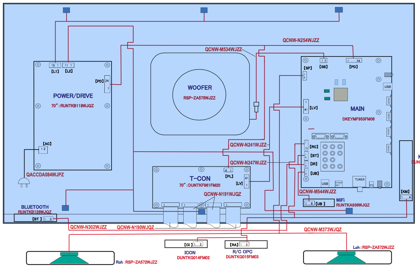

    I am trying to help out the neighbor. He has a Sharp LC-70LE757U that is flashing codes 2 - 5. The unit was working fine one day, he turned it off. Next evening, went to turn it on, nothing. Seems strange. Anyways, I am trying to keep in out of the "curb side dump". He got an "estimate" for fixing it that basically is replacing the panel and is pretty high so it isn't going to happen.
    So I started looking at some of the service manuals for similar sets (ie.70le740, 70le835)... unfortunately there is no service manuals for this model on the nice "toms-service-manuals"... if it has common circuits to the other mentioned model, it would appear that the 12v supply to the t-con board is in "question" with this flash code. Supposedly, the estimate "analysis" checked some of the voltages and they were "correct" (relayed info from neighbor).
    I further looked at this thread .... https://www.badcaps.net/forum/showth...rp+lc-70le732u... wow, great work all around.
    Maybe, just maybe these are similar issues / "similar sets". This thread gave me hope that perhaps a similar solution can be found for our set.
    Before I get my hope (and that of my neighbor) up too much, was hoping perhaps someone here might have access to the particular schematics for this set especially around the 12v pnl supply to help confirm similar operation and places to look.
    Once I get the Tv back off, my checks would be to recheck that the 12v is being delivered to the t-con and that correspondingly that the det- pnl 12v is "high" (?).
    Further to the above and based on the other thread, if the 12v is there at the power board and makes it way to the t-con board, but there is no "detect signal" being sent / set, then maybe I could try the same type of "trick" that the poster there and people on the forum helped with by "fooling" the system with a "diy signal". If this is the case, I am sure that the "estimator" would not have gone that far since it needs some "tender care" / "circuitry" for the "workaround". My fingers are crossed.
    So can anyone provide me with any additional guidance and details to help lift a little of the "veil"? I have access to a scope and multimeter and some experience in general electronics troubleshooting but not alot in the TV area (more home audio and automotive).

            I took off the "first" ribbon cable going from the "icon" board (right hand side of the 4 ribbons). Powered it up, interesting, the "perimeter" leds came on.... surprise as I haven't seen that happen in my brief "introduction" to the set (I own a samsung DLP rear projection set). Measured the 12v pin on the PD board (pin 1/2 at the connector leaving the board). It reads just under 12v (11.89). Then about say, 5-10 seconds, the lights went out on the perimeter and probably at about that time, the error code flash began with 2-5. The power reading dropped to below 1v so I assume the system shut down the panel.
            I checked the "mass" of mur260 diodes on the power board. They bias at about .54v and reverse at just under 3v (2.9ish).
            Further, additional power up attempts (ie. power at outlet switched off, then back on), no more "perimeter leds" come on. The 12v power comes up and about 3-5 seconds there after, drops when the error code start flashing.
            I don't see any display (not easy as the panel is laying flat with some over hang) as there is nothing connected to any inputs.
            I haven't checked PS-on signal as it is hard to get at and likely needs to have the board flipped to get there (pin 14 which is on the bottom of the connector).
            Looking at the main board block diagram, of course, the "det 12v" pin has to be on pin 12 which is on the bottom of the connector and again difficult to get at.

              Did some more "on/off" (at power outlet). Held the meter on the 12v pin (ground on board mount screws). The panel perimeter lights came on, flashed off then on again and stayed on. The panel itself lit up (back lighting) for about 2-3 seconds and then went out but error light no longer is flashing and the perimeter lights seem to stay on... at least for the "one minute" that I kept powered. This is with the one ribbon cable from the Tcon board disconnected.
              I don't see any cracks on the panel (during the brief light up period), I can't see the whole panel. I wouldn't expect there to be physical damage as the set hasn't been "travelling".
              I guess this means the panel is no good... :-(

                I no longer have the 2-5 error code flashing with one cable removed from the TCON board. I turned the set on with the remote and went to menu. Set stays on and displays a menu of sorts. There are some lines running thru it and the "lettering" is a bit "jagged".
                I guess I have a couple of questions.
                Is the 12v supply sufficient at the 11.93v? I was expecting to be above 12v.... maybe a panel load (failure) on the supply?

                    OK Tom. Now we did some more playing (neighbor came over to help). He said he never saw the perimeter lighting come on when the "shop guy" came over to do the "first look". So the neighbor was excited and dismayed at the same time.
                    Then we did some more "testing". We replaced the right most tcon cable and removed the left most one. The panel behaved the same way.... basically, perimeter lights come on, flash, then stay on. Panel turns "blue" in color while it searches for the input and then goes dark cause nothing is connect. If we hit menu, the screen comes on, but this time we can't see the menu, because the side of the tcon that we disconnect, I assume serves that side of the screen which is where the menu would.
                    Great we thought. Let's pull all Tcon cables back in. :-( as soon as we do that, the power up sequence "changes" in some form and the perimeter lights never come on, eventually, the code flashing 2-5 shows up and the 12v drops. :-(
                    Now we can't get it out of this mode, even when unplugging the tcon cable on the right side. :-(
                    So there appears to be some form of "diagnostic"/check that prevents the system from coming up and even lighting the perimeter lighting. I am think that maybe that perhaps the 12v det line is never getting pulled up and after a bit, the system "says", that's it, don't both doing anything and shuts down in error. So I am conjecturing that perhaps the 12v level is not sufficient to "trigger" the detect circuit (where ever that is... have to look). Does this open a possibility that perhaps the panel is actually good but some sub circuit / check is failing during some startup sequence?

                          You can check some of my other threads, but I just went through a bunch of similar sharp models. The five short blinks (pretty sure that was the count) was the dreaded panel short/error. Only way it could be alleviated was to connect the boards to another panel/chassis that wasn't damaged in such a way to throw that fault.
                          These Sharp sets are different from most other LCD's in that they have some kind of protection feature that kicks in as a result of an error on the panel circuit. It is especially aggravating when trying to make sure the mainboards and such are working.

                            If you connect the TCON cable to the panel, and it throws the error, then my bet is the panel is shot. My panels were very damaged, so that may be why you got past the 5 blinks with just one panel connect connected?
                            You could try this. If you disconnect both/all ribbons from tcon to panel, do you then get the 5 blinks? That's how I see them behave. Disconnect both ribbons, and five blinks happens. If so, then connect the one you did before. If you get past the 5 blinks, then connect the other. If 5 blinks then, that's gotta be the panel. These codes are listed in one or more of the manuals you can find on tanya. I believe it does say "panel fault" or something to that effect, but you should double check.

                                Out of the 4 ribbon cables going from the tcon to the panel, I now can "run" with the two "outter most" disconnected (ie. right and left most 80 pin ribbons). The two inner 64 pin ribbons are connected. Replacing either 80 pin ribbons results in a 2-5 code thereafter. The "failure" appears to be "worsening" since the "run scenario" started with just one disconnected. But maybe its just random. Looking at the ribbon cables at both ends, I don't see much out of place / unusual. :-(
                                Will "chew on" perhaps throwing one last $ at a replacement Tcon board.
                                Does anyone know the actual start check sequence that the system uses? It appears that when things are kind of running, the perimeter lights come up pretty fast where as when things are not "happy", no perimeter lighting is even attempted so some early checks fail, well before (at least chrono wise), lighting happens stopping the initialization process.

                                  Maybe my last gasp at this. The "det_pnl 12v" coming to the main board from the tcon board is on a 40 ribbon connector. Pretty small pins to get at. Looking around the board, both at the main and tcon, there doesn't appear to be any places that are easy access since they are SMD populated / laid out. Are there any "safe tricks" that I can use to connect to this line... shaking aside... :-)
