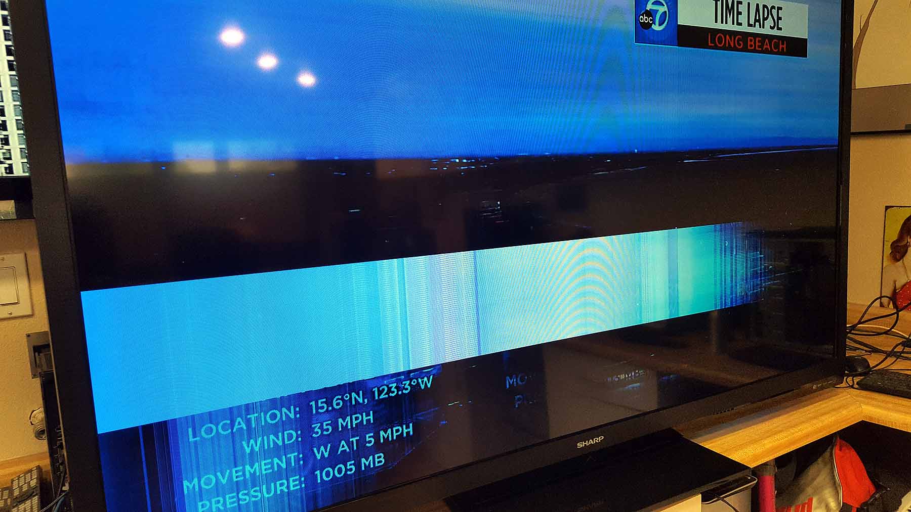

                  I got a Problem with my Sharp LC-70C6400U, I got from my Neighbor.
                  (Sorry for hi-jacking, I can't post a new Thread yet.)
                  Take a look at these Pics and give me some pointers?
                  I've been reading posts all afternoon, but haven't seen a real solution yet.
                  It looks like the T-con board is shot?

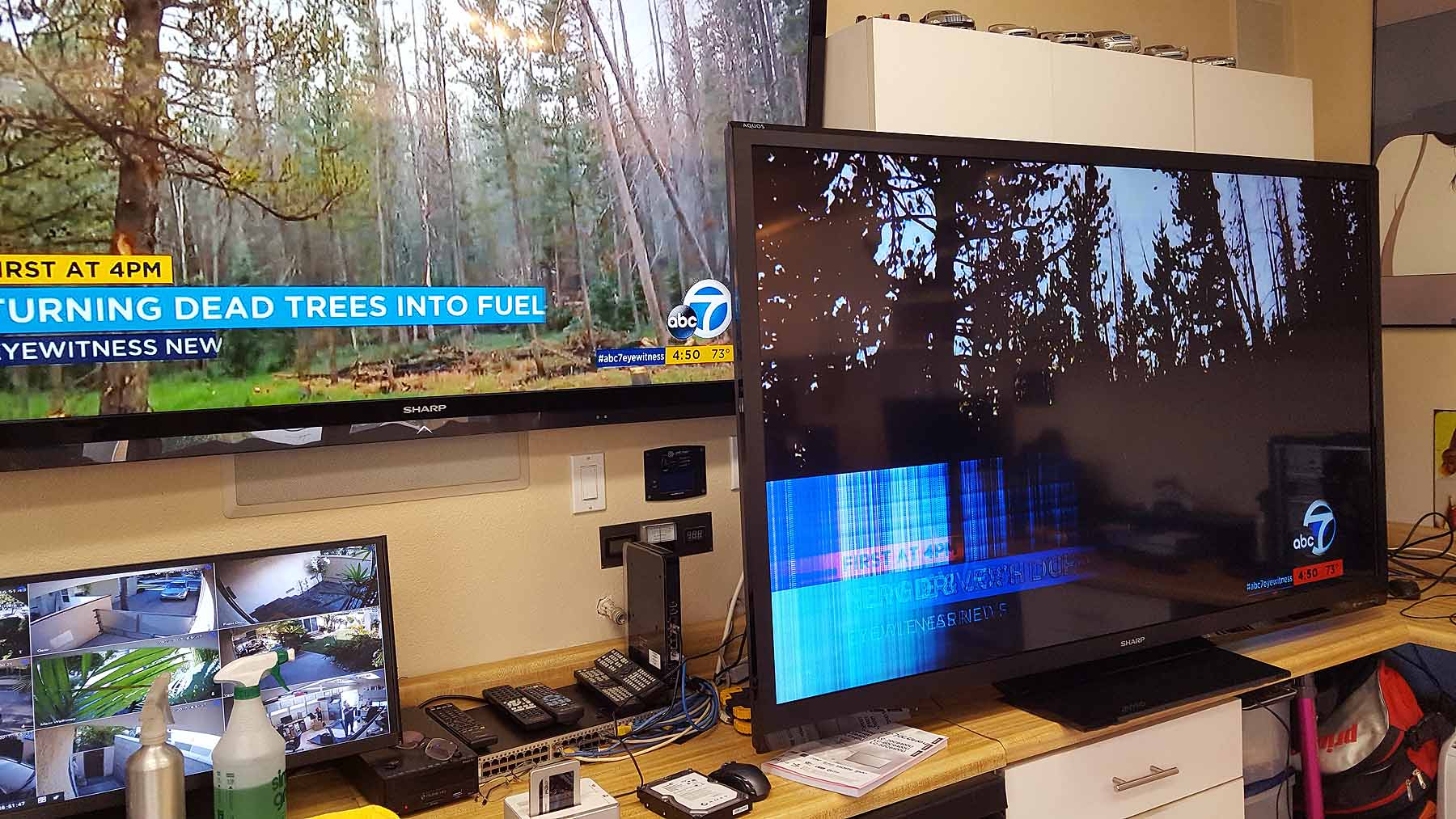

                    #209
                    Re: Sharp LC-70LE757U Flashing 2-5 :-( can it be saved economically?
                    On the last two pictures, you'll see two almost identic TV's.
                    The left one on the Wall is ok.

                      did you try disconnecting any of the cabling that was done in "all that reading"... :-) IF you are looking for a "matching issue", you will likely be disappointed. You need to do some basic "testing" / investigating in the back of the set to see where it take you. Post your results and you may get the set operational again.

                        #211
                        Thanks, Budwich. Tried to log on yesterday but the Forum was closed.
                        What I did is some basic voltage measurments around the PSU, all seems normal.
                        Here is what puzzles me:
                        As soon as I remove the Back Cover from the TV, the Picture is normal again. Put the Cover back on, the picture eventually (after 2 days or so) craps out.
                        I guess I have to wait until the picture fails when the Cover is removed to get some readings from the components.
