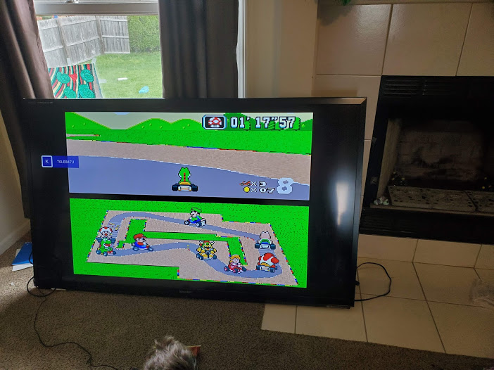

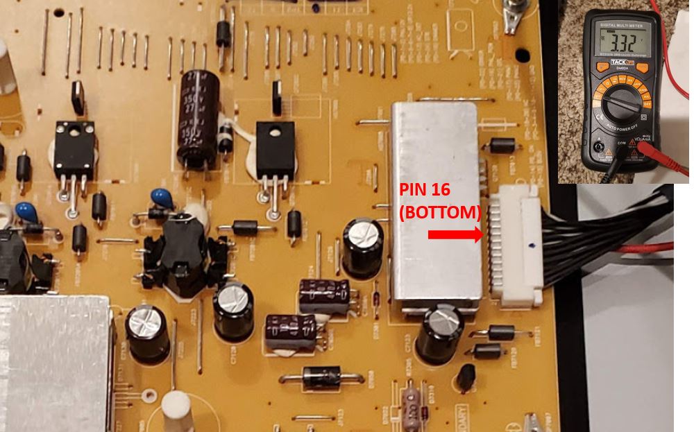

                Re: Sharp LC-70LE757U Flashing 2-5 :-( can it be saved economically?
                I pulled a working Sharp LC-70LE84U from somebody's wall. After plugging it in at my house I see the dreaded 2 5 flashing. It's a shock since the TV was working hours ago. The only difference is it was plugged into a Monster Power Center.
                Here's what I've tried:
                1) Entering service mode. Excuse the crappy source but it looks fine and I get the "K"
                2) Test pulling each of the four T-Con connectors at the T-Con board and testing each time. TV doesn't turn on. I think you're supposed to pull the L/R corner plugs but looks like I need to take of the bezel and I didn't go that far.
                3) Tested PNL_PWR (Pin 16) on the power supply board which was really hard to get to. It's 3.32V right after plugging in the TV. Goes to 0V after ~10s when the TV starts 2 5 flashing.
                I've attached pictures. I'd really appreciate some help on next steps.

                  #328
                  Use a flashlight and closely inspect the screen, hopefully it didn't crack in transport.

                    #329
                    in the service mode, carefully look at some of the pages especially the first one (I think) which shows error counts.
                    from your display picture, it appears that there is a horizontal line running in the top section... maybe. also try plugging into a different outlet and reseating the power cable. The corner cables are accessed by removing the bottom plastic frame member and not the bezel.

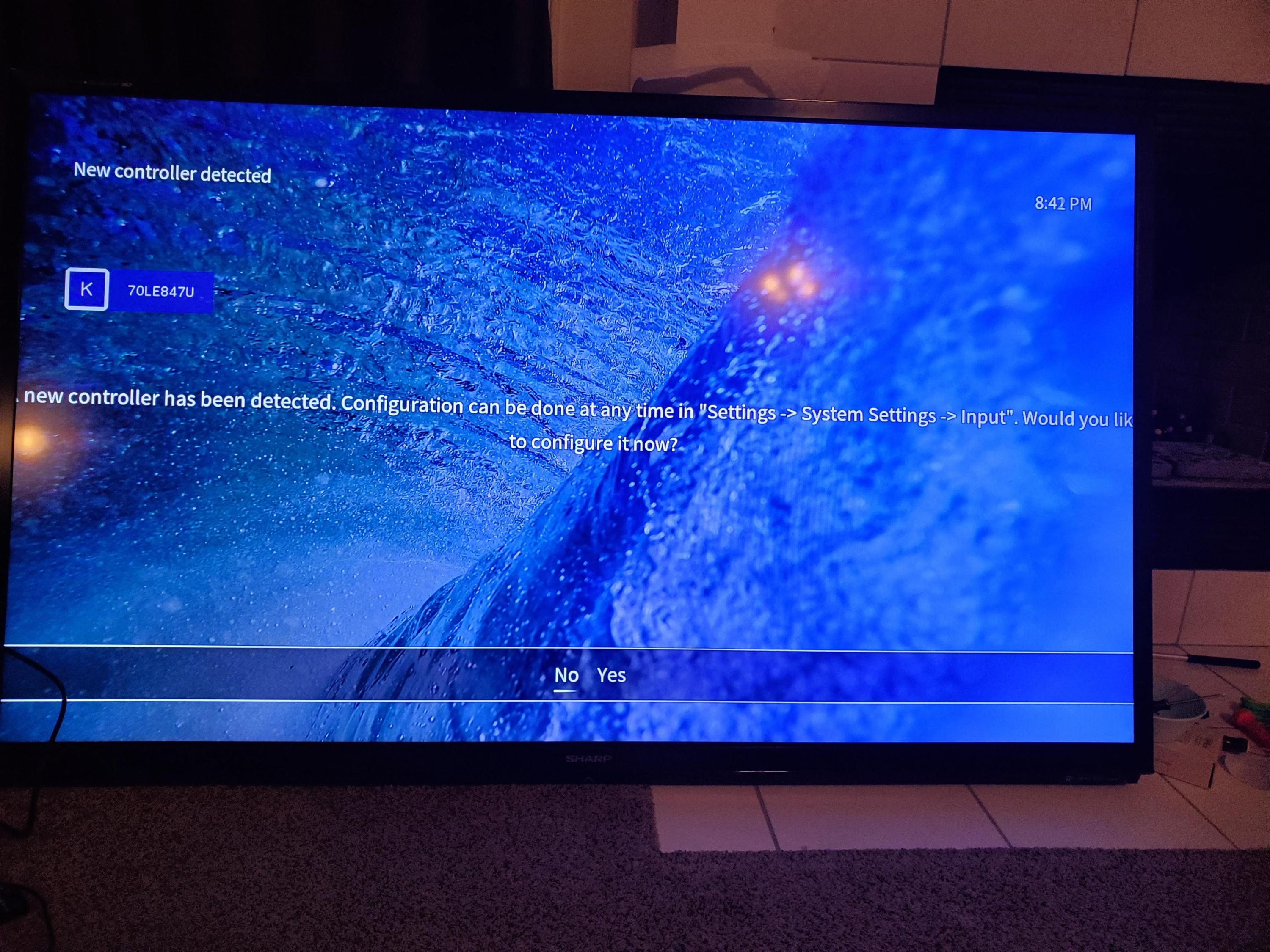

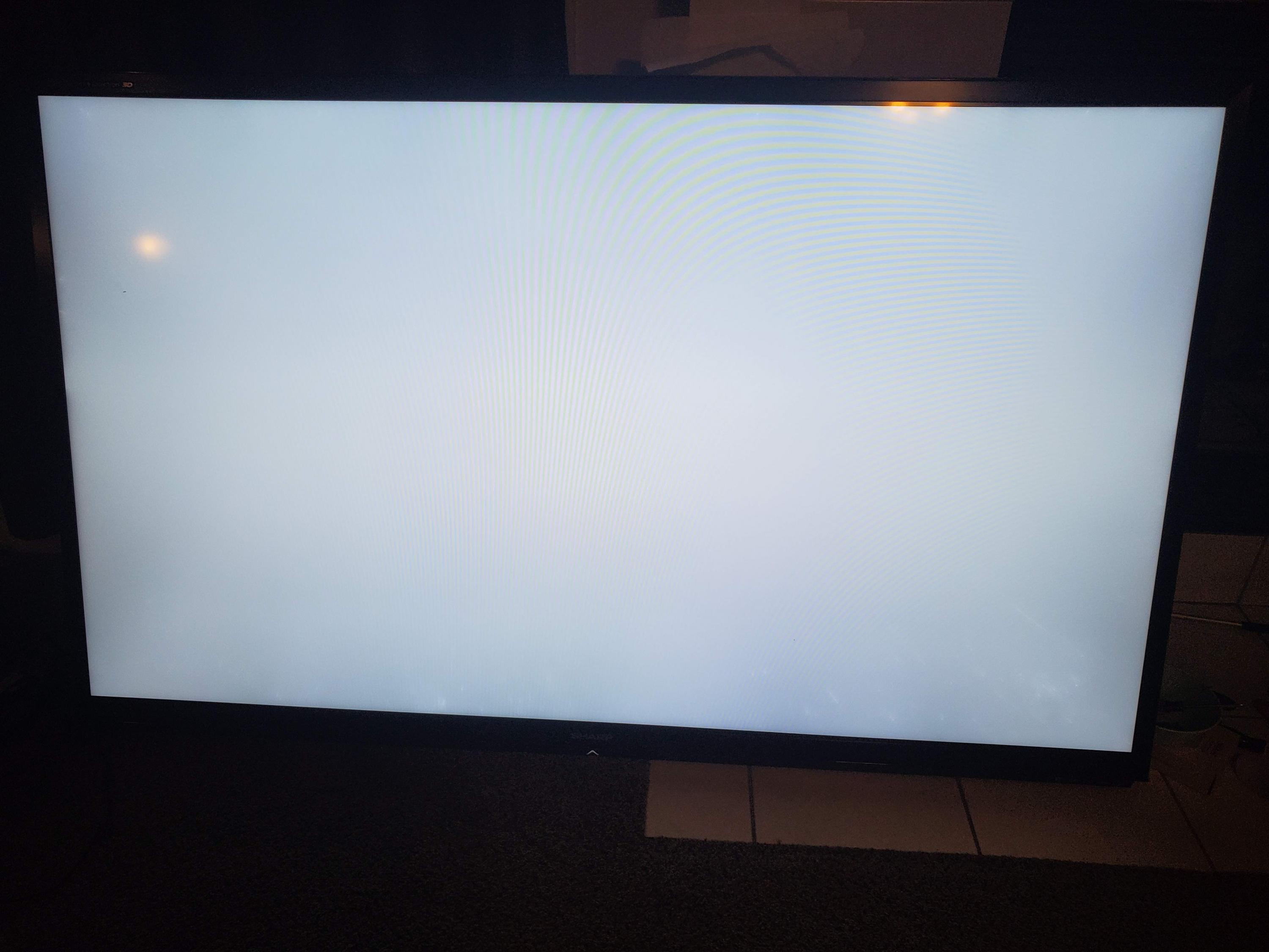

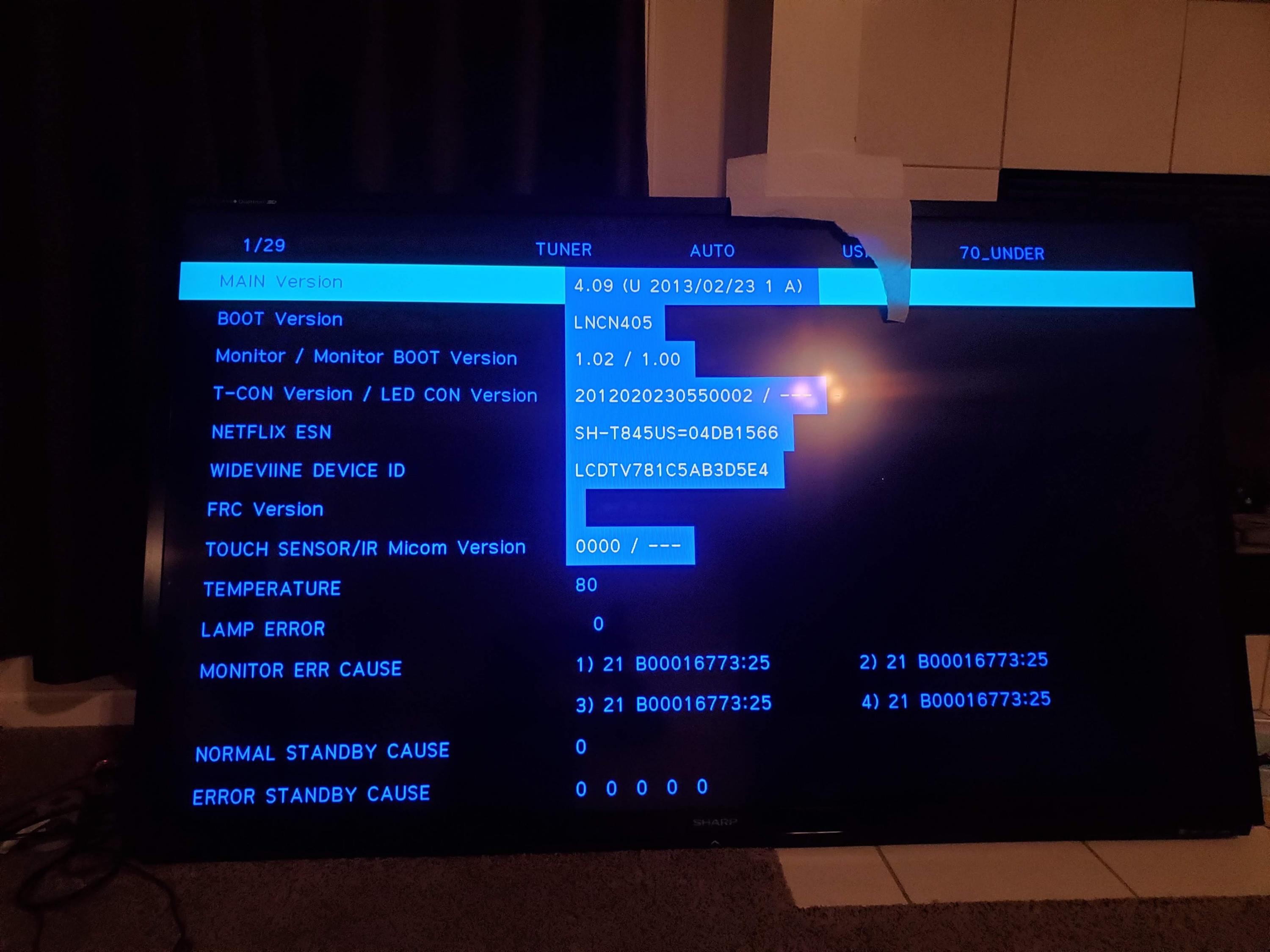

                          #332
                          Originally posted by budwich
                          I was not suggesting a crack in the panel. I was suggesting a display issue as in picture / pixels not correct. using poor source material will make it difficult to evaluate whether a display is functioning totally correct or has an issue.
                          Anyway, you are heading in the right direction. Although you indicate that the tv was functioning before this happen, is it possible that the set had issues (starting or otherwise) unbeknown to you and now you are seeing the "full result"?
                          Someone above suggested a crack. Here's a picture of the error codes i think. Also, here's a couple pictures with a completely white screen and an image. I've zoomed in on the lower screen because I noticed some streaks. Could this be the issue?

                            #333
                            Doesn't look cracked, I don't see the flaw in those pictures.

                              #334
                              I don't think it is cracked BUT the "marks" in the second picture (white angular "scratches"... if that is what you are trying to convey) appear to indicate that perhaps the set had some work done on it for backlighting and that the "marks" are a "reflection" of that work in terms of the layers in the panel.
                              As I asked before, what is the history of the set?
                              As for the error codes, I am not sure what they indicate... from various sharp SM, "21" is a power supply fault... but you kind of know that as I think the flash code also points to the same "failure". The fault is associated with the 12v system (tcon / power supply / panel). Based on my limited experience, the sharp system is good at monitoring this voltage and shuts down "quickly" before a more significant failure occurs as those you see with the "equivalent" vizio sets which usually takes out a FET on the tcon.
                              Not sure if the system specifically monitors the voltage itself or has some way of determining current levels. It is likely that too much current is a "bad thing" and the better trigger.
                              Your problem seems to be unaffected by disconnecting of cables which perhaps point elsewhere from the panel... but without knowing history and knowning the fact of the move, leaves the panel in question. I would recheck all screws holding down cards to ensure that they are tight. Check the frame area in and around the bottom edge boards as I do believe at one time, some sharp sets had an issue with the edge board coming loose and touching the frame which caused an issue.
                              One last thing, you can try a hard reset. I am not sure what the method is for this set so search. Some sets also have a reset within the service menu to clear errors.... it is likely your set has this one which might clear the monitor error.

                                #335
                                The TV came from my parents house and had been wall mounted since new which is ~3yrs. The TV was on and functional before moving. No issues in the past. I was careful moving as the TV is really flexible, much more so than my other Vizio sets. It was loaded in the back of my SUV and driven about 10 miles.
                                I'll try a hard reset and check the boards as you mentioned above. I appreciate the pointers.
