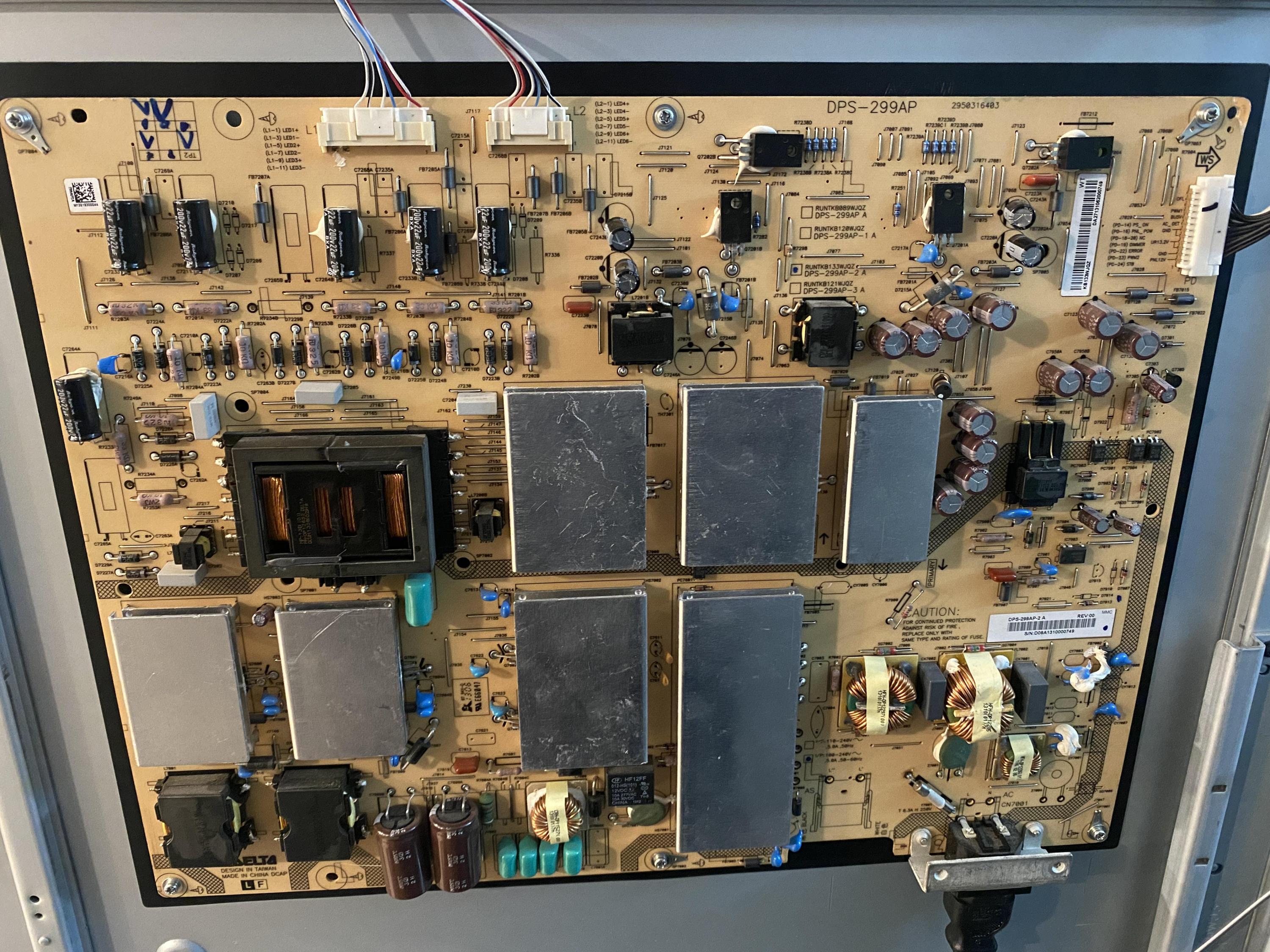

    I have a Sharp Aquos LC-80LE757U that randomly made a loud popping noise when when watching TV one day. We found that the fuse blew and the thermistor. We ended up replacing the entire power supply board and have also replaced the TCON board. Now as soon as I plug the TV in it lights up and has the Sharp logo flashing on and off of the screen. If I unplug the ribbon cable from the TCON board to the main board I get the 2 long 5 short error code. Any ideas on where to go from here? We've tried resetting it but nothing has worked. If we plug it in and let it cycle through the flashing of the Sharp screen it clicks off and gives the 2 long 3 short error code. Once I can figure out how to get my images and videos to attach I will post those as well. I am new to this so I hope I was somewhat clear on this. The link is my TV that I recorded and uploaded to help see what is happening.https://youtu.be/_xFSqnmIFxk

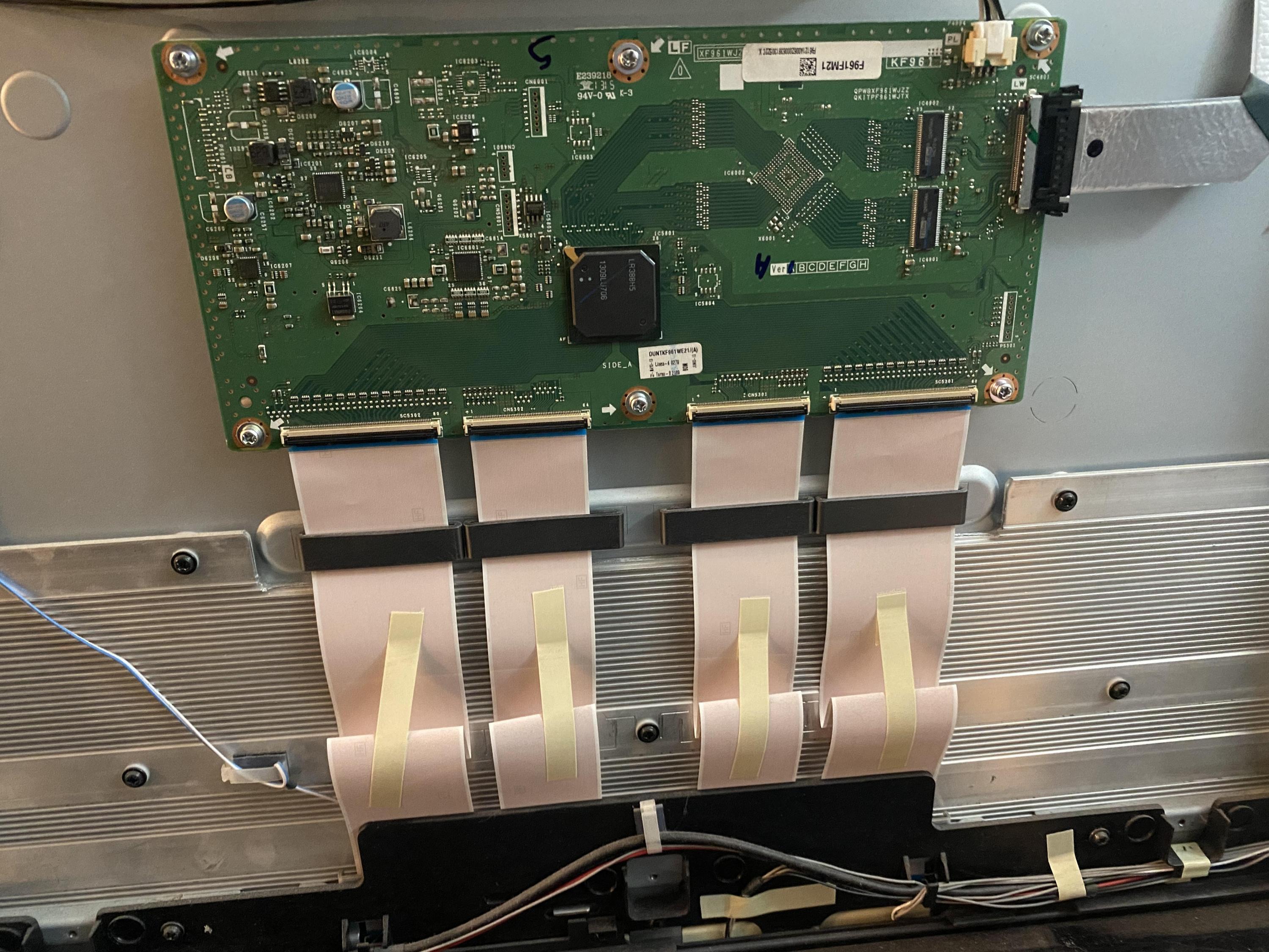

    try some testing, unhook all 4 ribbon cables from the tcon board, then turn it on, see if anything changes, then try with just one end cable unhooked and the other 3 hooked up, then do same for other side, take note of anything different, best policy is to make ALL connections and disconnections with tv UNPLUGGED from power to avoid any errant surges and such.
      I just unplugged it and unhooked all of the ribbons. I then added in one at a time testing them (I unplugged the TV between each time) then had three hooked up with one out and rotated them to see any differences. They all flashed until I had the second one from the left, when looking from the back and I got a black screen with white and grey vertical lines. After about a minute it started flashing again

            did you make sure the tcon was a match, usually need to match up the numbers on the white stickers.

                  ok, so you do get the blink error with everything hooked up? that does indicate a powerboard problem, do both powerboards give the same blink code?

                      ok, both those codes refer to power supply error.

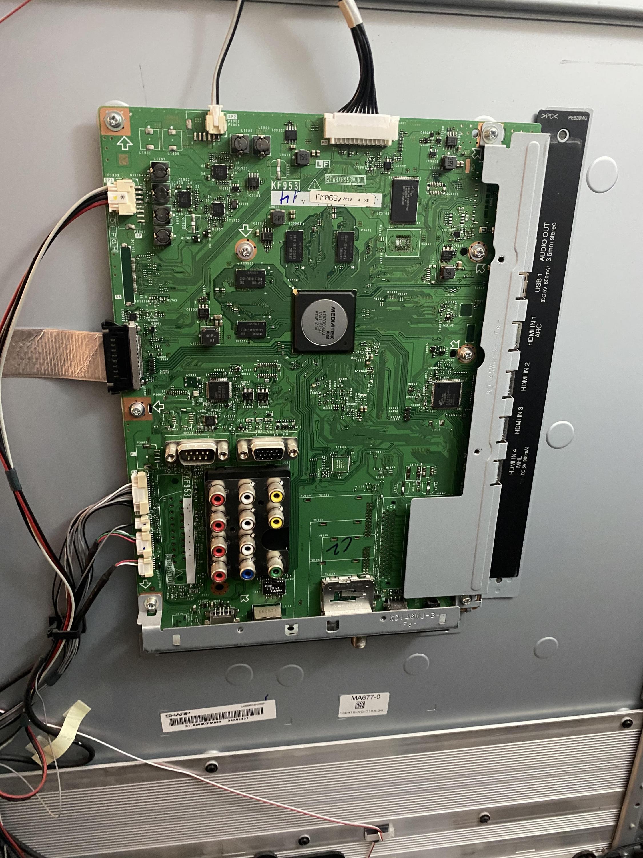

                              I haven't tried the 3D on it. I somehow managed to ruin the motherboard now too so I will have to order that now as well. But yes I got the same blink code with both power boards. What are the changes both power boards were having the same issue? Or could it be something connected to the power board?

                                good question, guess you could check the cable from powerboard to mainboard, check for any burn marks or off color on the ends, can also check it for continuity on all the wires, I just use a couple stripped bread ties, stuck in the ends to check continuity.

                                  might be good to check the powerboard as stand alone and see if the backlights come on and you get all expected voltages, not exactly sure how to do it on this tv, would also help if you could test each pin on the connector both in standby and when you hit power on, those bottom ones can be tough to check being so small and awkward to get to.

                                    Hi, try one or both of these: disconnect one flat cable at a time of the tcon output and test. Disconnect mainboard to tcon cable and connect a wire from 12v to tcon input fuse at Mountain of the two terminals then try. Note: i can't see nomoresonys posts

                                      why did you replaced the T-CON and you have only fuse on power board was blown..as you replaced the power boards..
                                      put back yours original t-CON. and don't play any more with panel or t-con ribbon cable.. just be sure the power boards you replaced belong to 80 tv size.. it may for 70 or less which didn't match the LED BL currents.

                                        I didnt think of that possibility, your replacement powerboard should be very much like this: https://www.shopjimmy.com/sharp-runt...ply-led-board/
