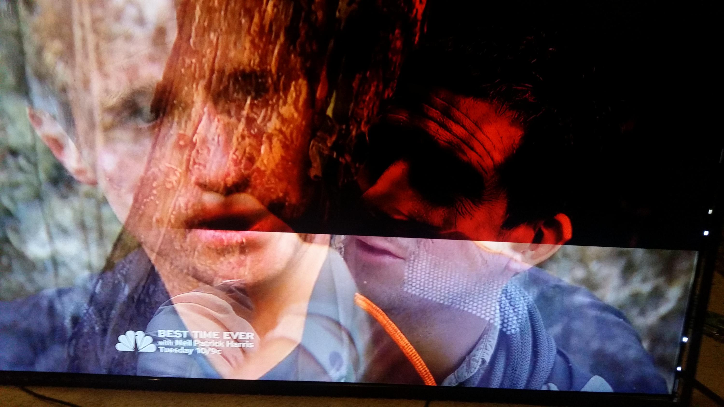

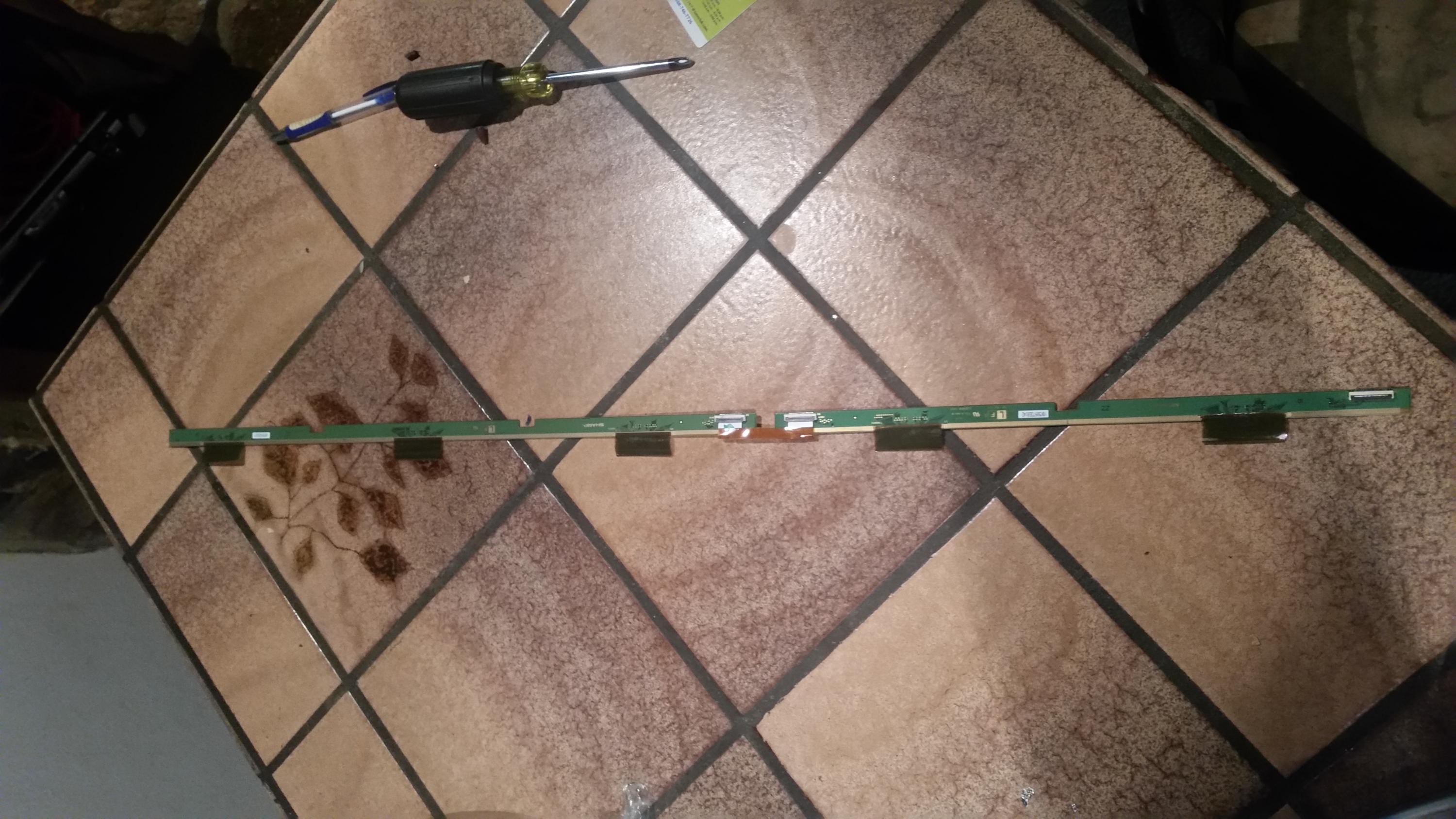

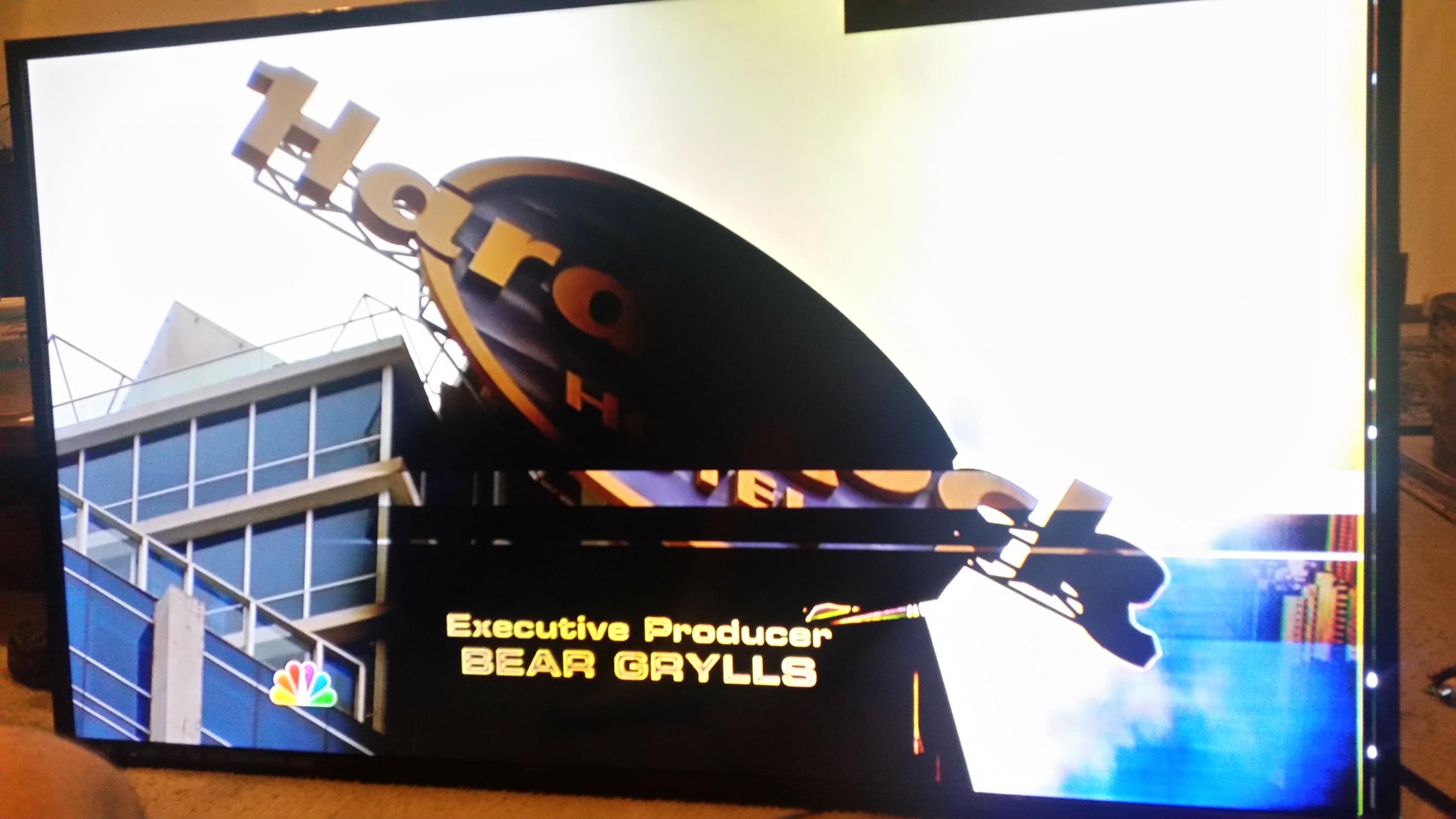

                          Here are a couple good pictures I took of the original problem with mine and what it looked like with just the power disconnected from the right side gate drivers. See the middle of the screen where the strip is where it looked good but the rest was dark? That's untouched yet. That area of the affected gate driver on the right side was making a bad connection so the panel essentially looked ok there. That's why I discovered that removing the rest of the drivers would essentially fix it.
                          The second picture is the bottom right side gate drivers removed.

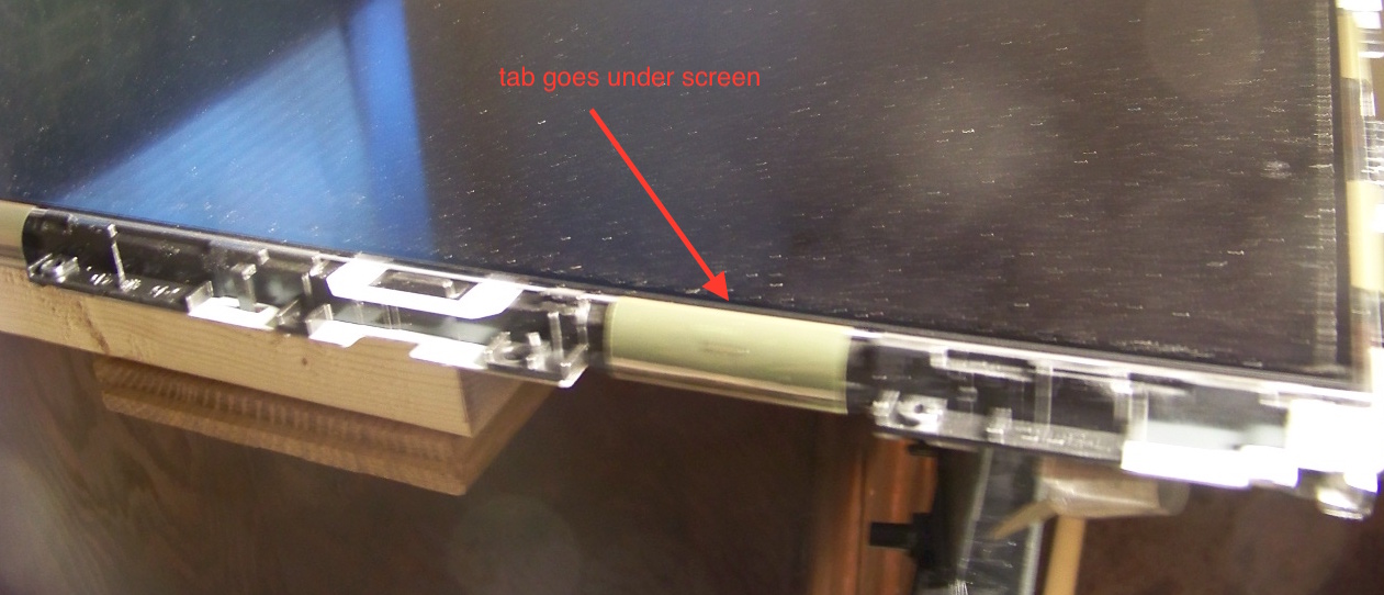

                                    OK... it looks like "shortly" could turn into "longly"
                                    HELP.
                                    I got the bezel off.... lots of unscrewing as the bezel acts like an integral structure member holding the screen flat and "sandwiched". IF you remove any of the screws before you have positioned the screen in your "flat" work space, depending on how many are left on at the time, the screen will almost be like "toffee" bending quite a bit... surprise. I thought the back bracing and such would be more rigid. Anyways, I should have left more screws on.
                                    The "HELP" is now that I have the bezel off, what next? It now looks scary. Access to the termination point of the flex cable tab is NOT readily available as it is goes under what I assume is the top protective screen of the "5 layer screen panel sandwich".
                                    What do I do to remove or at least "slide" the screen over to get access to those points?
                                    I am hoping I don't actually have to remove it but I suspect the "vacuum" effect will be great with that larger of a surface area. Dust is going to be an issue that I wasn't expecting to deal with (its my basement and it does have a work shop in there) as I was just expecting to deal with some form of "edge" only leaving the panel intact.
                                    I don't want to proceed until I get some comments / understanding as to the best way forward.... thanks for this.

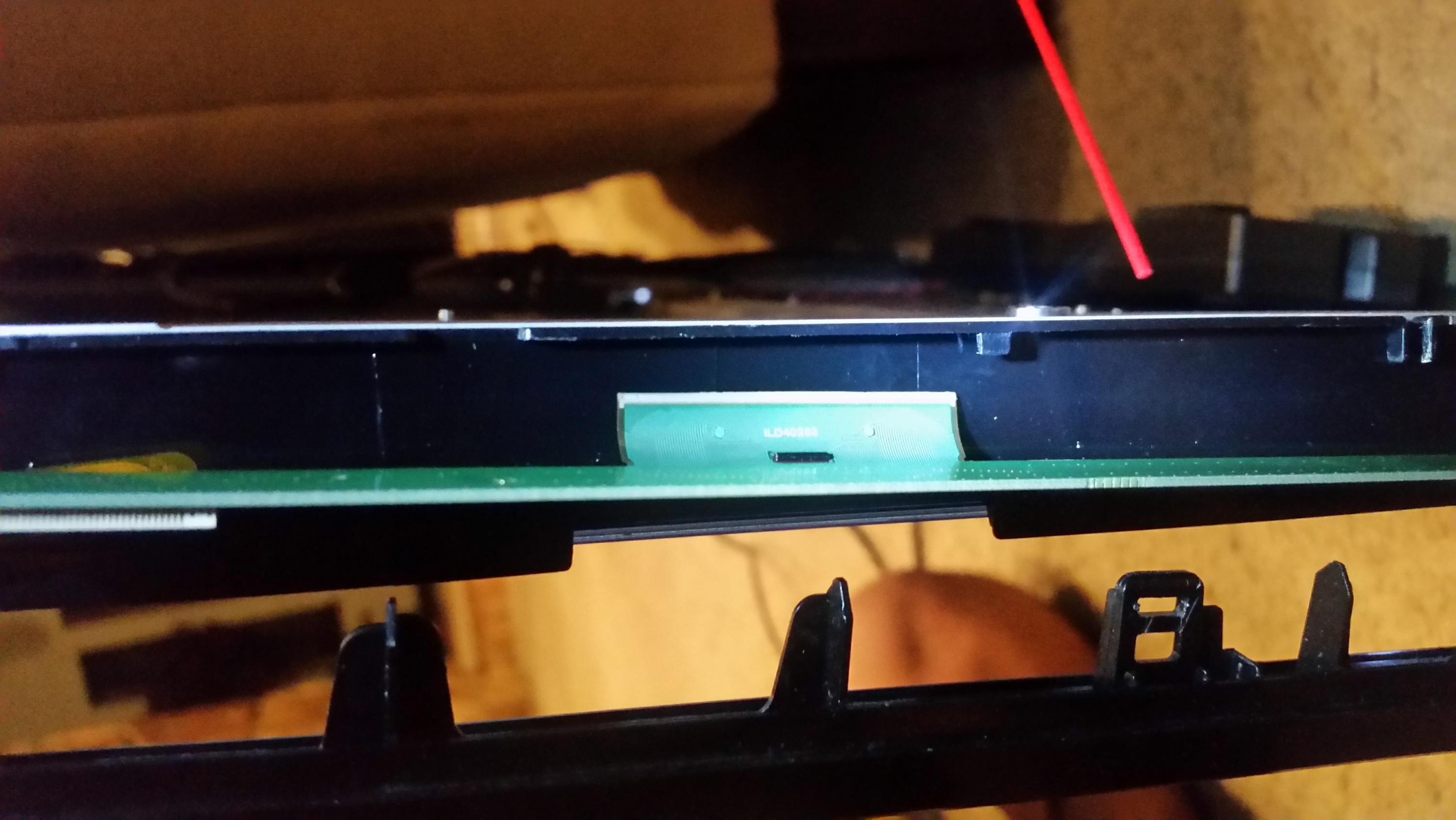

                                        Okay first of all what you're talking about disassembling is far and beyond what you need to do. You're already at the point we can remove those tabs they're bonded to the screen you do not need to take the screen out of the TV. You need to loosen the boards that hold those tabs to the frame they're two skinny green boards on that side. Make sure you got the proper side of the affected side of the screen. You need to carefully grab each of those boards starting with the upper board in carefully peel that cable of the screen from the top to the bottom of the screen. this should be done on this side that has the problem. If you look at my previous pictures I posted you will see what needs to be done.
                                          Re: Sharp LC-70LE757U Flashing 2-5 :-( can it be saved economically?
                                          By the way the first picture is showing the board still hanging off the screen but the ribbon cable had already been pulled from the scree. Those cables are physically bonded to the screen your purpose is to peel them off so they're not physically bonded to the screen anymore just on that side that is the bad side with the problem.
                                          In your picture you printed that the tab goes under the screen technically it is a mirage it does not go underneath the screen. It is fused to the side of the screen and you can peel that cable up and away from the screen
