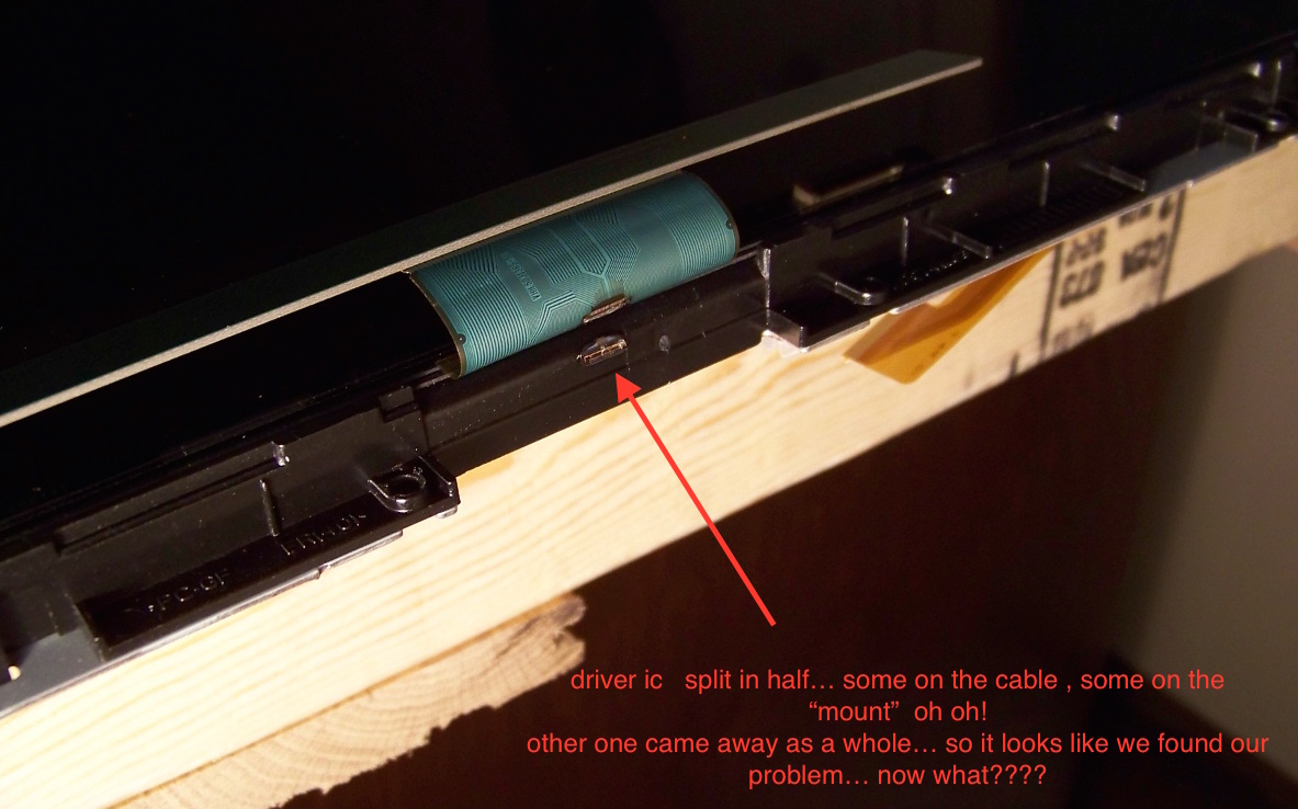

Sharp LC-70LE757U Flashing 2-5 :-( can it be saved economically?

    When I mean "disassemble the screen"... I mean take up at the top layer of the "sandwich".
    IF you look at the picture that I posted, the flex cable tab goes under the first screen... there is no access to the back side... PS. forget about the actual "side view" shown in the previous picture... I am indeed working on the screen's right side. (it was just easier taking the picture for the other side to illustrate what I am looking at. The new attached picture is where I am at NOW. yikes!
    Further, I "flipped" around the side edge board (lower right side). When I did that, the lowest driver ic came away "easy" from the side of the panel while the next one up "broke in half" with part stuck to the cable and part remaining on the side of the panel.
    NOTE: there is still no easy way to detact the flex cable (bond) from the screen... Do I just cut it?
      Re: Sharp LC-70LE757U Flashing 2-5 :-( can it be saved economically?
      OK...
      I put on my reading glasses and looked closely at the edge board and the flex cable at the panel. I now see that there is about 1/16 wide copper looking connection surface where the cable is bonded to the panel. As you indicated, I should try and "slowly" remove that portion. Any tricks?
        Interesting that that ic burned into the plastic that must be the bad one in that case you're at the point where you can peel those from the panel.
        Yes in this case just take a very nice pair of scissors and carefully cut across those cables so they're no longer attached to the screen part anymore. All of them. There should be like 5 or 6 cables on that side of the panel.
        On A side note you can leave the boards inside the black bezel just make sure that the carriers are not attached to the panel anymore
        This should be all you have to do your job is now done. At this point you can power up the TV after you're done and see if you have a good picture

            I tried to light pull the cable up from the bonding. It basically tore. I don't think there is an issue though... I hope. The "bonding area" (attachment thing) on the cable end is still bonded to the panel edge ... ie, there is no visibility of the underlying copper traces ("fingers") that the "bonding thing" is sitting on... the "bonding thing" must be some sort of thin conductive pin termination "skin". Anyways, I am hoping that there aren't any shorts across the underlying "traces". The flex cable seems to tear fairly easy when pulled up along one edge slowly.

                This doesn't give me much hope for the other side. I am thinking that ic are actually expected to be in "free air" as opposed to touching the plastic. By touching the plastic, it may have caused a "circulation block".
                I have lifted the top half edge board. One of the drive ic has started to melt the plastic but was not stuck to it yet.
                :-( not sure about the long term success of this... if I even get that far.

                  This is what I mean about a bad design. What the manufacturers should have done was sealed those IC's against an aluminum source with a white thermal paste compound to prevent them from overheating instead of having them pressed up againstplastic

                    ok.... are there any last checks / things that I should do before powering this thing up... with my fingers cross!!!
                      Other than making sure that all the cables are clean cut from that side of the screen and the IC's are no longer connected to the screen no give it a shot
                        PICTURE PERFECT!
                        so "economically" means "free"... :-) of course, I (and my neighbor) realize that this isn't a "fix", its a "save" which could be for any length of time... but as they say in hockey... "a save is a save, not matter what". thanks for the great help. I wouldn't have tried anything if it wasn't for the tips and guidance provided herein.
                        As for others that have similar problems, as suggested, once you have potentially isolated your problem to either edge drivers, the process to removing them seems fairly easy assuming you have the space to work on the unit face up. I used a raise "platform" along with two boards long enough to span the tv horizontally. I then affixed strategic 2X4 pieces of wood to those boards (both across and aligned) to support the panel in key areas and allowed me access to the underlying circuit boards and screw mounting positions.
