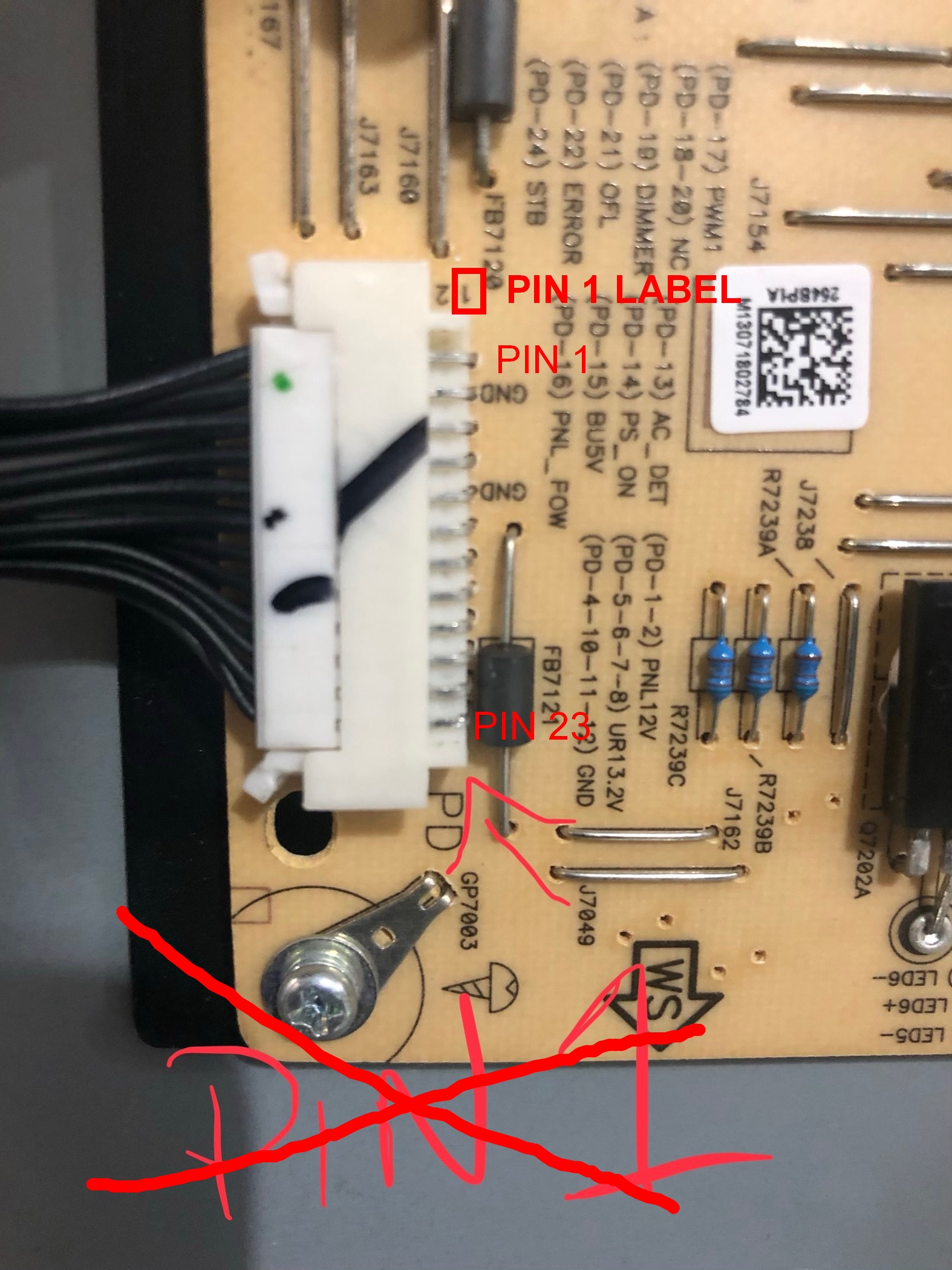

            #305
            Re: Sharp LC-70LE757U Flashing 2-5 :-( can it be saved economically?
            Originally posted by budm
            https://www.badcaps.net/forum/attach...8&d=1563917022
            That is not pin 1, pin 1 is printed right on the board next to the connector, you can also see pin 2, which you cannot get to it from the top side of the board as I explained).
            There are 24 pins total, the connector has to be in place to take the measurement.'
            Right now what you report is not usable, no pin name to go along with each pin, wrong pin count, etc.
            Hey guys, I'm sorry.. I just don't understand how to read the pins on the board correctly since im new to this its a bit confusing to me.
            Basically the TV is upside down and I don't want to move it around too much risking a crack in the screen. Not trying to be lazy but I added that picture and labeled It pin 1 to let you guys know where I started with the measurements so:
            8.8v - pin 1 (not physically pin 1, but where I marked it on the picture)
            .659 - pin 2
            12.7v - pin 3
            12.5v - pin 4
            5.04v - pin 5
            3.32v - pin 6
            02.2v - pin 7
            02.3v - pin 8
            13.36v - pin 9
            03.6v -pin 10
            11.92v - pin 11
            If I have to do it all over, that's fine I just am not too sure where to start :/

                  #308
                  .659 - pin 2
                  12.7v - pin 3
                  12.5v - pin 4
                  5.04v - pin 5
                  3.32v - pin 6
                  02.2v - pin 7
                  02.3v - pin 8
                  13.36v - pin 9
                  03.6v -pin 10
                  11.92v - pin 11
                  Nope, do it all over, pin 1 is printed right on the board, you can see it. Your pin 1 is actually pin 23 if you count the pin correctl.
                  This is is the format we are looking for:
                  Pin 1, PNL_12V: XX.V reading
                  Pin 2, PNL_12V: XXX.V reading
                  The chart for the PDC connector is printed right on the board, and report the readings for all those pins as listed. BTW, the PD connector has two rows, odd row and even row, 12 pins for each row, so 24 pins total.
                  I am too lazy to superimpose your pin number to the actual pin, beside you only show 11 pins instead of 12 Pins total for the ODD number pins that you can see from the top side of the board, you did not report any reading for the EVEN number pins (12 pins). Pull PD connector out and you will see how many pins it has. Bad data does not help in troubleshooting.

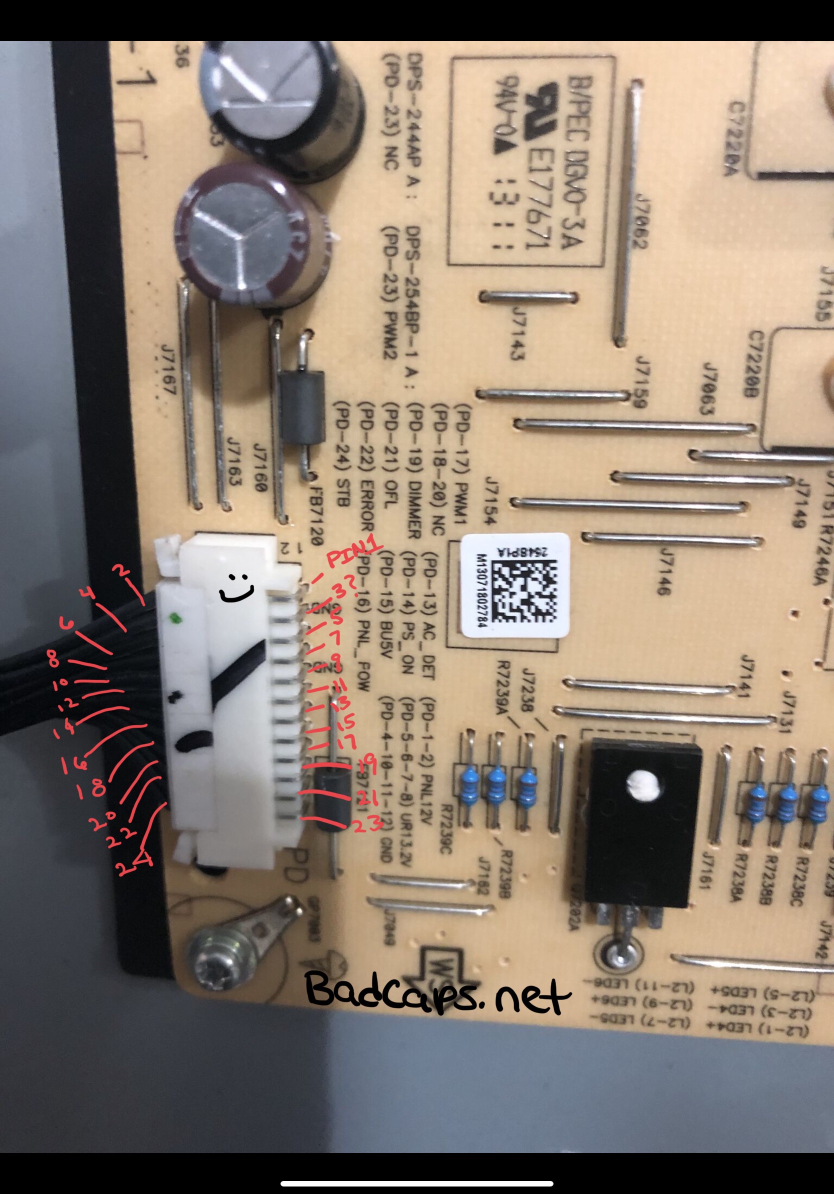

                    #309
                    Ok, I just reread your first post to me and realized my mistake. I was so confused cause I didn't realize the wires were another 12 set of pins :X Also is there a PIN #3? I don't see anything in the legend for that pin #.
                    I attached a photo here, I think this looks right now?
                    Also, I am supposed to be testing ONLY with the TV powered on right? And ground probe goes anywhere on the Chasis?
                    Hopefully all of this will help any newbs like myself in the future, heh

                      #310
                      Ok, so I redid it and tried my best. The multi-meter I have has this 'auto range' thing so the numbers go up and down sometimes. Also the EVEN side was bit hard as my probes are somewhat thick but I retested 3 times. Here's what I got the following:
                      Pin 1, PNL_12V: 11.91v
                      Pin 2, PNL_12V: 11.94v
                      Pin 3, GROUND: 0.28v
                      Pin 4, GROUND: 0.27v (although ground, just posting my meter reading)
                      Pin 5, UR13.2v: 13.35v
                      PIN 6, UR13.2v: 13v
                      PIN 7, UR13.2v: 13.35v
                      PIN 8, UR13.2v: 13v
                      PIN 9, GROUND: 02.4v (again, just posting my auto range meter reading)
                      PIN 10, GROUND: 02.3v
                      PIN 11, GROUND: 02.3v
                      PIN 12, GROUND: 0.23v
                      PIN 13, AC_DET: 3.3v
                      PIN 14, PS_ON: 3.3v
                      PIN 15, BU5v: 5.04v
                      PIN 16, PNL_POW: 5v
                      PIN 17, PWM1: 13.3v
                      PIN 18, NC: 13.4v
                      PIN 19, DIMMER: 13.4v
                      PIN 20, ?: 13.6v
                      PIN 21, OFL: 3.4v
                      PIN 22, ERROR: This pin I tested a few times goes up and down 3v, 5v, 7v in no order. Basically bounces around.
                      PIN 23, PWM2 / NC?: 9.5v
                      PIN 24, STB: 9.5v

                        • budwich
                          • Jul 2015
                          • 3097
                          #312
                          PIN 6, UR13.2v: 13v
                          PIN 8, UR13.2v: 13v
                          PIN 14, PS_ON: 3.3v
                          PIN 15, BU5v: 5.04v
                          PIN 16, PNL_POW: 5v
                          PIN 17, PWM1: 13.3v
                          PIN 18, NC: 13.4v
                          PIN 20, ?: 13.6v
                          PIN 21, OFL: 3.4v
                          PIN 24, STB: 9.5v
                          that's better. so if I read right, you appear to have major differences in the grounds ...note some are indicate .2ish while others are 2.ish. They should all be roughly the same... but potentially "finger problems". What are you using for your ground reference point for your meter... hopefully NOT one of the labels... usually a chassis screw is used. Further, "ground" as labelled should be checked WITHOUT power on and use your ground reference point (ie. known ground) and measure the resistance from the labeled pin... it should be a "short" / 0 resistance.
                          the error pin shouldn't be bouncing around, but again it depends on what you were using as a reference ground.... if the "reference" is not truly a ground then it is likely some voltage measurements maybe erroneous but the reference point might be "floating a bit".
                          Now that you have the "hang of it", there are usually other voltages to worry about associated with powering / driving the back lights. Look at or around the connector that may be coming off the power board and going somewhere up into the top of the panel somewhere.
                          A picture of the back of the set showing everything connected might help.

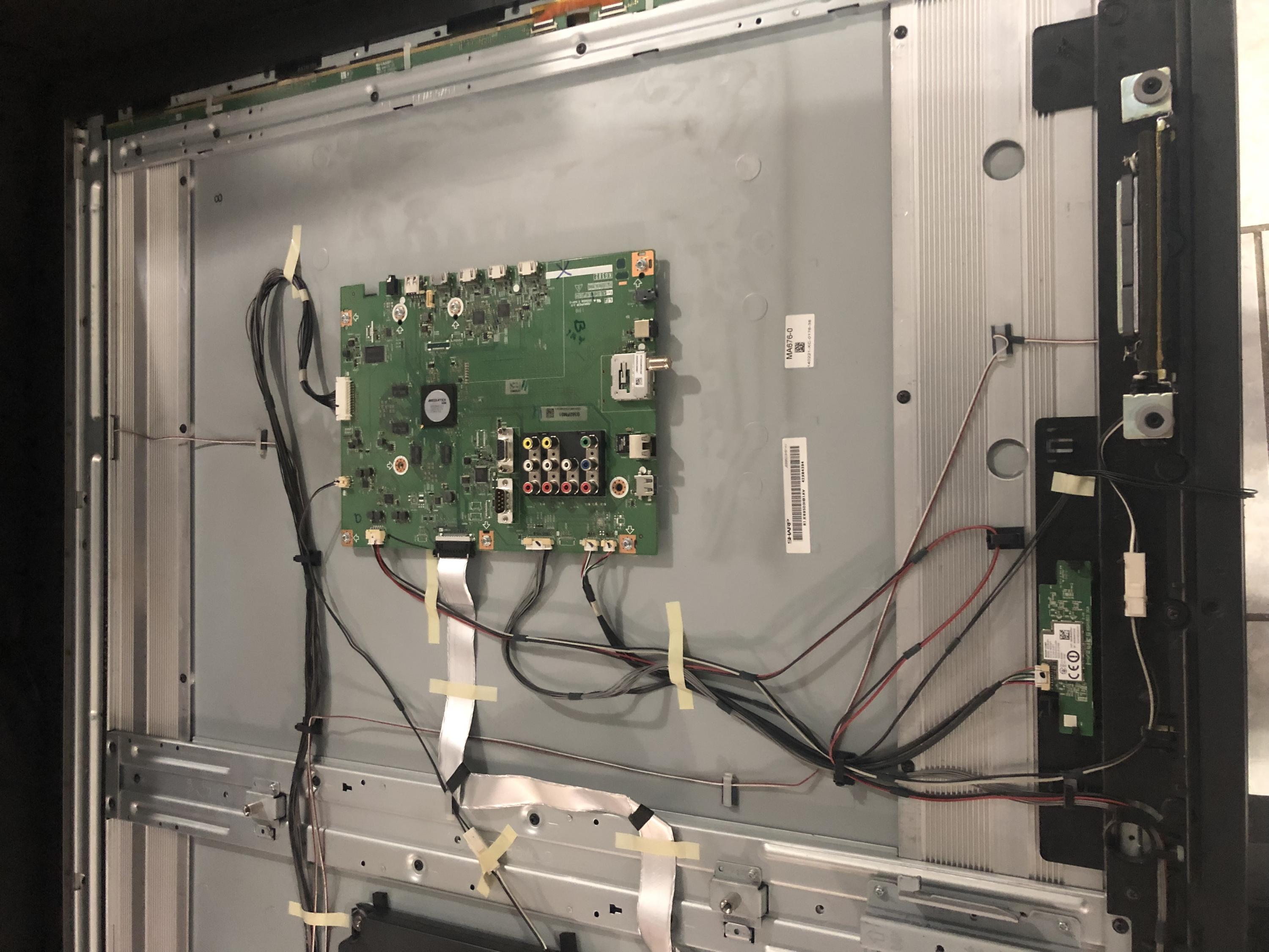

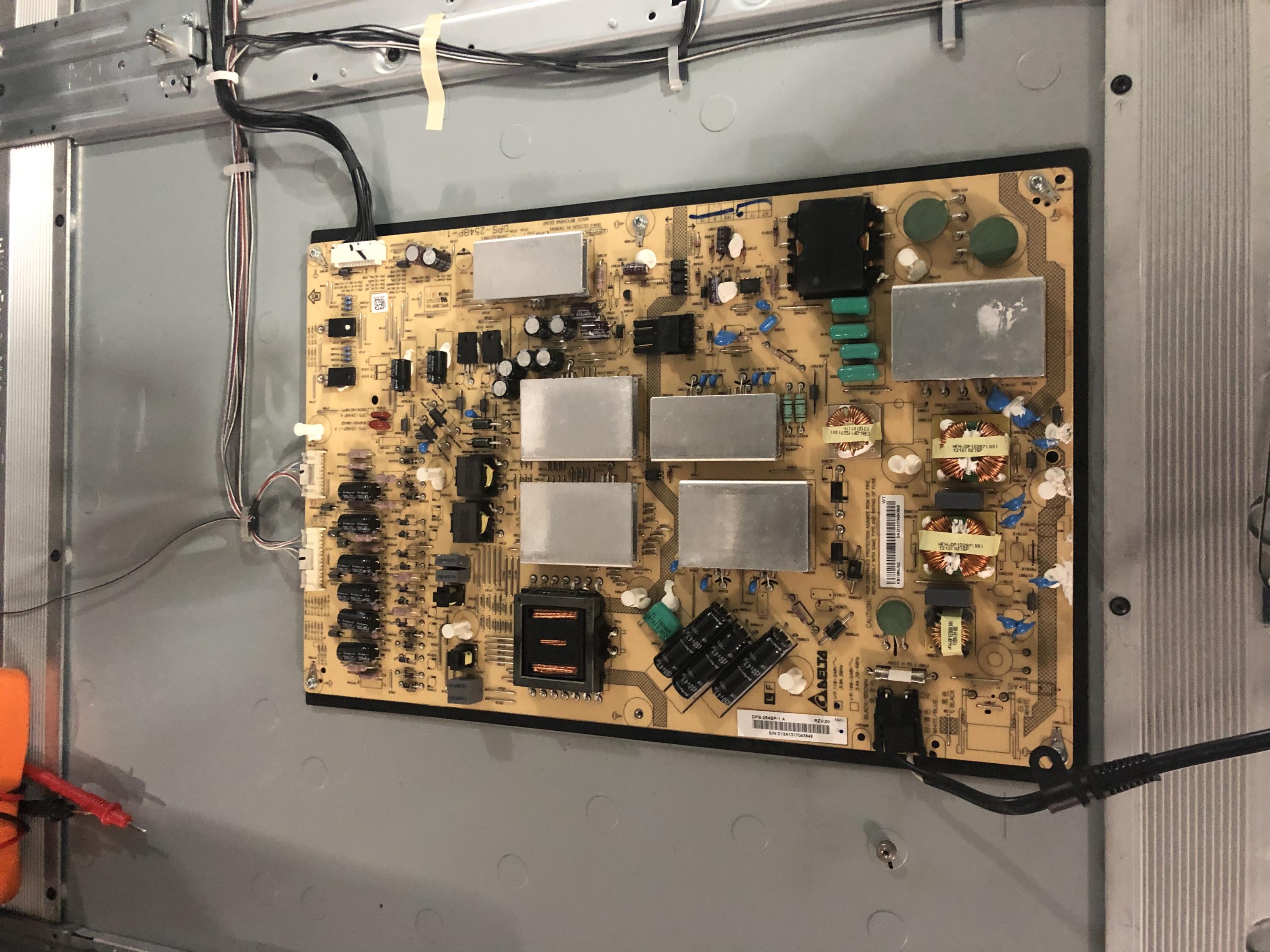

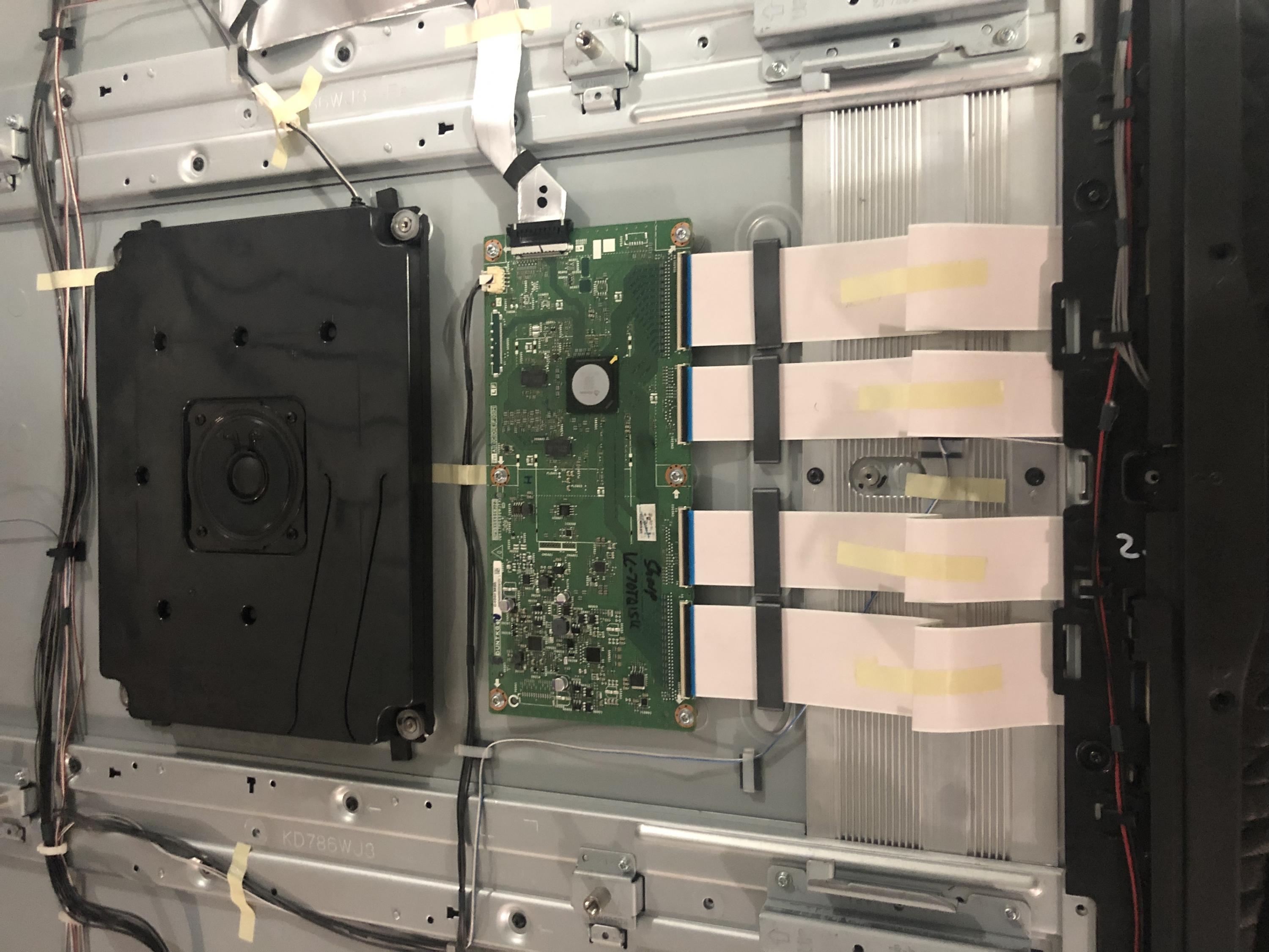

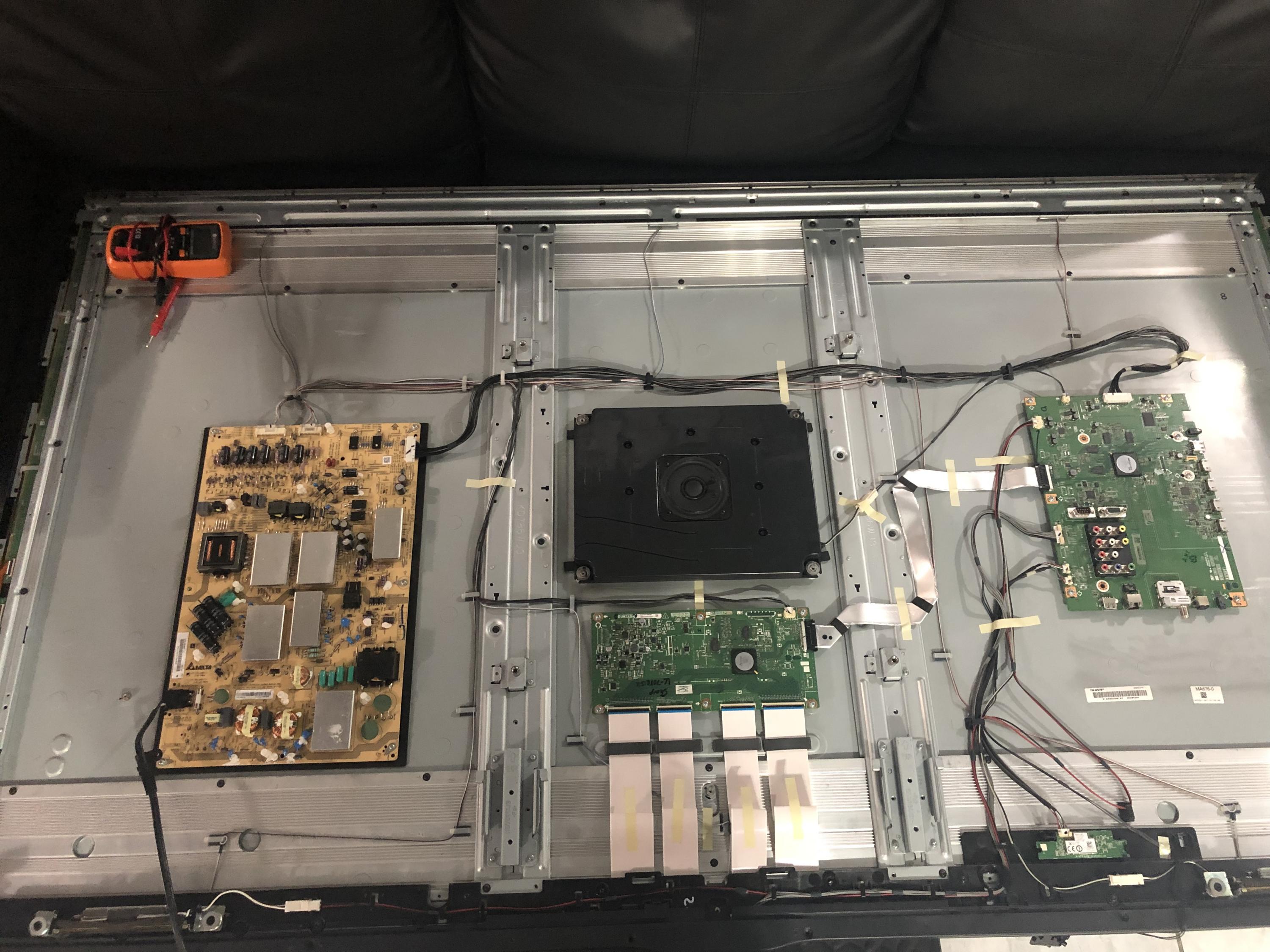

                              • anthony_c
                                • Jul 2019
                                • 49
                                #315
                                It looks like the board/s screws are not tightened so the board GND points are not making good contact with the chassis, GND pins on the connector should be 0V, your reading show some GND has 0.28v, some have 2.3V so that is not right.
                                "PIN 24, STB: 9.5v" that does not look right either.
                                You may not have good connection between your probe tips and what you are trying to measure.
                                Hey, thanks for the response. yes, I am using the chasis as a ground. My meter is kind of weird I don't really understand it but it could be the auto range feature on it. I'll recheck those pins. I believe STB is definitely showing 9.5v
                                I'm uploading pictures of the set now.
                                • anthony_c
                                  • Jul 2019
                                  • 49
                                  #316
                                  Here you go.
                                  • budwich
                                    • Jul 2015
                                    • 3097
                                    #317
                                    the top two connectors likely go to powering the backlights... there should be some labeling such as + / - ... you can carefully measure voltage across those "pairs"... note, it might only be momentarily on as the system may shut down those voltage when an error is detected.
                                    Further as mentioned by budm, IF indeed that measurement is correct, it would seem high... maybe. The "ground" measurement seem very strange. Do you have your meter set on DC or AC? Another general check, find two chassis screws locations and measure the voltage across those.... is there a difference? Further, again with power off / disconnected, do the same test with a resistance reading... it should be 0 or a short.
