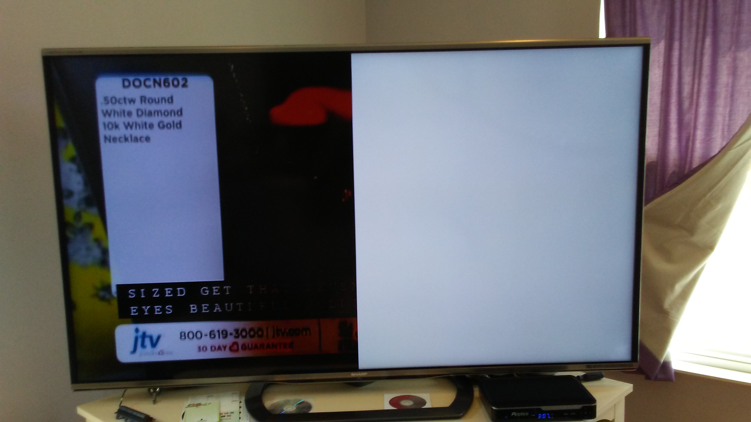

                                    Ok, I have the Sharp LC70LE857U with the 2 5 error code. When I disconnect the 2 ribbon cables on the left side (from the back) of the T-Con board it eliminates the 2 5 error code as shown in the picture. It displays a picture on the left half and solid white on the right side(from the Front) of the TV as shown in picture 2. so does this mean the driver board on the left side(from the back) of the TV is the board that I need to remove the Tabs from?
                                      Re: Sharp LC-70LE757U Flashing 2-5 :-( can it be saved economically?
                                      what happens when you do the same type of test the "other way around"?
                                      The best test for checking the conditions is to unplug the small corner cable in the bottom corrner of the panel (one on each side) with the tcon cables ALL connected. This test isolates on the side tab drivers but should result is a "full picture" which can then be reviewed to see if there are other issues.
                                      Your present test "result" doesn't give full assurance that the issue is with the side tabs because you have basically disconnected half the panel.

                                        I understand. So I went and hooked all 4 cables back up to the T-Con like you said and Disconnected the cable from the right side corner( looking from the rear of the TV) my symptoms were cross-hatched with no Image picture it ran for about 3 minutes then it through the 2 5 code. listed below.
                                        so I hooked that corner cable back up and I unplugged the left corner cable(looking from the rear) Symptoms then was a pretty decent picture with normal color on the left and dark picture in the middle with a reddish hue to slightly lighter on the right side of the screen I let it run 5 mins and it did not through a code.
                                        Thanks for the help
                                          ok.... hmmmm..... it would appear based on the first picture that you can see that there is some horizontal lining happen. That usually points to an issue with the side.... but the amount of "disturbance" vertically is somewhat surprising although not necessarily unseen / unforeseen as issues with a side tab can have strange results impacting the lower edge boards at the bottom of the panel that are feeding the side edge boards and ultimately feeding the side tabs which in this case appear to have an issue.
                                          the next check would be to look closer on the side tabs of the likely bad side (left side from the back... since disconnecting it gave a relatively good picture). look to see if the lower tab on that side are hot or have some form of "heat burns". that will confirm that you are on the right track and likely only have to remove that side to get a working set again. This is just for extra care as once you have removed the sides, there is no way back as they CAN NOT be replaced.
