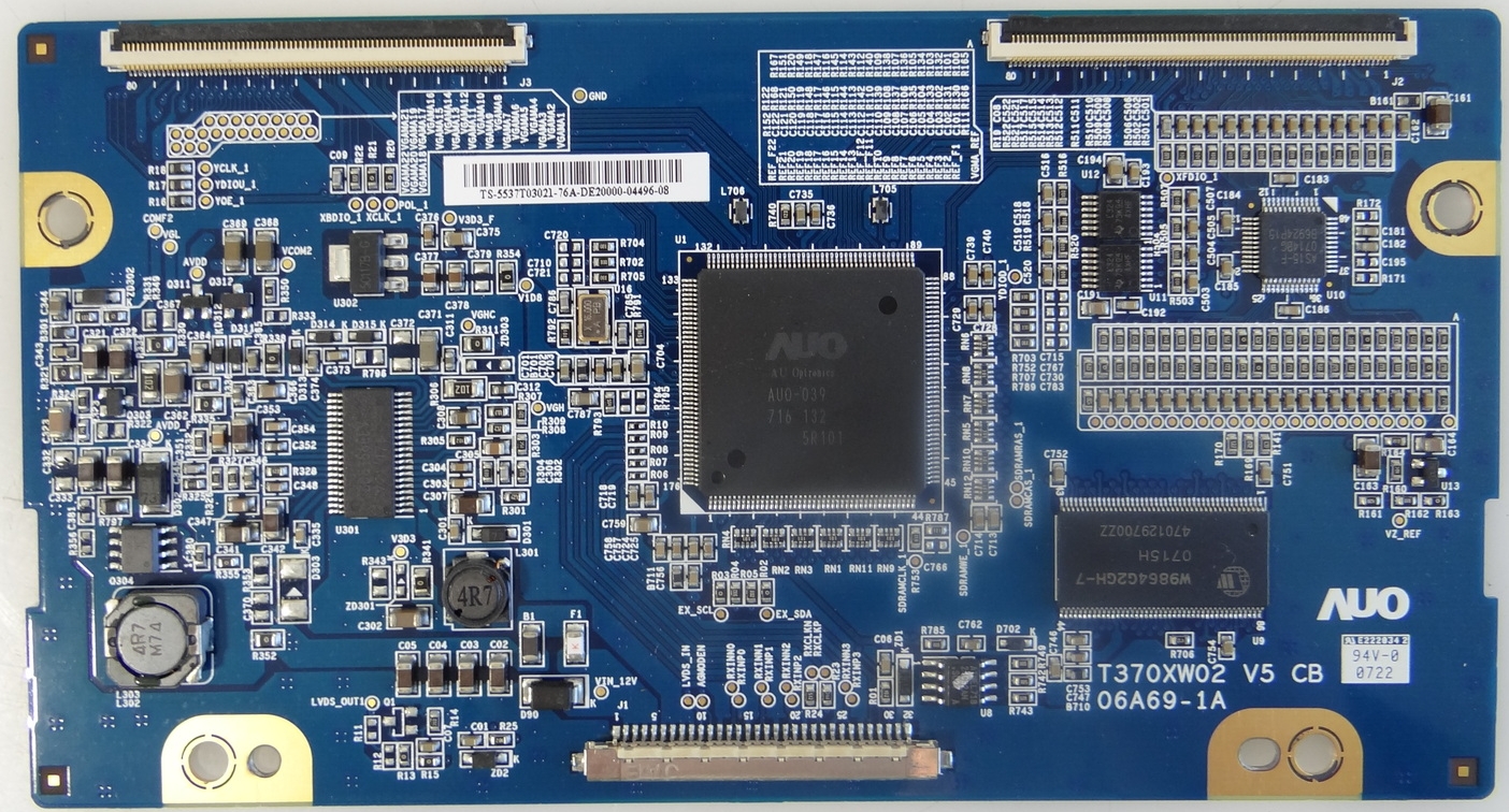

        I am surprised that it did not have one on the AS15.
        Does the IC too hot to touch by fingers?

          Hi budm, thanks for the help. I'll post an image of the board. This one (#3) does get screaming hot, and right away. Too hot to hold your finger on it. The last one I tested (#2) did not, so I didn't think to check this one until you asked.

                Thanks Michael, it was burning hot within seconds.
                  Re: T-CON Check Spreadsheet
                  I just replaced the burnt out AS15 on the T-CON board on 46" SAMSUNG, power it up without the ribbon cables between the LCD panel and the T-CON, no heat no smoke, unplug the power and connect all the ribbon cables, applied the power and turned on the TV, in less than a minute the IC smoked!

                          Yes, it is the bad panel that takes out the AS15.
                          I took the T-CON board out and replace the IC again but install the T-CON on anther SAMSUNG same model and panel without any problem, so now I have spare power supply, T-CON, and Main board for the next repair works.

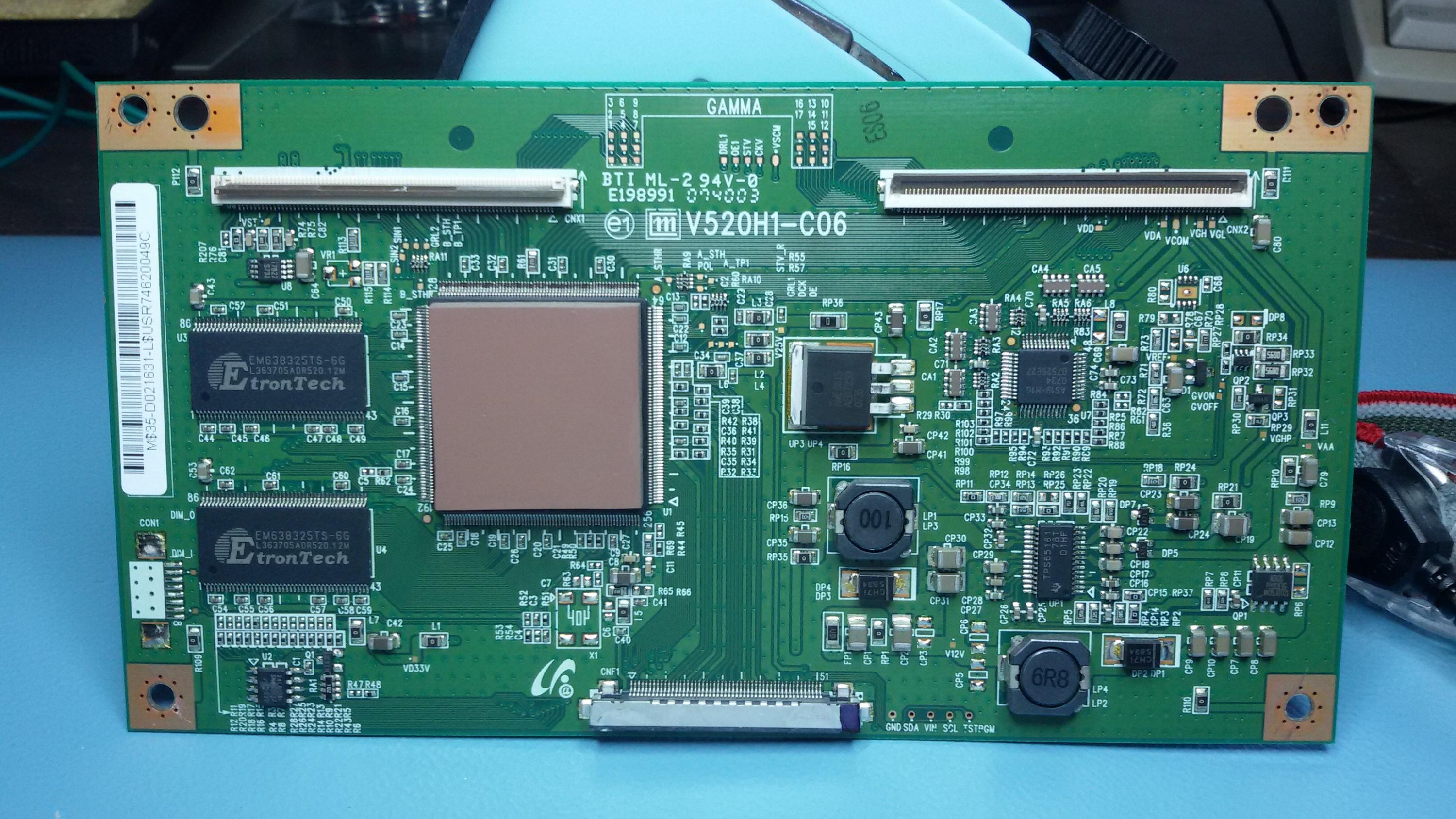

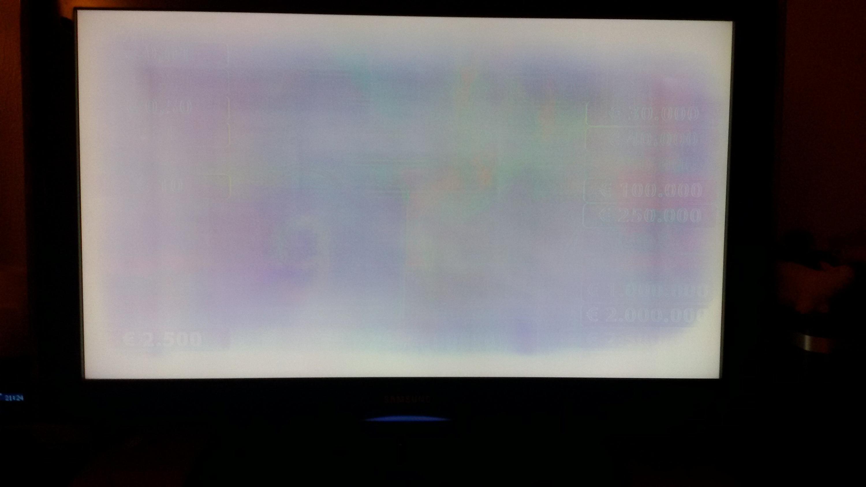

                                  I am testing my v520h1-c06 TCON. It doesnt have a AVDD test point, but a VDD and VDA. Which one do i need to fill in the spreadsheet?
                                  It's for the Samsung LE40N87BD, problem is image persistence.
