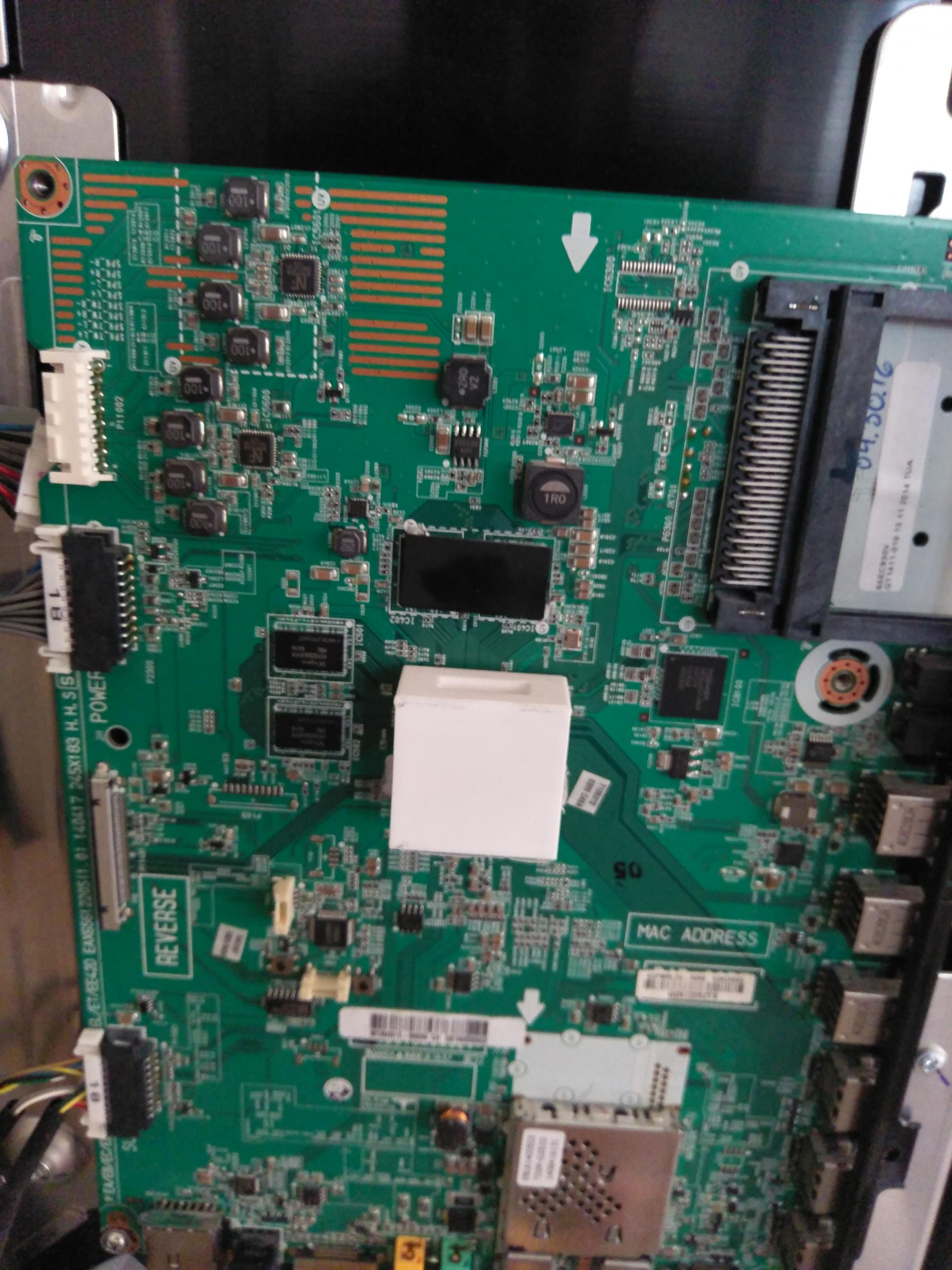

    Then I go to main board. I connected it to power board, and I try usb wih mp4 movie on second usb input, some peoples said that sometimes helps start board, or just to hear sound if board is working. problem is that my usb stick have led indication if is readed from, and that light was not showing up.
    Then I try use one of push buttons on the board to turn on. After doing that steps and hearing 3 times on of, it starts. Power to board with voltages 12V and 24V was correct, no noticed any voltage drop. But Usb did just fast blink, and that's all... Nothing more.
    I connected also pc on HDMI port, where alwas was connected, On this port before I brake it, Tv was working on. Also nothing. No sound.

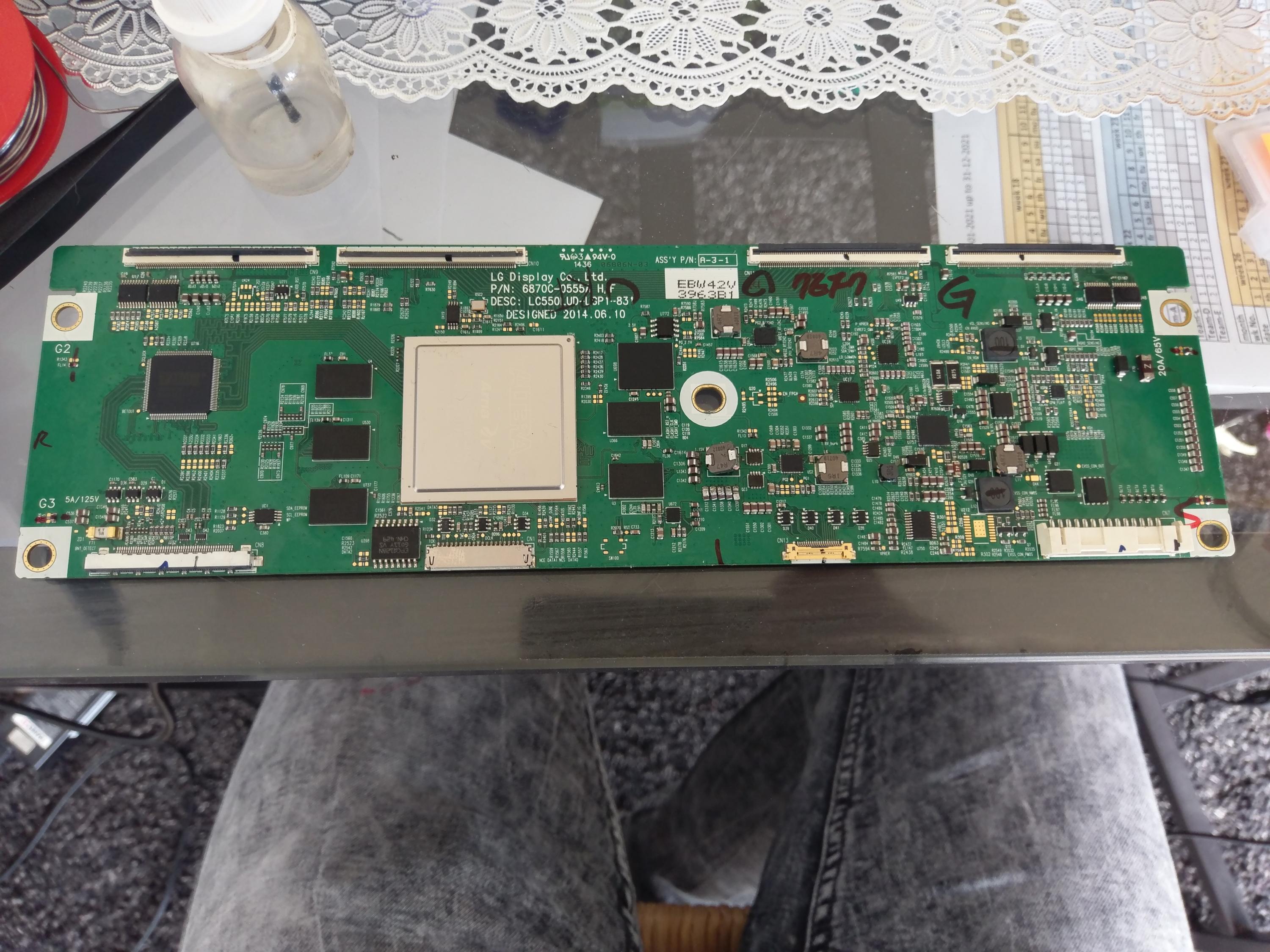

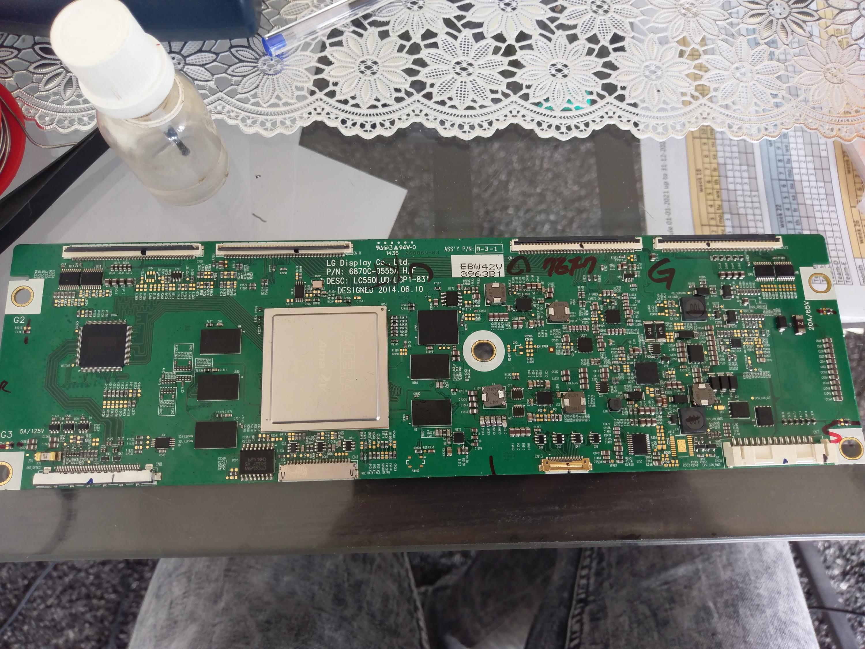

    Then I focused on Tcon board. I check voltages on turning on state. there voltage rise to almost 24V and turns of... First My assumption was, maybe there is shortage on board on TCON Board? I check board visually and nothing, I check resistance with multi-meter on side where 24V is supplied, also nothing. Then I get Idea to bypass turn on power board with 1Kohm. I disconnected main board and I put resistors in to socked. I check voltage on TCON, and ..... There was nice steady 24V. I keep that for a while to check if some elements are heating on... Nothing, board was cold.
    That Means that power supply for led screen is good.
    Then I found out where is fuse on TCON, And I check that, fuse also is good. There gows 12V and is steady. " I want mention that this model OLED have separate power to processor on TCON and separate power going to screen. Means that TCON stripe don't power screen it self, is powering only processor...
    Ps, I forget mention that Main board have led indicator which check if TCON send signal if is working or not, and That led is shining on red. I trace that led connection and one of the traces go straight to TCON board. Normally transistor is powered from main board with something 2.3V, But connection from TCON is shortening to ground, and this way, main board knows what is going. Question is if that signal , that red light is good sign or not?
    -I still could not figure out which board is broken. Or there are two ones bad?

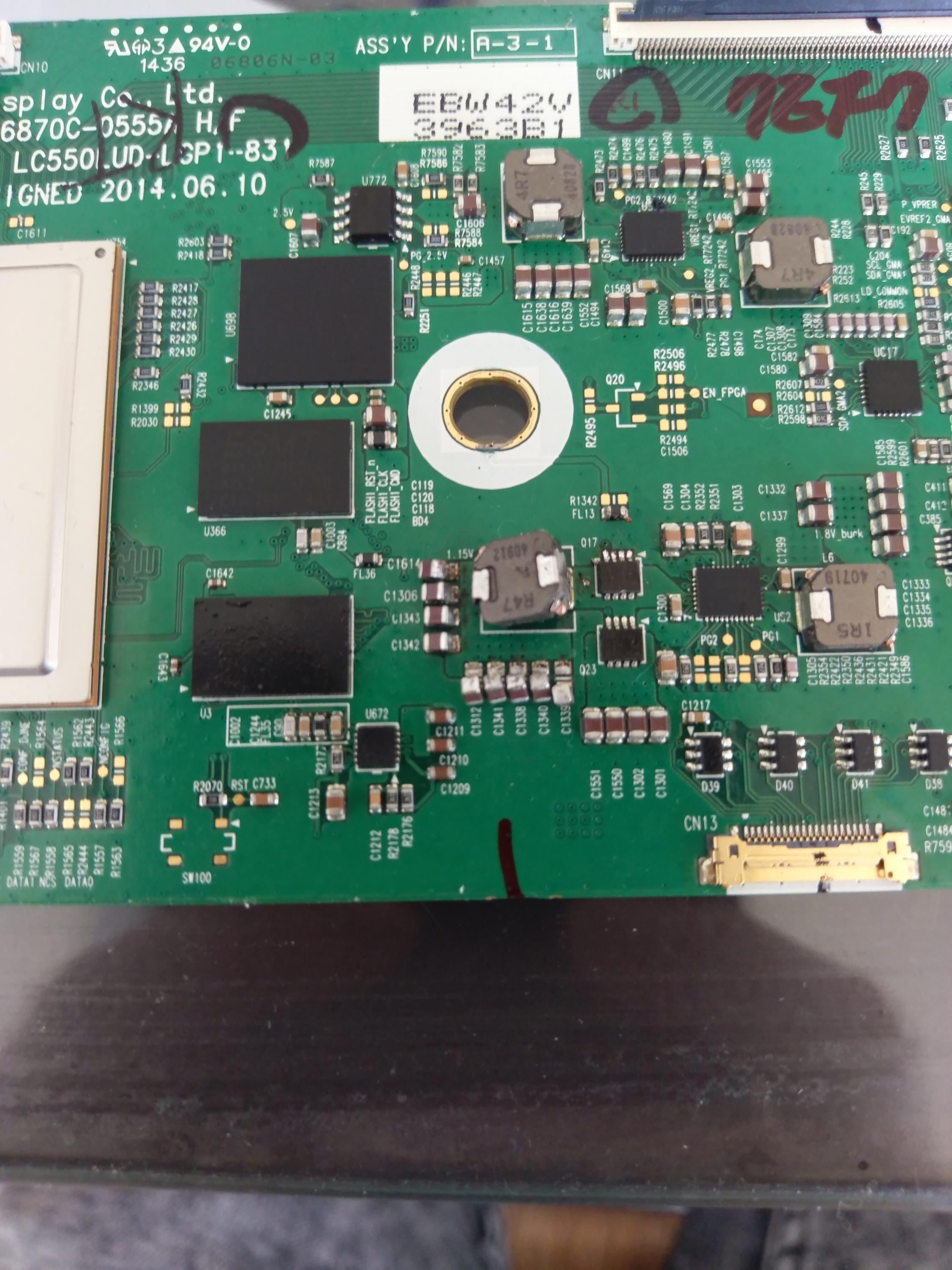

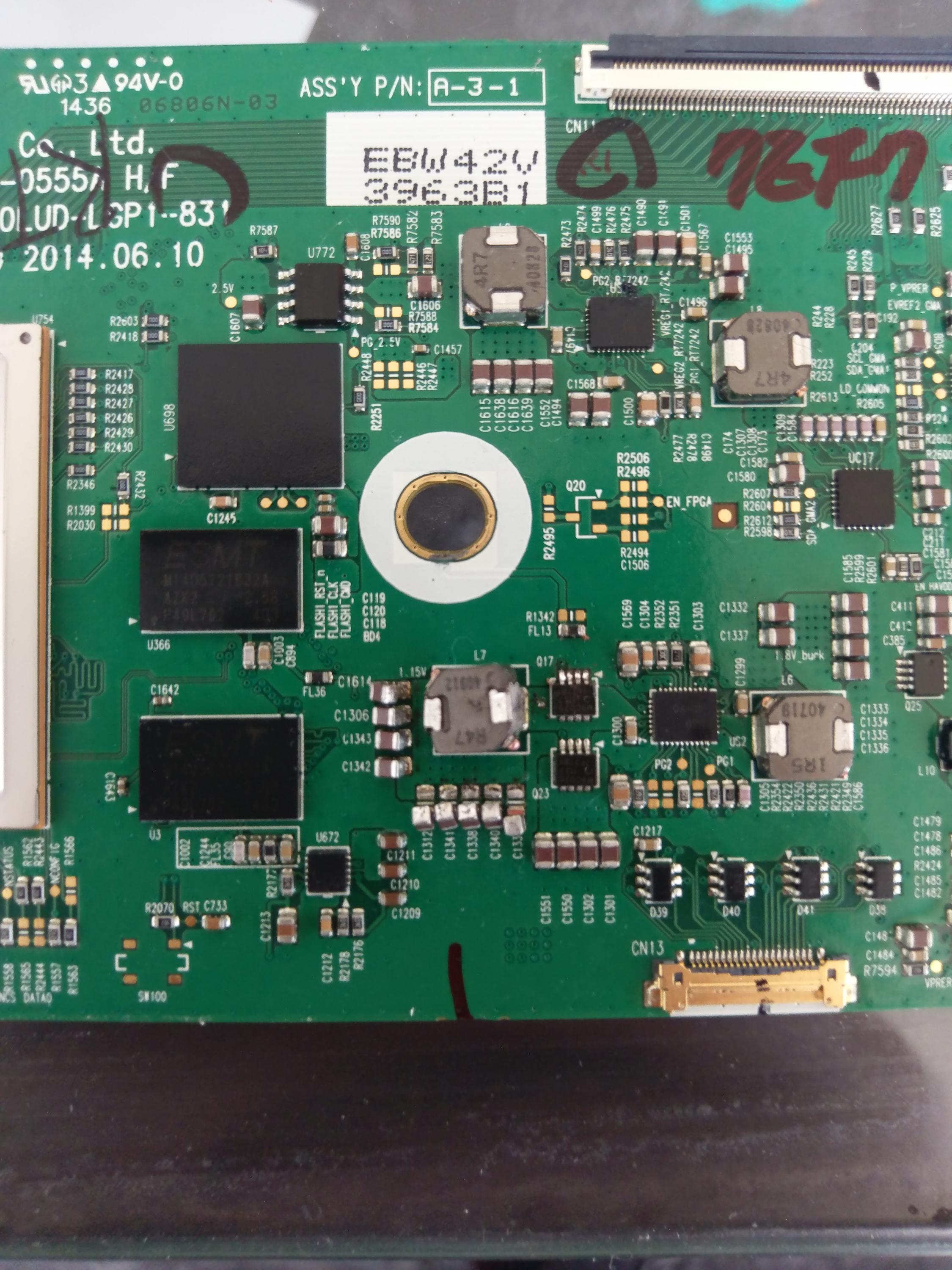

    I try one more time with tcon board. And I found something strange in voltage. One of coils should have output of 1.15v but there was 0.3v. Then I check capacitors, all of them was good. Then I dismount coil it self, because I was not sure if one of voltage regulators say blown. No there are good ones.
    When I check resistance of input of the coil and output without mounted any of that capacitors on that place, I found that output is 26ohms. Now I don't know where that output is going to. I will catch pictures of that board.
    I hope that it is not going to memory or process it self.

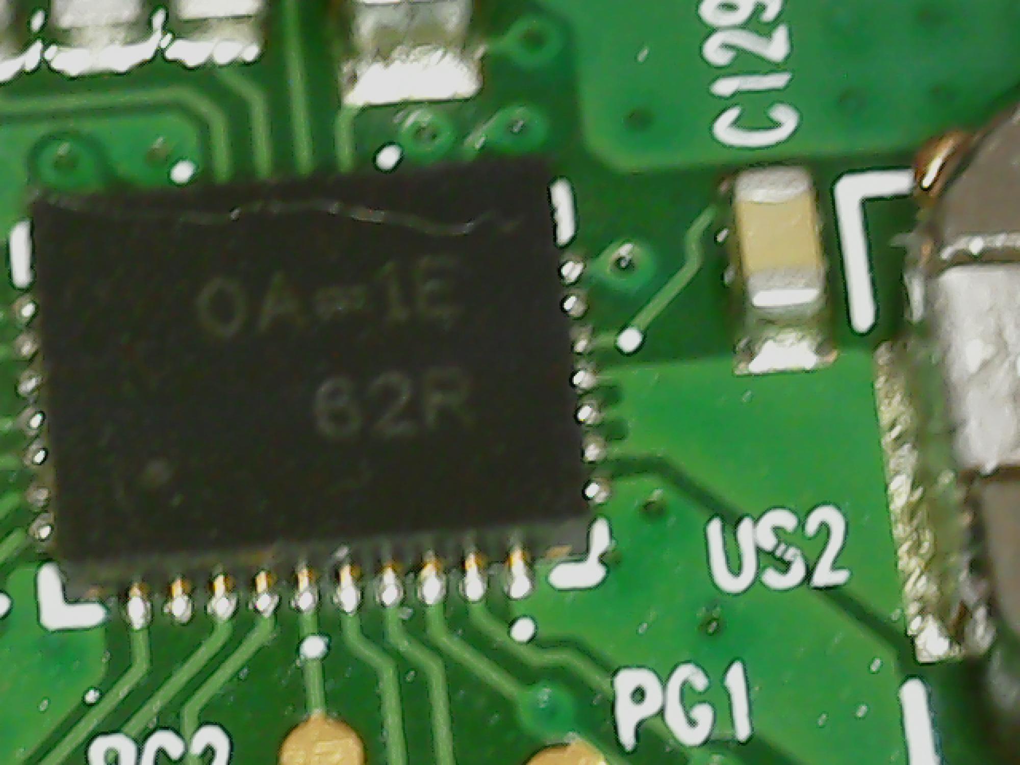

      What is the part number of US2 (or it could be U62) and Q17 and Q23
      • maxim2511
        • May 2021
        • 20
        • Netherlands
        Re: LG 55EC930V OLED - swich on swich of no screen
        what is the part number of us2 (or it could be u62) and q17 and q23
        US2 - 0a=1e 62r
        q17 - m9c025 1137 1437b1
        q23 is this same.

          This part have strange number.
          • dick_barton
            • Aug 2015
            • 6643
            • Wales
            Can't seem to find anything with those numbers.

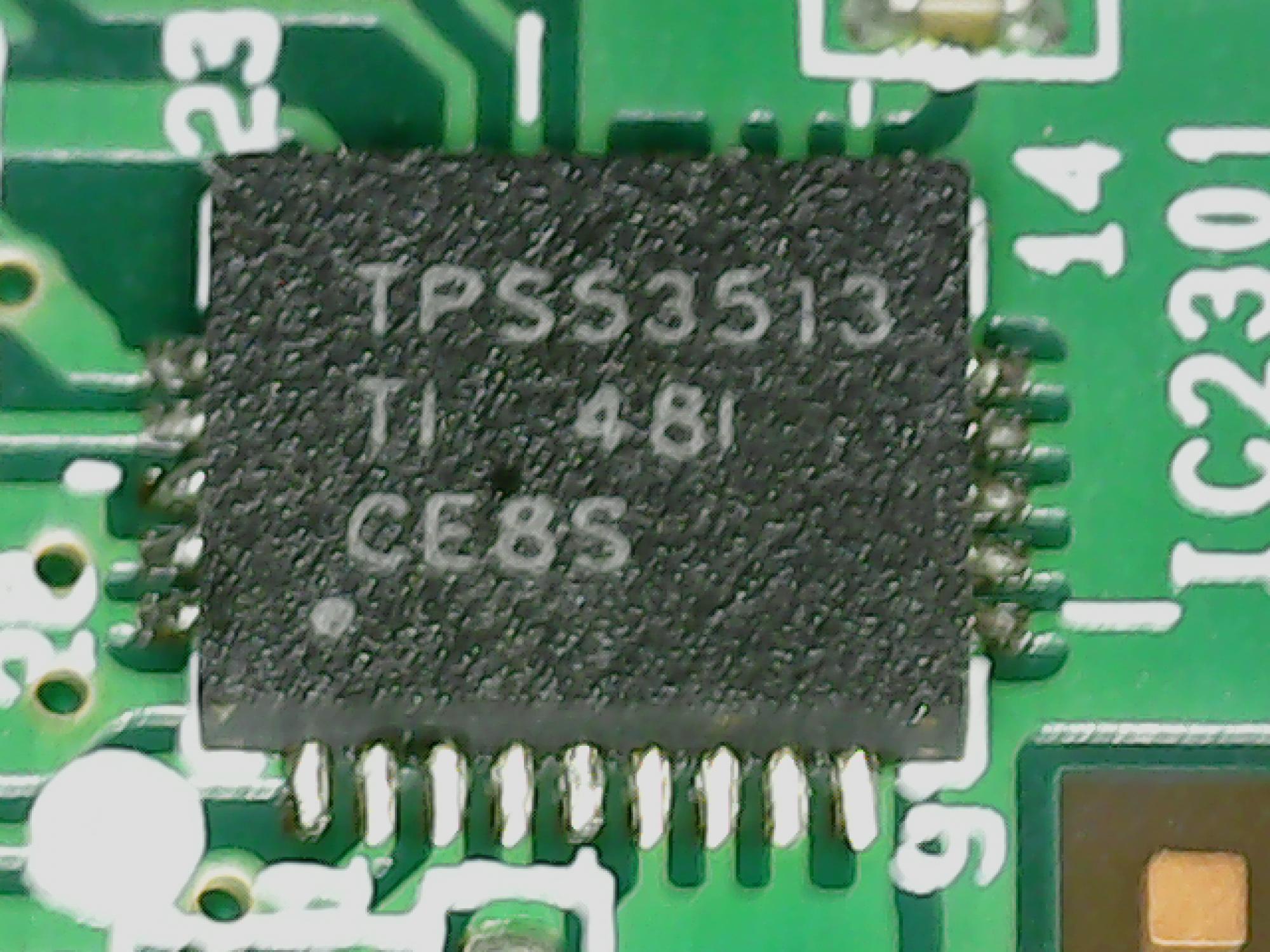

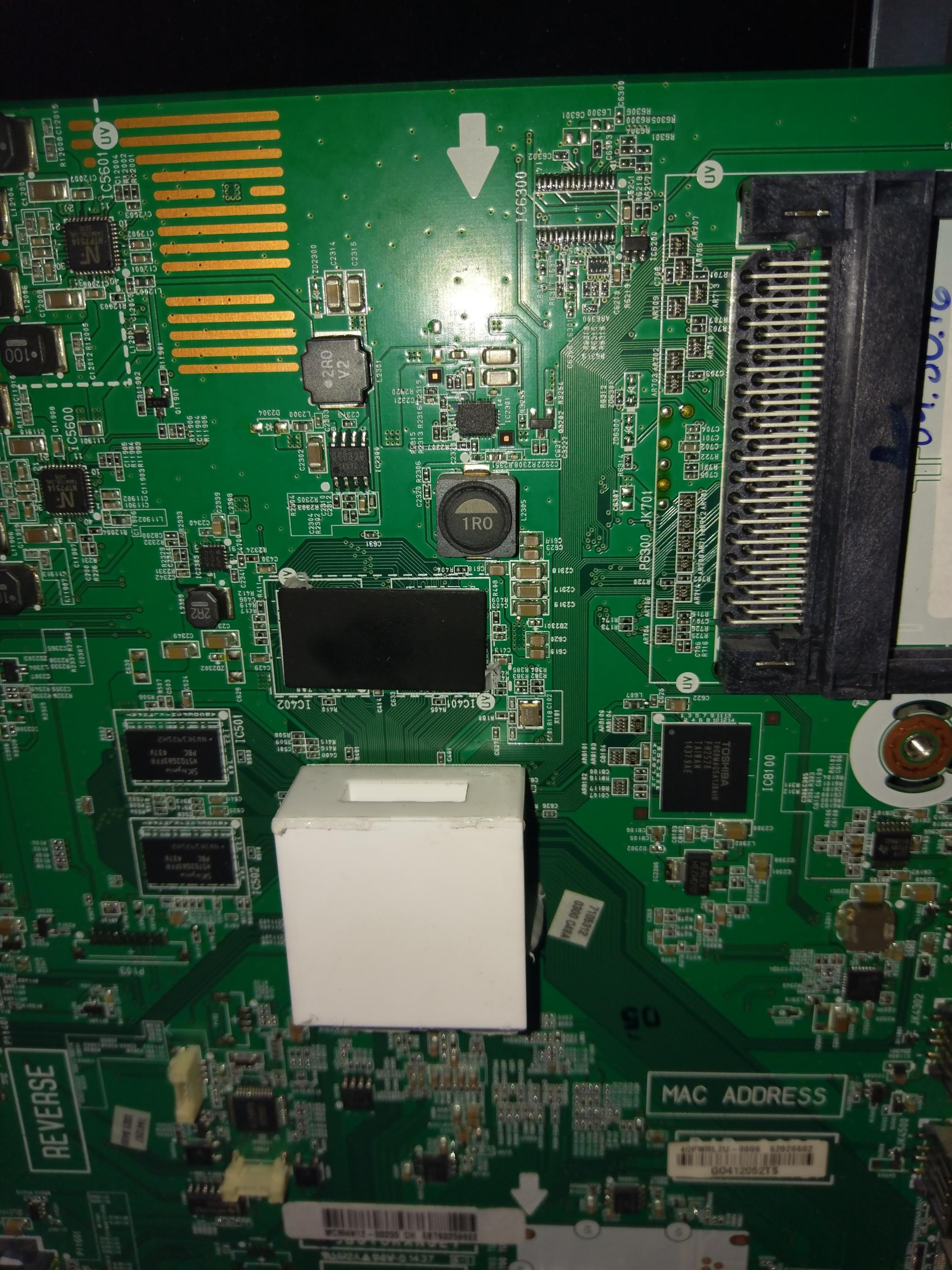

                          what about tpss3513 TI 481 CE8S
                          This part is on main board, and is close to coil, that coil is showing me 0.9V, but higher place there is 11.6V, yeah, almost 12V . I think this go to main procesor. When I put main board on hard turn on using botton on board, procesor is heating on like it could working, but I dont see light from optical fiber.. Coil it self is quite big, and so smal voltage is wired for that big coil.
                          • maxim2511
                            • May 2021
                            • 20
                            • Netherlands

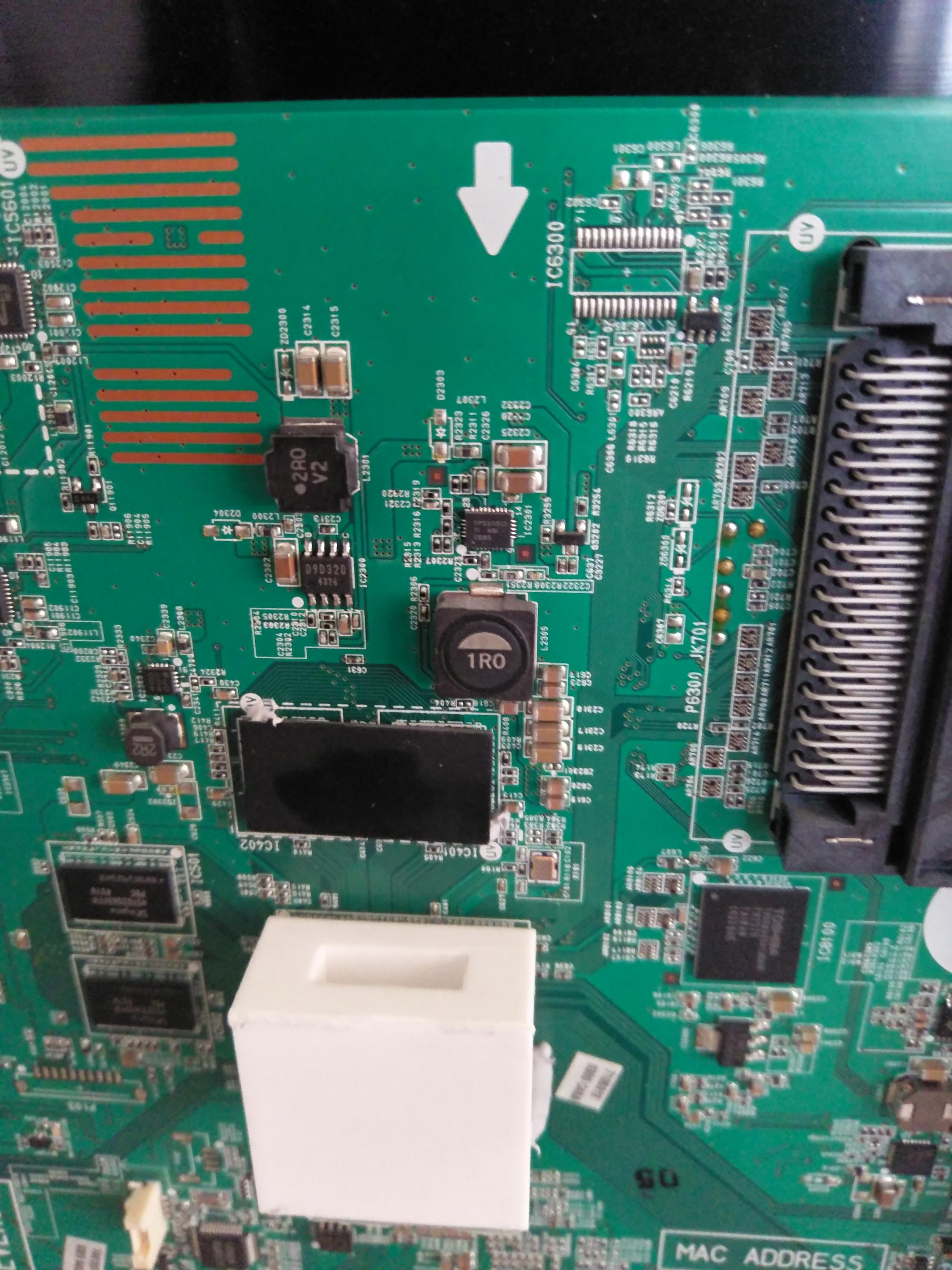

                            There where is white arrow, is pointing straight to that coil. I am wondering that for me 0.9v is bit too low. I think it should be more then 5v?
                            I read PDF about that chip, and this is Buck converter. Is step down voltage. PDF say that output should be something 0.6 to 5.5v but that big coil. Hm..
                            Capacitor near that coil have 0.26ohm.
                            Also I notice that when I try turn on with remote, that coil have 0.9V, and then goes to 0V, like is switching of earlier and then I heard click from power board.

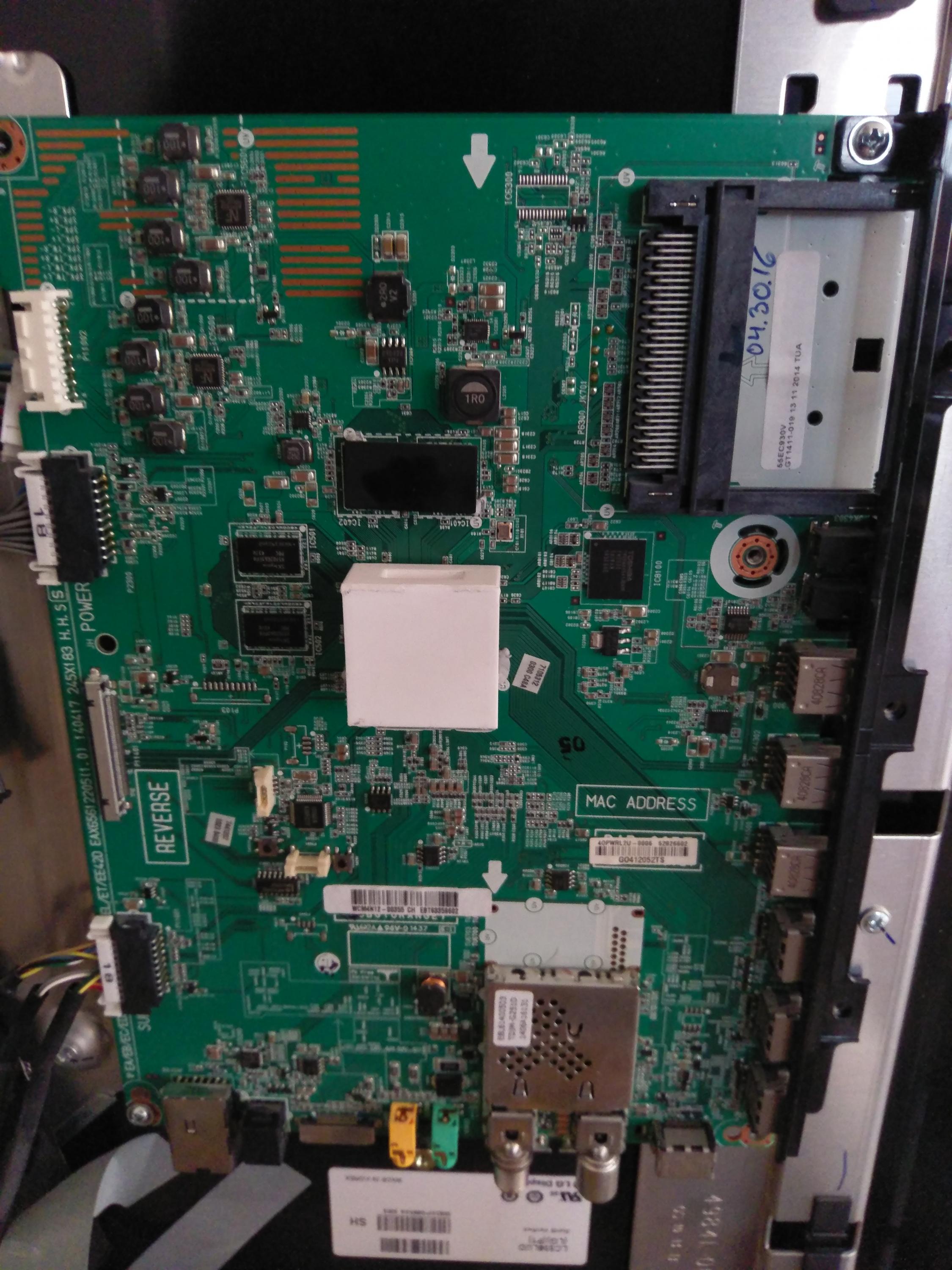

                                      I did order new boards, and Broken was TCON... Now I have different problem, and this is probably not problem of new TCON, I have almost black shadow in t he middle of the screen. It looks like there is not enough voltage, because when I have menu from operating system, and the rest is black screen, then letters are quite white, but when All screen is white, then whole screen is darkening, and in the middle of the screen is dark shadow. What more wired, is that when I change input from HDMI to 3, then is a lot worse.
                                      Screen should work a lot better, because ealier I was watching tv. From time when I was waiting for new boards, is NOT possible that pixels could burn out!
                                      I check voltage going to power screen in TCON from power board, and voltage is 23,6V not 24V.
                                      Maybe ground is missing?
                                      When TV works for longer time, then middle of the creen is going even more darker. But when I switch input in HDMI to 2 port, for short moment screen looks a lot better.
                                      What I can check??
                                      PS: Now I have 2 working main boards, and one TCOM from different TV but exactly this same model.
