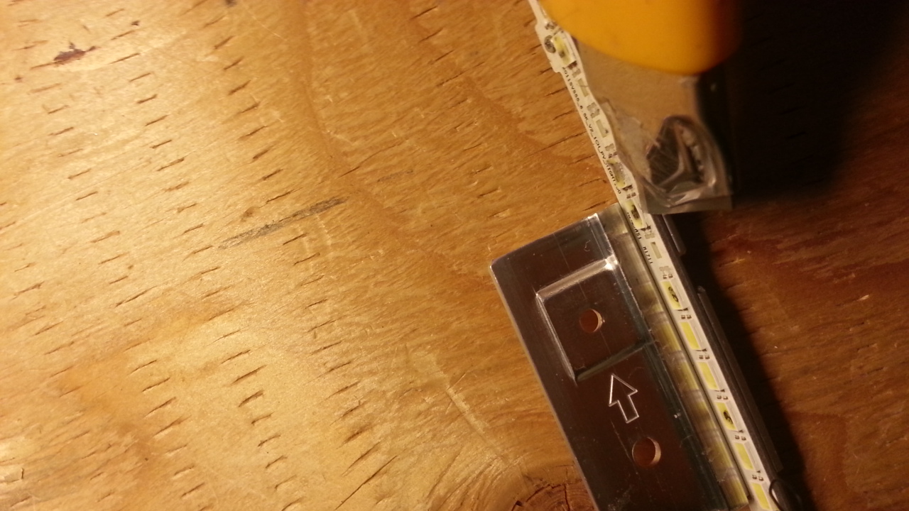

                        #131
                        Re: UN55D6000 Blinking Standby Light
                        You can pop them off with a knife. I'm going to use thermal glue to cement good ones back in place and jumpers to wire them together.
                        Won't be for a couple of days but will update my thread with a progress report

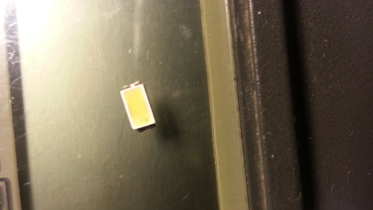

                          #132
                          @Ltank - there are no markings anywhere on the leds including underneath.

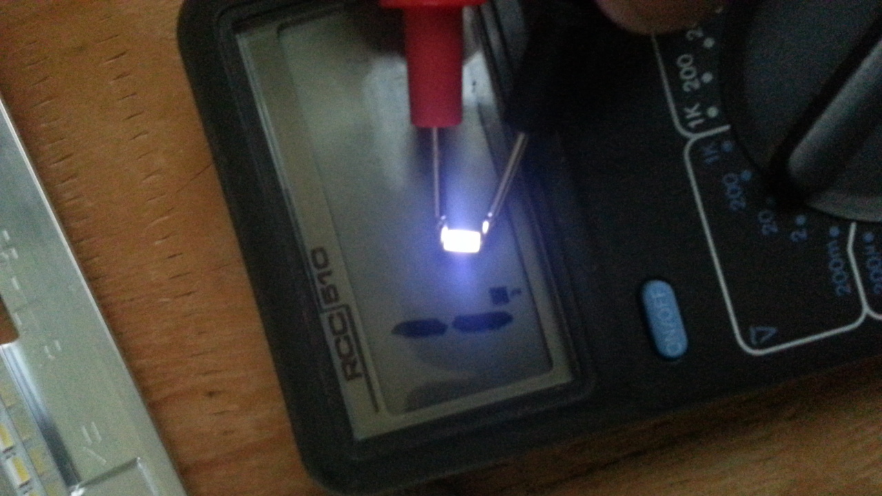

                                  #136
                                  I can try to measure the dimensions. The other clue for my string anyway is the 6.5k designation which is probably colour temp. I measured 3.6v across one in operation. That's about all I got.
                                  I have probably 75 or so good leds so depending on how this repair goes I can probably apportion some out.
                                  • Ltank
                                    • Jun 2013
                                    • 776
                                    #137
                                    I found these LEDs at http://store.comet.bg/en/Catalogue/Product/17108/
                                    from 15 to 18 cents each depending on how many you buy. I think I will buy about 20 and seeif they work out then i could buy more/

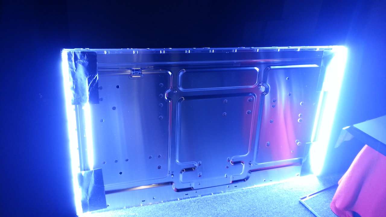

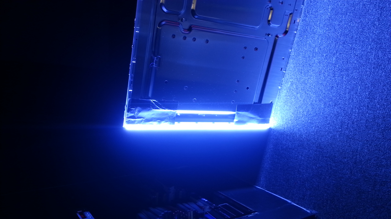

                                          #140
                                          Repaired. Again.
                                          Replaced three leds. Hardest part is wiring in the jumpers to complete the circuit because there isn't a lot of room between the leds and I couldn't make a functional solder bridge.
                                          Placed a light bead of solder paste down the back of where the leds are mounted before remounting the strip to the back plate.
                                          In the midst of a 12hour burn-in right now. Will check on them in the morning.
                                          In the first photo leds 6 and 7 from the right have been replaced.
