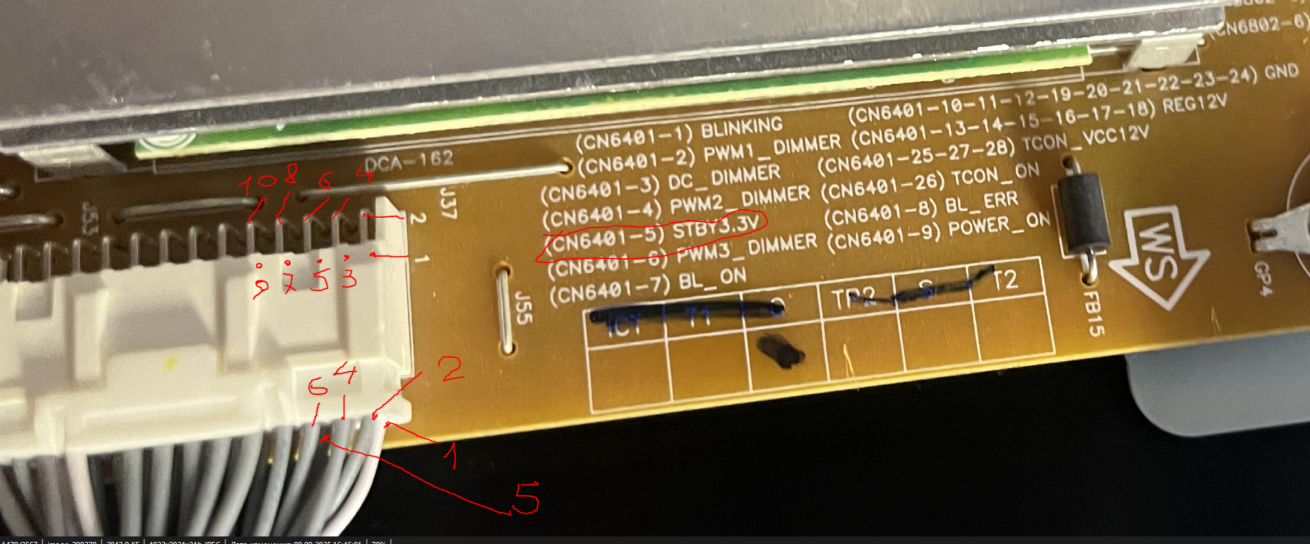

    I’ve got a Sony KD-65XE8596 here that has no standby light coming on. I’ve tested the power board with the test meter, the TV needs 3.4 for the standby but only getting 2.4. Anything that I can change/check on the board to get it working? Pictures of the board are included.

    Do you get any voltages on main board?

      2,4v also without loads? i.e. main board detached

        Pin 2 main board : 2.63v
        Pin 7 main board : 12.83v
        Pin 10 main board: 12.84v
        Pin 11 main board: 2.58v

          With Main board detached, I only get 0.03v on the same pin

            Are you at least measuring the voltage on certain pins correctly?

              this is not possible due to the post #4 , check well the connector, it has usually 2 rows of pins...

                Getting nothing from any of the pins with the main board in or when it’s not plugged in

                  See here.

                    I’m now getting nothing

                      5 Pin (stb 3.3v) is in the bottom row, third from the left, a thick probe may not reach the contact, insert a medical needle into the connector and measure the voltage on the needle relative to the ground.

                            To reach inner of connector use a new through hole resistor..

                                    The answer is NO, if you tested voltages before messing with connectors and now you have no more voltages then the new power board will not solve as the original fault was not the power board.. but check better with a resistor wire if you have..

                                      If the STB power supply (3.3V) was reduced to 2.4V (if this power supply was measured correctly and on the corresponding output (5 pin)), then the problem was initially in the power supply, and not in the motherboard.
