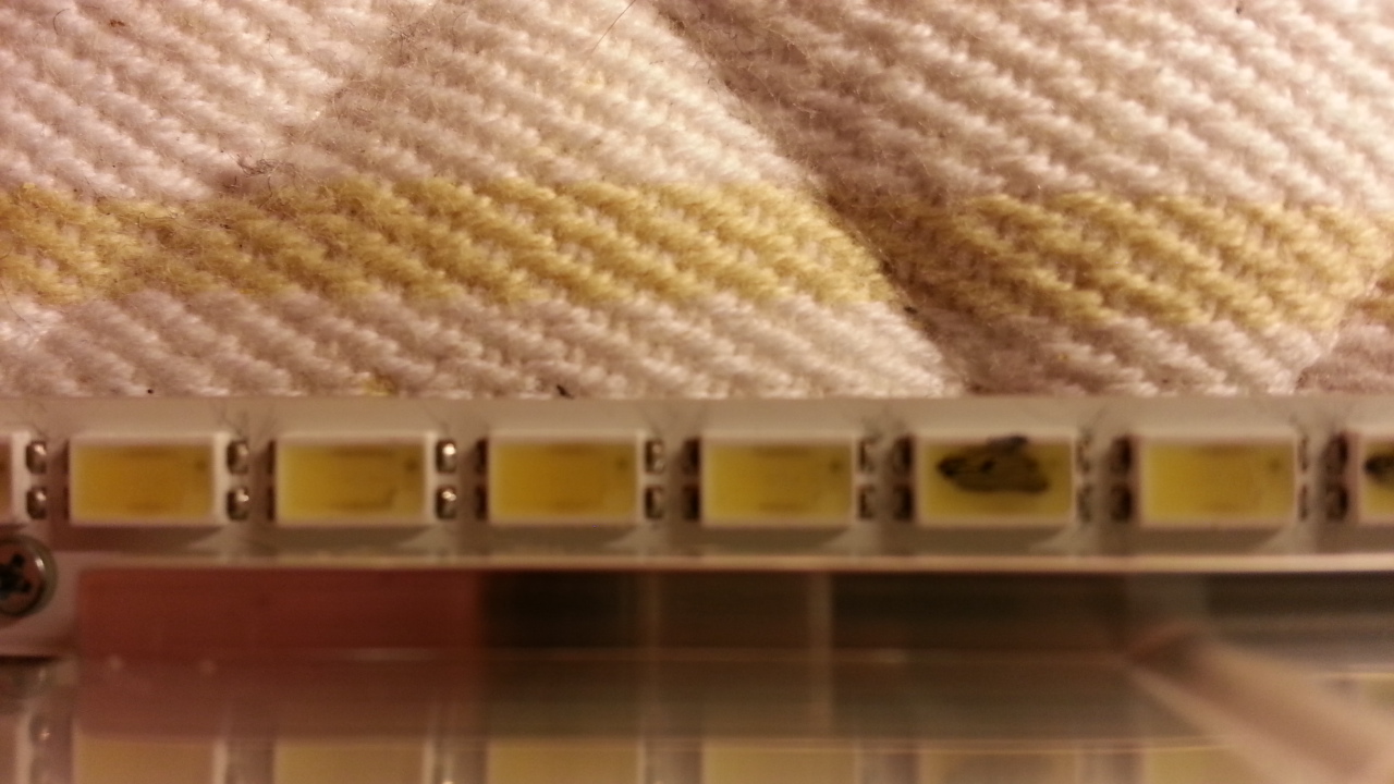

        #103
        Re: UN55D6000 Blinking Standby Light
        Show us a picture of the LEDs.
        Then, take your meter and measure the voltage across the LED when it is at room temperature (allow TV to settle down to room temperature first.)
        Then put your multimeter in 10A range across it, shorting it out, measuring current.
        (Both done while TV powered ON.)
        Then the replacement LED may be located.

            #105
            Ya let me clarify that. I CAN run the leds as the default is ON with main unhooked is that good enough for the measurements ?
              #106
              Yes, you can do that. We don't care if main board is working or not.

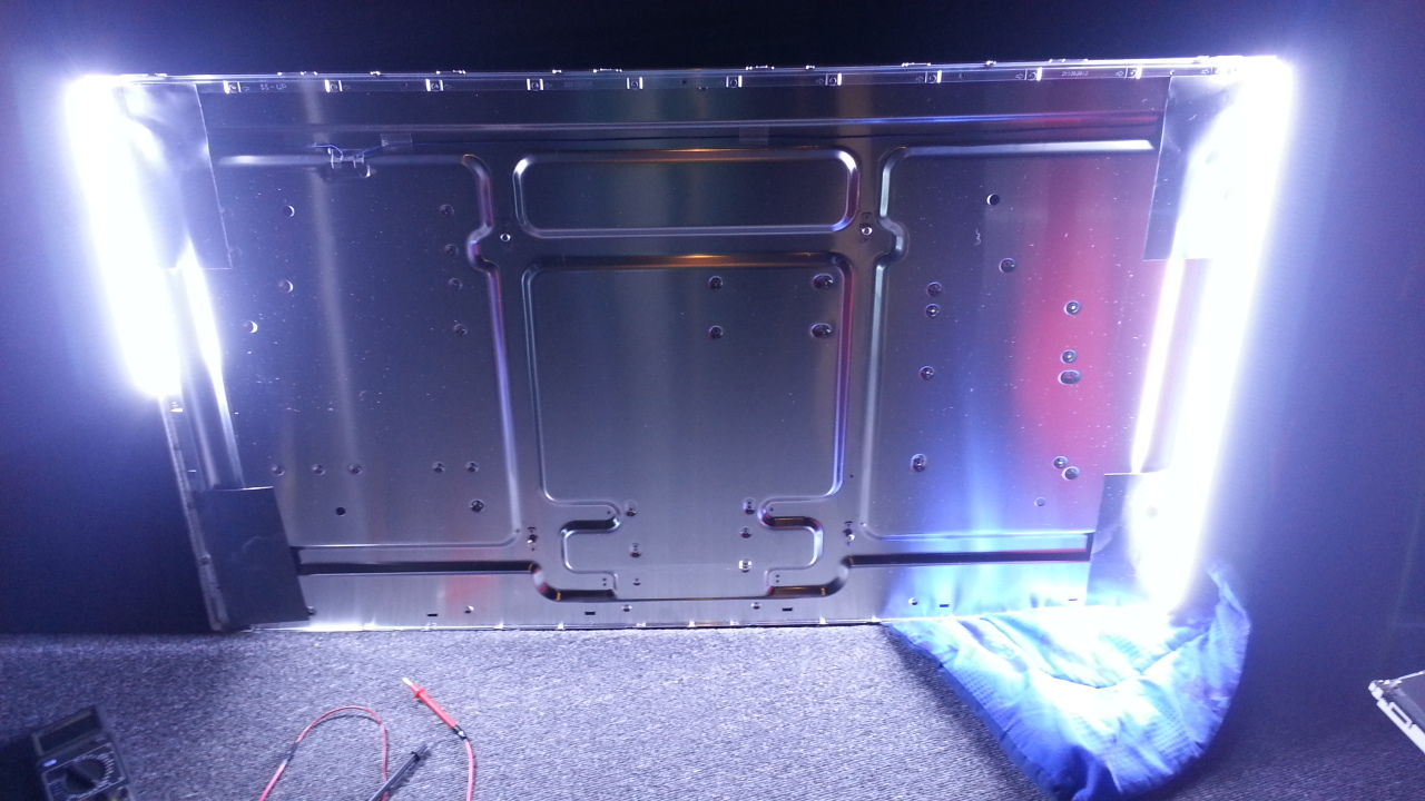

                    #109
                    That was difficult - very hard to see with the damn light stabbing your eyes.
                    I managed to get this. 3.6v across working led.
                    As for amperage, well... there was a spark and POOF! Lower half of the left string (the portion with 19 out already) has gone dark. The good news is the upper half has gone to full luminosity

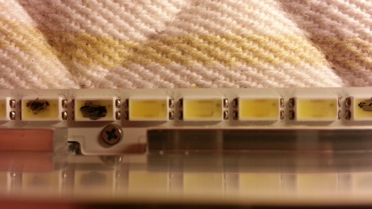

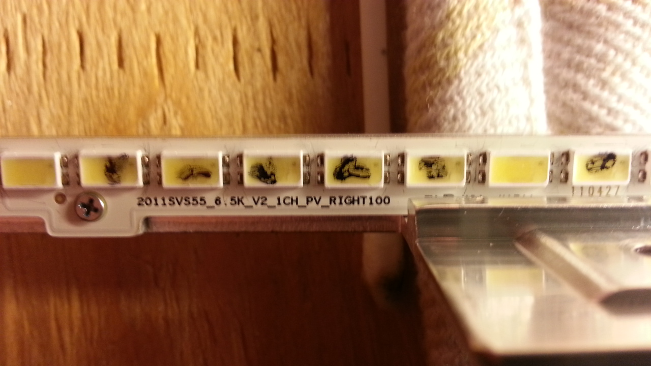

                      #110
                      Some pics...

                          #112
                          CCFL Warehouse is getting into supplying finished LED back lights, but their selection is small and they don't have these. I would expect if things go the way they are you will see more of these on the market.
                          There is a little bit of info on the last pic which shows the colour temperature as 6.5K, not sure if anything else useful is there.
                          The discolouration on the led's btw was put there by me with a sharpie to mark bad ones.

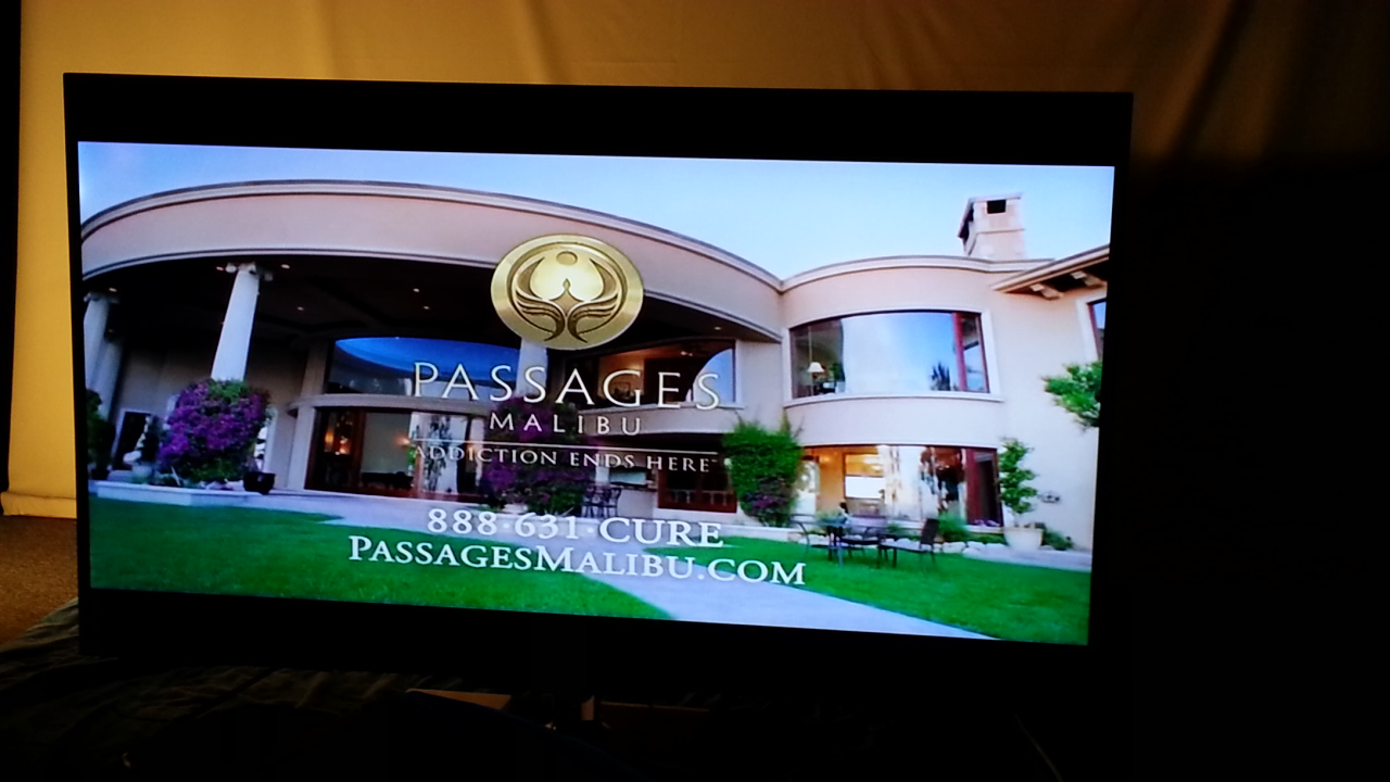

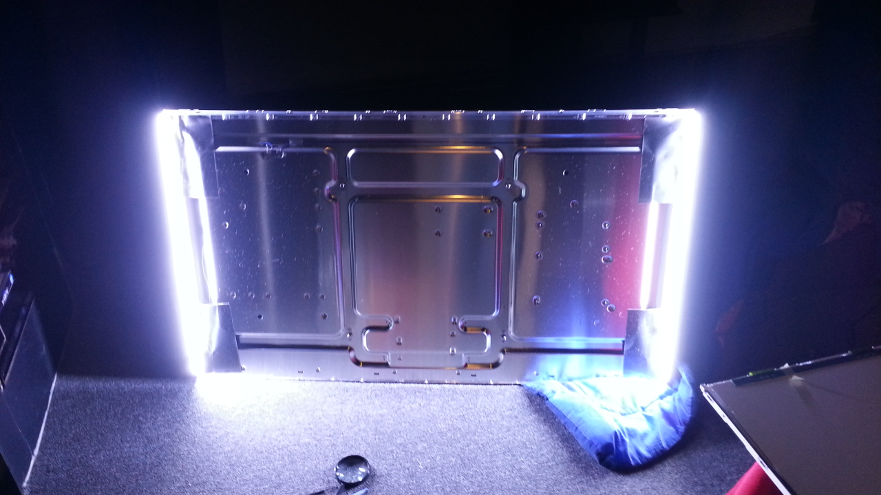

                              #114
                              One step closer...
                              • Ltank
                                • Jun 2013
                                • 776
                                #115
                                One step closer? What got to that point? Did you replace the LED strips?
                                • mmartell
                                  • Oct 2013
                                  • 3189

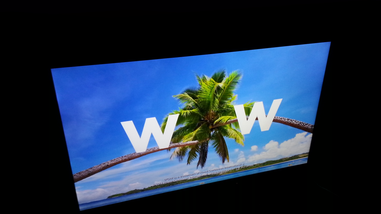

                                  #116
                                  Yes I replaced the bad strip. Now I need to replace the ir/button board which I broke (tore off some pads). I have no idea where one pad leads to so I need a replacement.

                                        #119
                                        I managed to repair the ir/button board and zipped the whole thing back up.
                                        Thanks to everybody for their help and input.
