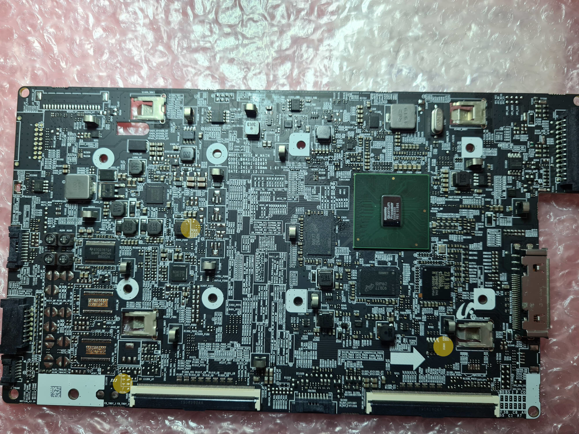

    I got a Samsung The Frame 55 inch TV for free from uncle cause it is not turning on anymore. I am in the second year of training as an electrician so I have knowledge already but I am far away from to be a pro.
    The TV has Standby but ist not turning on. A Friend of mine owns a 50 inch Frame TV so I checked the One Connect Box and the One Connect Cable there. Both are good and working normally. I have opened the TV case and measured some voltages on the Board.
    What I already found is that the 12.8V are not an the connector to the main board connector to the power board. The main power supply is in the one connect box and it delivers 350V and 13V over the One Connect Cable to the main board and then to a smaller power supply in the TV.
    It is not the easiest TV to start with 🤔
    What is happening when i press the TV on Button:
    1. Standby Light goes off
    2. The One Connect Box starts up with a clicking noise (3 times followed by a break and then another clicking noise for 3 times)
    3. Standby Light is back but screen stays black and no backlight at all
    The power supply board gets the power on voltage of 3.3V and the 350V but no 13V(12.8V). I found a component on the main board without a value( OL on the multimeter) and I don't know what it is. It is marked as VT and is green. Could it be a smd thermistor? Picture attached for the main board and the component.
    What I know is that the missing 13V should reach this point but the don't. Could someone help me to identify this component and the right value?

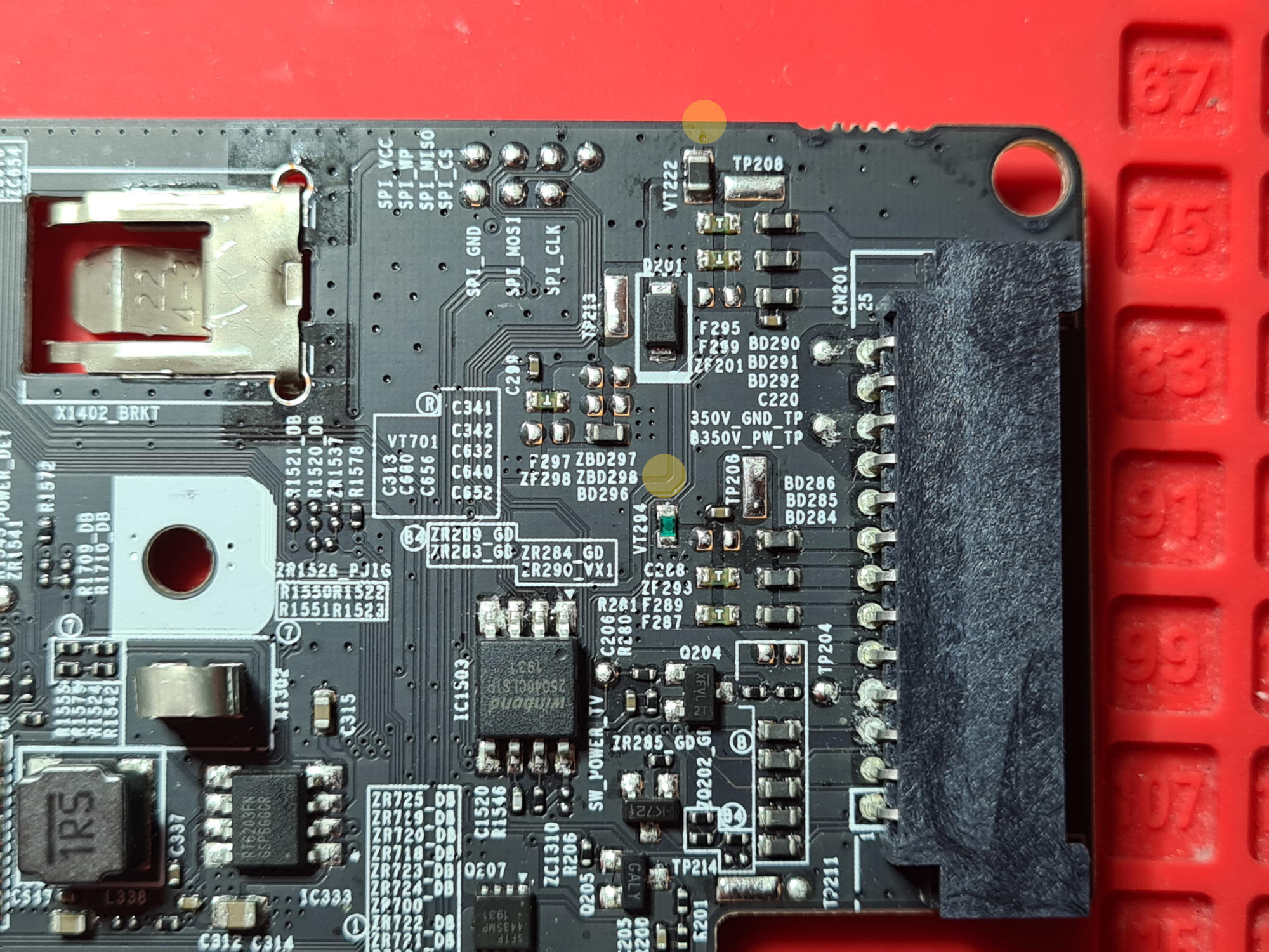

    Marked as VT294 on the pcb.
    • Diah
      • Feb 2013
      • 6483
      its look some one play with solder IC 1503 SPI 25Q40CL, this is where the start firmware saved on it... check pin 4 if it had short with pin 3 and if there 3.3V on pin 8, try to dump it and posted over here to check if its fine or not

        Hello Diah,
        no short on IC 1503
        Voltages on Pins
        P1: 3.3V - P2: 1 - 1.5V depends on clicking inside the One Connect Box
        P3: 0V - P4: GND
        P5: 0V - P6: 0 - 0.7V depends on clicking inside the One Connect Box
        P7: 3.3V - P8: 3.3V
        Thank you for your help!
        I thought, i found something shorted but I was wrong. On the picture with the whole pcb are 3 yellow marks. A Coil and 2 ICs. The coil ist connected with on side to a diode and with the other to ground.. so it´s ok.
        On the left ist a small sot23-6 IC1100 (U9AJ) where pin 2 and 3 are grounded and after a closer look on them, it´s ok.
        On the right side is an IC - IC801(S24C51 - 2C4KJ6) where pin 1 - 4 are grounded. Looks also ok...

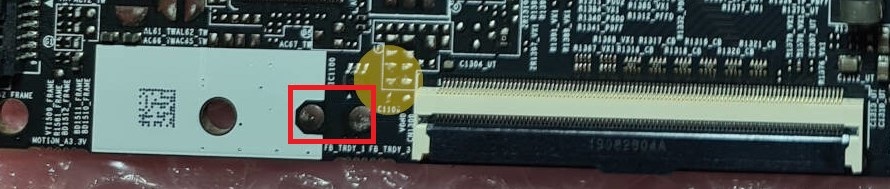

          put jumper between this 2 points FB_TRDY1 and FB_TRDY3, and disconnect the LVDS cable both or one by one.. see if the TV start on

            Tried all combinations but result remained the same.The 13V on the connector are missing and therefore on the psu.

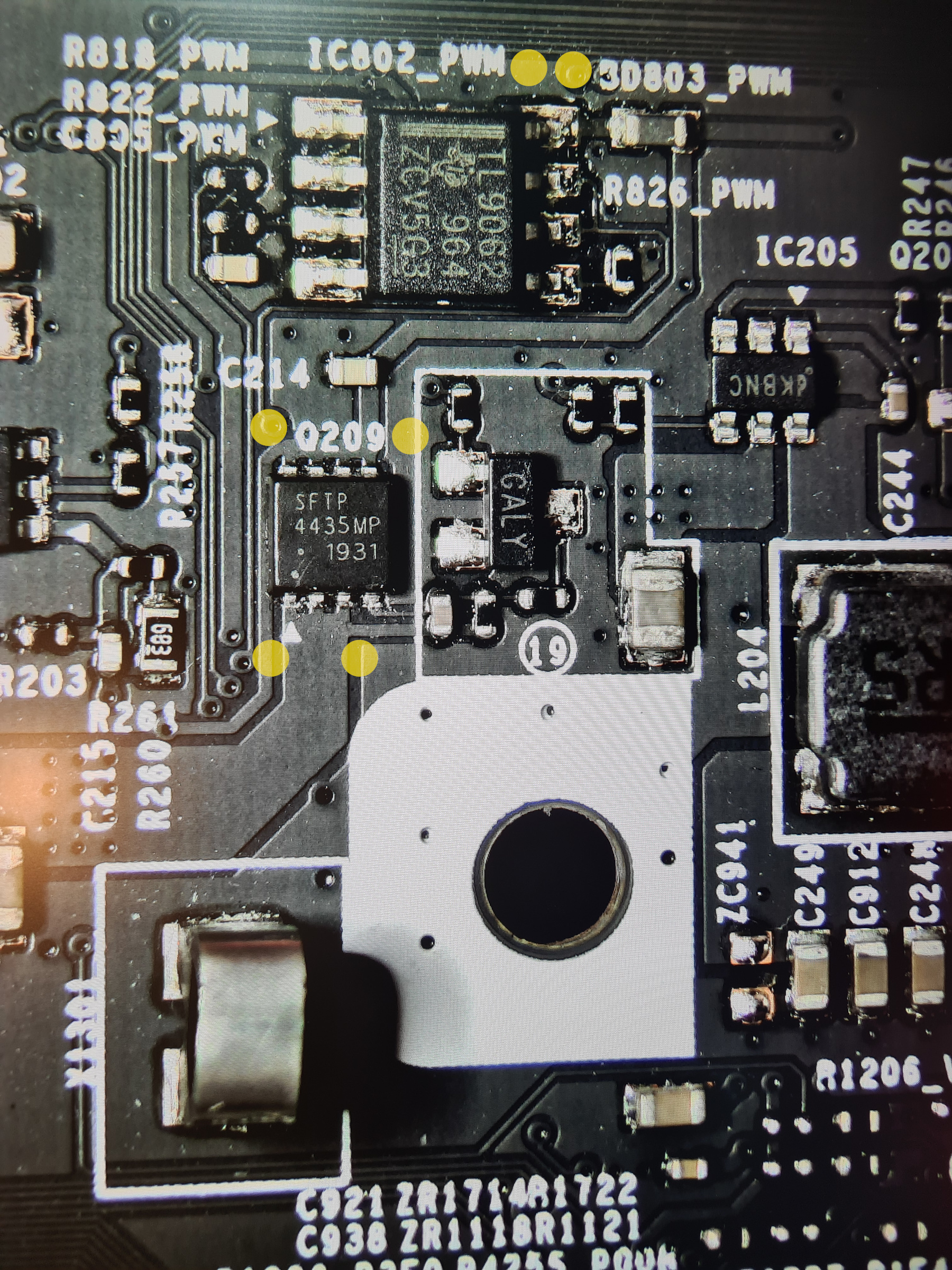

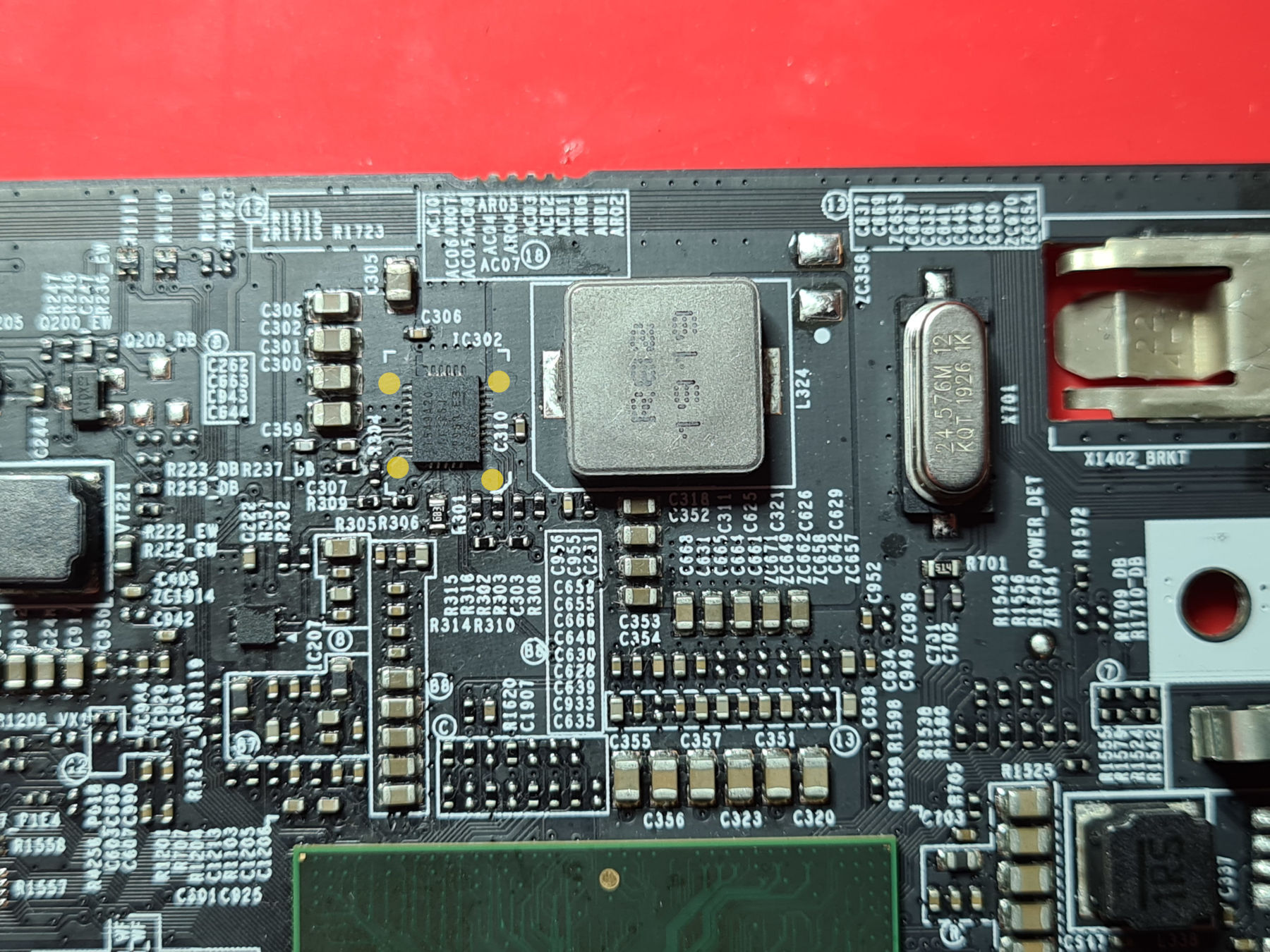

                          I borrowed from the company I work for a UNI-T 260A thermal camera. I was really excited but my attempt to find the faulty component went terribly wrong.
                          I found a spot on the board where something was heating up but very slowly. The Connect Box tries to turn the TV on and then stops. So I've pushed the TV on button for about 4- 5 times to localize the heat spot better.
                          And then.... something lightens up so quickly that I could not react. This feels so bad. I am really shocked till now. Not what I wanted.
                          The good is, the PCB is not damaged. I've de-soldered this ic and cleaned everything up. Everything looks good to me but this ic dead. It has a hole now.
                          Honestly, everything i fixed until now was easy going. A shorted Cap here and a burned Mosfet there or bulgy Cap... This TV is different and shows me how
                          much I have to learn. A very disappointing and loud "Welcome to the real world!" moment.
                          Ok... have to order a new one and replace it. IC302 is the one that died. (TPS549A20)
                          Found a suspicious p-ch Mosfet too. It has 5.1V on source and 5V on Gate but 0V on drain.
                          In my opinion it should be switched on and has voltage on drain right?
                          It's a Samsung Mosfet and i can't find a datasheet for it. But found a shop in the Netherlands where i can get it from.😥​

                            wow.. it sound will be big project.. when you remove the IC, you need all ceramic caps around it testing.before you put the new one

                              With regards to the MOSFET, since its a p-channel FET the readings you are seeing are as expected. You see, P-channel MOSFETs turns ON when the gate voltage is sufficiently lower than the source voltage. You will have to look at the datasheet to see how low the VGS needs to be in order turn the FET on. Will definitely be greater than a 0.1v difference.
                              We also cannot rule out the possibility of a short on the panel itself although i have never heard of one on these FRAME TVs. In reality there is no reason why they should be any different from other Samsung panels. The only real difference is the matt coating which reduces glare. So it should be as susceptible as any other panel. There are just fewer FRAME TVs out there and their owners are less likely to attempt a fix and more likely to just replace the TV.
